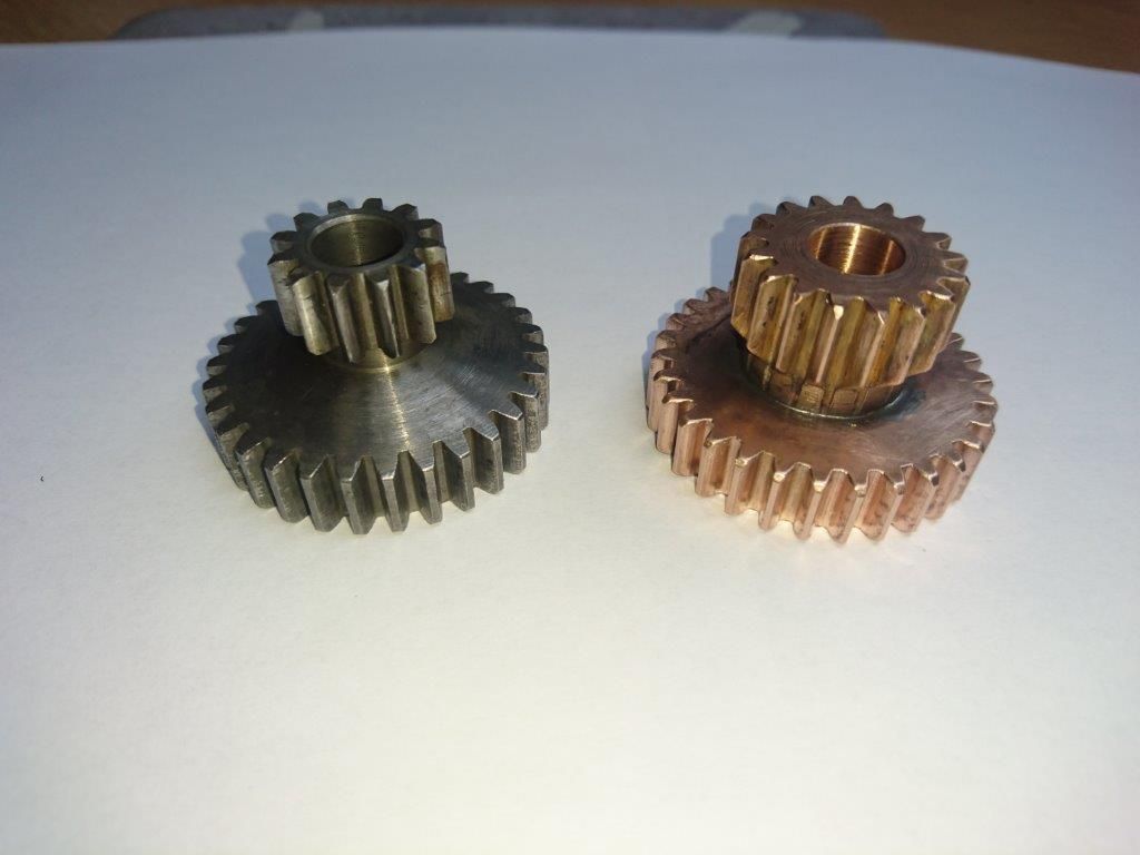

      First to set the scene. Some of you will be familiar with this as being the mandrel gear for a pre-historic Myford S7 with the Mk 1 QCGB,
      xxxx
      The one on the left is the proprietary Myford 30/12T original, the one on the right is my version of the same thing with 17 teeth on the smaller gear. I made a 17T gear on a stub shaft, and soft soldered a 30 T gear onto the stub.
      I was curious to know if I could have used Loctite, and how strong is the soft solder anyway.

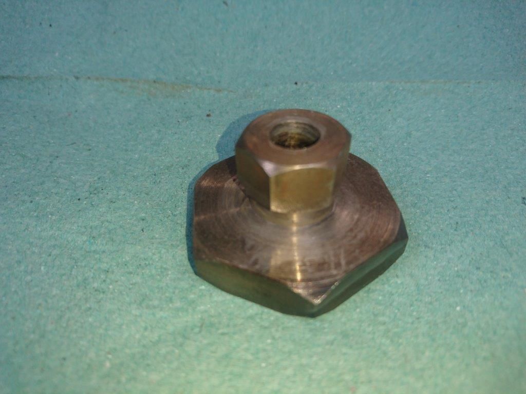

      So here is a dummy gear cluster, with hexagons cut instead of the two gears:

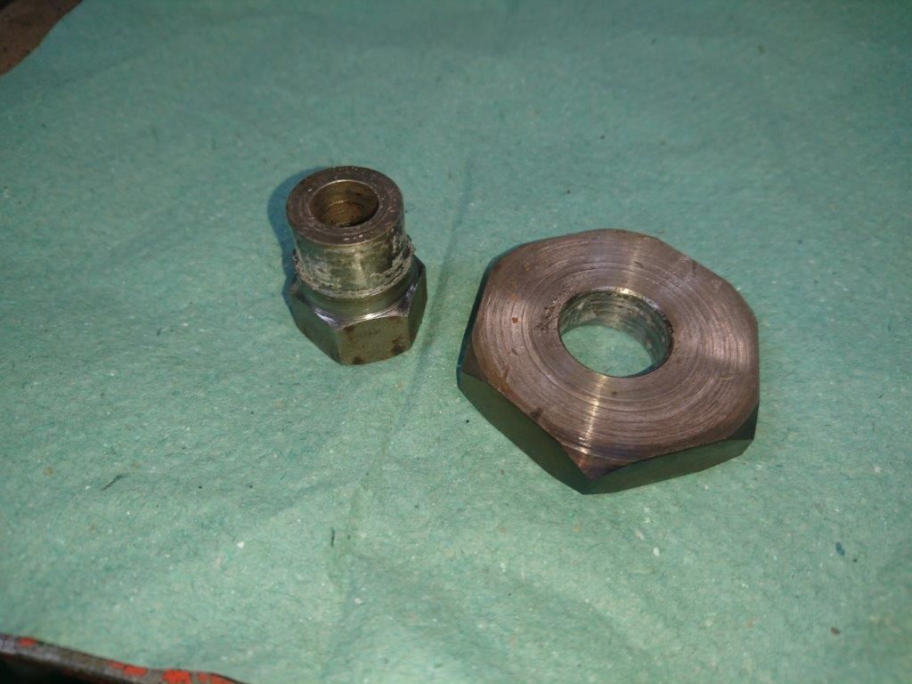

      For the sake of completeness here is a picture of the two component parts:
      xxx
      There are, as you will have noticed, remnants of Loctite on the interface between the two parts. To scale the area of the interface, that stub is 0.625 OD +/- about 3 tenths, and the bore is 0.375 ins long by 0.625 OD – minus nothing plus maybe 5 tenths. So a "place fit" rather than a push fit. I didn't make any attempt to polish the mating surfaces – the bore is straight off a reamer and the stub is straight off the lathe tool, which is exactly how I made the parts of the original gear cluster.
      So I tried assembling the two parts with differing grades of Loctite. Then I broke them apart in torsion holding the large nut (41 mm a/f) in the vice and applying a measured torque to the 19 mm a/f "pinion" with a torque wrench. To be strictly fair the torque is applied only one sided – so it is a cantilever load on the join – but that is how the assembly will be used in real life. I applied successive and increasing torques to the assembly increasing in 5 ft-lbs increments until the joint failed. The two torque wrenches I used are in good condition but not formally calibrated and are the micrometer type.
      This is what I measured:
      Loctite 638 12 hours cure, failed at 60 ft-lbs, withstood 55 ft lbs.
      Loctite 638 repeated, 17 hrs cure, same result
      Loctite 243 (Nutlock) 2 hrs cure failed at 15 ft-lbs, withstood 10 ft-lbs
      Loctite 542 (Thread Sealant), 3 hrs cure, failed at 30 ft-lbs, withstood 25 ft-lbs.
      I then tried soft-soldering the two parts together, using 60/40 resin cored solder with additional active flux, this failed at 110 ft-lbs withstood 105 ft-lbs.
      If anyone can suggest other grades of Loctite which might be of interest to get into the magic three figures I'd be interested to try them out.
