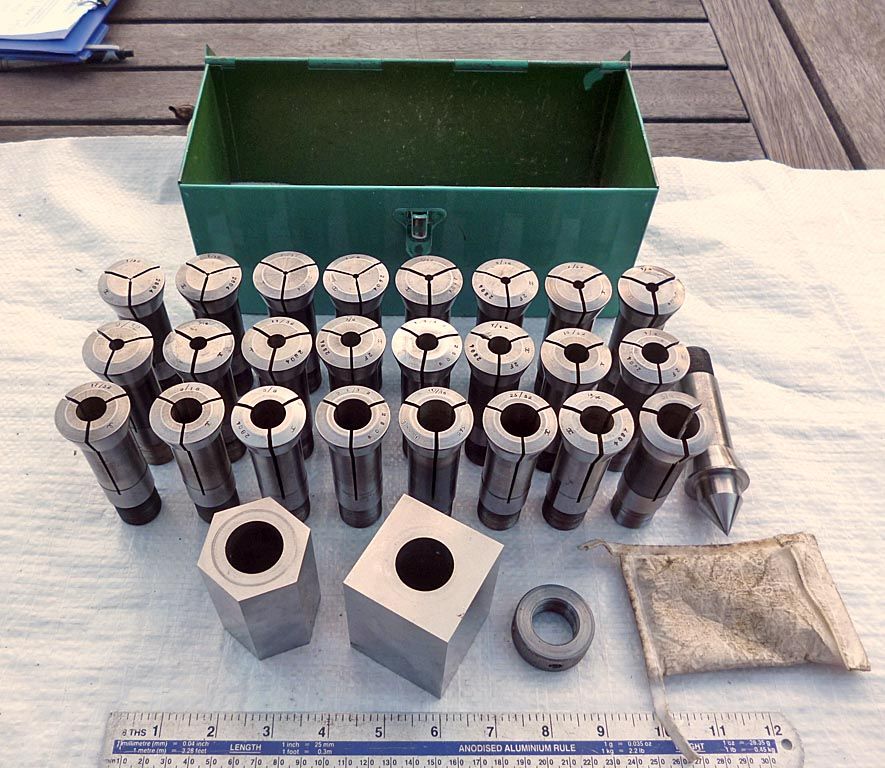

      Hi all,
      Just got back from a large tool auction and in the lots I purchased there is a full set of Imperial collets which I am going to dispose of on EBay.
      Naturally I wish to describe these accurately but have never had any of this size and design.
      I wonder if anyone can shed some light for me on the correct ID of these.collets 1.jpg
      They all have the number 2804 on them with a logo that looks like the CC of Coco Chanel! smiley
      Imperial sizes from 1/32" up to 3/4"; the parallel shank diameter is 25mm and the external diameter of the threaded end is 23mm; 33mm maximum diameter at the bell end.
      Any help most welcome.
      Regards,
      Martin

          Crawford Collets is the CC, have a look here to find the size/type

                Too bad you did not give more informations: total length, angle of head,keyway or not, thread metric or imp., normal or sawtooth…
                In my eyes they look suspiciously like W25 collets. .
                Some numbers for these: length 97.6 mm, head dia. 33.7 mm, thread (very special! sawtooth) dia, 24.7mm / 15 tpi with angles 45/5 deg., head angle 15°, keyway 5 mm
                Hope this can help?
                Regards, HansR.

                  Martin,
                  Crawford collets no 2804 were/are used on Smart & Brown lathes, and may be specific to those machines.
                  So they won't be in a current Crawford list .
                  I should try the Yahoo S & B Group for confirmation

                      There is a 4mm keyway; total length is approx 92.5mm;
                      external diameter of the threaded end is 23mm; 33.7mm maximum diameter at the bell end.
                      Martin

                              2804 are the collets for a Smart & Brown model A, I think they also fit the model L plain turning and capstan lathes, I don't know about the others. The ones for my Model A are all marked 2804. I think they are a specific collet for these lathes, slightly bigger than a 3C and smaller than a 5C.
                              The sizes will be imperial, the 25mm diameter is 63/64 which is the spindle bore, the thread is approx 0.9" diameter probably 29/32, and 24tpi RH.
                              Hope this helps

                                OK, just measured them properly on a good mitutoyo mic.
                                The parallel diameter is 0.9834" and tghe diameter across the treads od is 0.9033".
                                Thread form looks totally symetrical to my eye under a x10 lens. Thread is RH
                                Looks like Trevor is on the money!

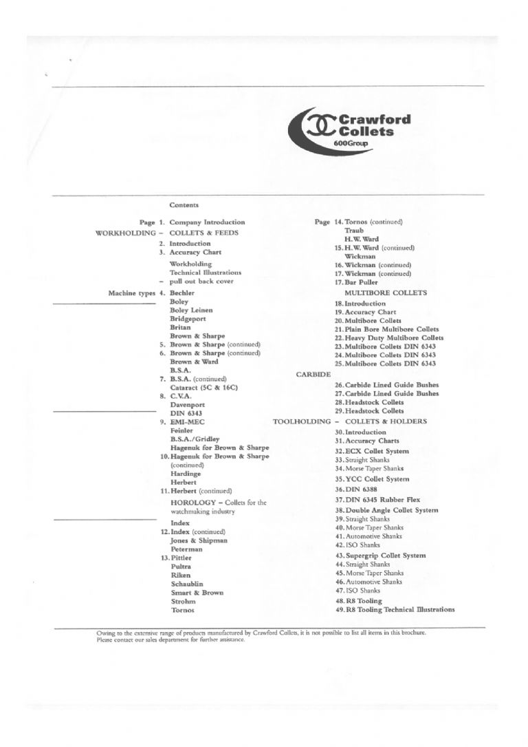

                                  I have dug out an old print out of the Crawford Collets products and scanned it to a PDF. There are 29 pages with dimensions and capacities listed by manufacturer so I was wondering if there was a good place to put this file or is it just a case of email it to people if they ask for it?
                                  Martin

                                        I could convert to jpg format but there are 29 pages and it is probably best kept as one file. If someone has a web site that could make it available to anyone searching for collet dimensions for lots of manufacturers' machines that would be the best place for it. I have copied the Smart & Brown section to a single page made a new table with the data in it and put it in the files section of the Yahoo group for those lathes. It would be a lot of work to do that for all the other makes. As I write this it occurs to me that it may be something that could be put on the lathes.co.uk web site. I will ask Tony about it.
                                        Martin

                                          With thanks to Martin for spplying the PDF …
                                          I have put the supplied pages into individual jpg files, here
                                          The files are numbered to reflect the pagination.
