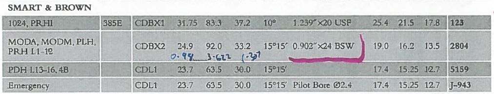

      I have a number of collets bought in a job lot.
      They are marked with various makers logos including Crawford and S&B.
      The number that identifies them is 5159.
      They are 2.5" long and the rear diameter is .937"
      Does anyone know what they fit?

          Look through this album. Page 13
          **LINK**
          Martin C
          Edited By Martin Connelly on 03/01/2020 18:15:39

            Found the original scan and clipped a bit for you.
            Martin C

              Hi,
              Thanks for taking the time to find that.
              Presumably they fit one of the model L headstocks.
              Many thanks.
              David.
              #444628
              Martin Connelly
                @martinconnelly55370
                Model L with PDH headstock. According to lathes.co.uk website this was a collet only headstock so it is probably quite rare and owners will already have the required collets.

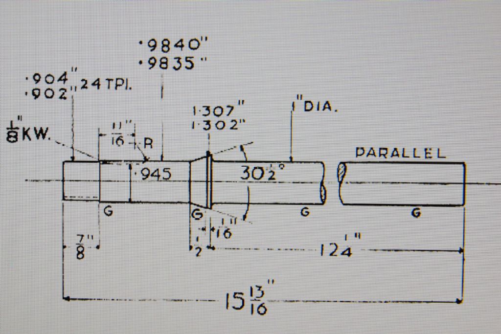

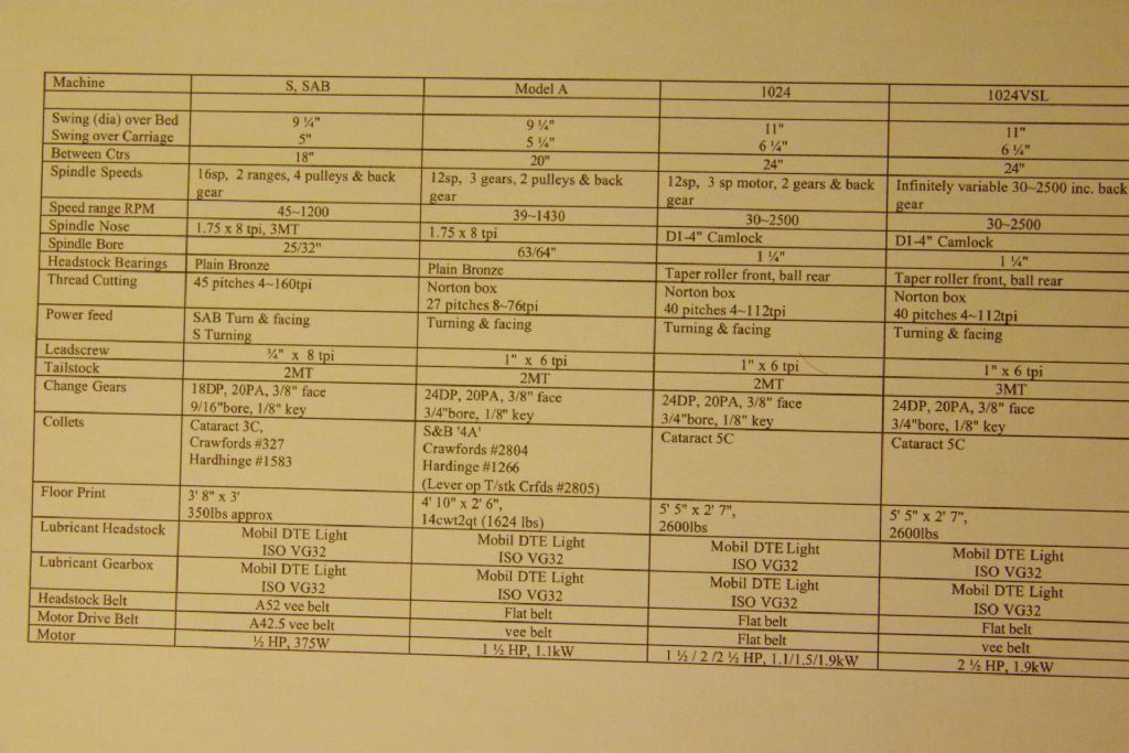

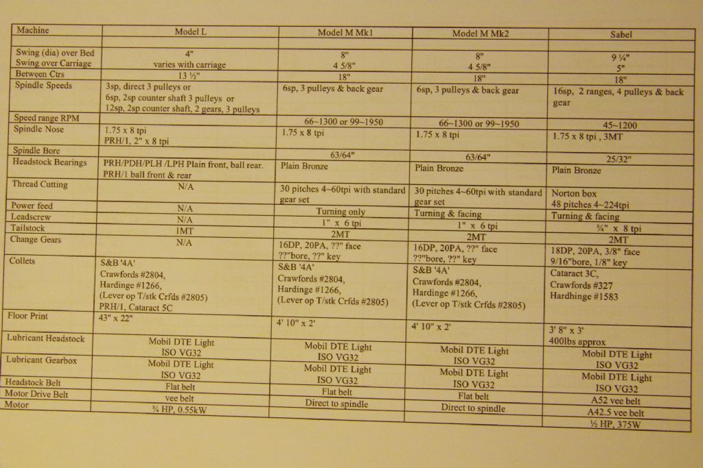

                old mart
                  @oldmart
                  imgp0949.jpgI have some of the S & B lathe specifications which list collets, and a drawing of a test bar for the Model A which shows the exact collet dimensions.imgp0948.jpg
