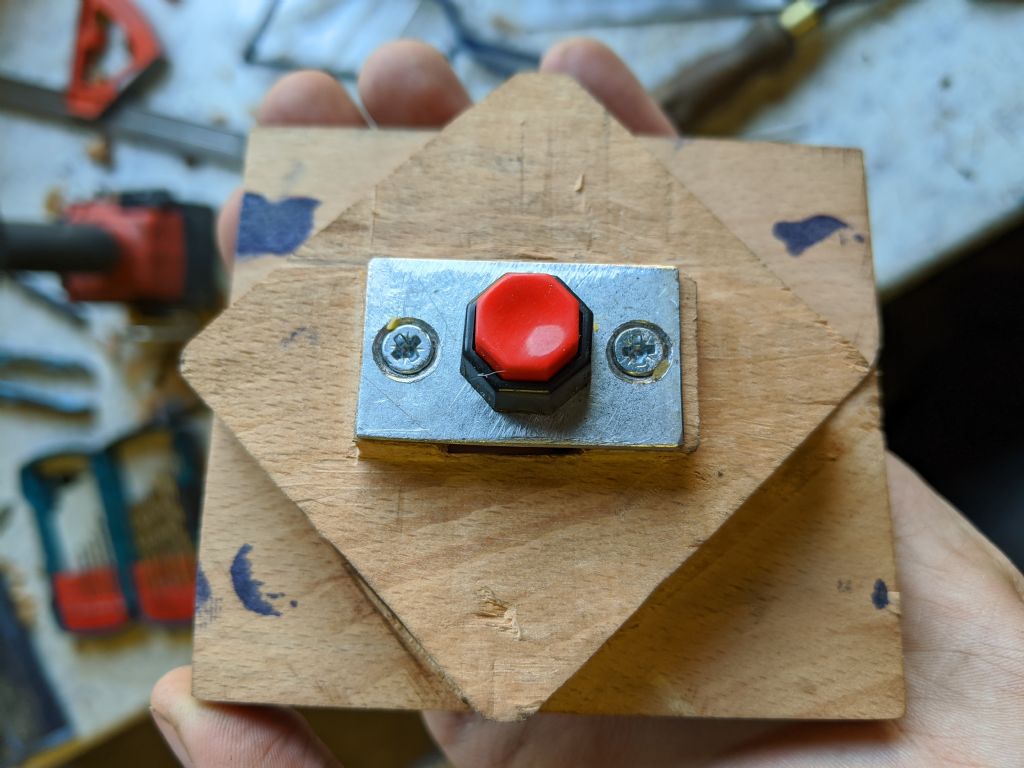

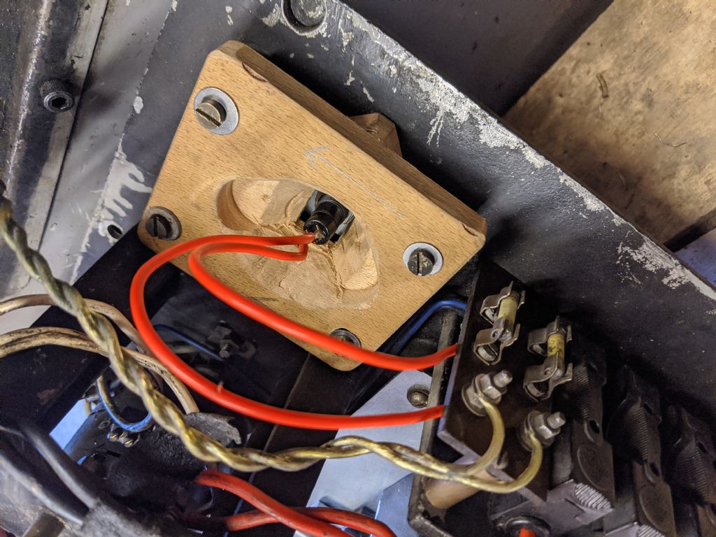

      I've just finished the light switch mounting things, so that's looking quite nice, especially considering you'll never see any of it.

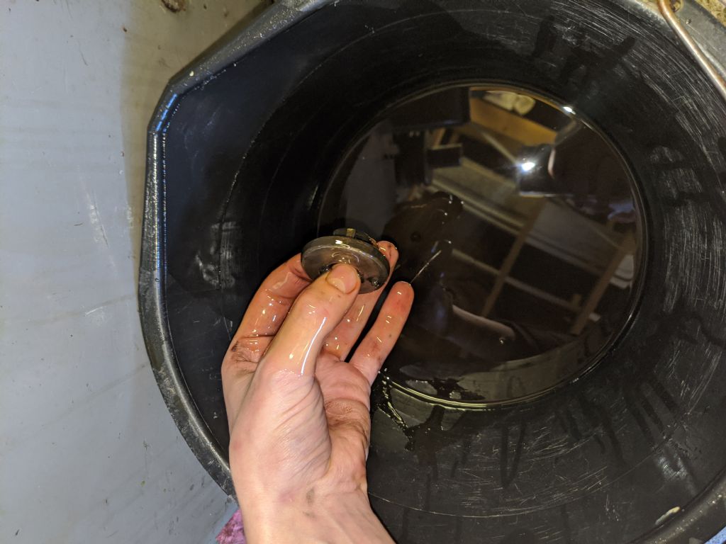

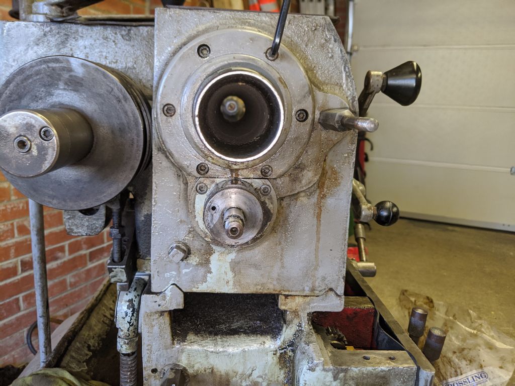

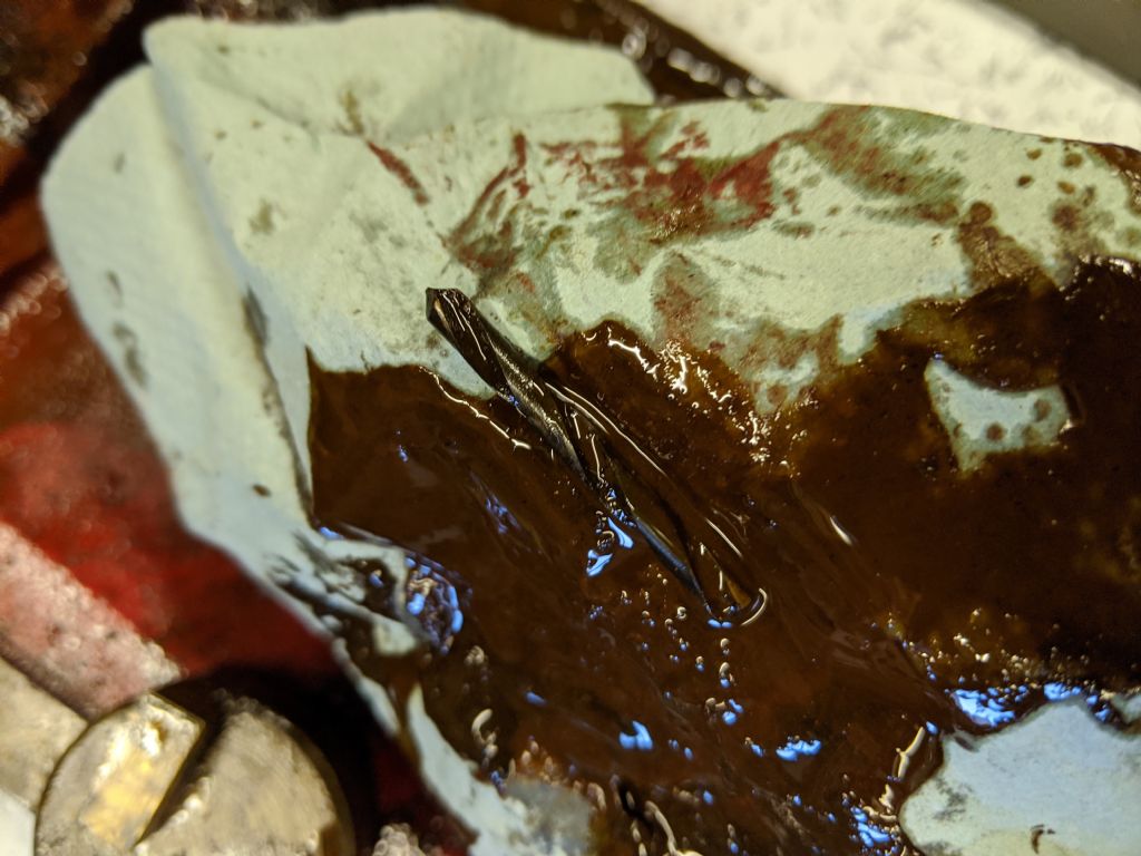

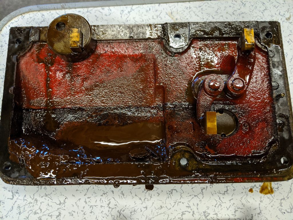

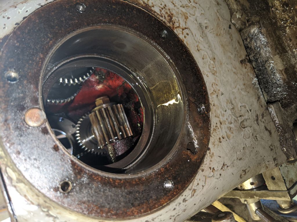

          Little break from electronics, I have started on the gaskets finally. Or disassembly at least…
          Definitely not the same colour as when I put it in, I kept reusing the oil to try to flush the headstock a bit, but i still need to get in properly and give it a good scrub
          The gearbox was absolutely full of crap, I even found a drill bit in there. There was so much gunk that it was probably reducing the actual amount of oil I could put in significantly.
          Not perfect, still needs a good scrub, I've left it covered in degreaser
          This was after I'd cleaned it a little, the bottom was full with nutella sludge up to about the top of the black bit with lots of holes in it. So progress has been made. The gasket didn't seem to be in too bad shape, but I'll still replace it.
          Contactor should arrive tomorrow so I'll post pictures of that when I get it.
          Also, I think the sight glasses could do with being replaced, can't seem to clean them

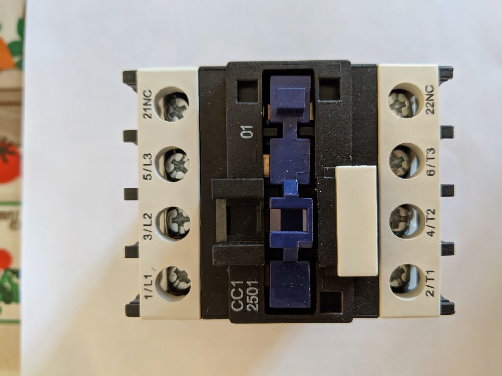

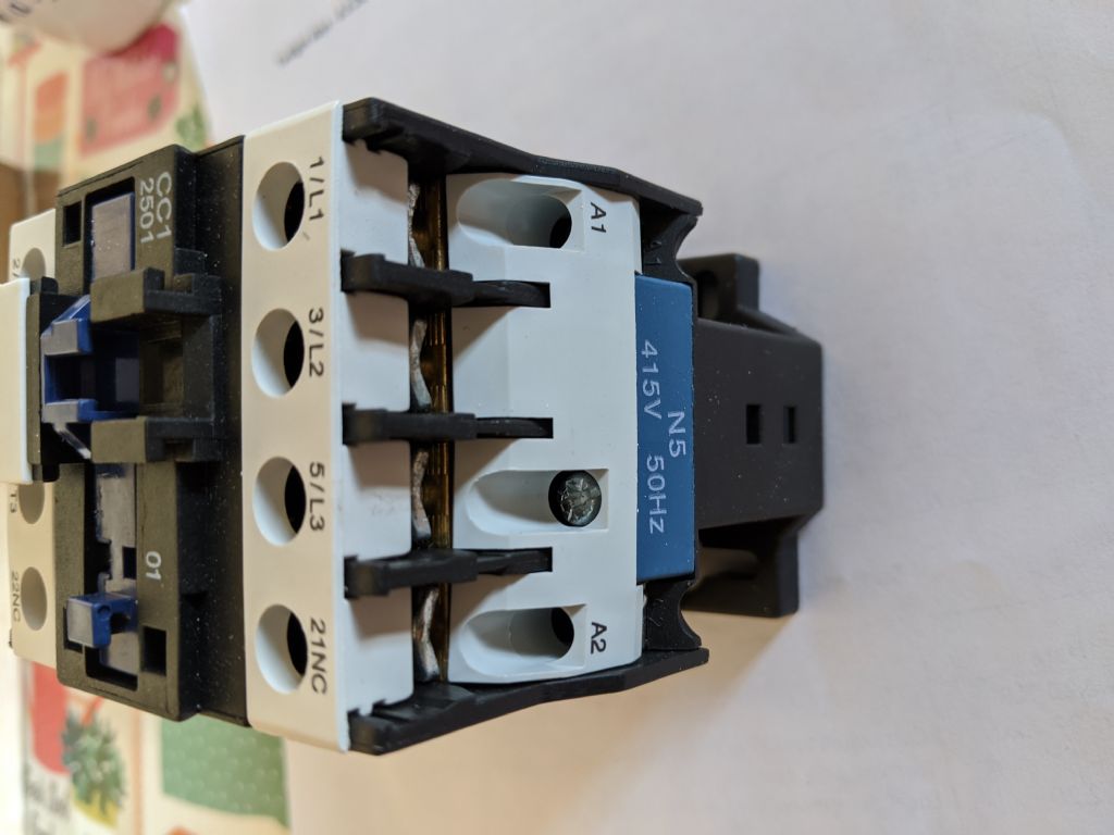

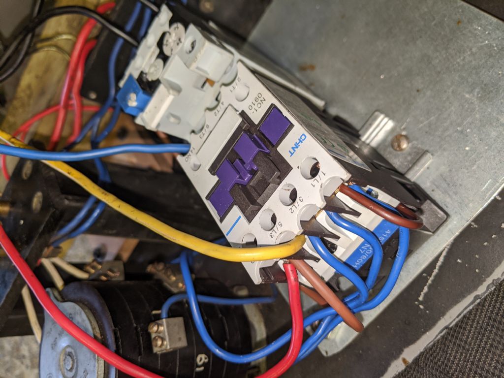

            Contactor arrived
            So, where do I need to stick the wires in?

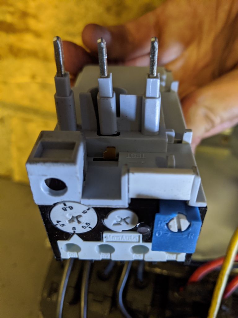

            The overloads will go into the same part as before. but will the motor wires go back into the same L1 L2 L3 as before too?

                Hi Richard, First off, I am confused!! the terminals 21 &22 should read NO, not NC, but I am hoping this is due to chinese confusion in terminology. put a multimeter across them, there should be no connection until you push the contactor down, if this is the case, they are NO, and have been labeled incorrectly.
                Connect the incoming three phases from the rotary switch to L1 L2 and L3 fit the overload to the contactor to T1 T2 and T3, connect the motor wires to the three outputs from the overload
                on the contactor, put a wire link betweenA1 (coil connection) and L1.
                put a link from A2 (other coil connection) to one of the NC connections on the overload (Need a pic of the overload connections!)
                Put a link from the other NC connection on the overload to one of the NO connections on the contactor holding in contacts along with the red wire from the C&D limit switch
                Connect the blue wire from the C&D limit switch to the other NO connection on the contactor.
                Connect the yellow wire from the C&D limit switch to L3 on the incoming side of the contactor.
                With the end cover fitted, and the key switch on, check continuity between L3 and the yellow wire in the C&D limit switch, this confirms that the switches are working.
                power up the lathe and lift the stop/ start handle, lathe should start and continue to run.
                Press down stop start handle, lathe should stop.
                start lathe again and turn off mains power, lathe stops.
                turn on mains power, lathe should not restart until stop/start handle is moved to stop position, and then back to start.
                This is a peliminary instruction set!! I need to confirm that the contactor connections marked 21/22 are actually NO, and close when the contactor is energised, and also need a pic of the connections on the overload to confirm the connection designations.
                BTW! if you get it wrong it will simply not work As long as you have got the coil connections correct!
                I need to go lie down for a bit!
                If you compare the above instructions with the wiring diagram I did earlier in the thread, you will see they are in compliance.

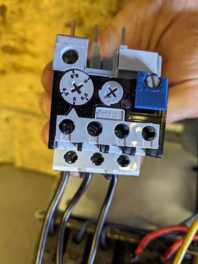

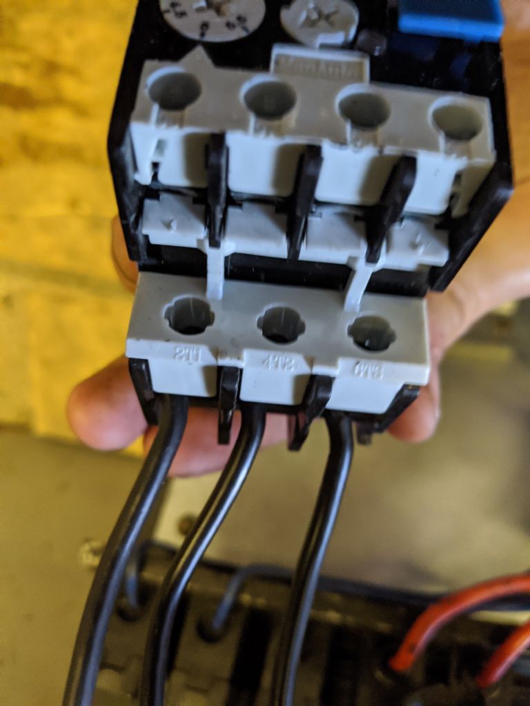

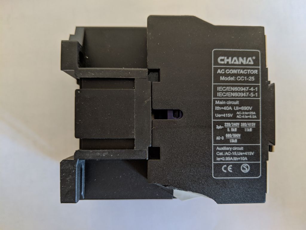

                  The 21 and 22 have continuity when the contactor is NOT pushed down. So they are normally closed? Hence the NC? Is this a problem?
                  The listing for the contactor stated this "Chana CC1-2501 3 Pole Contactor with 1 normally closed auxiliary contact on body of contactor, 2NO auxillary contacts supplied loose to fit on top of contactor. "
                  I'm not sure what it means by auxillary contacts supplied loose to fit on the top, but I didn't receive anything else in the box?
                  Overload pics coming right up
                  #459797
                  Richard Kirkman 1
                    @richardkirkman1
                    #459805
                    Richard Kirkman 1
                      @richardkirkman1
                      I suspect I've just bought the wrong contactor againblush At least I'm learning, hopefully it doesn't frustrate you too much.
                      Do I need to get one with NO?
                      If so, I'll order this one right away and return the other
                      **LINK**

                        Hi Richard, Yes, swap the contactor for one with a NO contact. Pity you didnt get the auxillary contacts supposedly "supplied" with it, as they would have done the job. turn the overload screwdriver switch from manual to auto. this means it will reset automatically when it cools down (although in practice it will probably never, ever trip) on the overload use 95 and 96, connect a link from the A2 coil connection to 95 and then put a link from 96 to one of the contactor NO contacts, along with the red wire from the C&D limit switch, if you follow the instructions, whilst looking at the wiring diagram I drew, it will make more sense! after this carry on as above! I bet your 3 phase hook up is on hold now! never mind, we will get there!

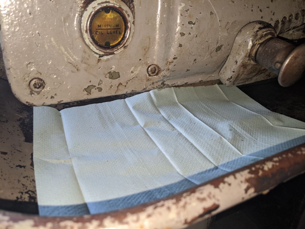

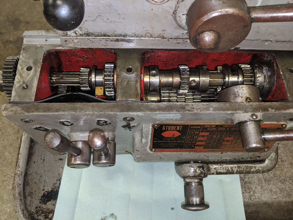

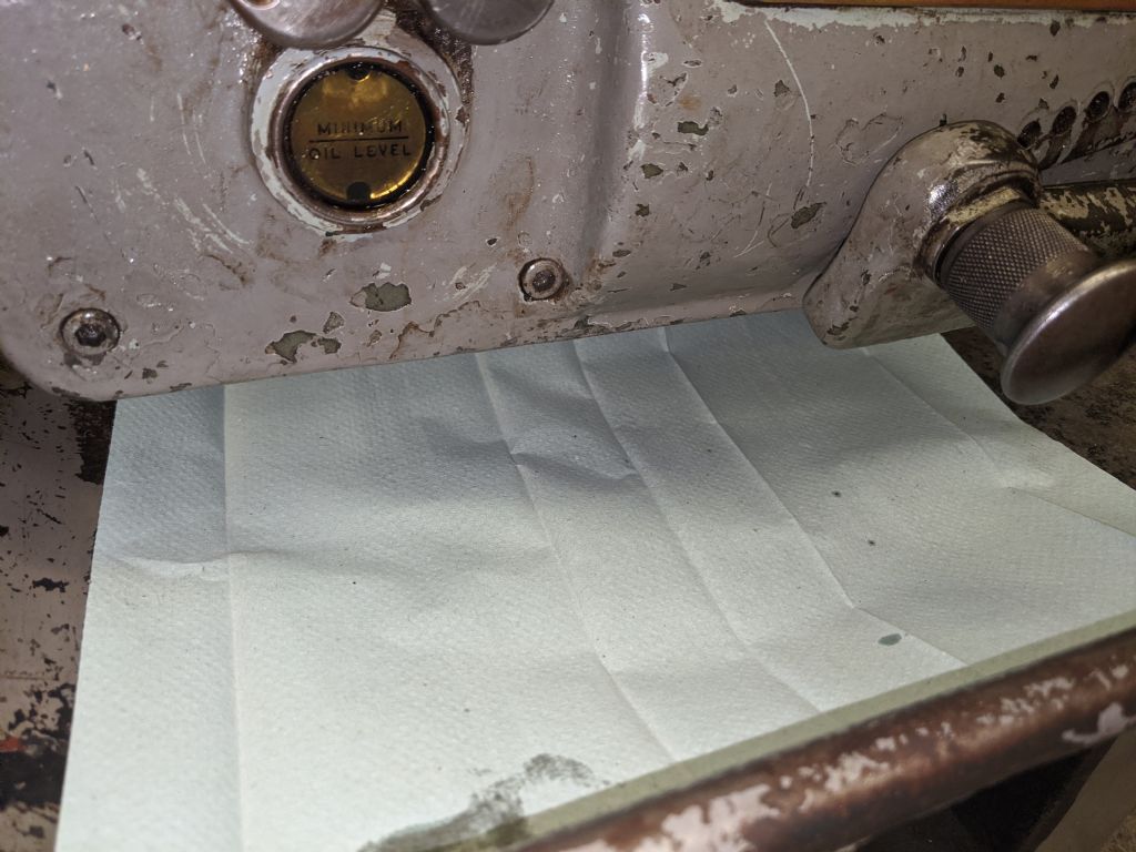

                            I just finished putting the gearbox back together. Cutting the gasket was very easy since the old gasket was still in decent shape.
                            I've filled it back up with some old oil I had from the last time I filled it up, hopefully this will stay in this time. However, I will empty it out again and put in the proper tellus 41/Iso100 oil that's needed, I'm just using this oil to check for leaks.
                            I've cleaned everything up and put a paper towel under it, so leaks should be very easy to spot. I'm hoping for the best, only time will tell. 1 gasket down, 3 to go.

                                  I don't seem to have any leaks this morning, But, I'll leave it sitting for another day or two before I flush it and put the correct oil in.
                                  The nitrile seems to be doing a good job. I think the old gasket was paper.
                                  My cover was also quite tight, but did go back on eventually. I expected it to be a lot harder.

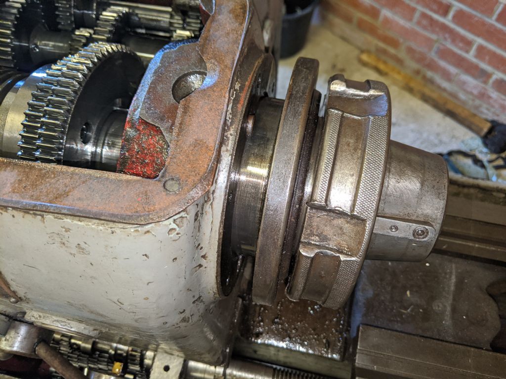

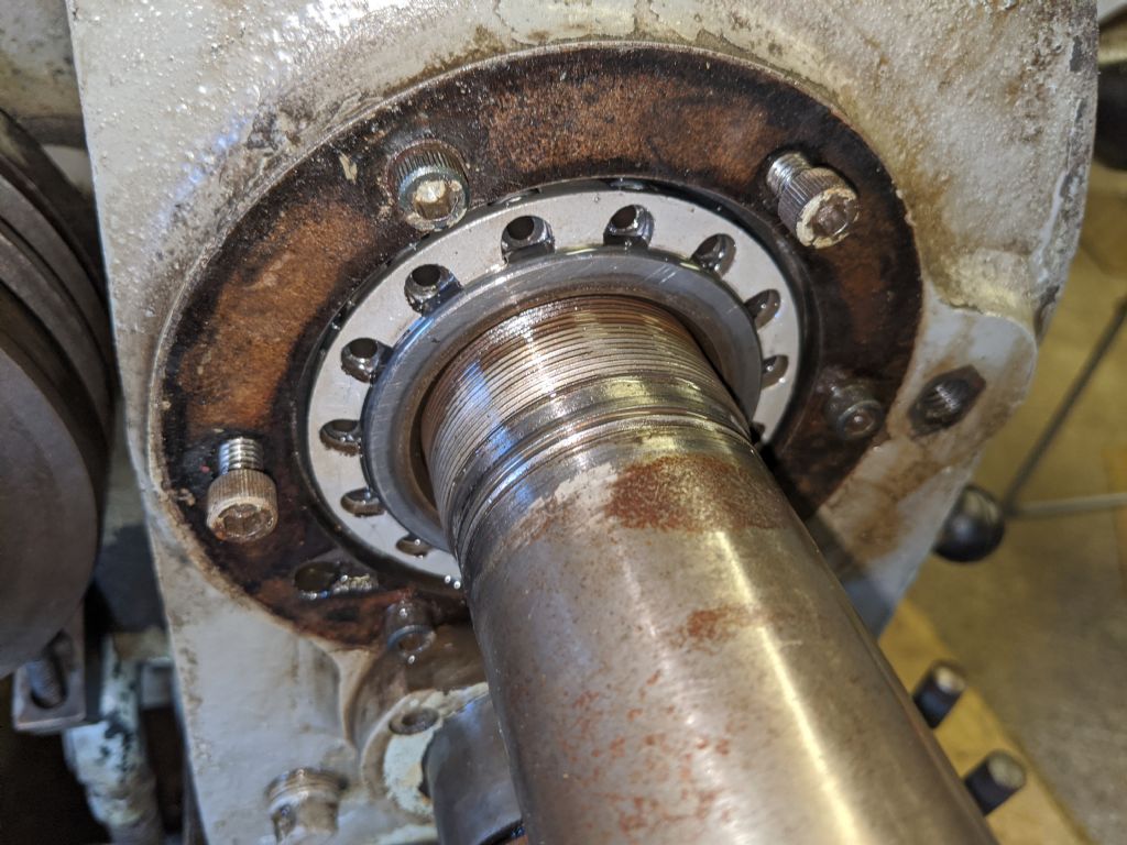

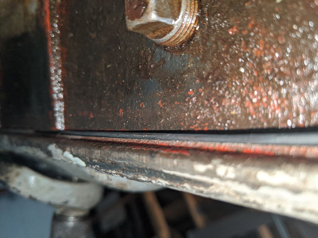

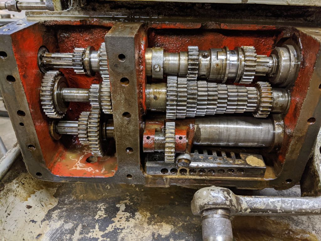

                                          After a full day of oil sitting in the gearbox, we have a leak. The gasket is absolutely fine, nice and tight, but I must have not tightened the drain plug in the bottom tight enough as oil was leaking out of there.

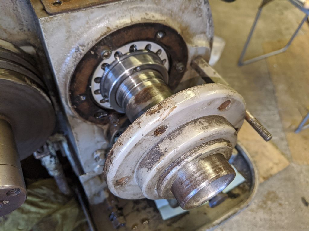

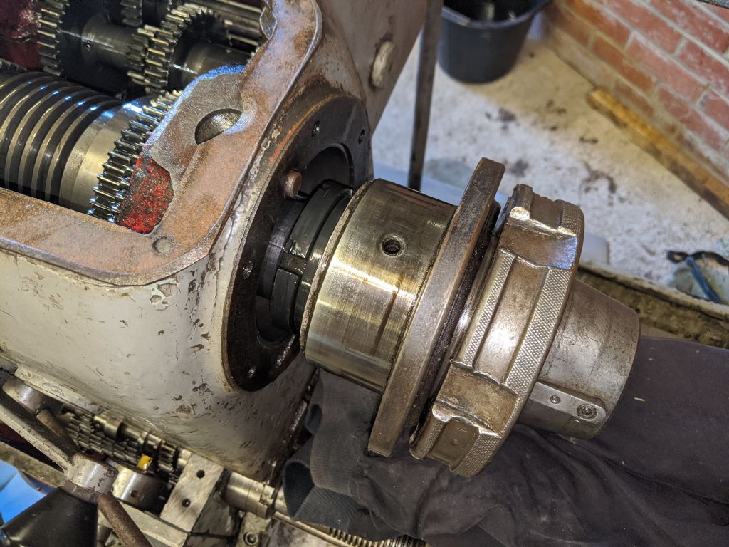

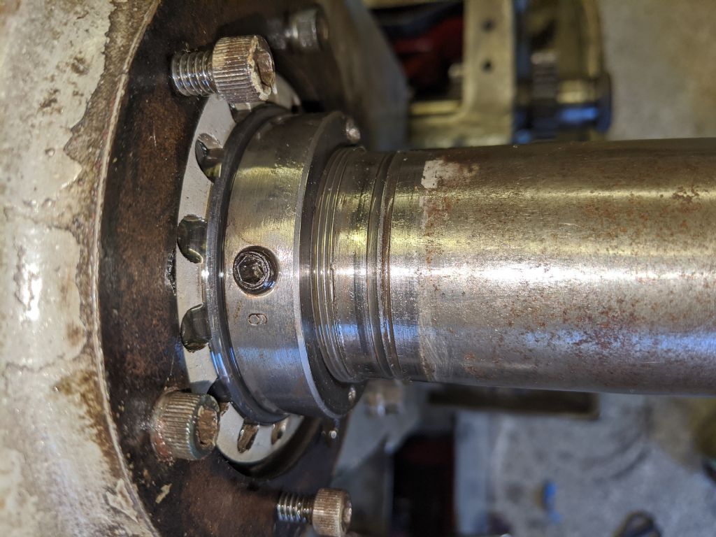

                                          I started to take the main spindle out again today so I can replace the gaskets.
                                          So, first step, remove the gears from the end of the lathe. It's essential that you keep a bucket of the old headstock oil right below what you're doing, so when you drop your parts they land in there.
                                          Then you need to remove 3 of the 6 end screws in the top plate. Only the 3 that are protruding more. As the others are through holes

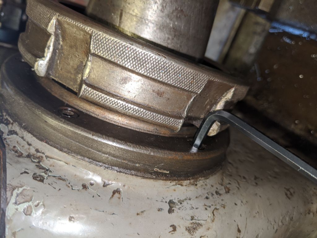

                                          Then undo the grub screw in the collar and twist it off using the two holes in the front. I just used a pinch to twist it off as I already did that last time, but the proper tool would be much better
                                          Then once that collar is off, that's that end free. So you go to the chuck end and start to take the bolts out there
                                          The locking ring for the L0 taper has different slots in it so you can get a hex key in there. Much easier if you have ball ended hex keys
                                          Once they're out, the spindle can be tapped out with a block of wood. Once the head comes out of the bore, make sure to hold onto it as you tap it the last bit.
                                          Then the gears slide off the spindle as you pull the spindle out.
                                          Then there are some locking nuts on the front part which I presume holds the bearings in somewhere but mine are fine so I'll leave them be.

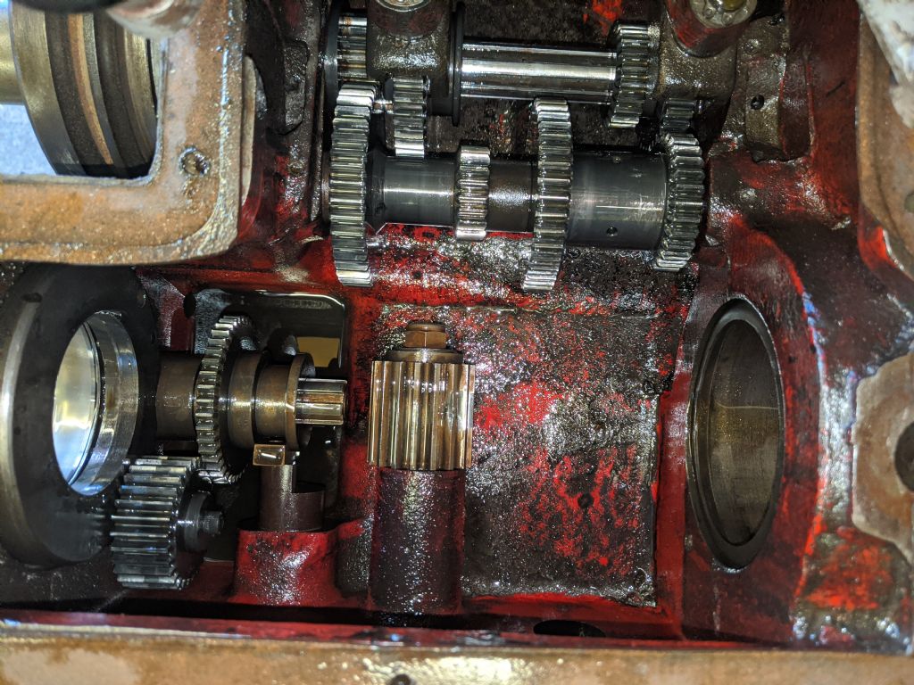

                                          Inside is really grimy, I didn't realise how bad it was last time I took it out. I've started cleaning, but it's taking a long time.

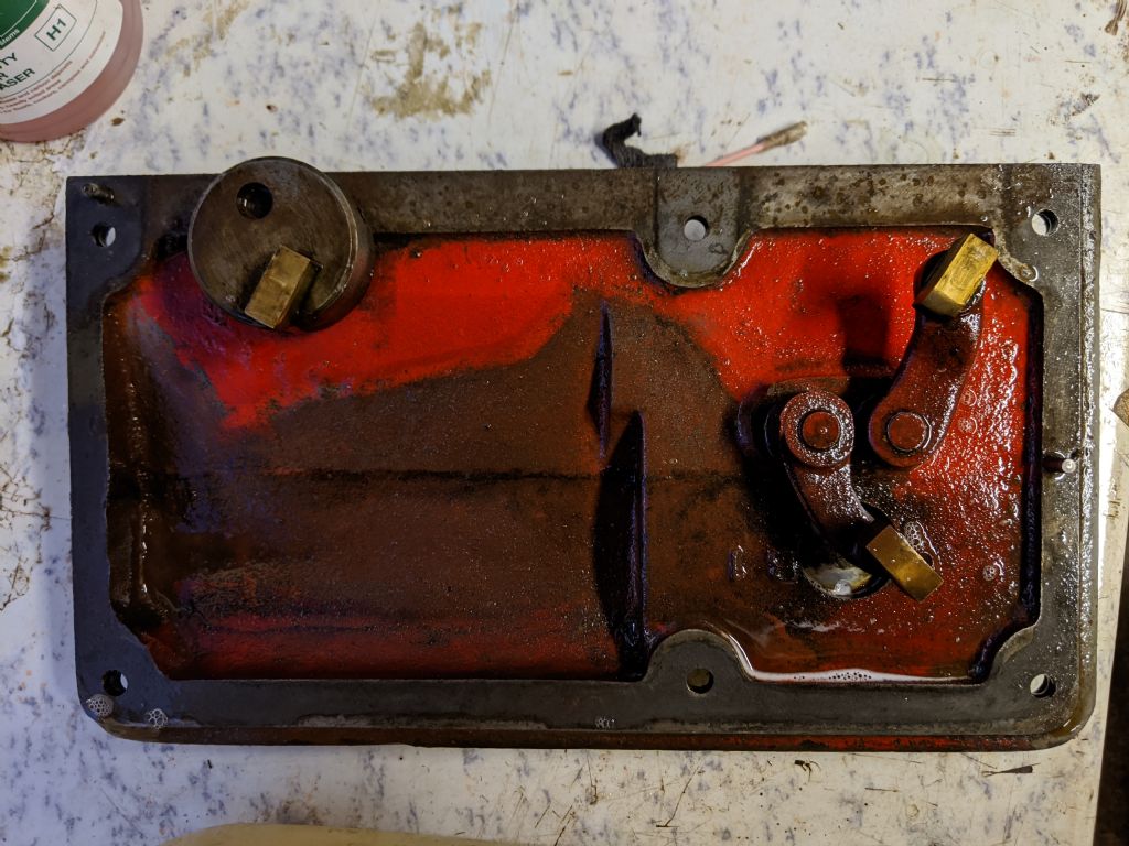

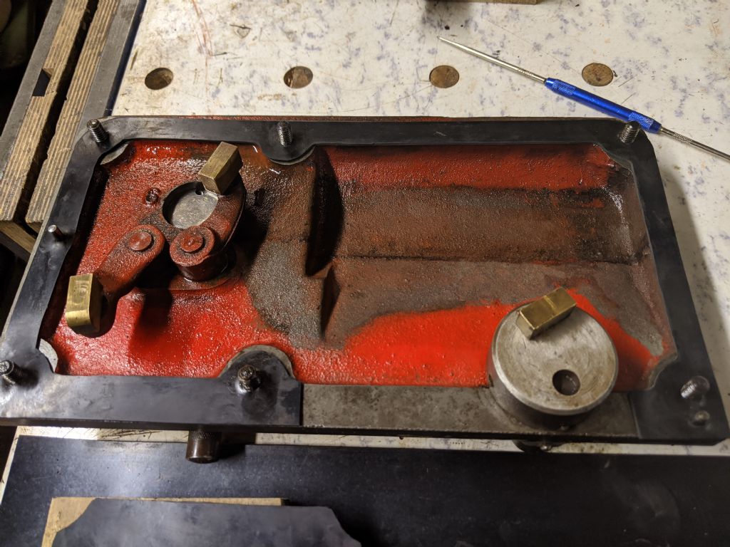

                                          I cut the new gaskets using the old ones as templates. I used my dividers to actually cut out the circles as they were just sharp enough to cut the rubber
                                          Old vs new
                                          I noticed that it was leaking from the high low speed selector at the front of the lathe, so i made a new leather gasket for it a while ago. Finally took it to pieces and the old one was pretty much gone. The new one is a very tight fit on the shaft so should hopefully seal nicely.
                                          Still, lots of cleaning inside to do, then reassembly, and that should be all as far as oil and gaskets go.

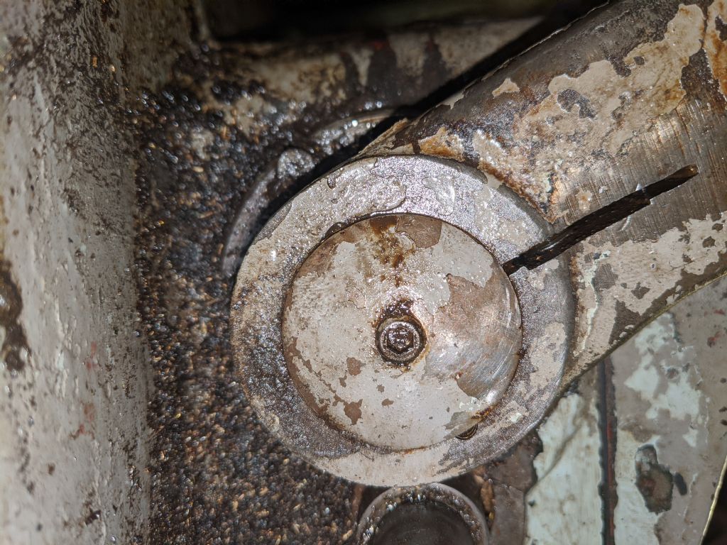

                                          As for the tumbler arm, I had a good look at the end for the dutch key, since I remember you mentioning it when I was looking at your lathe. But the only grub screw I could find was in the middle of the shaft. I'll look again tomorrow

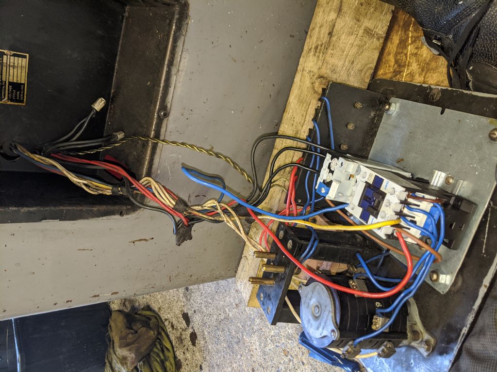

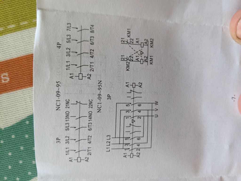

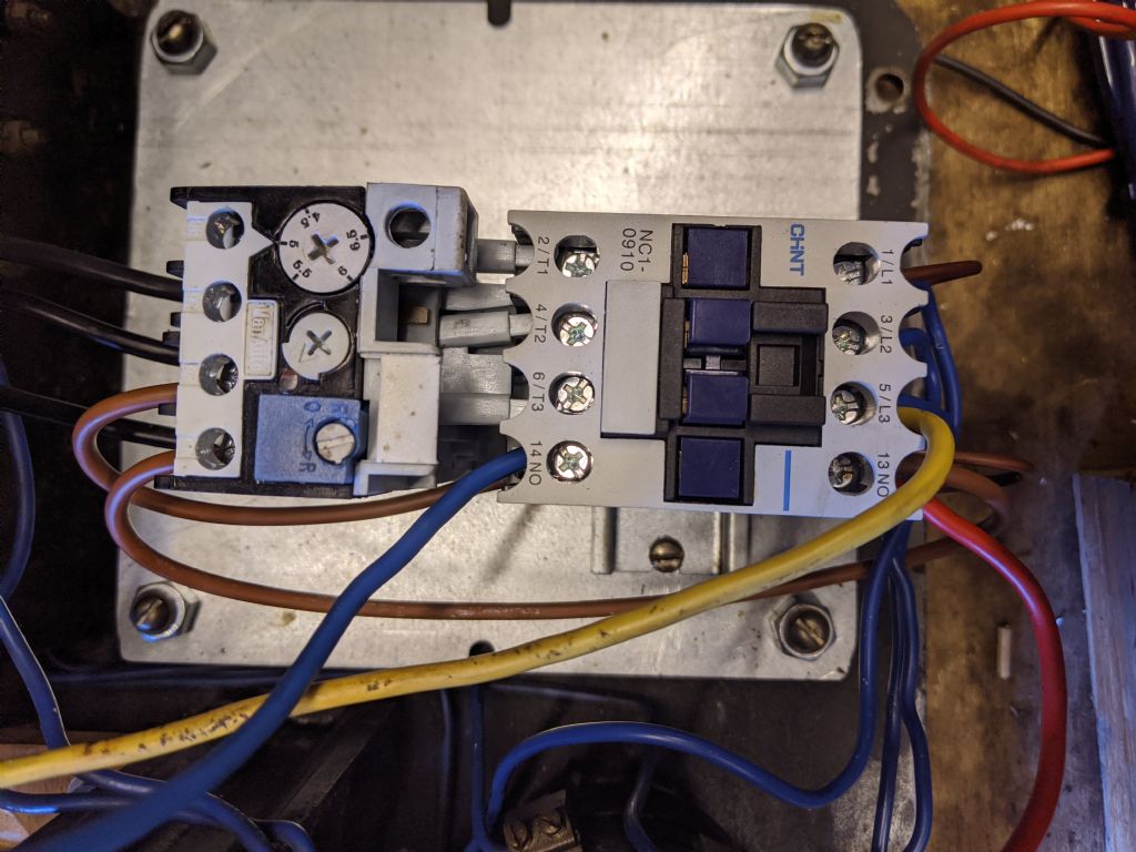

                                            Finally got some wiring diagrams with this contactor, 3rd time lucky. I'll go and wire it as directed in Phils messages
                                            #460441
                                            Richard Kirkman 1
                                              @richardkirkman1

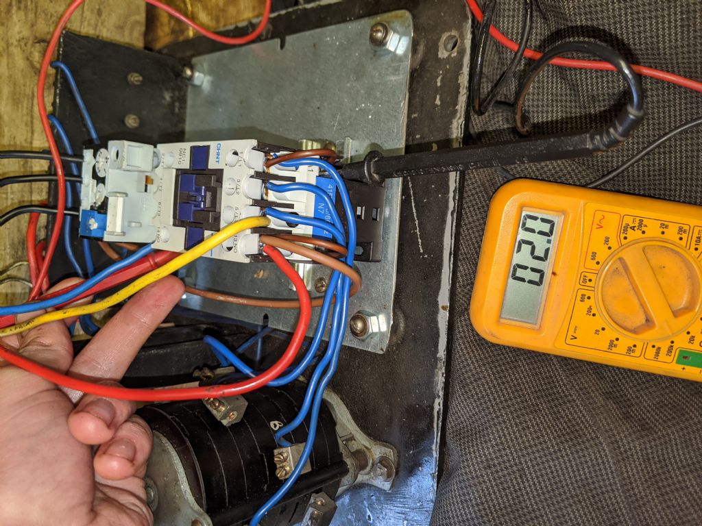

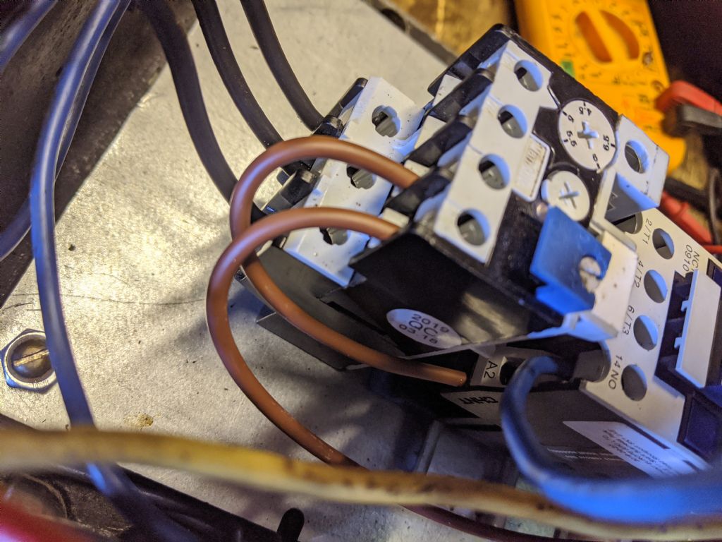

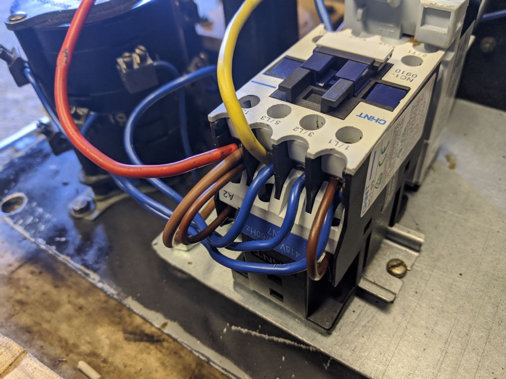

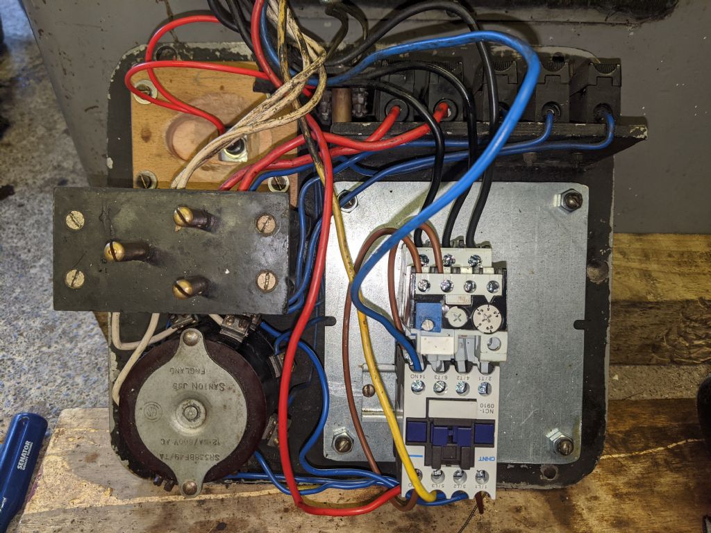

                                              Alright, all wired, as far as I could work out from the directions in the long messages.
                                              Please can this be checked over meticulously as I'm not confident that I did it correctly
                                              I checked the cnd switch for continuity with the yellow wire, the safety circuit is working.
                                              Thanks

                                                Hi richard, the dutch key is in a hole which is drilled between the steel shaft and the cast handle, half the hole is in the shaft, and half in the handle, and it is usually full of grime so you cant see it. I am looking at the wiring now, I will get back to you on that presently. Thanks for the pics re spindle removal, that gearbox heeds a good flush out!

                                                  #460467
                                                  Phil Whitley
                                                    @philwhitley94135
                                                    Hi Richard, We have one two many A2 connections! If the A2 terminal on the overload end of the contactor is common with the one on the other end (multimeter check, look for the same resistance between A1, and either of the A2 connections. and check with the contactor pushed down to make sure that it is not switched by the contactor) then it is a common and we can use that one. Remove the link between the other A2 connection and the 13NO(the one with the red wire in it) There is confusion here, because the two wiring diagrams refer to NC-09-95 and NC-09-95N and your contactor is an NC-09-10, an example of Chinese inscrutability if ever I saw one!
                                                    Alternatively, you can use the A1 and A2 connections on the same end of the contactor, and wire from that A2 to the NC on the overloads, then from the other NC overload contact to the 13NO. there should be only two wires at this connection, and it should not be linked to A2.
                                                    This sounds a lot more complex than it is!, referring to the diagram will make it easier. You only need use one of the A2 connections, as the coil only has two ends, one end goes to a supply line (A1 to L1) and the other end goes into the switching and safety circuits and uses them to get back to L3 via the yellow wire, and when L1 and L3 are across the coil the contactor pulls in, and the motor starts. rewire it like this and post more pics! Tedious, but then, what else can we do in the present "interesting" times?
                                                    Phil
                                                    Edited By Phil Whitley on 28/03/2020 15:12:47
                                                    #460485
                                                    Richard Kirkman 1
                                                      @richardkirkman1
                                                      I've removed the link between A2 and the 13NO as suggested
                                                      I think I understand what's going on, but I was confused by there being two A2 points.
                                                      I used a multimeter and the resistance was the same for A1-A2 and A1-otherA2
                                                      Is this wiring correct now?
                                                      Now just two wires out of that one

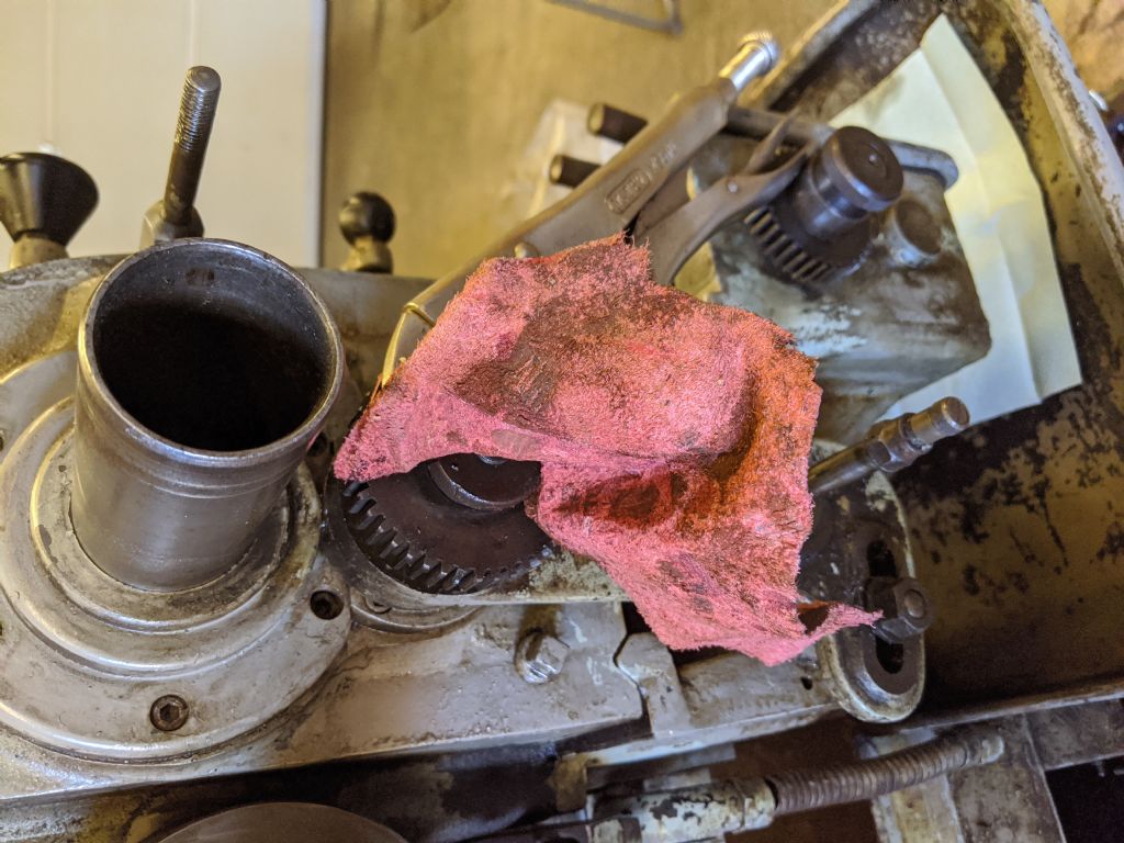

                                                      Lots of pictures, because why not?
                                                      Cleaning the headstock is very nasty work. I keep hitting my hands off the gears in there as I scrub and cutting the backs of my hands. I've just about had enough, but it seems a lot cleaner. I'm currently flushing with the old oil again, then I'll clean it one last time and reassemble. Awfully cold out there today.
                                                      As for the tumbler arm mystery, you tell me if I'm being blind, I can't see a dutch key!
                                                      Looks like there's the starts of the threads on one the actual tumbler arm, but the shaft doesn't seem to have anything?
