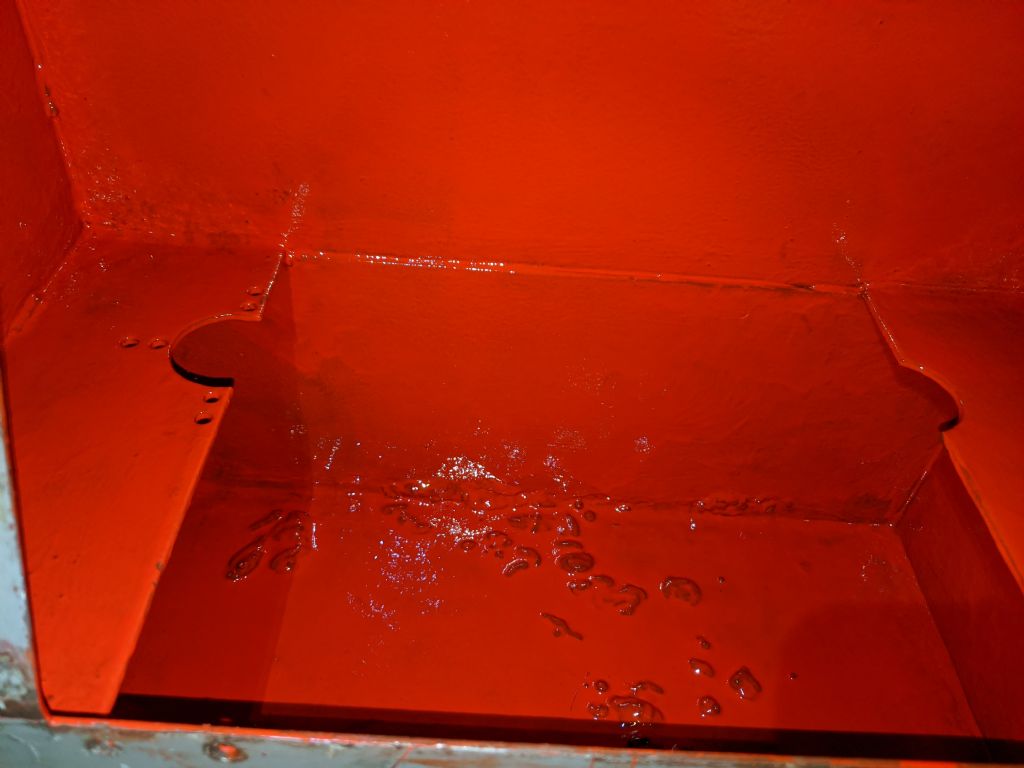

                      I've been to smith and allen today, had a chat with the man behind the counter to see what he recommended. He thought some red oxide primer and then some tractol on top would be fine, so I'll just go with that as my dad can get me some tomorrow from his work.
                      I've welded up the coolant tank, so It shouldn't leak anymore, however it was such a horrible task, welding in such a small box. I cleaned it all and wire brushed it, but it didn't get all the way down into the holes. Still, they're all sealed up and the paint should help. Won't be uploading any pictures though as it was by far the worst welding i have ever done. I did made sure to stick a hoover down the coolant drain below the bed, so that helped get rid of some of the fumes.

                        Red lead is good, and tractol is oil resistant once it has had a week or so to cure, just make sure the tank is clean and dry before you start, as I said, get it hot eith a hot air gun to get rid of any moisture and oil residue. should be fine. I do tend to go a bit belt and braces on these jobs! Good luck with the exams, the country needs good engineers!!

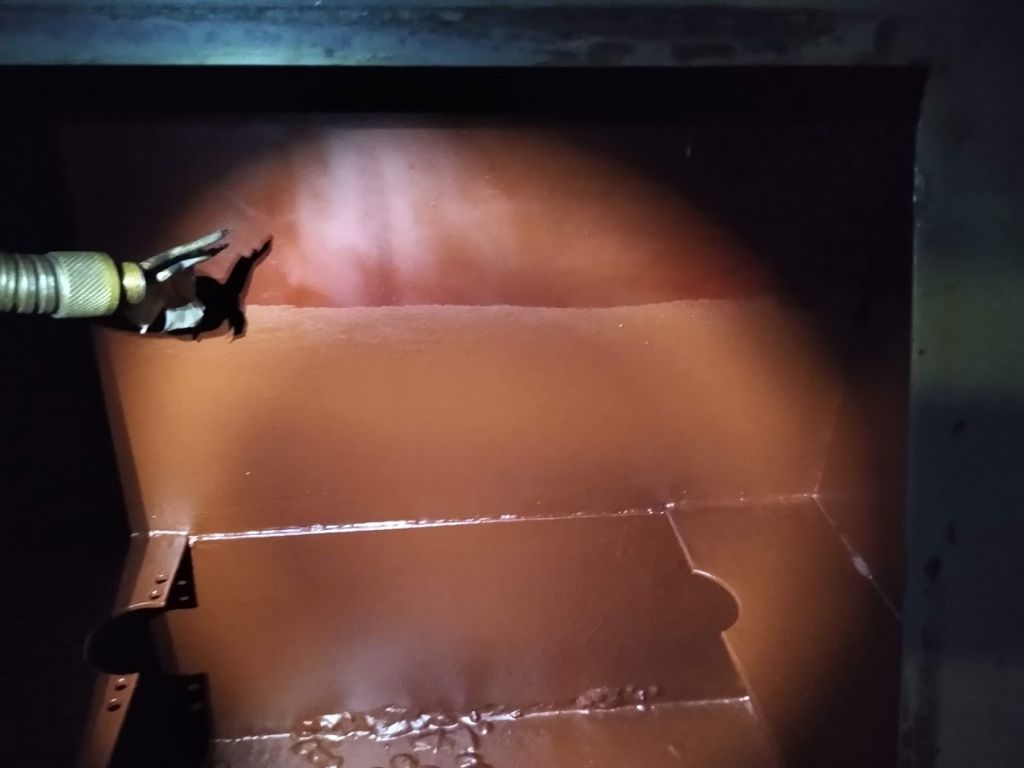

                          Dad brought home the primer this morning (Sigmafast 20) So I gave the tank a good wire wheeling, hoovered it out, then gave it a wipe down, then used a heat gun on it like you reccomended, Then i've put a coat of primer on. It says it dries in 4 hours at 20 degrees, so who knows how long it'll take at 2 degrees in the garage. Anyway, I'm now back at uni, having painted this morning, my dad says he'll put on another coat of primer for me tomorrow, then let that dry and paint it with the tractol for me.

                              Read the data sheet for Sigmafast 20, good gear, that will do the job! I had a 5ltr of yellow zinc chromate primer which lasted for years, it is long gone, but some of the things I painted with it are still yellow and rust free after all these years!

                                3 coats of primer on and dry, Dad said he'd start the tractol today. It's looking decent enough, as the primer has started to cover the welds a bit! However they still looks awful so please ignore them

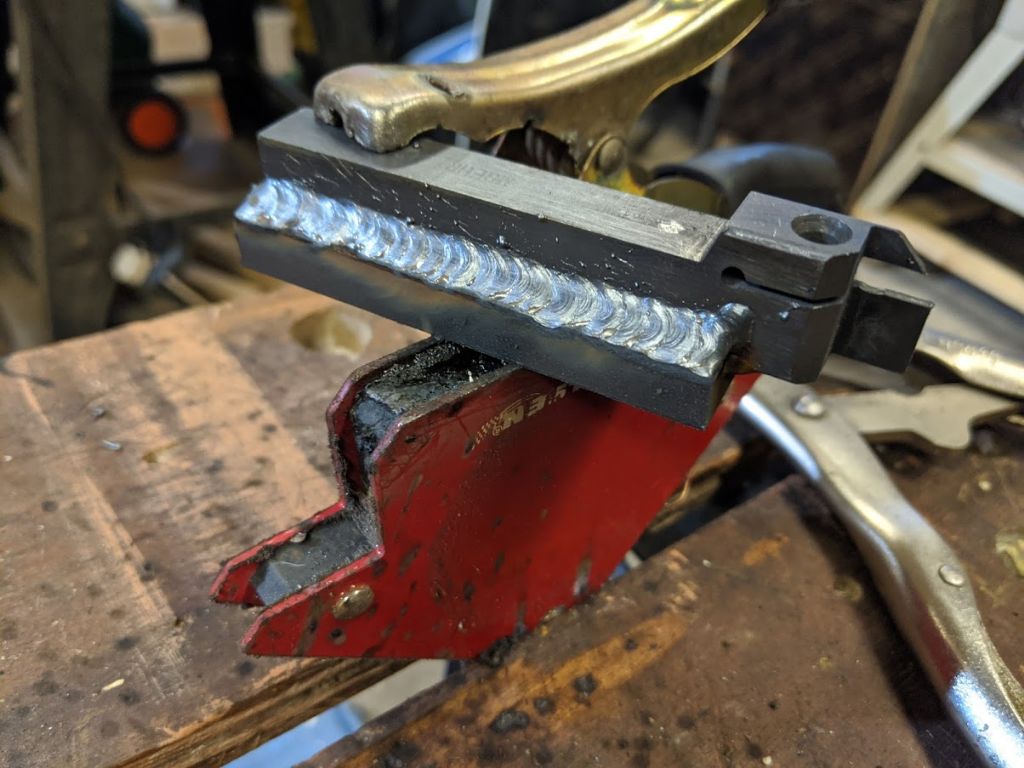

                                              I've also been working on my cheap chinese carbide insert tooling. I've welded on some bar stock to the bottom and now its just around half a mm over center height, so I can grind it down slowly checking the height and getting it perfect without the use of shims. A lot of effort now, but should make tool changing much easier in the future! Just need to grind them all to size, get them to a decent surface finish then cold blue them. A nice little project to keep me busy.

                                                I thought you wouldlike the video, seeing as it has Student roundheads in it! there are several old films about Cochester lathes on YouTube!
