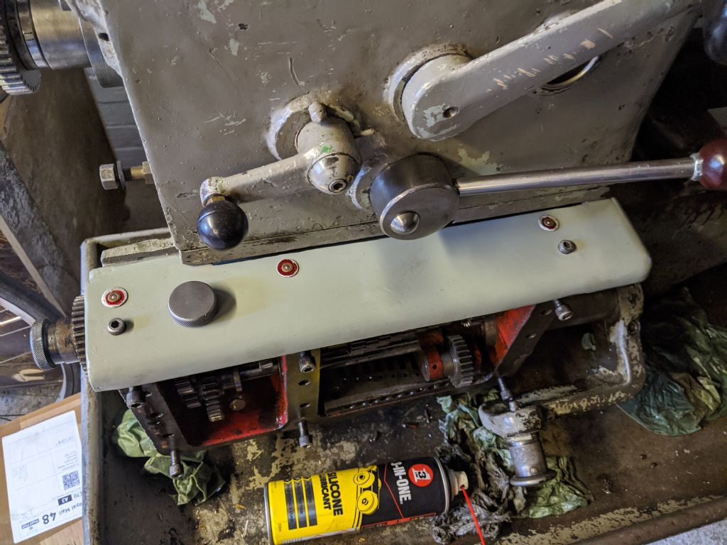

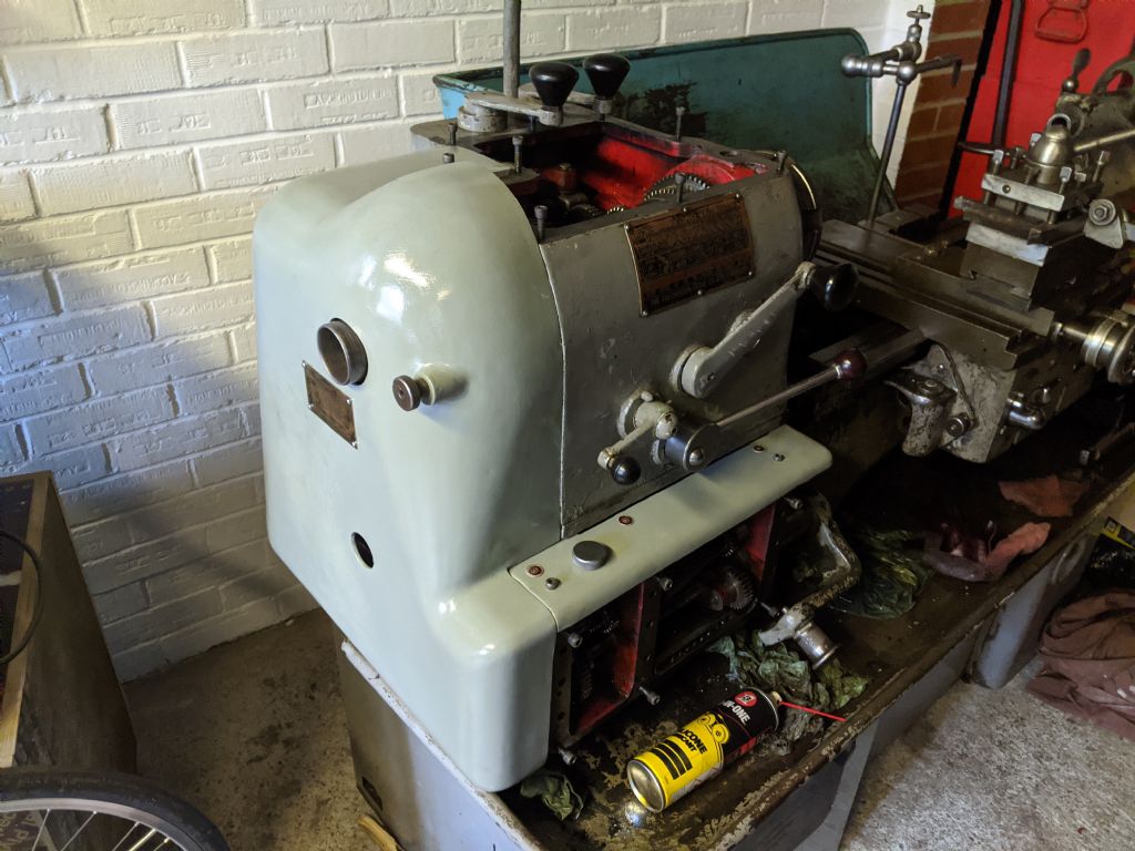

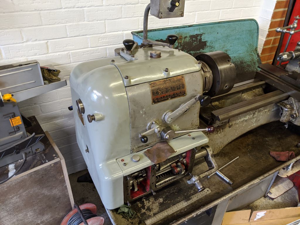

                  Anyway, I've had a quick tidy up and a little play this morning. I've been trying to clear workspace so I can start to make a few things. Need to sort birthday presents for my flat mates… Much better to make them something than to buy. Point is that meant deciding to stop painting for the year completely. No more painting this year. So I had some bits to put back together

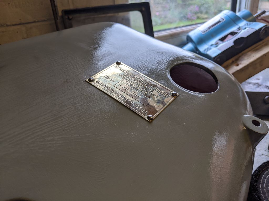

                  First was the gearbox lid. I put all the oilers back in then put the oil cover on too. it's not bolted down fully since it'll need to come off again, but its better to store it there than anywhere else. And yes, the colour difference isn't the best. Definitely not going to have a matching lathe for a year. This may annoy a few, but It will be fully painted eventually. The colour is actually quite different. The new dove grey is much lighter. However, I like the colour and I'm not too bothered about it being an original colour, as long as it looks nice.

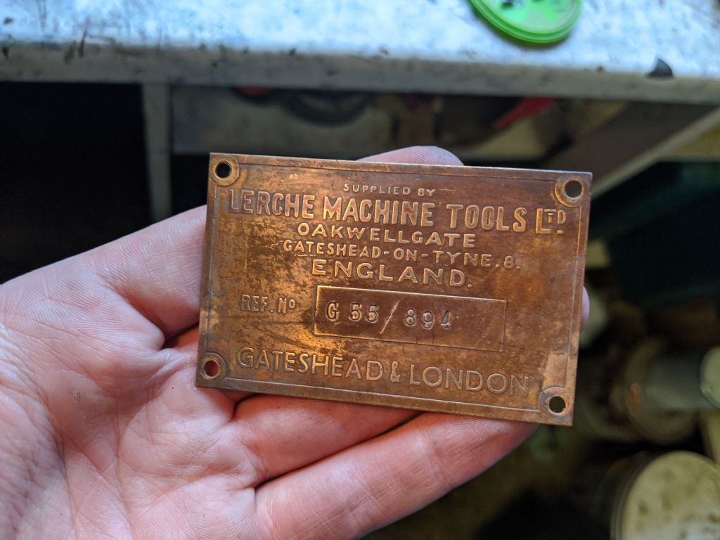

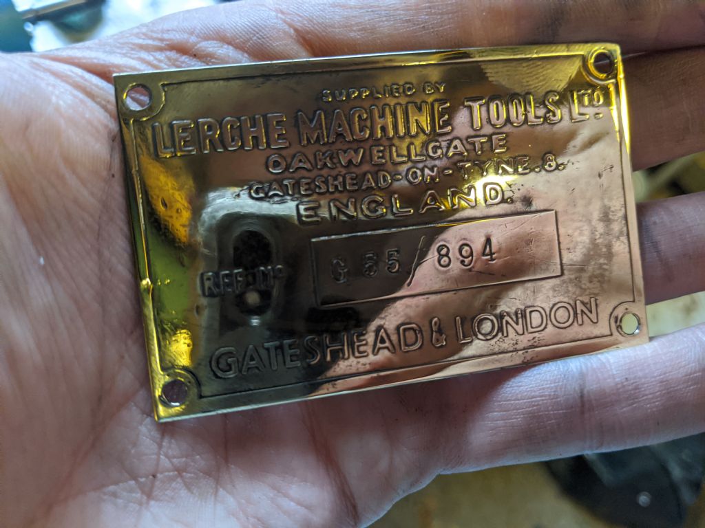

                  Then, I needed to polish up this tag for the end cover. I also polished all the little hammer in pin heads, so they're all shiny too
                  Not that it needed to be shiny, but now it can patina again and look nice for a while
                  And then reinstalled onto the semi painted/unfinished end cover. Once again, good enough for now, but not permanent
                  I really am a fan of the light grey. It's going to look very nice when it's done properly

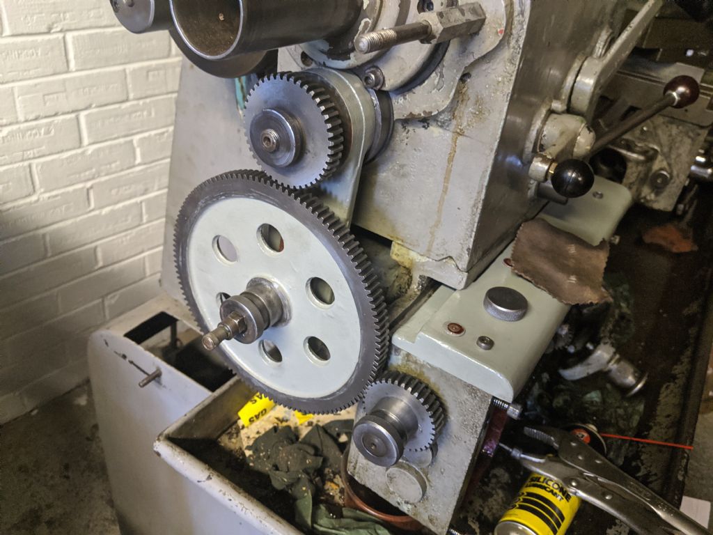

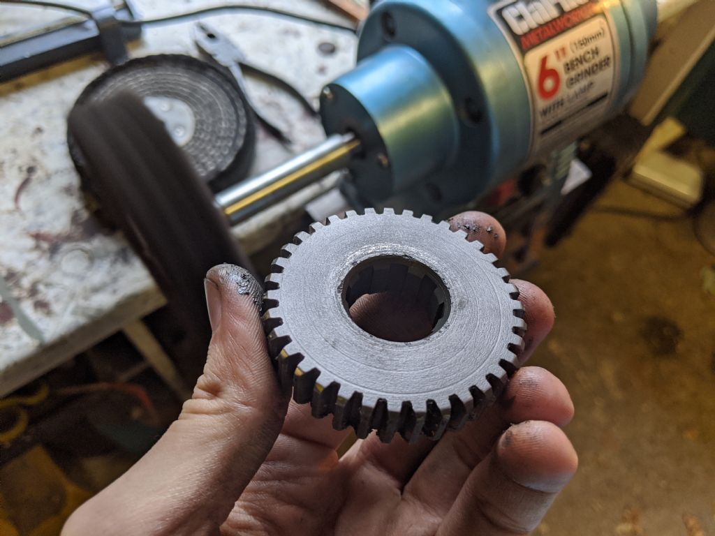

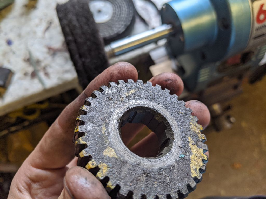

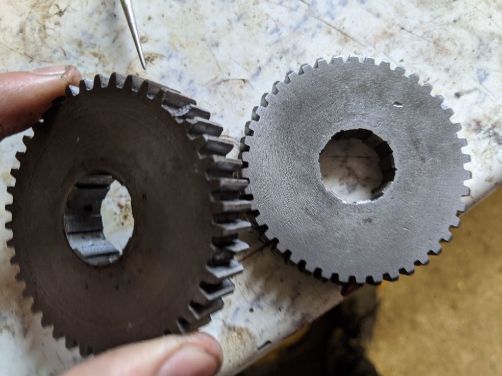

                  Then I cleaned up the gears that I'm replacing

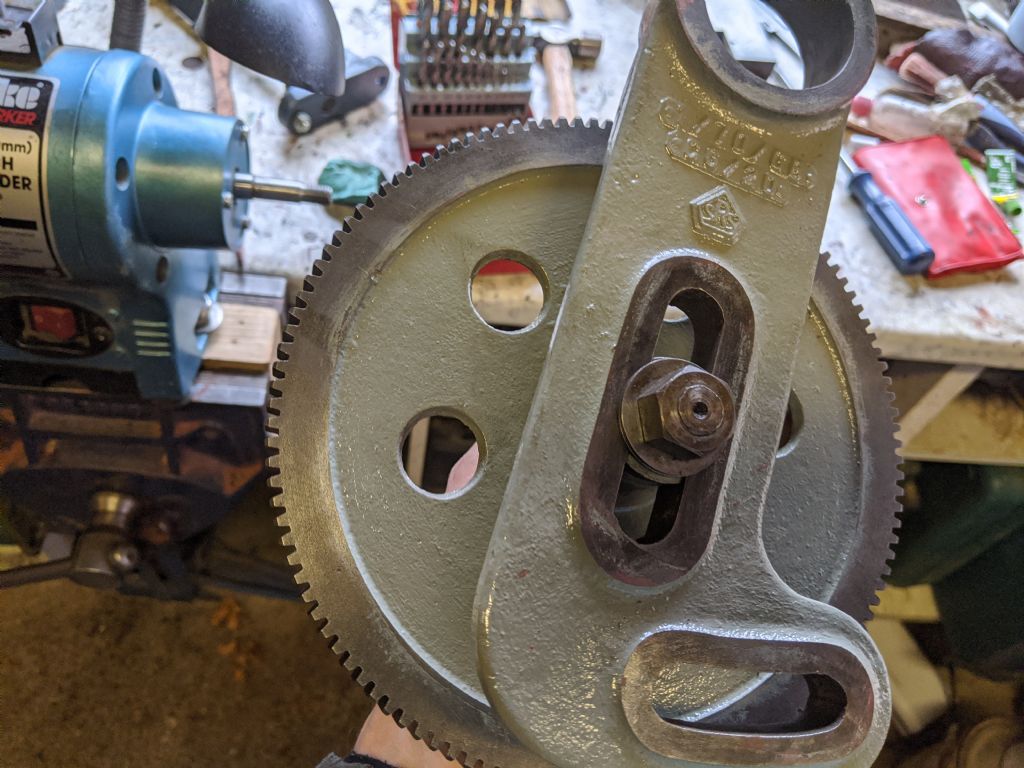

                  I also put my gear back onto the swing frame, so that takes up less space too
                  You can see why I need to replace this gear

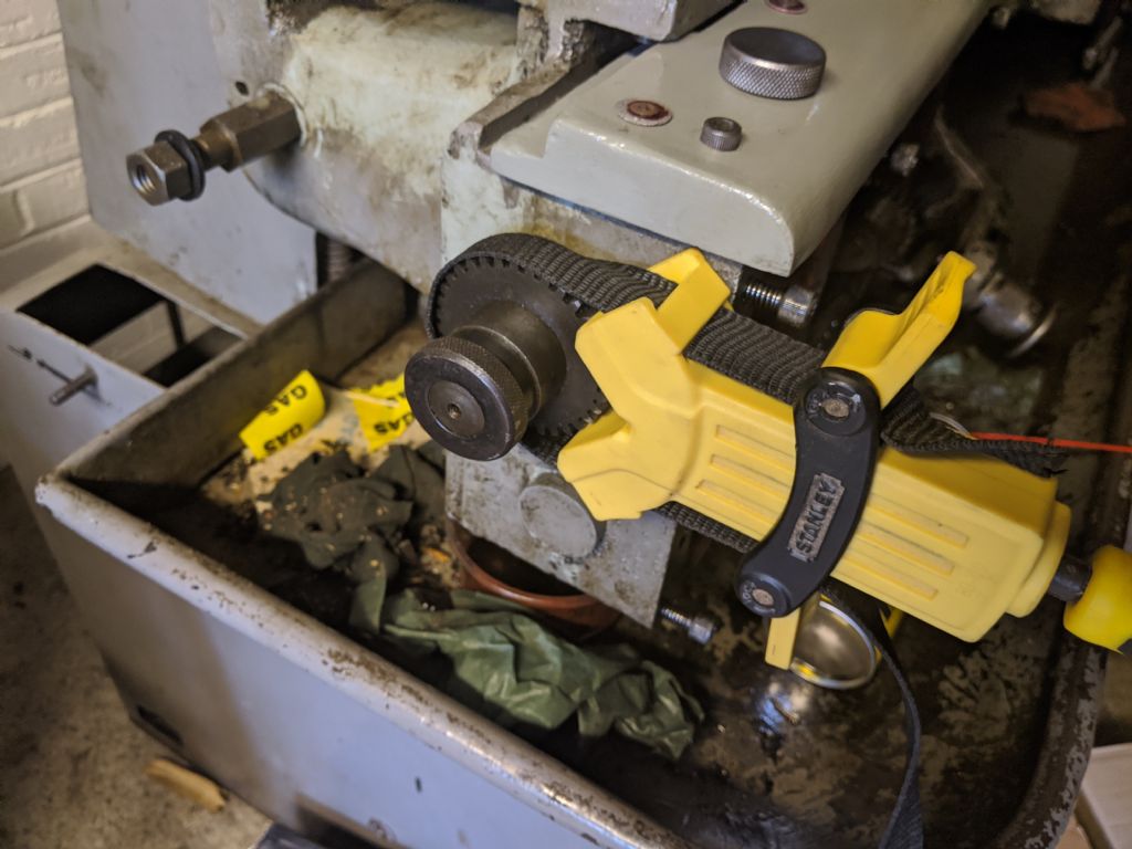

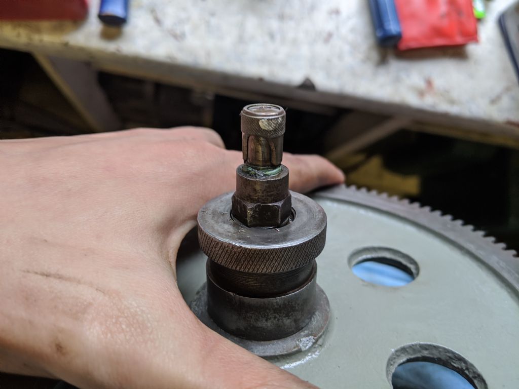

                  However, I cannot seem to get this last gear off. The nut on the end is really tight and I can't get it to budge. That gear is okay, but if i'm replacing the other then I may as well do both.
                  I think I'll probably fit the belts back on next and try to align the motor perfectly with that string method or some way. I need to get it right this time! Since hopefully the oil seal won't leak so it shouldn't have to come off again for a while

                            Posted by Richard Kirkman 1 on 16/08/2020 13:38:15:
                            Edited By Richard Kirkman 1 on 16/08/2020 13:47:02
                            Did you remove the grub screw in the nut? If not, remove it, screw a bolt in there, put a strap wrench on the nut and put tension on it. While under tension give the bolt a wack. Will come loose …
                            If yours does not have a grub screw, drill a hole and use a pin C-spanner to undo it.

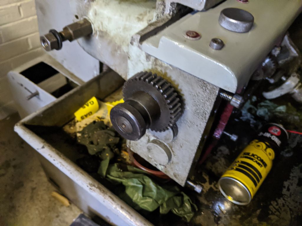

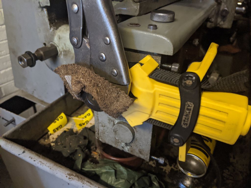

                              A day behind now! I haven't been up to much.
                              I managed to get the knurled nut off with my band clamp and some mole grips
                              Then it popped off quite easily
                              And the gears have all been replaced. No more chipped teeth!

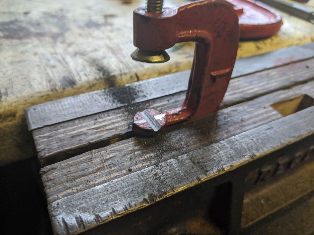

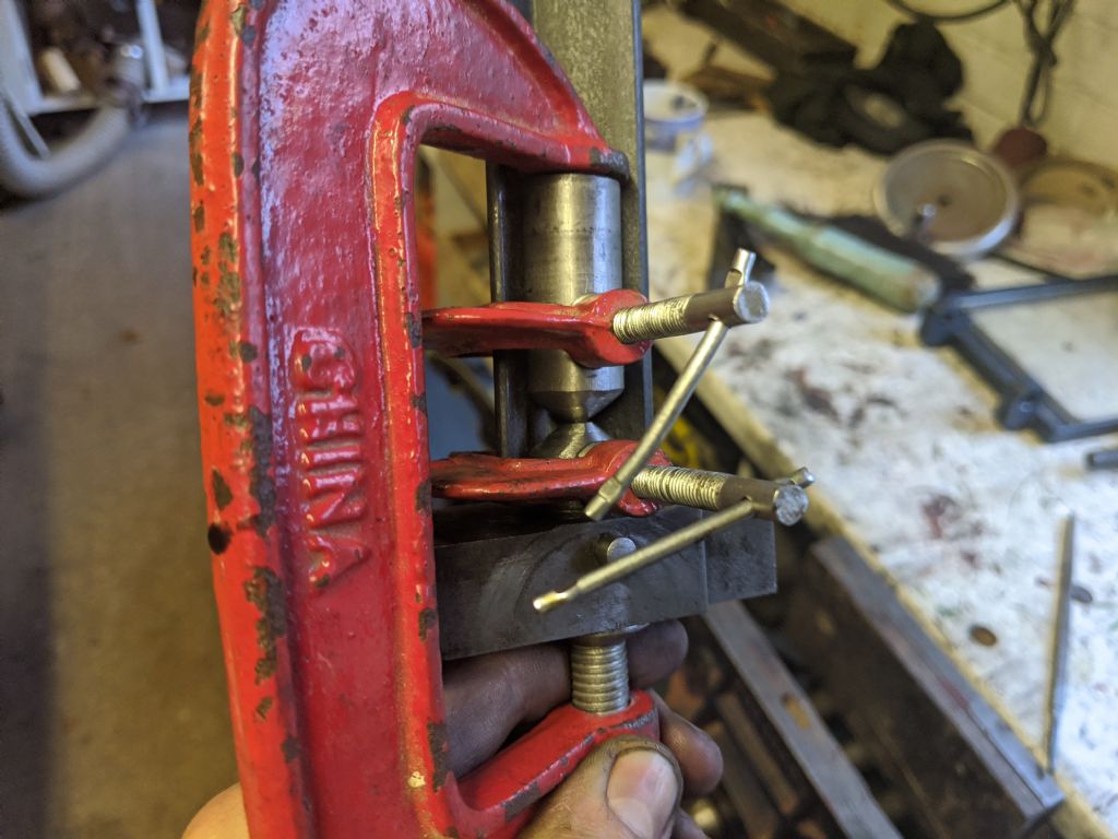

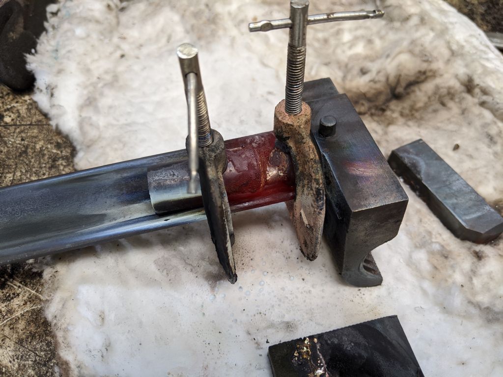

                              Then I got to work on the half nut. I ground a chamfer on each end with a really rough 24grit belt on my belt grinder, it made light work of it. I haven't gone down to a point, as i don't want to take any more off.
                              The little clamps kept slipping and not tightening properly, so i filed a groove for the angle iron to sit in
                              It is very close quarters, so I'm not sure how easy it will be. But they're the smallest clamps that will fit. I can't clamp it any other way and I don't have any smaller clamps. So this'll have to do. Hopefully, I'll be going to braze tomorrow

                                I would remove the big C-clamp. Braze a nut or two in the angle iron with a bolt through it and tension the shaft with this. That big clamp is going to move with heat and it is just simply awkward, huge and made in China.
                                I would still clamp the shaft with a short section of smaller angle iron with the grooved C-clamp riding on the corner of the smaller angle iron. You need stability when things get hot. Remember to wear gators over your safety boots. Last thing you need for some blob of brazing to jump loose and into your boot. This is not welding where you can grit your teeth while your flesh is going up in smoke.
                                Have fun brazing.

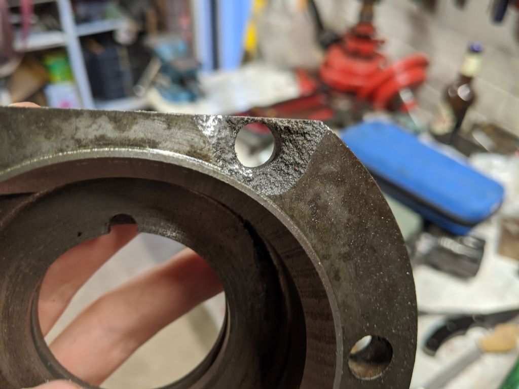

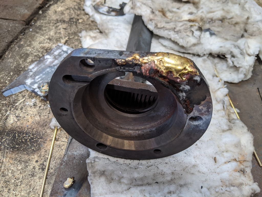

                                  My friend has a very large lathe, its a bit of a workhorse. Although I've never seen him use it! It made my skin crawl, a fantastic machine that just needs a good clean

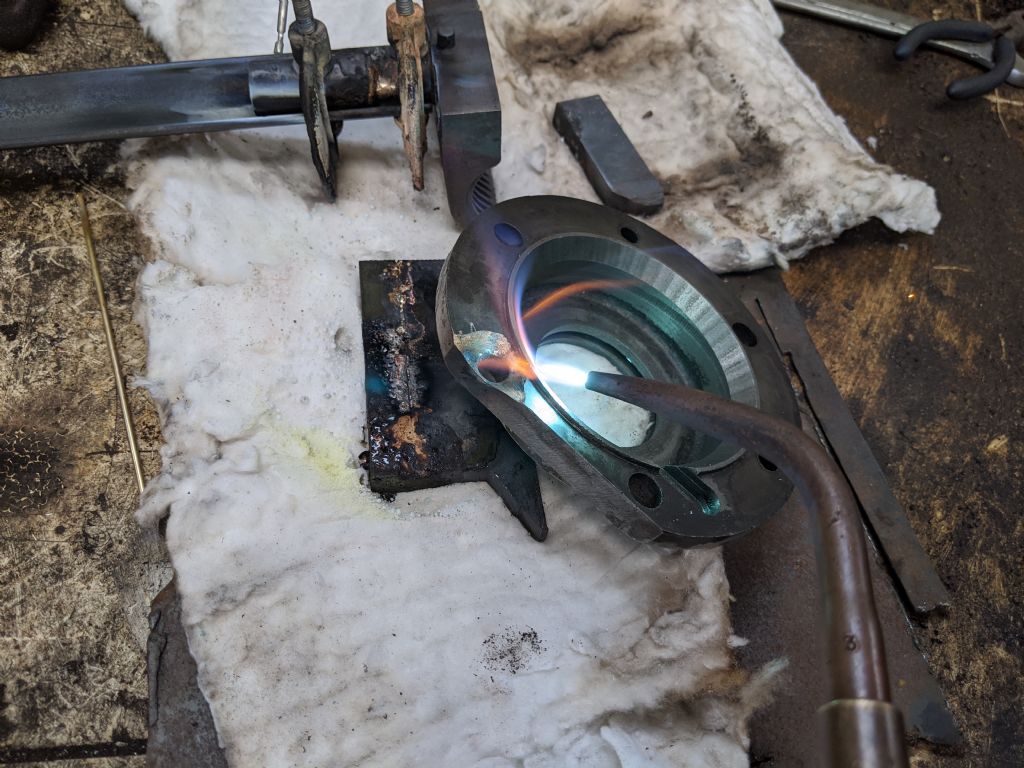

                                  Anyway, so I had 2 things to braze at my friends, the rear bearing housing and the half nut

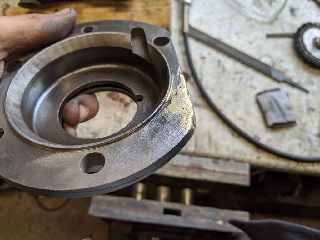

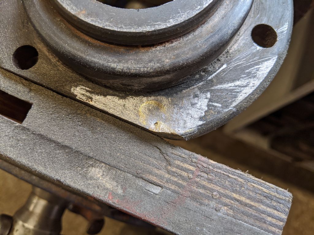

                                  Last night I took the housing and ground down the broken area so it was smooth
                                  So this should all be clean and good to braze
                                  I did a sample on some mild steel, but I found that the mild steel glows differently to the cast iron, so I should have tested on some of that instead. Oh well, I've learned a lot today
                                  I found tacking the shaft to be very difficult, so difficult that I just decided to not bother and just braze it all together, then if it all worked, I would have to clean it up on the lathe anyway.
                                  I found that there was not enough meat on the lower bit of the shaft to clamp it properly into the angle iron, so they had not joined at the right angle. I am not going to bother wasting any more time with this part. I'm just going to wait for the spare one to get here
                                  So, onto the housing. The housing was very tricky since the hole had a very thin wall, which I ended up meltingcheeky
                                  So this then became just a very large area to fill with braze.

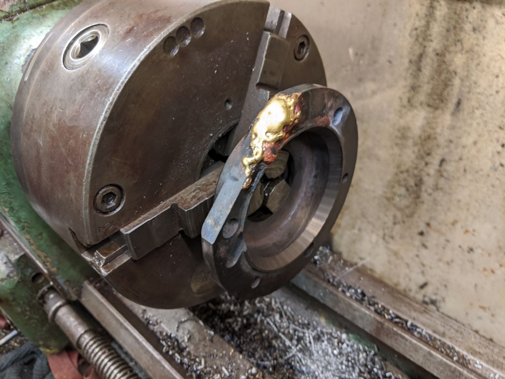

                                  I did change tips and get to a better flame so it was sufficient for heating
                                  All filled up, but a mess. I went to use the other mans lathe to clean up all of the excess bronze, but not to really touch the metal.
                                  I don't have any pictures of the actual turned surfaces, but there will be one in the next post. Its been a long day and I'll do it tomorrow
                                  It was quite a nice lathe. A harrison model. Still, it needed a good clean as well, but at least it worked.
                                  I also used the lathe to drill the center of 2 bolts out to 5mm
                                  Then I tried to tap them m6, but the tap got stuck. It is still in there, but I didn't want to risk trying to get it out at my friends. I'll do a better job at home. I'll get them tapped somehow.
                                  Anyway, the housing is machined down closely enough so i will be able to finish it off with files and sandpaper or whatever. Good progress. Then I'll just put the rest of the lathe back together
                                  My only issue will be getting the hole that i have filled redrilled in the correct location, but I have a plan!

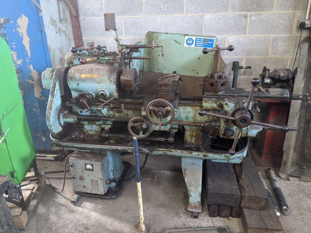

                                    This is the lathe I was using. It felt like a very long bed. The owner is about a foot shorter than me, so this lathe was quite low. And the ceiling was low too. So I knocked my head a few times by accident!
                                    #491451
                                    Herman van der Merwe
                                      @hermanvandermerwe76509
                                      A big old capstan lathe … made for working …
                                      You did not heat the flange to red hot and then not enough flux you did add … also the incorrect flame type.
                                      So you learn, so you learn!
                                      #491452
                                      Richard Kirkman 1
                                        @richardkirkman1
                                        Posted by Herman van der Merwe on 19/08/2020 18:36:26:
                                        Maybe so, maybe not. Either way, I'm happy with the braze and once its smoothed, it is solid. I think it was plenty hot enough. I think I would have struggled to get the whole thing red hot. The flame type was restricted. My friend only had a few tips. It was either that or a cutting torch. So I've made the best of it. Am I a professional now? No, but I had fun!

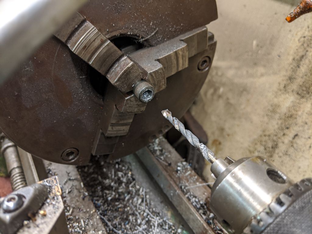

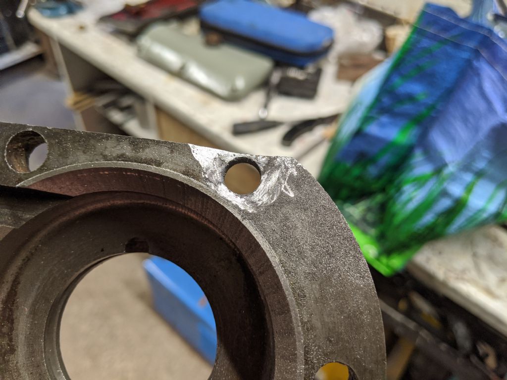

                                            To begin the day I thought I would deal with the bearing cover that needed filling down and smoothing. This went quite well. Although the hardened flux was a pain to deal with, I'd rather file metal than try to remove flux!
                                            Anyway so that was relatively cleaned up, so I used my scotch brite wheels to give it a nice surface finish. I use the scotch brite wheels more than I ever thought I would. It's very handy having multiple grades so you can do different finishes or removal rates. I would highly recommend anyone to try them, although the lower grits cut through flesh pretty well too, just ask my fingers…
                                            Then I got onto drilling the hole. Tricky work since I was drilling through a mix of cast iron and bronze, due to my EXTREMELY HIGH quality brazing!!!!!
                                            This meant that the hole I drilled did not line up with the previous hole and was off by a bit. However, this did not matter in the big picture since its just for mounting and I was just going to use the washer and bolt anyway. So I am happy with this fix being permanent since there is now a significant increase in the pressure being applied to the gasket, so hopfully it won't leak. Although the leak before was not significant. It's just a more permanent fix than filler/epoxy
                                            I will not be repainting this until next year. I want to use my lathe !!!!

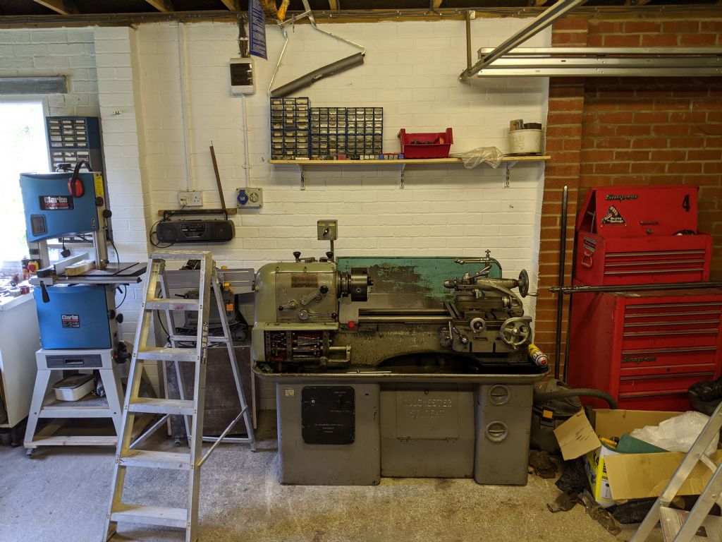

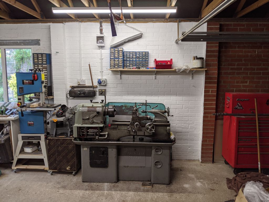

                                            This is with my (dads) fluorescent lighting(before)
                                            And after!
                                            I've moved the lathe along a bit so I have space to slide in my table saw next to it for when I'm not using it. This means my dad has much more length in the garage to put the car in, also reducing the chance that he damages my table saw on his car or vice versa.
                                            The real difference can be seen through the window, the exposure of the pictures is completely different. The first pic shows the light outside to be much brighter than inside, however, the second shows the light inside to be similar to outside. I don't care what anyone says, LEDs or better lighting in any form is well worth the investment. I am absolutely astounded in the difference. Especially since the lighting has been placed over machinery and workbenches, rather than behind, so I can see what I'm doing now.
                                            Anyway, I will get the lathe back together tomorrow, I will put the cover onto the gearbox and fill the headstock with oil and put the belts back on. The feed shaft and leadscrew do not need to go back in until I have the replacement half nut. Just waiting on James to get back to me! His package of the topslide should have arrived today, or at least the tracking say it has.
