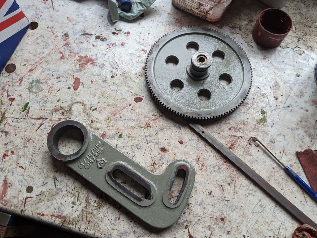

        Thanks Herman, there's always next summer for me. You're doing things properly, so well worth the time and effort!
        I managed to get a coat of paint on the parts today

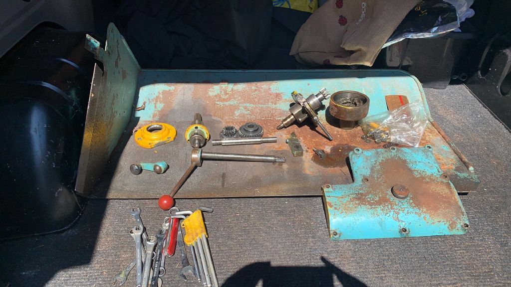

        Traci has finally been to her lockup and got me the parts that I asked for! 6 months and a hell of a lot of pestering and she's finally done it. This past week has been like Christmas twice over! First with Brian and Ted's tools, now with Traci. I'm finally going to have an original hand wheel for the apron!
        These are a few of the parts she's sending me. Some aren't in the picture too. The splash guard wall thing has definitely been changed significantly to make it work with how they rigged their lathe. The lathe was pretty much cannibalised, so I'm going to have a big job getting that pannel back into original shape. Possibly including welding and bending some other steel back onto it. I'll probably need a bit of help with measurements from Herman and or Phil. Also, there is the main on/ off switch, so I will try to use the new one if it is in better condition than my current one. Maybe swap the ball ends too.
        Unfortunately, she was unable to get me the motor cover for the back of the lathe since we had a miscommunication and she thought I didn't want it, so her husband cut it up and used it for something else.
        The yellow bearing housing seal is broken on my version, so hopefully, it'll seal with the new one. I'll also have access to both the shafts that are for the oil seals that I've been replacing, so I'll be able to pick the best parts to use.
        She had a spare 3 jaw chuck and traveling steady and all sorts, I don't need them, but I just hope they don't go to scrap. I've sent her a link to Colchester spares, hopefully they'll give her more than scrap value so someone else can make use of the parts. Then again, if anyone reads this in the next few days and needs something specific, message me and I can ask her or something. I don't like the idea of these parts being scrapped.

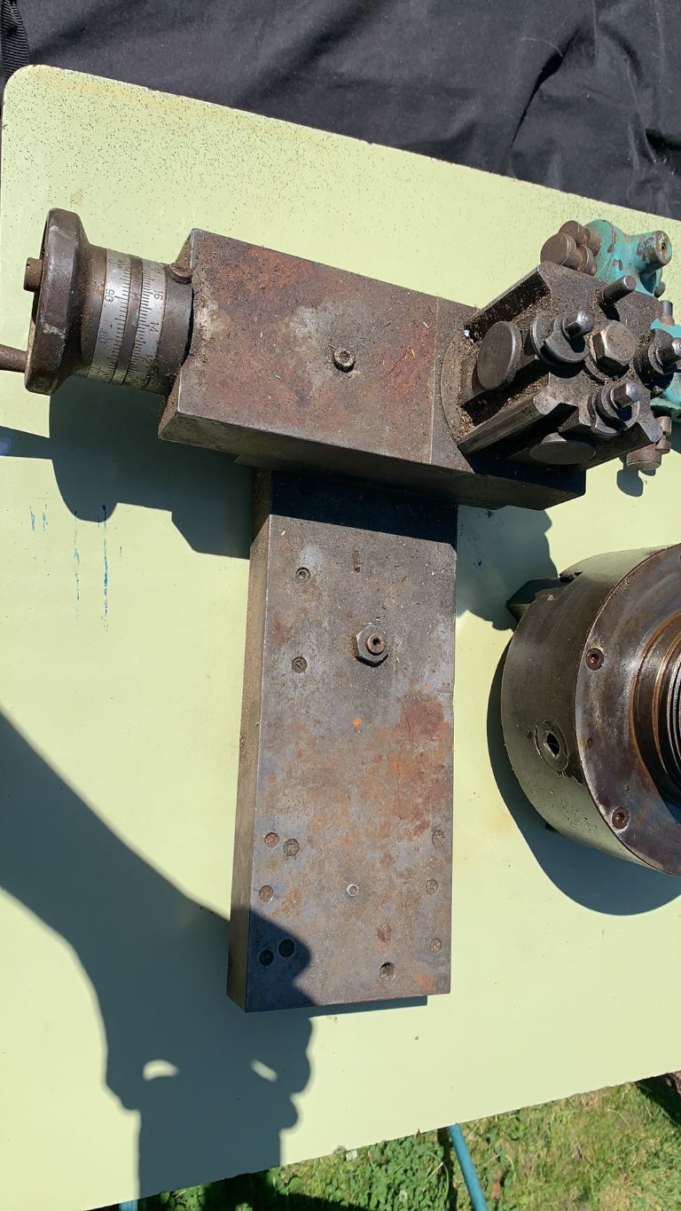

        She's also sending me the entire cross slide, which has a dicksons t2(maybe?) quick change tool post on. This is interesting since it's not a t-slot cross slide, so this must have been modified. Hopefully, I'll be able to make use of it. Although I was planning on getting a model 222 from ARC, this could be nicer. But there aren't any holders, so I'll need to find some, and I don't believe they're cheap.
        So more progress to follow. Looks like I'll have a multi-coloured lathe for a while

          Nice plunder Richard, the toolpost is interesting as it appears to be dual inch/mm dials, and I would love to see how they have modded it to fit the QCTP! The splashback looks fairly intact, and they save the inevitable spray of oil and coolant up the wall! Don't worry about the tool holders, when you get your milling machine you will ba able to make some!
          Phil

            The back splash plate looks 100% intact to me. Shout if you need dimensions. Mine is on its third coat of primer so it is easy to measure.
            Wish you could send those spares you do not want this way … dream on, dream on …

              Honestly, it's been a lot of effort to get the parts. It's from the woman I initially bought the 4 jaw chuck from. Dealing with her to get to her husband. I've had to pester her for 6 months to get this far.
              The backsplash seems alright but the headstock end looks to me like its been messed about with. Looks like it's been modified when compared to yours Herman.
              I'd love to have sent you some spares, but I'm not sure how feasible that is, especially with you in South Africa.
              Anyway the courier is booked, so all the parts should be here on Thursday. I'm looking forward to it.
              I will also be interested to see how they've mounted the toolpost, as it definitely will have been modified.

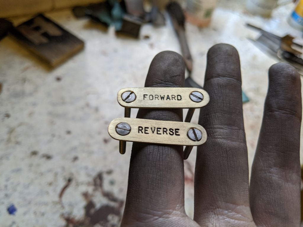

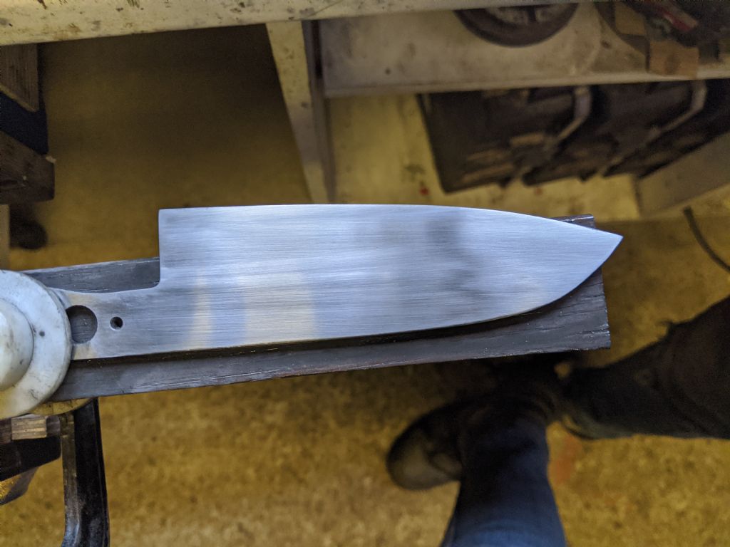

                                            I've been busy making some wooden signs for my aunt, and working on a kitchen knife and a hunting knife.
                                            However, the brass plate has arrived, so I'll be able to make my new labels soon enough. I think I'll heat treat the knives first
                                            #487765
                                            Richard Kirkman 1
                                              @richardkirkman1

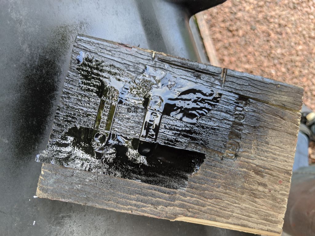

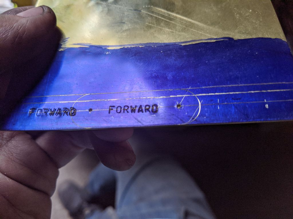

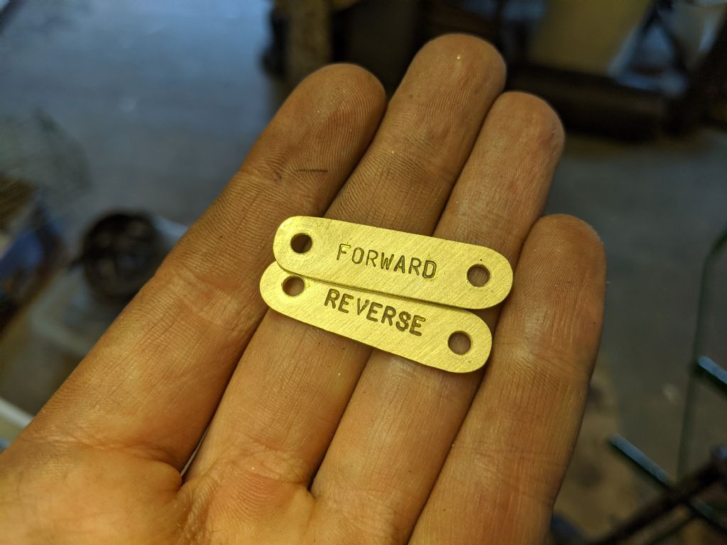

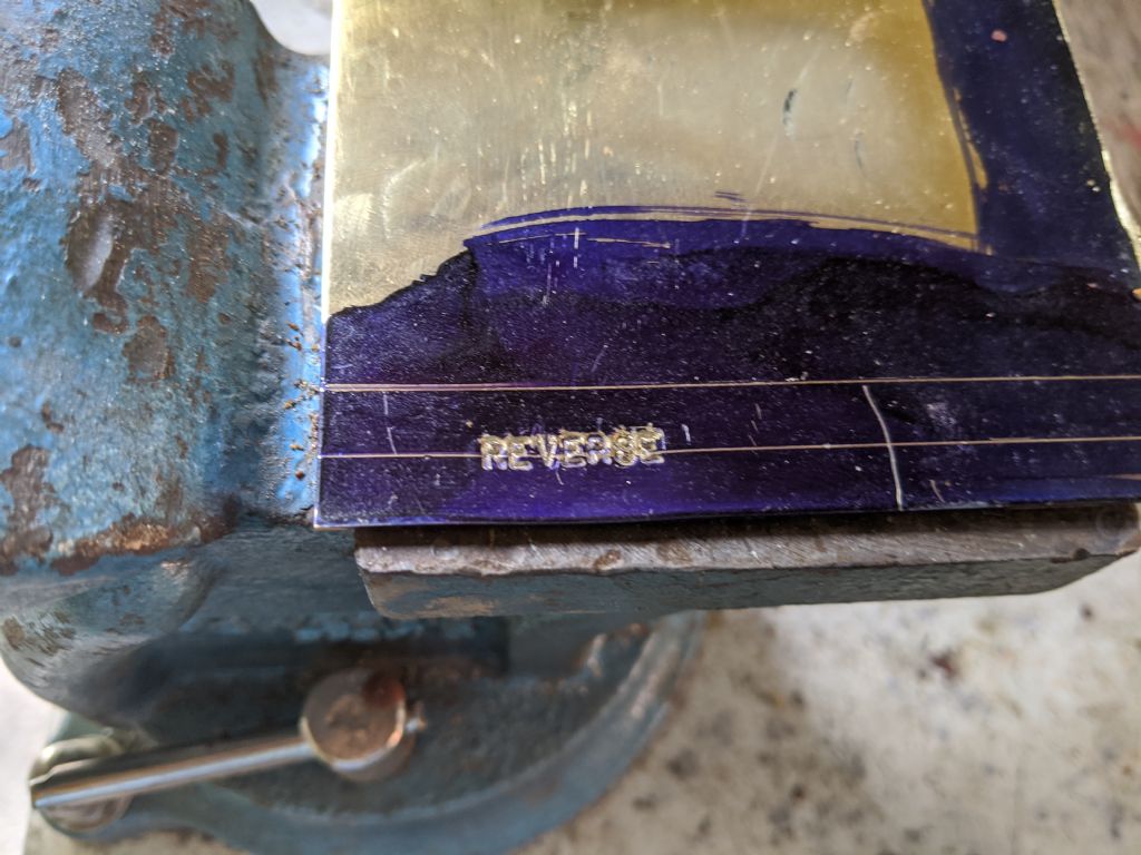

                                              PROGRESS!!

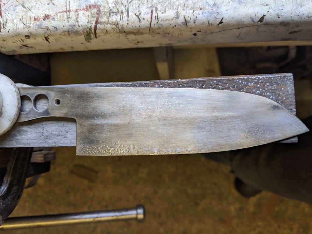

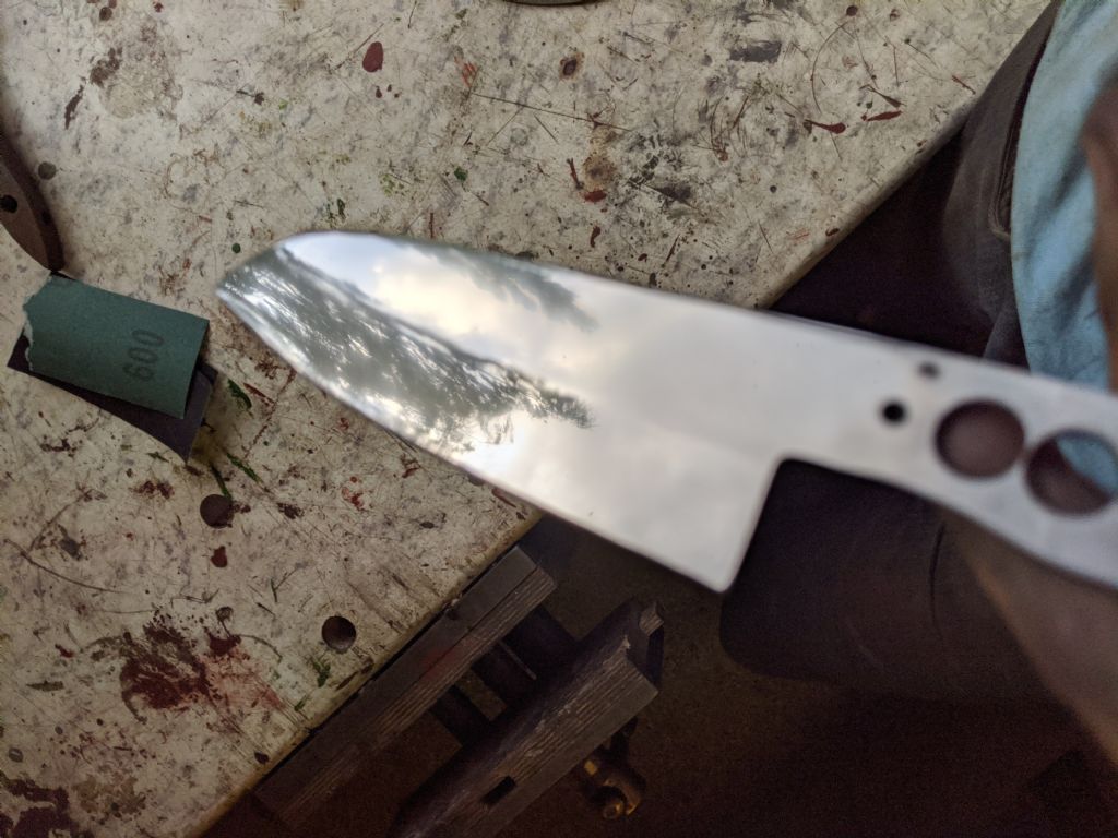

                                              I heat treated the knives as expected, had some warps so had some fixing to do.
                                              So I had an hour or two spare while the knives were tempering in the mini oven.
                                              First one went a little squiffy when I tried to make it deeper
                                              Funilly enough, I currently only have 2 E's, so I had to do this by overlaying the other ones.
                                              I have some more letters on order, but they're backordered for a few more weeks, so I thought I'd have a go.
                                              Ready to be fitted tomorrow. I'm very pleased so far. They look much better than F. and R. written in marker pen
                                              I may try to deepen the O and the R a little.

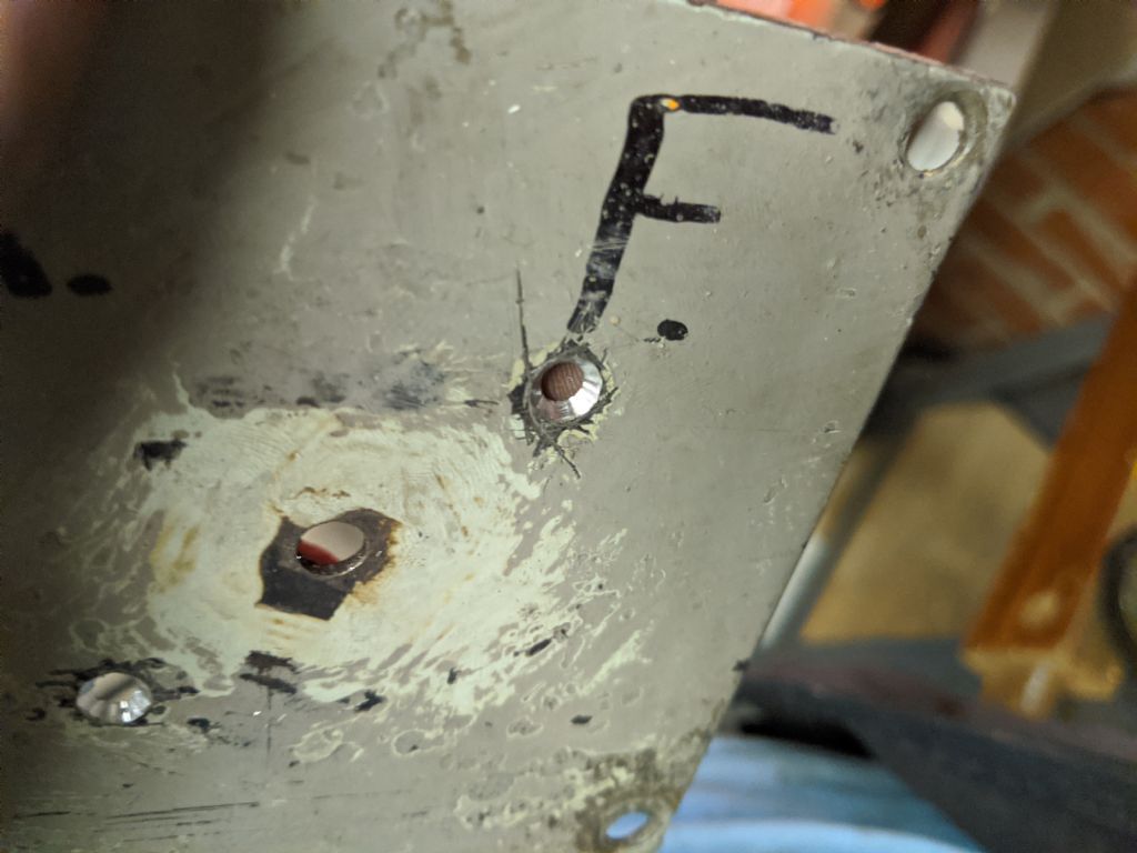

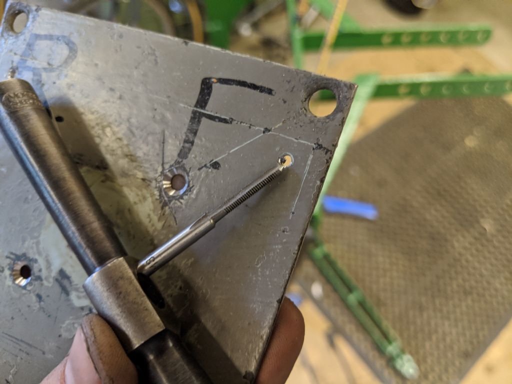

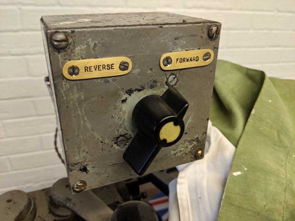

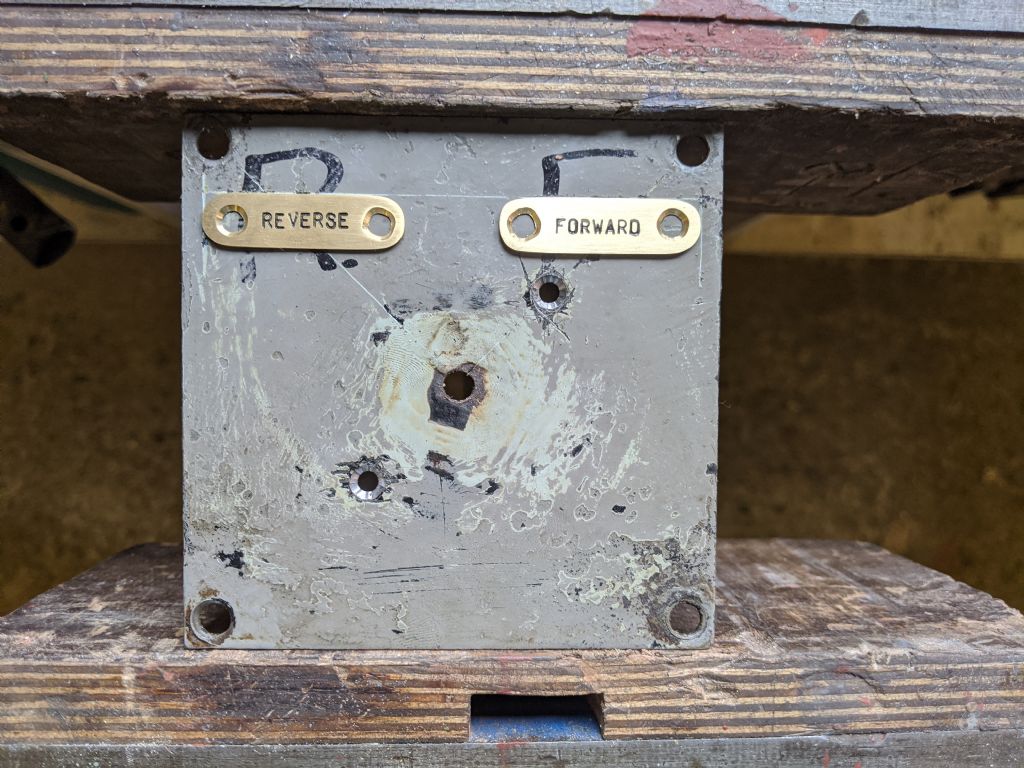

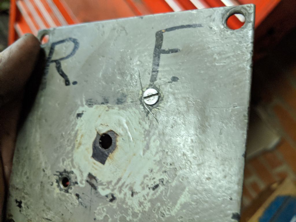

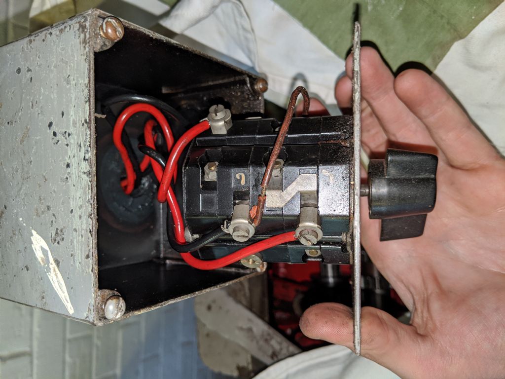

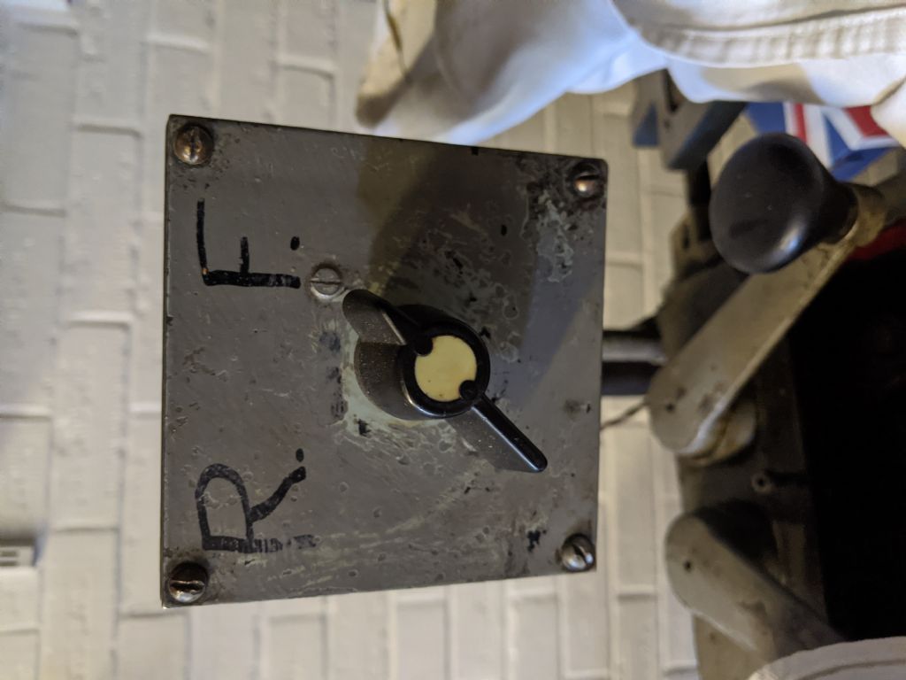

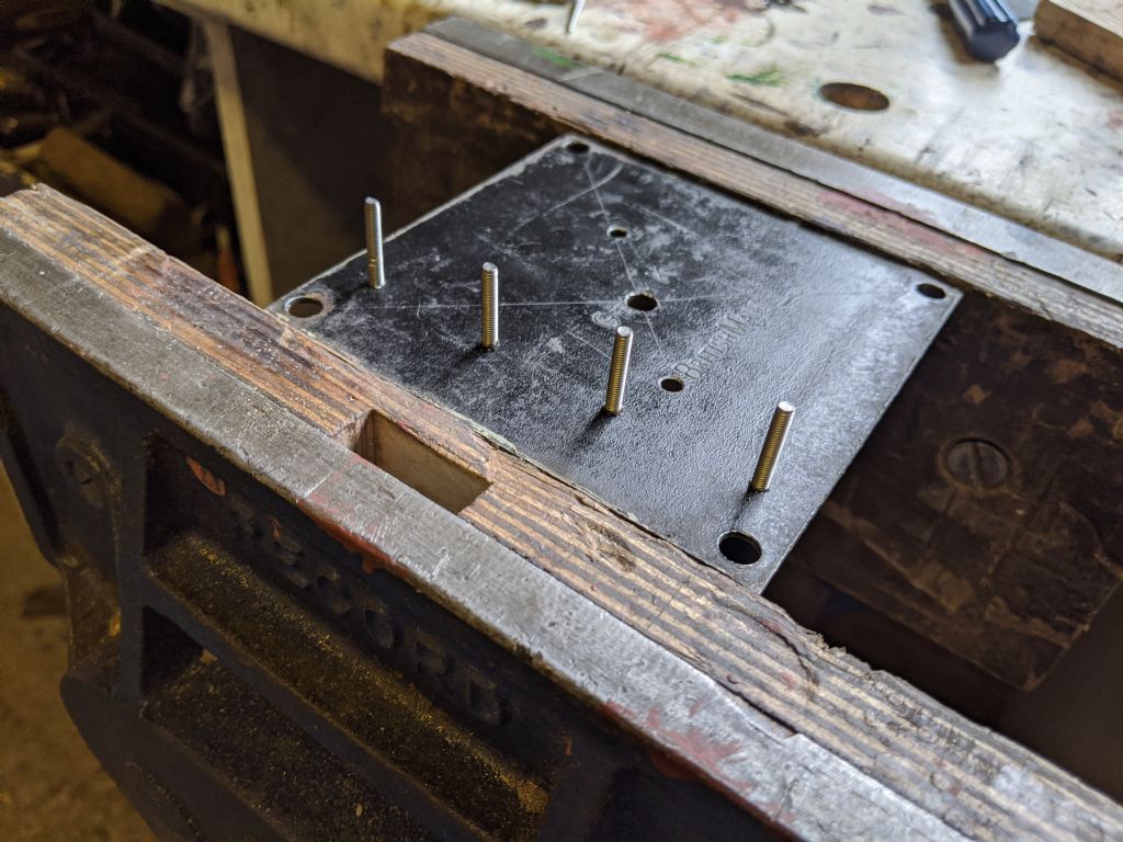

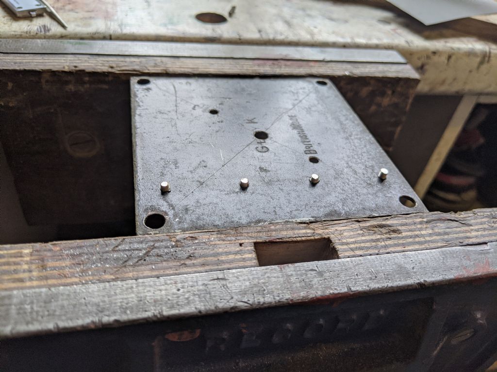

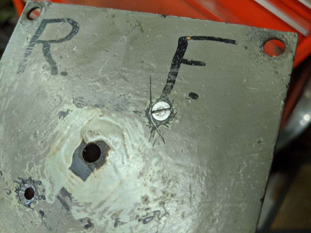

                                                      So this is what the switch originally looked like. Nice and rough with beautifully handwritten F and R
                                                      First step was to take it out and off
                                                      It was held on by 2 countersunk screws, which were going through non countersunk holes.
                                                      So I countersunk the holes so the screws are now flush, cosmetic improvements only today.
                                                      Then I laid out the new labels and marked where I wanted them to go. I did one hole for each, drilled and tapped, then marked the other hole from there so they both lined up. This worked well
                                                      Then I had 4 long m3 screws to cut down. They didn't interfere with anything inside, but it made screwing them in and out much quicker
                                                      The F and the R mostly rubbed off with a bit of acetone. But It will be fully repainted one day!
                                                      Then at last I put it all back together
                                                      I'm very happy with how they came out. Not original, but much more fitting than permanent marker!
                                                      I did end up deepening the O and the R from forward, so it blended a bit better. A minute difference that you wouldn't notice unless I told you.
