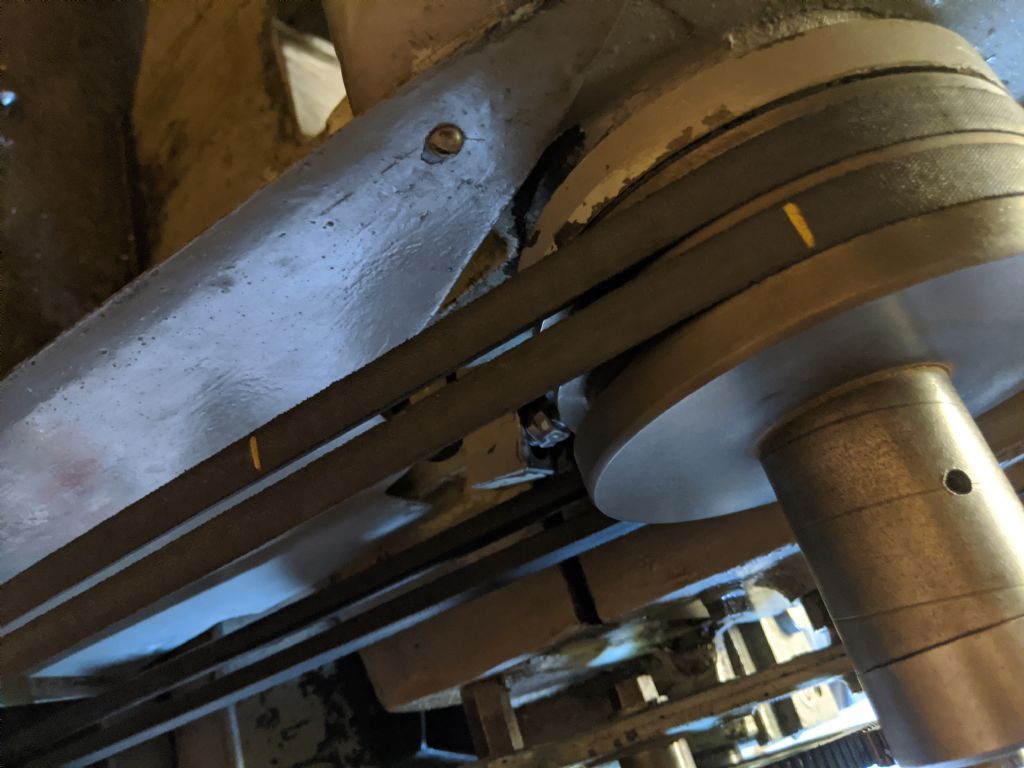

        Yes, The lathe doesn't quite knock itself that hard. But it does vibrate. What is this caused by?
        Most likely the V-belts are not of equal length. Have you done the chalk test on the belts?
        I meant what is the electrical issue caused by, but I've figured that out now.
        The belts are almost definitely different lengths or not running right as they make a lot of noise and sound like they're hitting off each other. What is this chalk test?
        I managed to sort out the excessive wobbling by using a much longer bolt, it works much better now
        Wobble before
        Wobble after
        So it's now much more satisfying to turn, and doesn't feel like I'm about to break something.

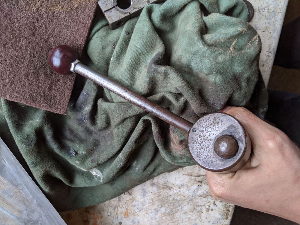

        The last handle that Is loose is the main on/off lever. There is a lot of slop in this and it makes it feel loose and less tactile to use. The only trouble is, it's actually worn.
        Herman, after seeing your future shiny handle I think I need to polish a few of mine. Perhaps just a brushed finish

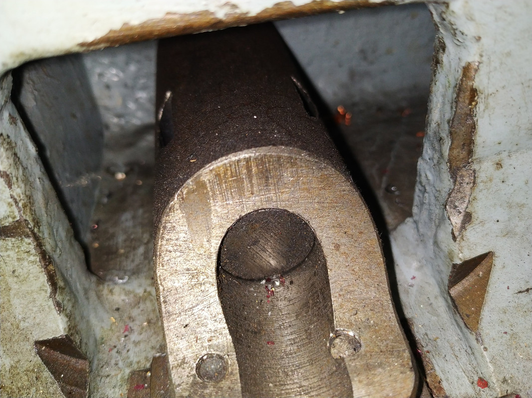

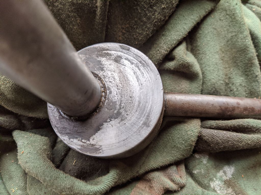

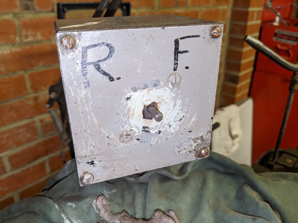

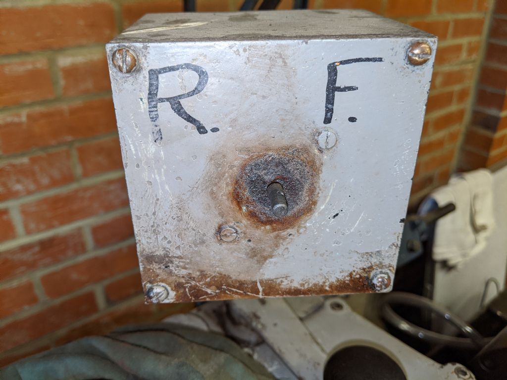

          I cleaned up the face of the switch box too. There must be a more elegant way to write reverse and forward onto it
          Interestingly, there is the original lathe colour paint underneath the grey. This means that the switch is original, or at least was put on when the lathe was painted before.

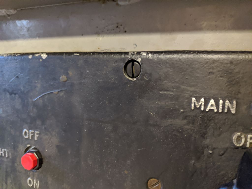

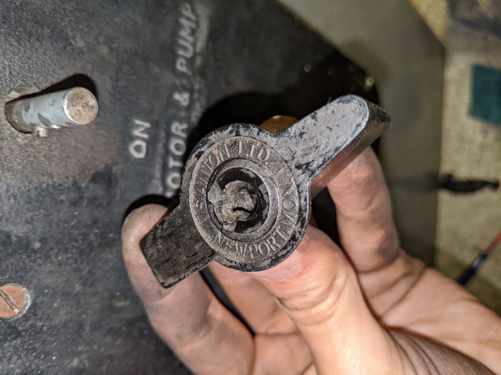

          This is the handle, it will be brightened up. The rod is held in by a blind pin. Any suggestions as to how I can get it out without drilling out the pin? Drilling is last resort, but I think it might be inevitable.

            Posted by Richard Kirkman 1 on 03/06/2020 21:51:38:img_20200603_194756.jpg
            I'll get the bolts tomorrow for the cabinet things
            Have you checked that it cannot be punched through and out the other side? Remove some paint on the rear surface and check. If not then screw a self tapping screw into the hole of the pin and pull it out with a slide hammer.

              Yes, I checked the other side thoroughly, but I did not take a picture. There's definitely not a through-hole for the pin to be knocked out.

                Posted by Richard Kirkman 1 on 03/06/2020 21:35:40:
                You need a matched set of v-belts. If you do not have such you need to replace the belts with Nu-T link belts. I only run Nu-T Link belts on all my machines.
                Chalk test – http://www.lathes.co.uk/colchester/page2.html

                  Thank you, I have read that page before but I don't remember reading that. The belts were supposedly matched but I'll do the chalk test tomorrow. Link belts are a possibility depending on the cost.

                    Unmatched belts can certainly cause some strange noises/vibrations/patterns in the finish. If you are experiencing any of these effects you could try operating with just a single belt. That is what I have done on both of my Master 2500 lathes and even though I work them hard, I don't spend all day taking huge cuts as would have perhaps been the case in a production environment. As a consequence all belt derived artifacts no longer arise, but a the same time there is no loss of transmitted power at the levels I require.
                    The removed belt becomes a spare for when it may be needed, although at least 10 years have gone by with no requirement!

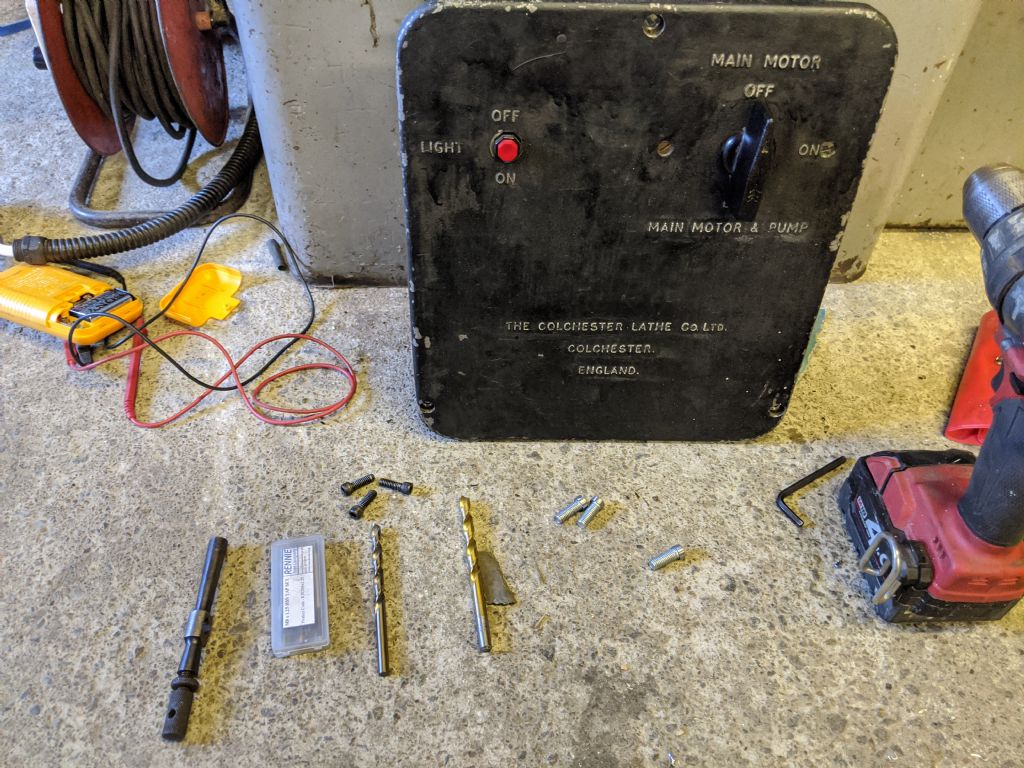

                            I've had a very productive day. I finished some jewelry boxes, similar to the one I made for Phil, but with trays and sections. Then some castors arrived in the post so my bandsaw is now free to glide around the garage. Then onto lathe work…

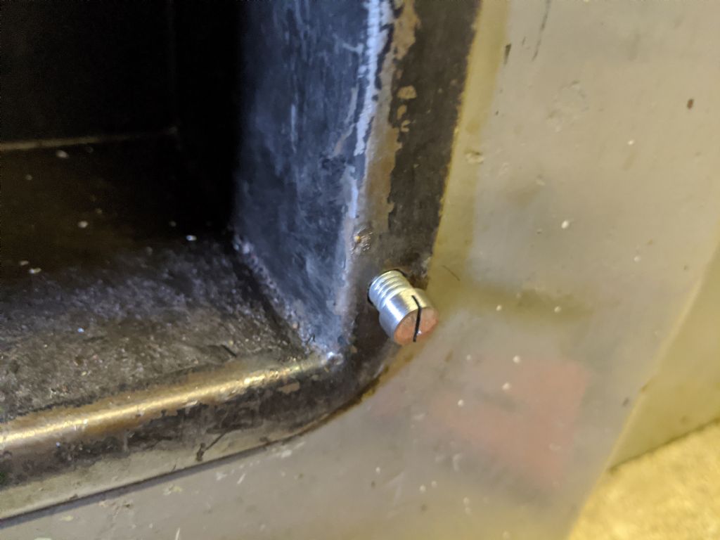

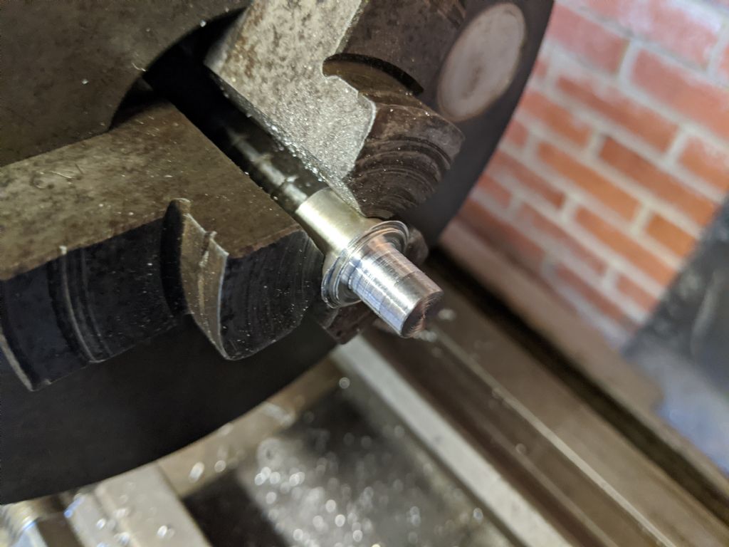

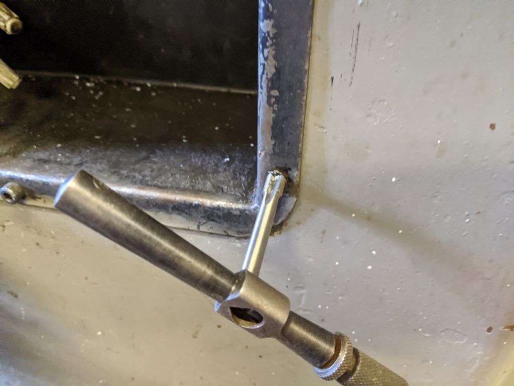

                            I picked up some m8 bolts from Toolstation so I could work on getting the panel fixed in place properly
                            Before I could turn the bolts down I had to put the starting lever back onto the lathe, so I took a picture of the back. Tracy finally got back to me today, so I will try to see if she can send me the starting level of her lathe so I have a spare if I mess this one up!

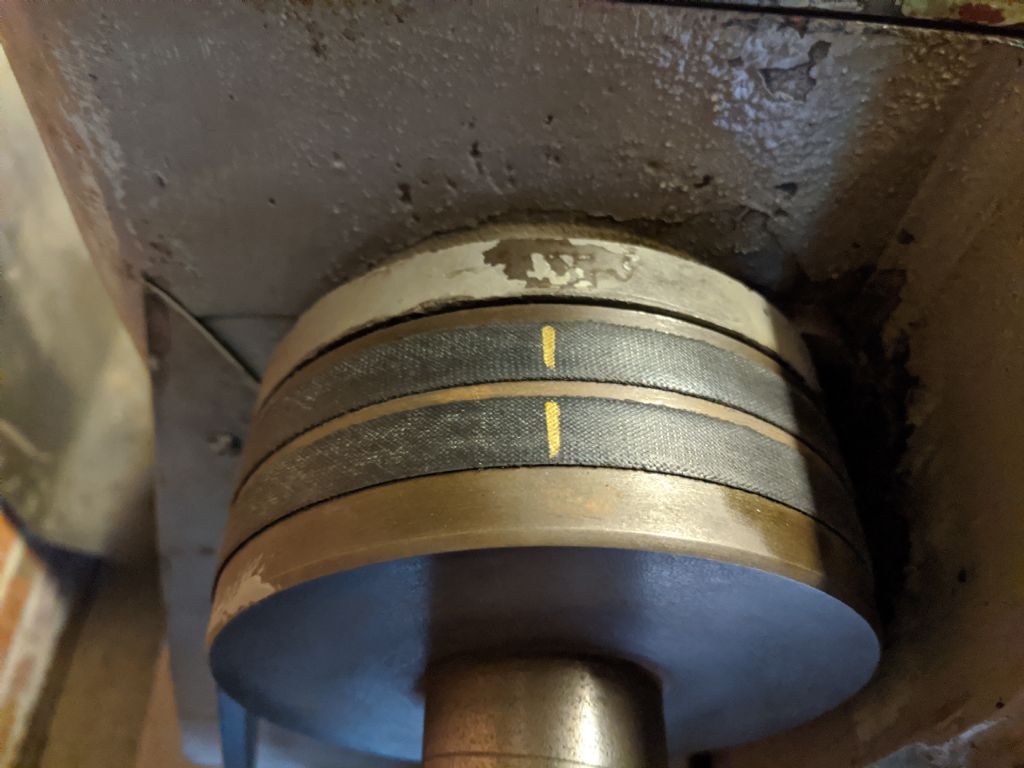

                            Chalk test, with a gold highlighter as I didn't have any chalk. The belts are not even. Can this be caused by a misaligned motor too?
                            Anyway, I'm running on 1 belt now and the lathe is much more peaceful. The link belts seemed a bit expensive when I can just use one belt, especially since I just bought these belts, although I do see the attraction.

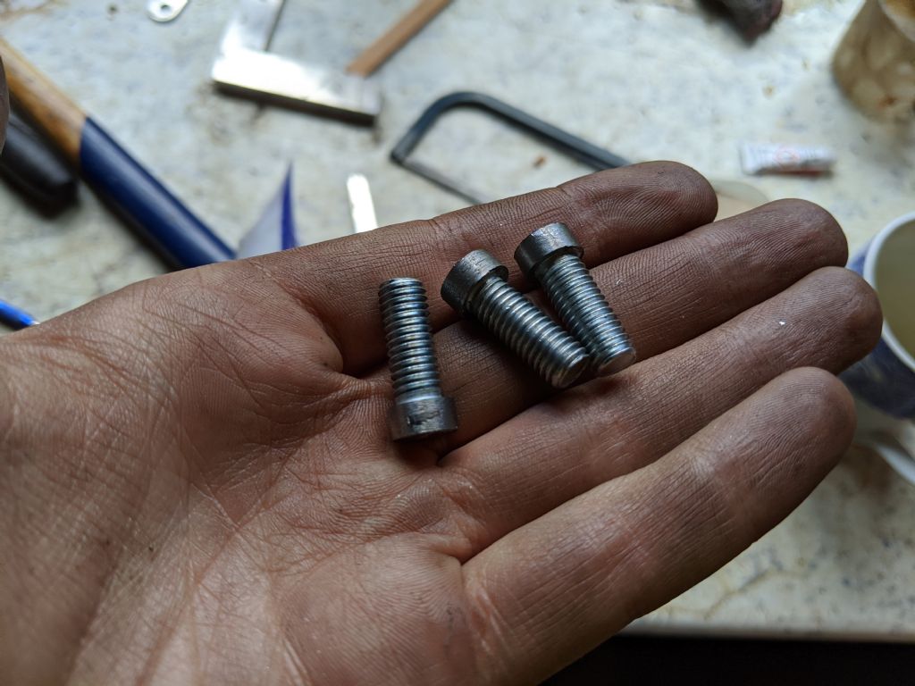

                            The bolts were screwed into a piece of aluminium I tapped, then faced, and turned to the dimensions I wanted.
                            Then I cut the slots just with a hacksaw
                            Then I prepared to drill and tap the lathe body.
                            This went surprisingly well

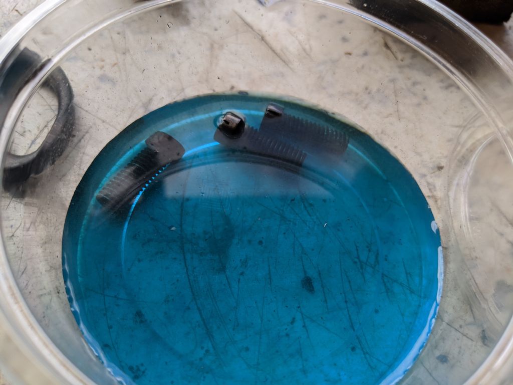

                            Then I polished the bolts, gave them a brushed finish, then cold blued and oiled them.
                            Fully installed, I'd say they look rather fitting.
                            They pull the panel in tight

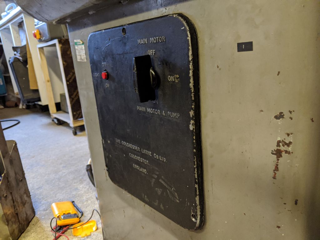

                            Then I tried the light and gave the panel a bit of a bang around to see if the light went off.
                            The light went off again
                            I've still fixed the stripped threads and improved the panel's fit, which I'd say is productive enough, but It annoyed me that it didn't fix it, so I started testing things
                            I cleaned the contacts of where the 2 legs for the lighting power leave the brass plug bit, that didn't help
                            I cleaned the surface of the slide lock fuses, that didn't help
                            Then I bypassed the switch to see if that made a difference, low and behold it stopped flickering when I banged it, I think. I could be completely wrong once again, I'll replace the switch and see.
                            I've ordered a toggle switch to replace it with since I found a picture and there should have been a toggle switch there anyway. I ordered it a couple of days ago actually, so this is currently working in my favour until it turns out to not be the issue.

                              Belt problem could easily be a misaligned motor Richard, and I like those screws so much I am going to make some! I never realised that the hex bolts in mine were not original! For a better screwdriver slot, put two blades in your hacksaw at once, but of course, when you buy your milling machine, you will be able to use a slitting saw! Jewellry box? anyone can see that it is an instrument case!

                                I'll have a look at playing with the alignment then, we'll see what happens
                                Phil, I don't know if they used hex bolts or not originally. I just wanted slot head screws since I could make the head whatever size I wanted. If I had a rotary broach, I would have made hex bolts
                                Two blades at once sounds like a good idea, although it wouldn't work for a junior hacksaw like I used. I'll definitely try that in the future!
                                Definitely a toggle switch originally.Can't see if they're hex or slotted

                                  I was going on the fact that the control panel has counterbores in it for cheese head screws, or allen bolts, of course, mine may not be the same!

                                    Posted by Richard Kirkman 1 on 04/06/2020 19:26:02
                                    What do you use to blue the steel? I normally use a mixture of phosphoric acid and copper sulphate. The reaction on the bolts looks similar.

                                      Mine has 5/16" cap screws installed @Phil.
                                        Agree, read this article on how to get the pulleys aligned.
                                        http://www.lubsys.com/knowledge/knw_align05.htm
                                        What I like about a Nu-T belt is that it never slips, does not have a direction, oil has no effect on it and when a link breaks you simply replace that link. These may be a tad expensive but in the long run they are just so much better in all aspects.

                                          It's just 'Phillips Professional Cold Blue' but it's quite expensive, I'd like to be able to make my own. The web says its made from some sort of selenium dioxide
                                          Phil, I had to look up what cheese head bolts were. But now I know what to search when I need bolts like that. Does your lathe have hex bolts in it? Because that really doesn't sound right?

                                              @Richard, my friend who made the sleeving etc did these mods to his tailstock.
                                              Both our lathe's stop/start arms do not have pins and the arm screws into the shaft.

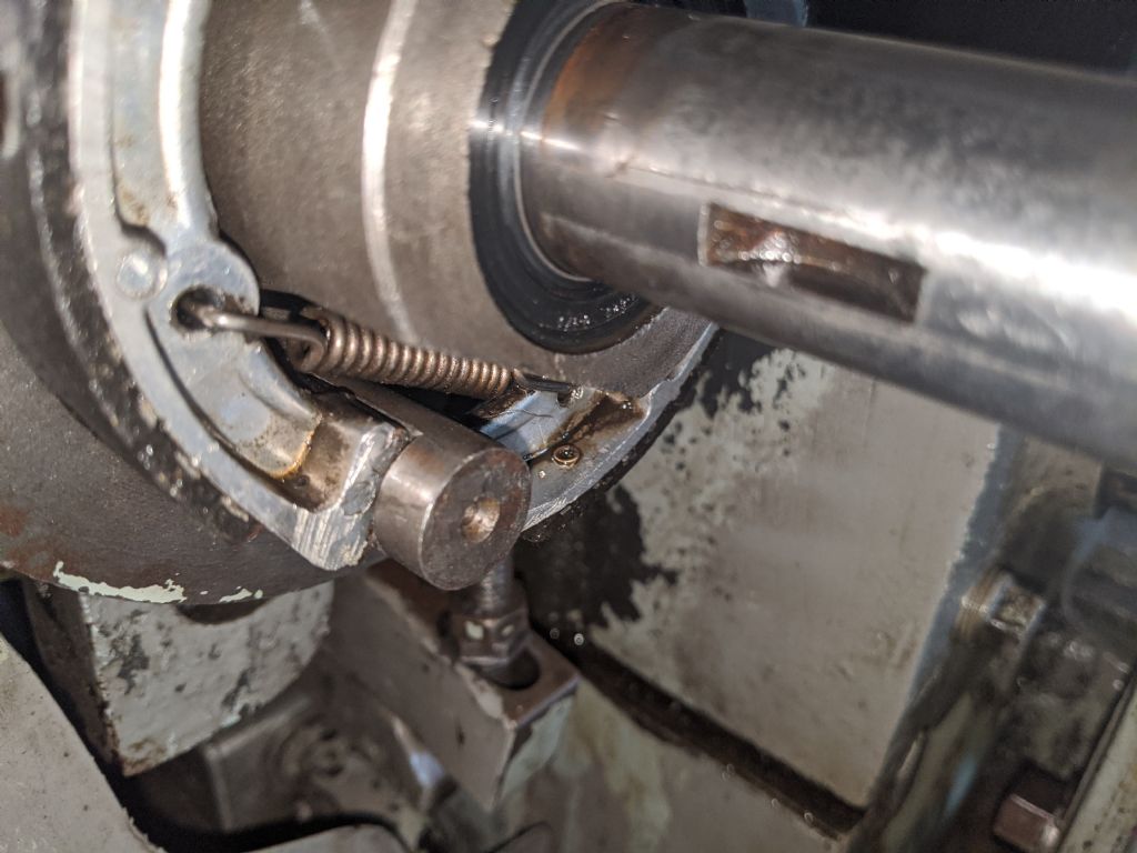

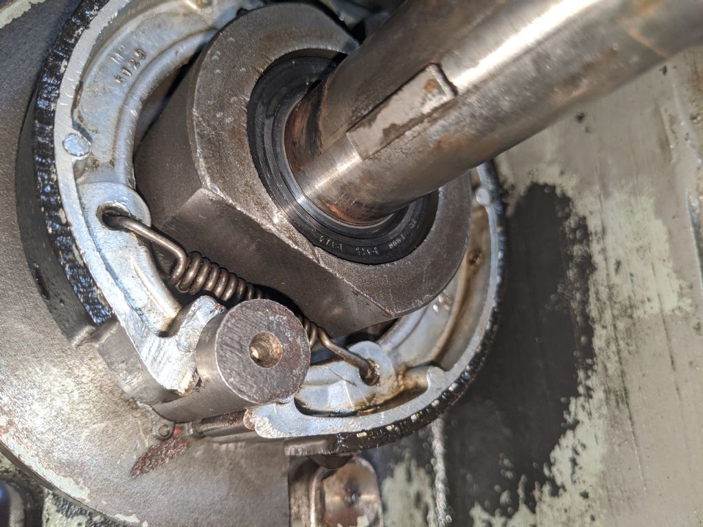

                                                    Looks like I'll try some windshield cleaner, but I'll have to blow it out using a straw with lung pressure!

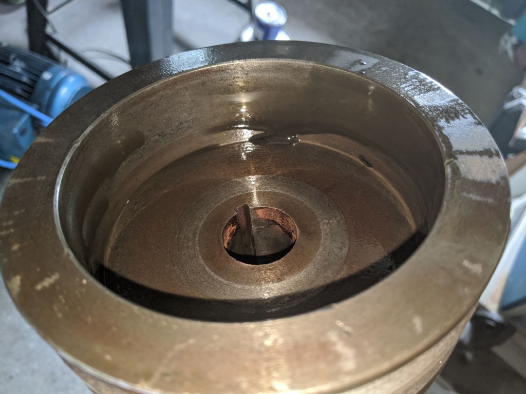

                                                    Leaking once again.
                                                    The brake seemed to stop working so I thought I'd have a check. Low and behold, it's leaking.
                                                    It seems like its leaking from the outside of the seal, not the inside. So I need to take it out and put it back with gasket sealer or something? What do people recommend?

                                                    Freddybear
                                                      @freddybear
                                                      I replaced the bearings and the seals. ( and I seem to remember there is a gasket at the rear too).
                                                      However. I did have the entire headstock stripped at the time. Also I was sick and tired of all the oil leaks everywhere
                                                      Incidentally, I also bored my wormbox true and bushed it. Action is much more positive now.
