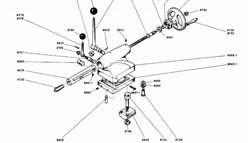

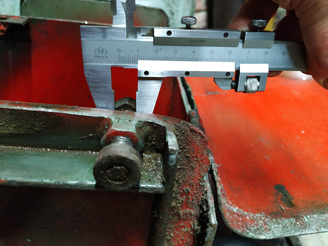

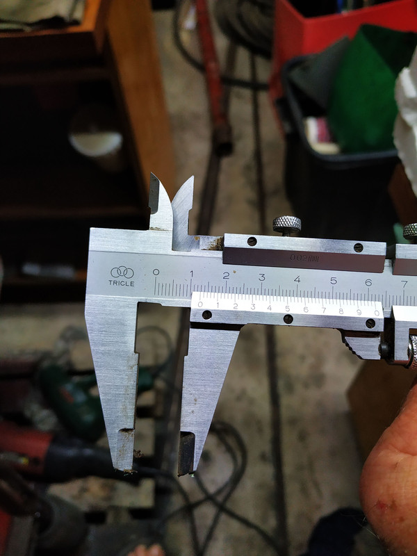

        I'll take a clear picture of the spanner tomorrow, but I'd recommend you just design your own. What feels comfortable for me might not be comfortable for you. I'm not going to bother hardening it. It really shouldn't need hardening at all. It's a tight fit and it's not going to be abused. No hole for a chain required as it's going to stay on that nut permanently. I just hated reaching for a spanner every time, so this works best for me
        The lamp works fine now, I think. I didn't turn it on after cleaning the contacts but I can't see it having done any harm.

                I'd still think a modification can be made to make a permanent handle, like the later models

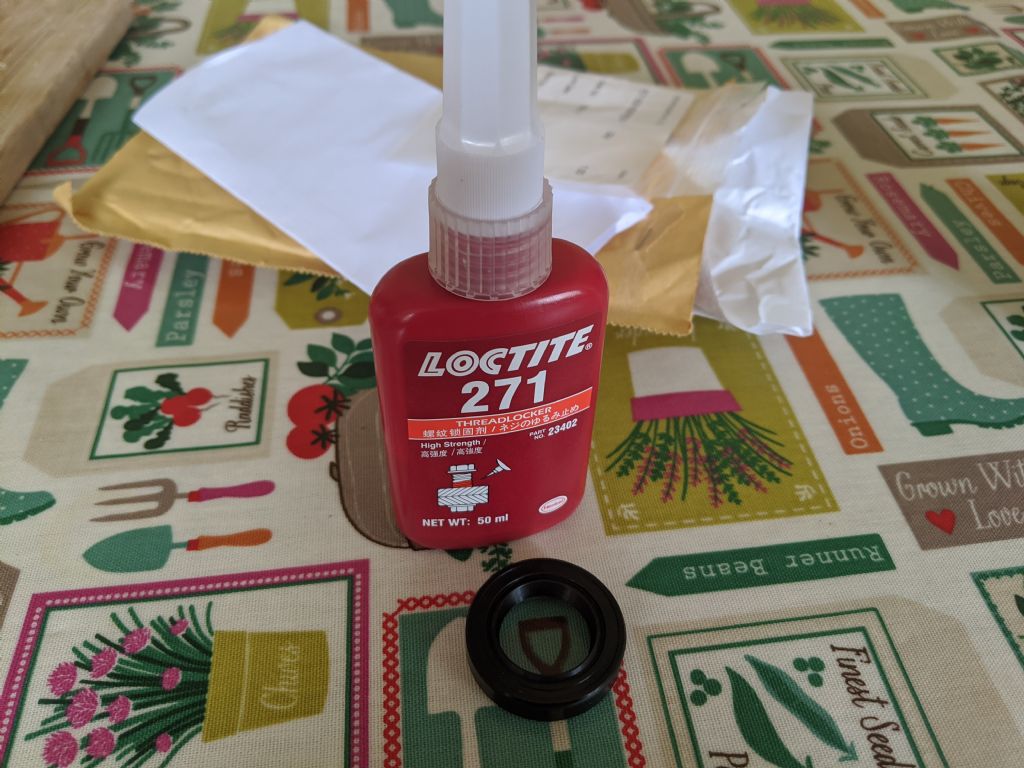

                On another note, Loctite and oil seal arrived this morning, so we will have a working lathe once again, Perhaps even new and improved with the spanner! Still waiting for a nice cheap Chinese boring bar to arrive so I can get on with making some die holders
                I didn't realise the Loctite was going to be pink. And it smells a bit like bubblegum? Or perhaps bubblegum smells like Loctitelaugh

                  I see no reason why you cannot make the clamping handle for the tail stock. You can even put the handle to be on the front. Try a lobe setup where you can get some leverage from the handle lobe to the clamp lobe.

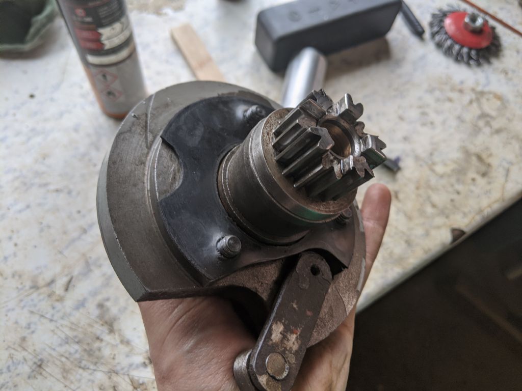

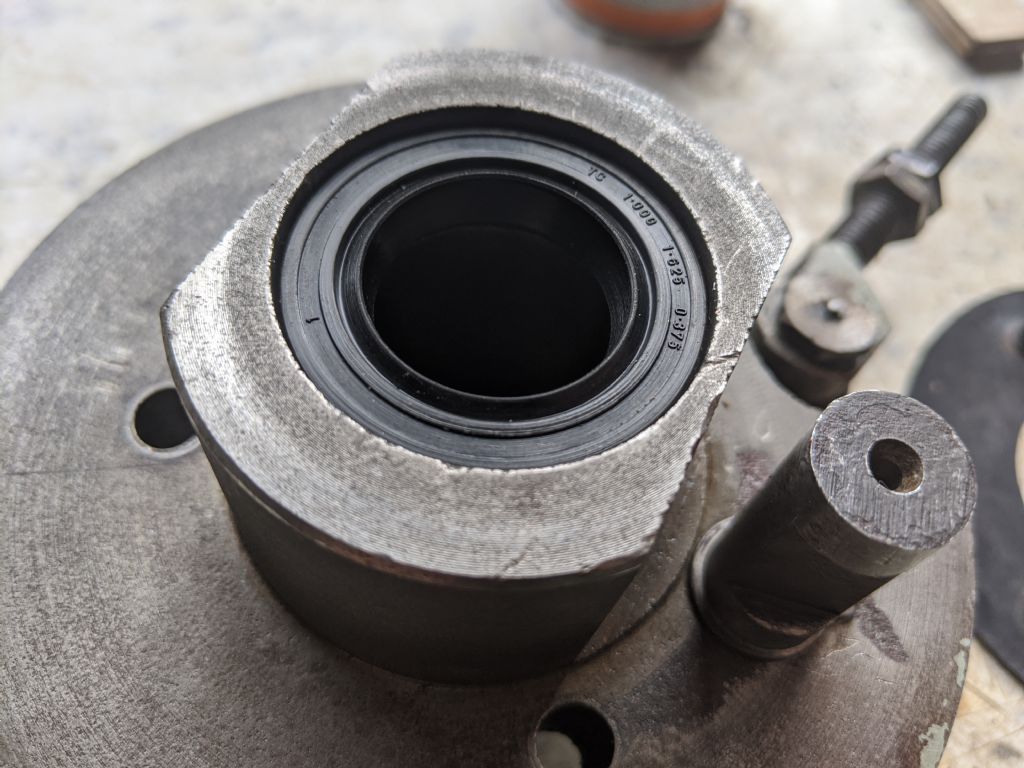

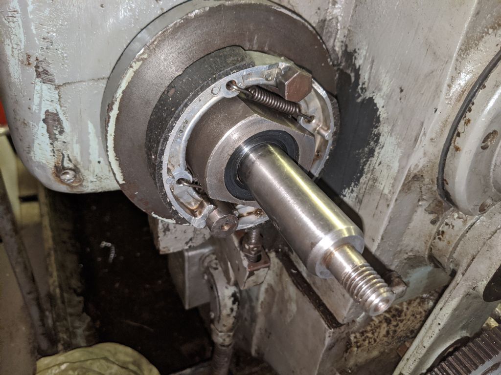

                    Lathe is all back together, loctited, tailstock handled and brake sealed nicely. Only time will tell if the seal is any good. Hopefully no more leaks!
                    Getting the sprung bit back on was an absolute pain, but I managed eventually. May be worth getting the right tool If I plan on doing it again
                    So, all is well, or at least it was until I switched the lathe on. Since the lathe had been in bits when I was testing the bulb, I never tried it with the lathe running.
                    There was power to the lathe, the light was on, the 'off' 'on' 'on with coolant' switch was on 'off', so I turned the switch to 'on' and the light went out. Not a good start.
                    So I had a bit of a play with the brake. It's working much better than before. I'll take it back off in a couple days to see if there's any oil in there again.

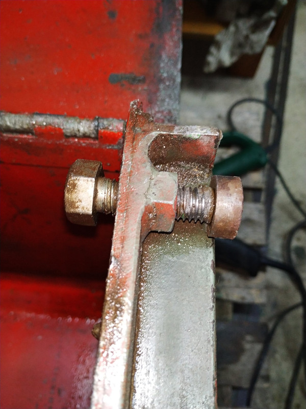

                          Phil, the adjustable feet. Hope it helps!
                          Right hand side. The one in the front fits onto the thick bottom shelf.
                          The left hand side. The back one is difficult to spot so another angle photo of it.

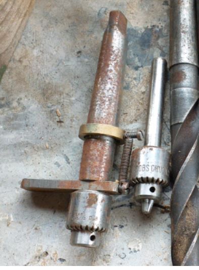

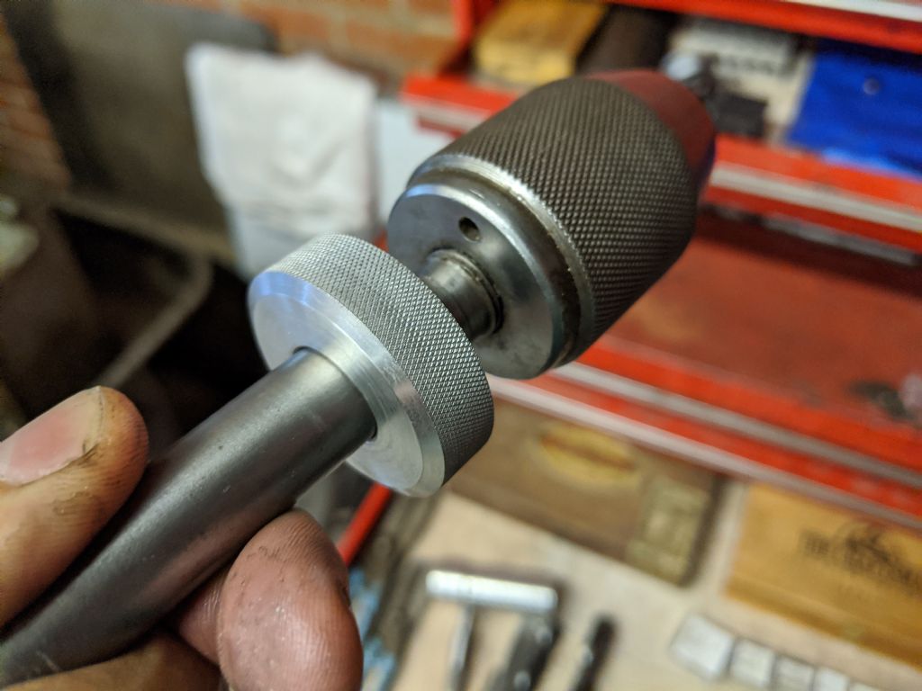

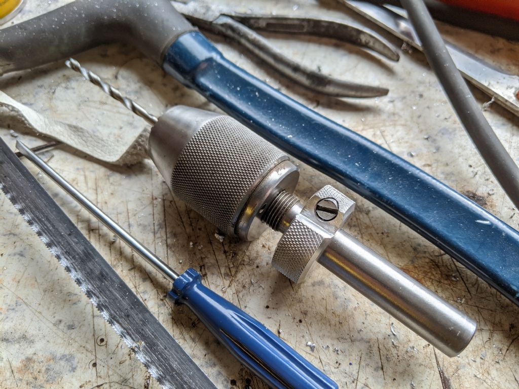

                                            I ordered a large selection of morse taper tooling for my lathe. In the package there was meant to be this micro drilling attachment to allow you to drill small hole with feel so you don't snap your bits. Anyway, long story short, the man mis-sold me and i didn't end up getting them, just the drills. So, I'd like to make one. I've seen oxtools video series on making his own, but this version here looks a lot simpler, however I'm not too sure how it would work. Any ideas? I couldn't find anywhere they're sold, but i'm not sure of the correct terminology to search.
                                            After finding Joe Pieczynski's video and thought I could make a similar thing just from a little chuck I had lying around. So, I made a collar to go on the shaft this morning. Knurling is still very satisfying and I am finding parting off much easier after all of your tips. I can't make any more of the parts since I still don't have a boring bar, chinese post is slow.
                                            But, I even made my own screw. It's just the simple things that feel like big achievementslaugh

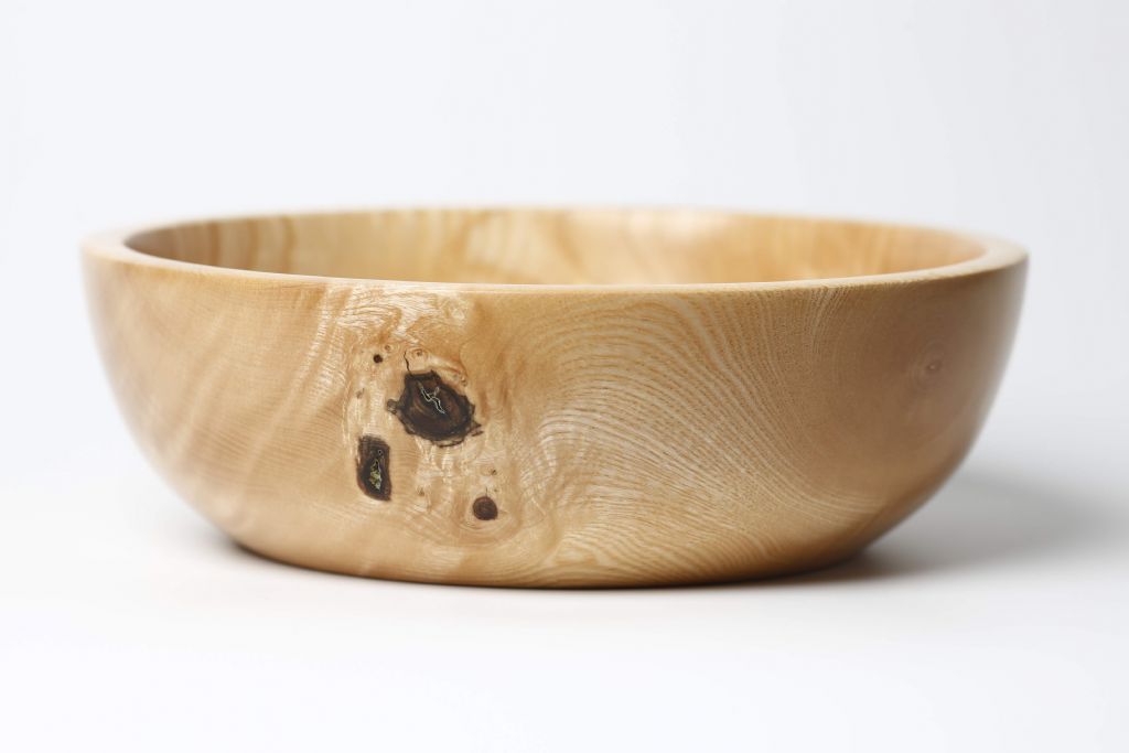

                                            Then I've been occupied photographing about 20 bowls which I need to sell. And refinishing a table for my aunt.
                                            Anyway, I hope someone can help with the micro drilling mystery. I have an idea, but I'd like to hear others as well.
                                            Thanks

                                                Just a few photos of the feet. The bottom is some kind of bearing that fits onto the bottom of the bolt which was turned down to form a shaft for the bearing to fit onto. Then the end of the bolt was punched so that the bearing remains on the shaft.
                                                The nut is welded to the bottom of the plate and the bolt is threaded through it before fitting the bearing and punching the end.
                                                The diameter of the bolt is a half inch bolt.
