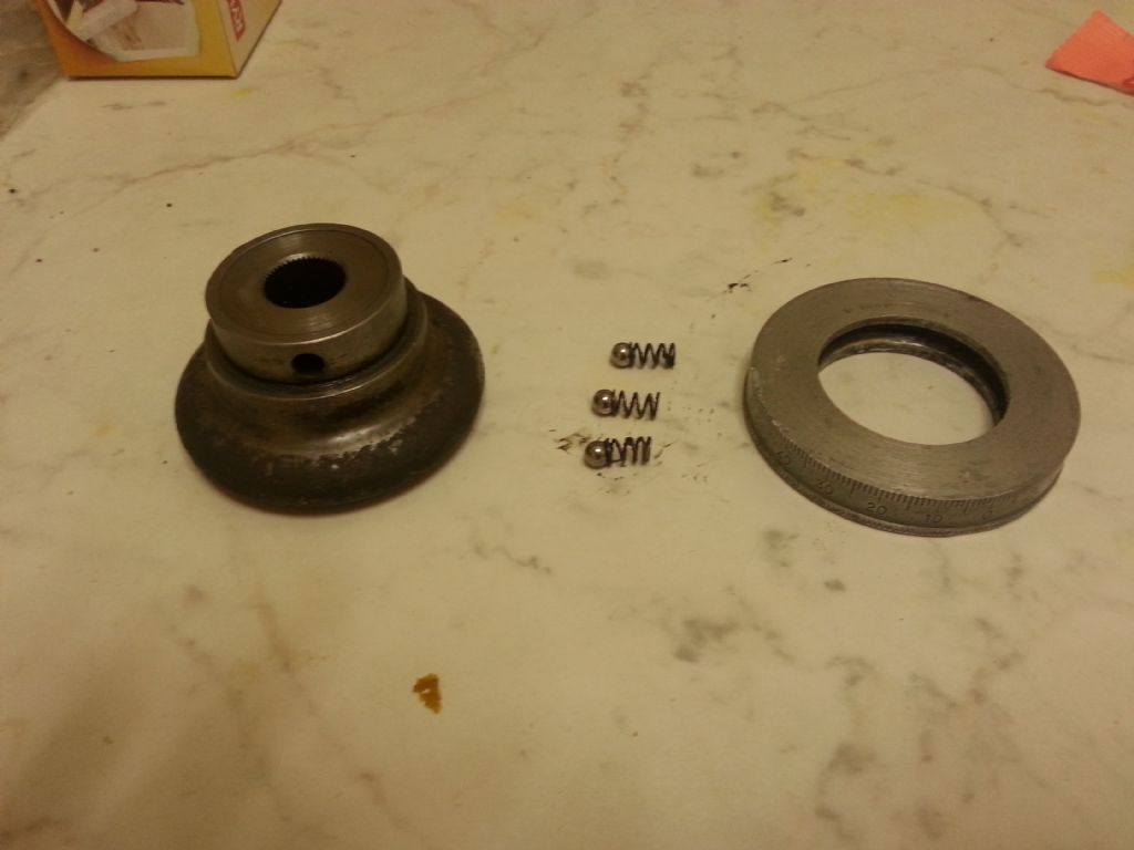

      I have been trying all day to put this back together with no sucess, I have been able to get all three springs and two balls in place but not the third ball, can anyone advise on a method please?

            It is a Mark 1 and a half (1 1/2 ) but I suppose the same principle would apply to other Laths, it is basically one ring inside another with three ball bearings and springs between the two to provide some tension.The problem is trying to hold the springs and balls in place in the smallwer ring to allow the larger ring to fit over the smaller ring.

                Machine yourself up a collar with taper that fits the inner part with an outside diameter that which the balls spring against. Put the springs and balls in their respective grooves, put the collar on the inner piece, push the outer piece over the taper, thus encouraging all three balls/springs to go into place.

                  Thanks for your reply Oompa, I thought of something like this I was going to use the vise to hold it the problem is that to get to the position of having the two balls in place and attempting to put the third one in the two rings are not parrallel and it is almost impossible or impossible to expose the hole where the third ball is to go without letting the other balls escape. I have been thinking of making some sort of narrow retaining ring to hold all the balls in place whilst I slip the larger ring partly over the balls and then removig the retaining ring and fully pressing the large ring home. There really is very little difference in the diameter of the two rings, there is a groove in the larger ring and the balls run in this groove when all is assembled.

                            Hi Ed, The three springs sit in three holes in the inner ring the three balls sit on top of these springs and push down on the springs and into the holes, they will go into the holes compressing the springs until they are flush with the inner ring circumferance the outer ring will then fit on the inner ring over the balls. When the outer ring is fully on the inner ring the springs push the balls up into a groove in the outer ring the outer ring will then turn on the inner ring thus you can set the outer ring to the zero mark and the tension from the balls and springs stop the outer ring from moving when you do not want it to. It is not possible to hold all three balls in place with fingers the tension is too great, this is a difficult one.

                              Got it the springs/balls fit to the inner not the outer crook.
                              Bit of shim wrapped round the inner keeping the balls in place as you slid the outer on

                                Tried this Jo not been a sucess, these springs are quite strong, I think I need to make some sort of split sleeve/clamp.

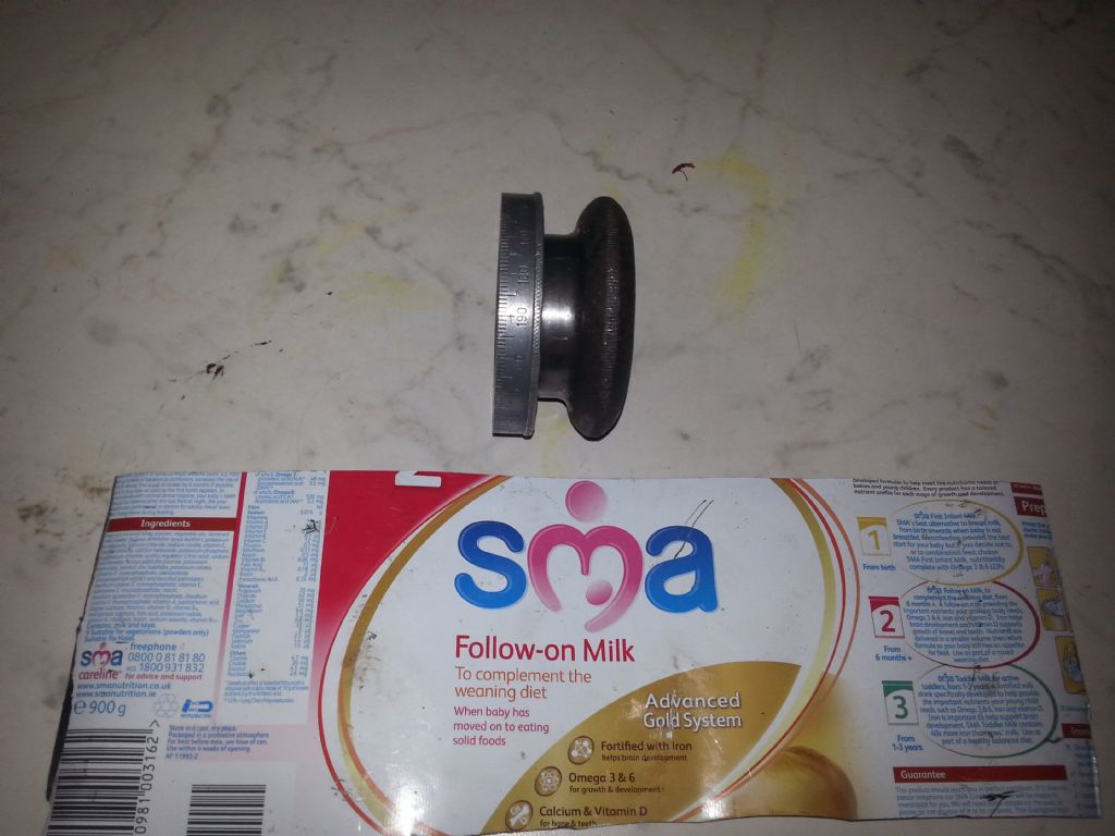

                                              Bit of tin can just a bit wider than the balls to go round and have the end bent up at 90 degrees.
                                              Insert springs with dab of grease or even super glue the lower coil into place, balls on the spring then wrap the band round and grip with a pair of snipe nosed pliers.
                                              Offer the outer ring over pushing the band down to the bottom and then when you are sure some of the balls are inside the ring, remove tension from the pliers and unwrap the band.
                                              Basically you have invented the piston ring clamp again, secret is getting it thin enough to hld the balls but slide down as the outer ring is going on.

                                              JOHN BRIDGE 1
                                                @johnbridge1
                                                Hi John, I have tried this method to a tee except I only had thin brass shim, too thin the can method is worth a try thanks, how can something that looks so simplle take all this time to conquer.
                                                #151840
                                                JOHN BRIDGE 1
                                                  @johnbridge1
                                                  Well thanks to John and my Great Grandson the job is done.
