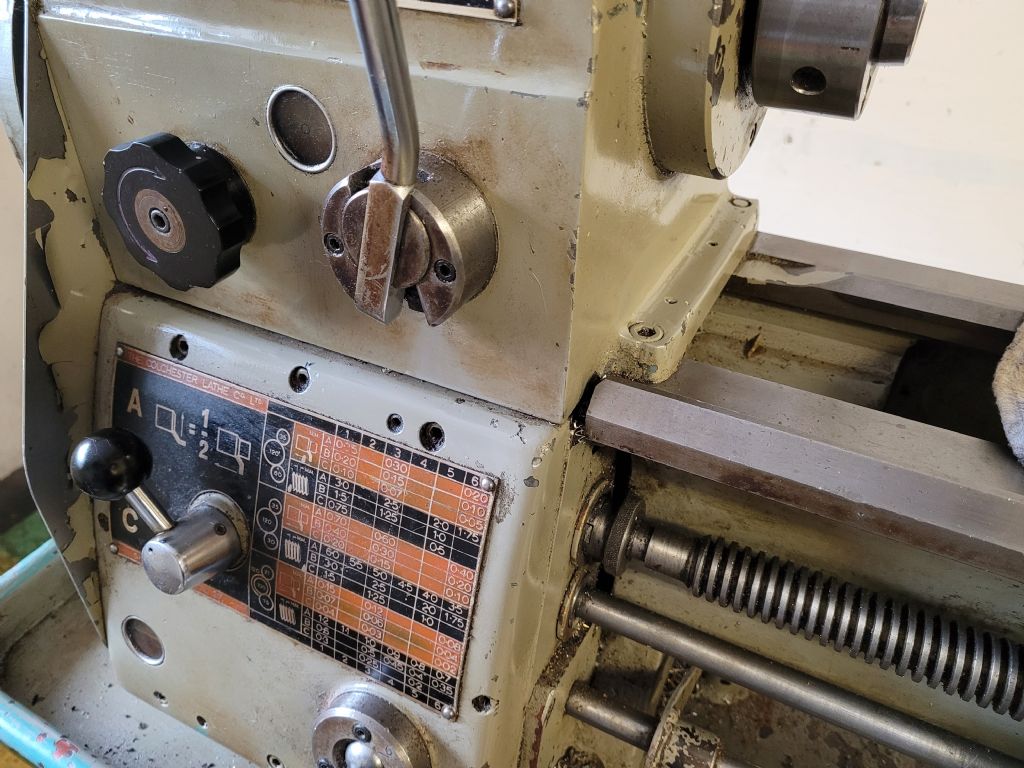

          Although ive no doubt you guys already know what im talking about, heres a picture showing the headstock in question. It looks like two bolts at the front onto the bed and two at the rear. 'Seems' straightforward?
          #557580
          Neil Rimmer 1
            @neilrimmer1
            The front gear box, is bolts and dowls, and can be removed, pulls forward. The head stock is bolted to the main bed, (then lifts up) I removed mine the first time I moved it. The bed on its own, remove the saddle as well. it is still very heavy, but managable.
            The manual explains how to realinge the head. it is not too difficult

              It all depends on how far you need to move the machine. I have the very same lathe and had to move it some distance when I collected it. I used an engine hoist to lift the lathe from the stand and place on a pallet truck. I strapped the lathe well down and with my partner pushing and me pulling was able to move it 200 yards to my trailer. I hated the idea of taking it all apart. I removed the motor, tail stock and crossslide to reduce the weight and try to balance the lathes weight better.

                Thanks guys, unfortunately its located in shed quite some distance away from any hard standing so will have to be carried over lawn. I have another neighbour and his teenage sons on stand by for when im ready!
                So ill have a go at removing the gearbox tomorrow and report back.

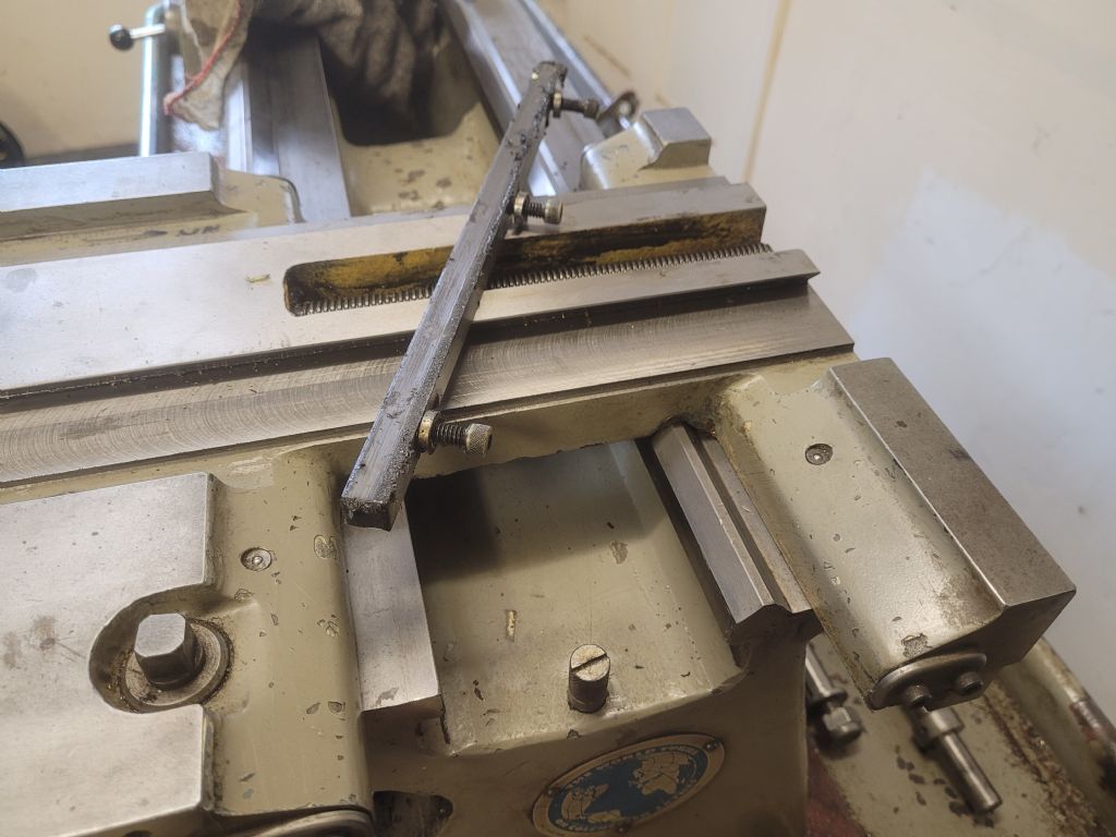

                                Thanks for the info. Ive just tried to do this and im afraid youve lost me a bit with the terminology. Ive removed the shafts and end bracket and also the guide plate underneath the rear side of the saddle. Is that what you call a shear guide?
                                As for the 'apron' im afraid that stumped me!

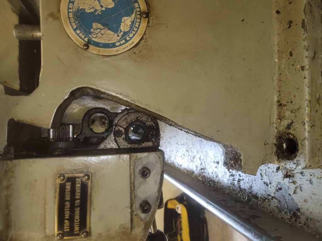

                                    So is this the 'rear shear guide'

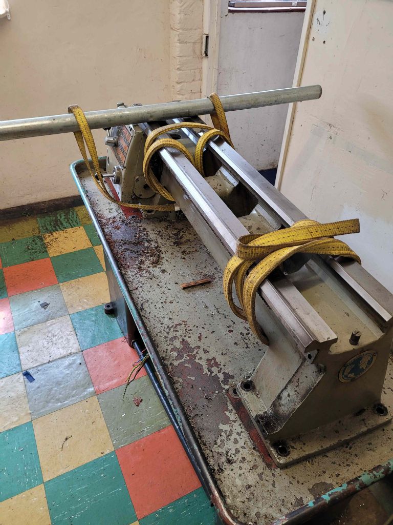

                                      And this is as far as i could get today. Not sure what i need to remove next to take the saddle off:

                                        Gaz, The 'apron' is the lower front part of the saddle which is held in place with four Allen screws. It contains the feed gearbox and half-nuts, plus associated levers and carries the saddle hand-wheel. The rear-shear guide, as I termed it although it is probably more properly called the rear-gib plate or strip, is the part under the rear of the saddle which prevents the rear of the saddle lifting. You will find some shims between it and the base of the saddle. It's all very easy to strip down and re-assemble, as you are probably finding.
