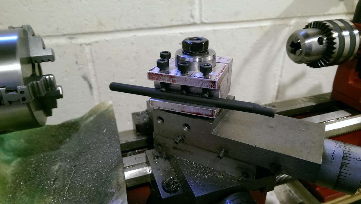

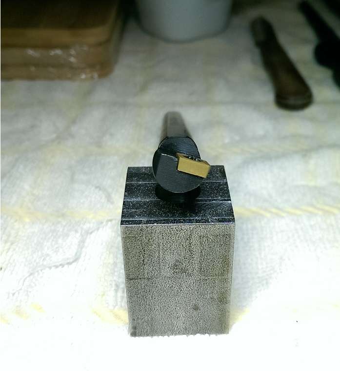

      I just got a set of boring bars.  They seem to be well made and all.  But I’m not understanding why the shank flats are about 17 degrees off from the plane of the insert.
      Is there something special about this type of bar?  Should I still strive to get the cutting edge at lathe center height?
      I’m thinking that this angle is going to restrict the minimum bore since I have to raise the tool height so much to get the cutting edge at lathe center.  I’m tempted to fix them so the insert is level.
      Mike

      #724228
      David Senior
        @davidsenior29320
        My guess is that if the insert was level the minimum diameter possible would INCREASE otherwise the heel of the tip would rub.
        #724229
        MikeK
          @mikek40713
          Good point.
          #724230
          Andrew Tinsley
            @andrewtinsley63637
            Nothing wrong with the boring bar. It is how they are intended to be to be. Note that the cutting point of the insert is at the half height of the bar.
            Andrew.
            #724231
            MikeK
              @mikek40713
              Okay, sorry for the amateur question.  I checked the end against a drawing circle template and it does fit through a much smaller hole than if the insert were level.
              Mike
              #724235
              SteveP
                @stevepye68246
                On smaller boring bars the tips are angled to create clearance between the front of the tip and the bore of the hole being machined.
                Steve p

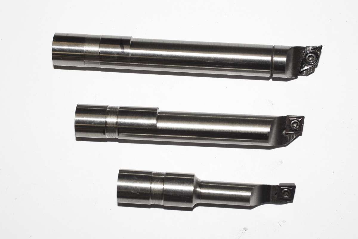

                #724248
                  Some of mine, see how the angle gets steeper the smaller the bar is so the edge of teh insert does not rub
                  #724265
                  MikeK
                    @mikek40713
                    Yeah, that makes sense now.  Thanks.

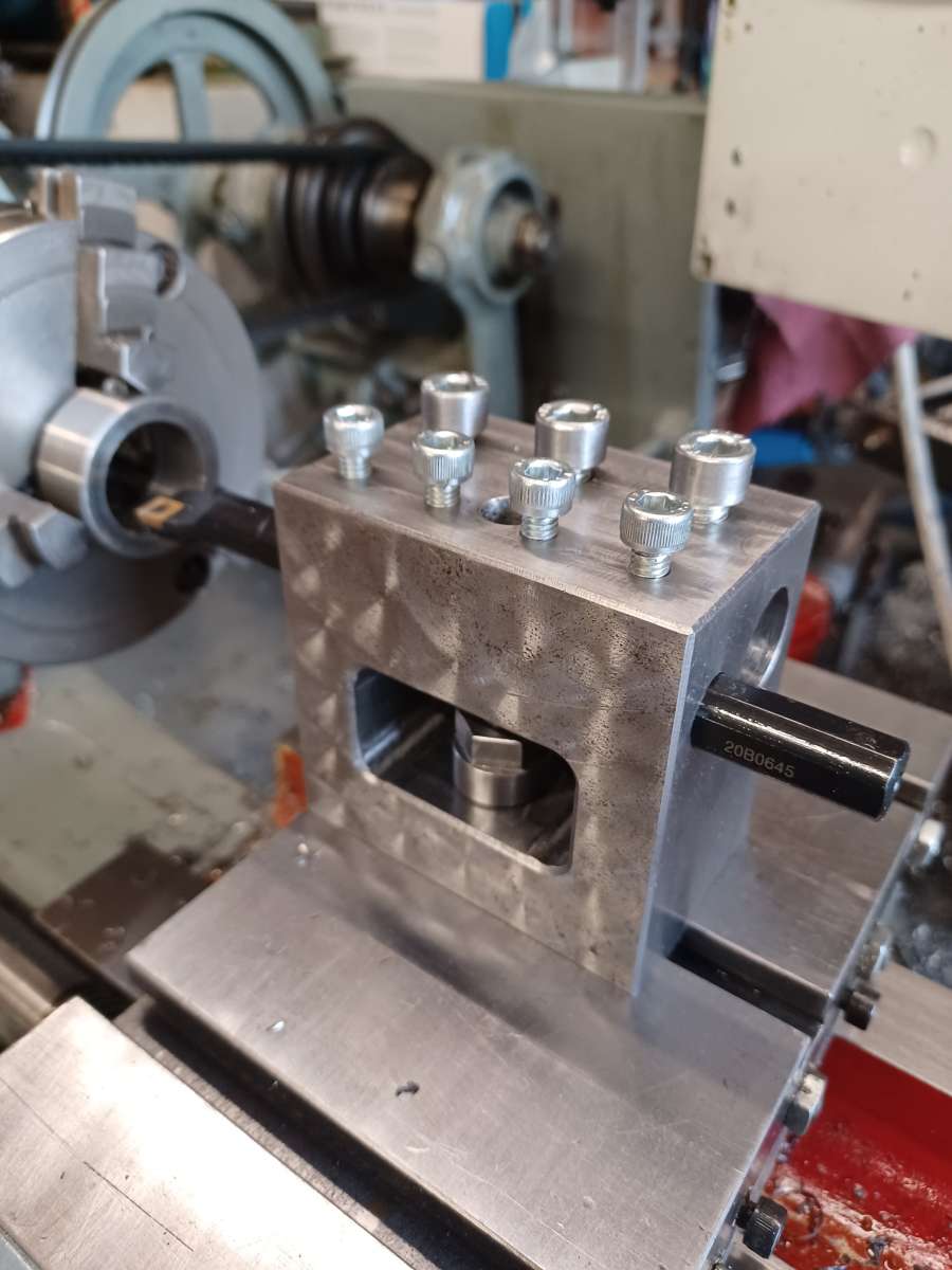

                            #724336
                            David George 1
                              @davidgeorge1
                              I recently wanted a larger boring bar than would fit into my toolpost. I wanted to screw cut a large nut with a full form thread insert and that shape comes in a 16mm size insert and that fitts into a 20mm boring bar. I also found from the supplier of the boring bar that the center height of boring and screw cutting bars have the cutting edge on the center of the boring bar shank. so it was easly to make a new fixed toolpost with a hole on the center height of my lathe and at the same time add an extra hole for smaller boring bars at the same time.

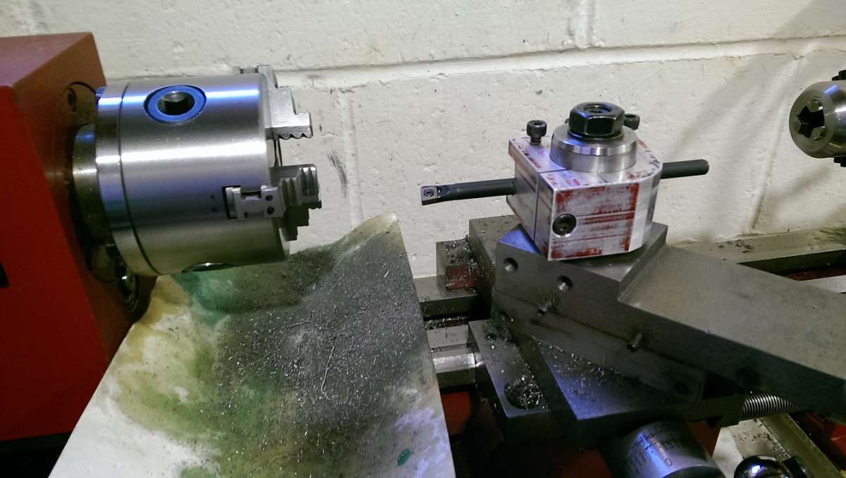

                              #724375
                              MikeK
                                @mikek40713
                                The bar is indeed 7mm.  The set came with 7, 8, 10, and 12mm.  6mm would have been nice, if they insert would fit.
                                This was my setup.  I haven’t made a toolholder specific for boring bars yet, so I used one of my standard ones.
                                I got these bars because I didn’t want to keep using my 2-flute end mill, even though it does a great job.  Have yet to find any enjoyment from using carbide…I can grind my own HSS bits and they cut so much better.  In my experience, carbide complains and leaves a poor surface finish.
                                Mike

                                #724423
                                  Out of interest what diam hole were you cutting, most bars have a minimum diameter and if yours is 7mm then I would expect that to need a 10 or maybe even 11mm hole at the minimum otherwise there is a risk of the holder or insert rubbing which won’t do anything for the finish.
                                  You also mention the carbide “complaining” this can be a result of several things. Excessive stick out is one of them, 5 x dia is the usual suggested amount for this type of bar. Too light a cut can also be a reason as the tool can get pushed out of the cut.
                                  This is my 6mm bar with a CCGT 060202 insert, approx 25mm stick out. First cut is 0.050″ off dia so 25thou DOC and no complaints. Second cut is 0.010″ off dia so 0.005″ DOC and you can hear the high pitch though the finish is still acceptable. EN1A steel, approx 16mm dia hole.

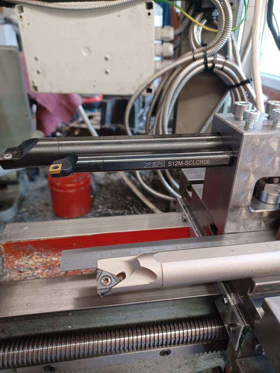

                                      #724449
                                      old mart
                                        @oldmart
                                        I fully agree with Jason about using the sharp polished GT type inserts for smaller cuts on steel. They are sharp like honed HSS and intended for aluminium, but very good with steel. They can stand a certain ammount of interrupted cutting, I like them when boring soft jaws, and thats about as interrupted as you can get. The blunt inserts work best when taking deep cuts, but need rigid support that larger machines have. An intermediate grade would be for stainless steel,which is quite fine edged. Carbide shanked boring bars are better than steel ones because of their stiffness and density, but unforgiving if mistakes are made. I am lucky to have a supply of Densimet at the museum in ground bar form, 1/2″ and 12mm which has both the stiffness and density of carbide bars, but is not brittle and it can be machined. I have made some boring bars for lathes and also for mill boring heads. Here is a pic of one of the boring head tools.
                                        I also take advantage of the boring and threading bars having the tiip height at half the bar size like DG, I was surprised that he was informed that you need a 20mm threading bar for er16 type inserts, I think I have smaller diameters as well as 20mm that take them, I will check tomorror when I get back to the museum, if I remember.

                                        #724566
                                        old mart
                                          @oldmart
                                          I checked the threading bars at the museum and found the 16mm shank one for the size 16 threading inserts. It can manage a smaller diameter than a 20mm and I have made some specials for this size insert which are smaller than the 16mm.
