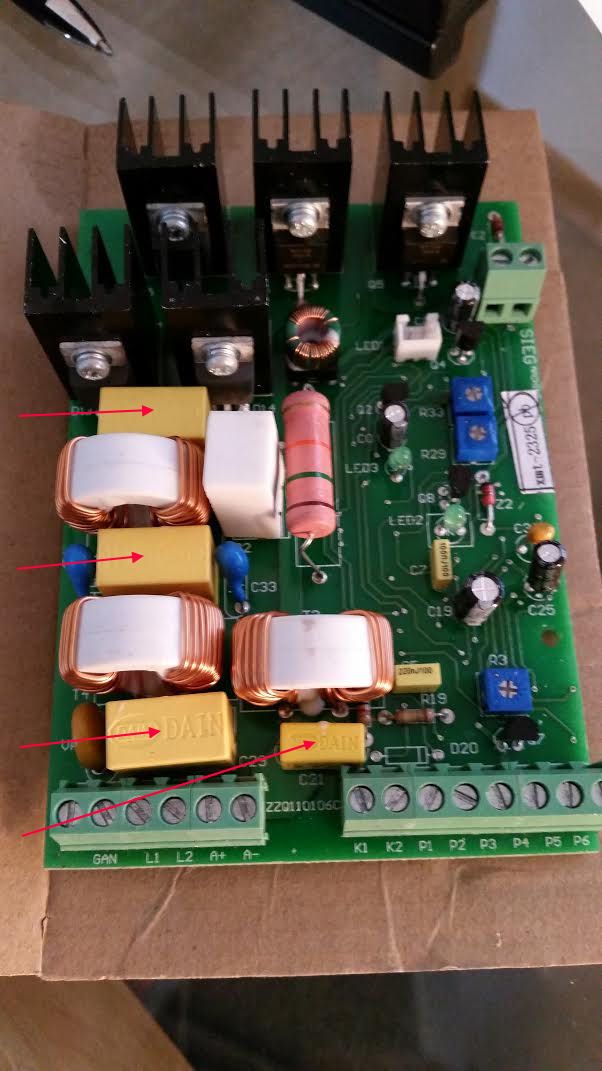

        Hello Creetings, this is my first post so I hope its in the correct place, if not then apologies.
        The lathe is a clarke cl300m, the problem is that the variable speed control only starts to increase the speed after it has been rotated for 1/3 of its travel. The control should be 4.7K ohms but actually measures 4.0K, I would not have thought that this would make 'that' much difference. R17 is slighty discoulred, not burnt, the colours have never been very clear and apear to be browm/black/brown but that is a pure guess.
        The PCB is a SEIG XMT 2325.
        Any suggestions would be gratefully received.
        Thank you.
        Geoff Gould.

            The resistor marking suggest it started life as a nominal 100 ohms. Does it have a tolerance marking?
            It might be worth checking with a meter. If anyone has a similar controller perhaps they could measure theirs and let you know its value.

              From this picture of the XMT2325 I think R17 is the large resistor in the middle of the board.
              If I am correct it's value is 15 K ohms.
              Les.

                    As a repairer of many speed control boards, I can confirm that R17 should read as 15k, its power rating should be in excess of 2 watts. The resistor fitted is of carbon film, really needs to be wire wound if longevity is required…they do dissipate some heat….that particular resistor is also responsible for a high failure rate in boards not working/ working properly..
                    I do not recommend "twiddling" any of the pots on board without proper diagnosis…
                    As to the value of the 4.7k pot, how was this measured?
                    Edited By John Rudd on 13/11/2018 22:21:12

                      Good afternoon gentlemen, thank you very much for your many and quick answers, I was very surprised. A little about me, late seventies and eyesight not as sharp as it was, hands a bit shakey and a faulty memory chip!!
                      Anyway here goes.
                      Tim steadilly got worse not a sudden thing.
                      Brian measured at spot on 14K.
                      Les and John you are quite correct at 15K, seems to be what it was, reads 14K spot on, has a gold band but the other colours have not been good as regards being able to be read from new!
                      Neil sorry mine must be a different board because it does not have a switched pot.
                      John measured (4k.) disconected , AVO 8 Mk6. Also measured from wiper end to end and gives a smooth reading with no dead spots.
                      I have split the answers as memory not good enough to retain all the info. at one go.
                      I checked the F & R switch as I had the board to hand and noted that there was a tendensy for one set of contacts to give a reading, when closed ,sometimes, of 400 ohms. I have ordered a new switch.
                      Something I have just remembered is that when the switch is in 'neautral' the motor will run for a second or give a kick a couple of times, in the falword direction. This happens very very ocasionally.
                      Many thanks for your help and interest.
                      Nothing will be twiddled with the small adjustment pots, they are very well sealed and I don't think it is a good idea. There are a lot of smd's on the back of the PCB and the soldering does not look too clever ( lead free solder?) I don't think that either my soldering iron , not hot enough, or indeed I am good enough to tidy things up without doing some damage!!

                        Hello everybody, first an apology sorry but I got it wrong with the 240 volt reference with the switch contacts being burnt, it was the Motor supply contacts, got my wires crossed (in my head, not physically!).
                        I am very pleased the pot arrived yesterday and measured just a few ohms short of 4.7K. The combination of R17 and the pot has made it into a different machine, instead of being sudden and course the control now starts to operate after about 3/16” of turn. I can control the speed smoothly from just turning, I haven’t timed it but something like 8 seconds to turn 360 degrees. It is completely smooth with no fluctuation which is something it would not do before as it tended to ‘hunt’.
