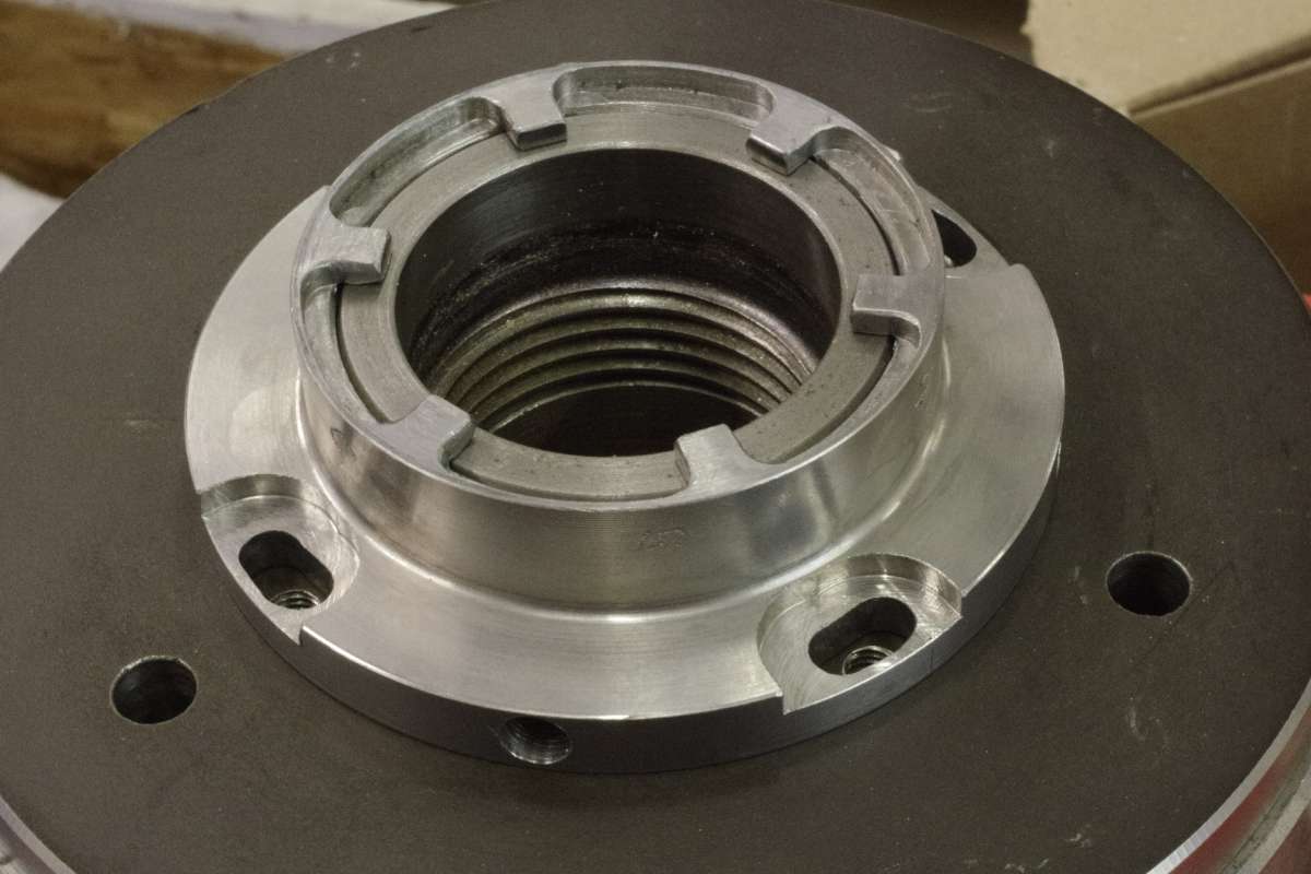

      I have come across several mentions of a clamp to prevent a screw on chuck becoming loose when run in reverse.
      I was looking at my screw on chucks yesterday and wondered how this clamp/latch was implemented, as I could not see an obvious solution to the above. Can anyone enlighten me as to how such a clamp works?

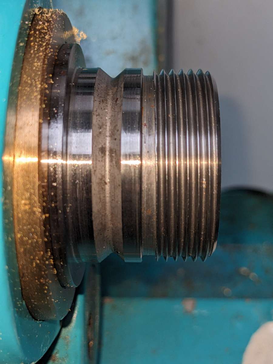

          On the big bore Super 7 (and maybe the others) there is a vee-groove on the OD of the spindle register between the thread and the flange as in the photo.  A set screw in any backplates etc can engage in this to prevent unscrewing.  IIRC the instructions are NOT to fully tighten this as it may throw the chuck etc off concentric – it is only to prevent the accessory unscrewing, not to allow machining in reverse.

            On John Haine Said:
            […] IIRC the instructions are NOT to fully tighten this […]
            That’s an interesting subtlety, of which I was previously unaware John … thanks for mentioning it.
            It effectively means that there is no pressure on the safety mechanism unless and until it is needed … very clever!
              If the set screw had a head or flange, it could be arranged to bottom out on the body of the chuck before the point contacted the groove in the spindle (so the point just floated in the groove). That would prevent any accidental contact where it is undesirable. If would also give some security against it rattling loose if any operation causing vibration was attempted.

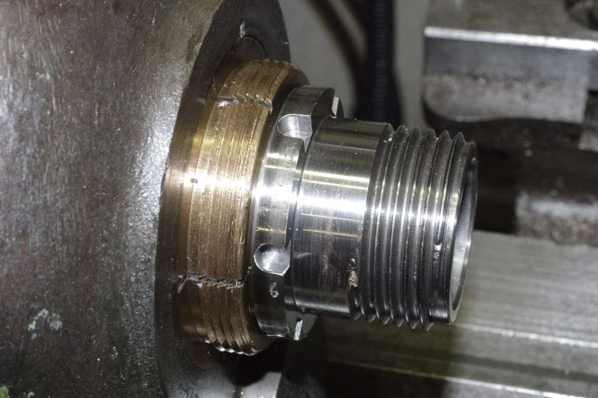

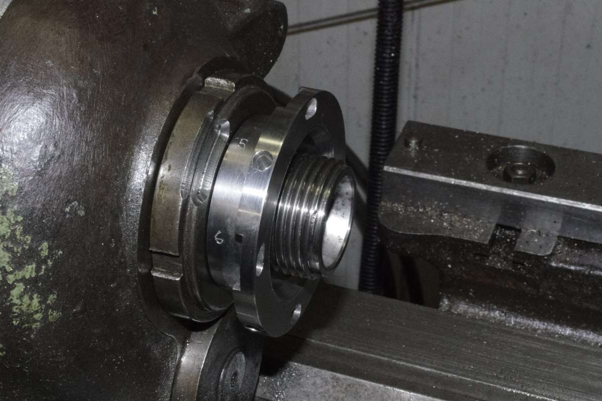

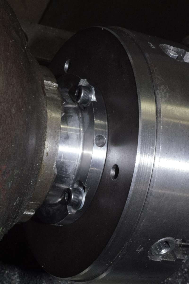

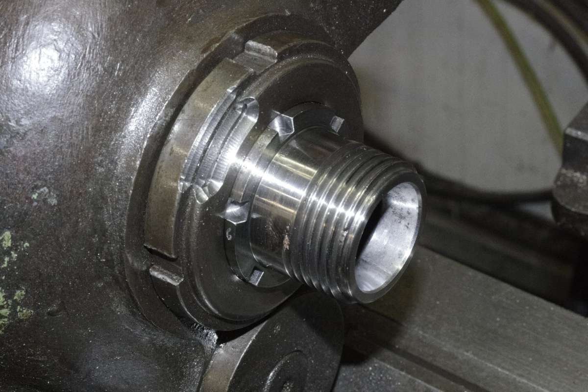

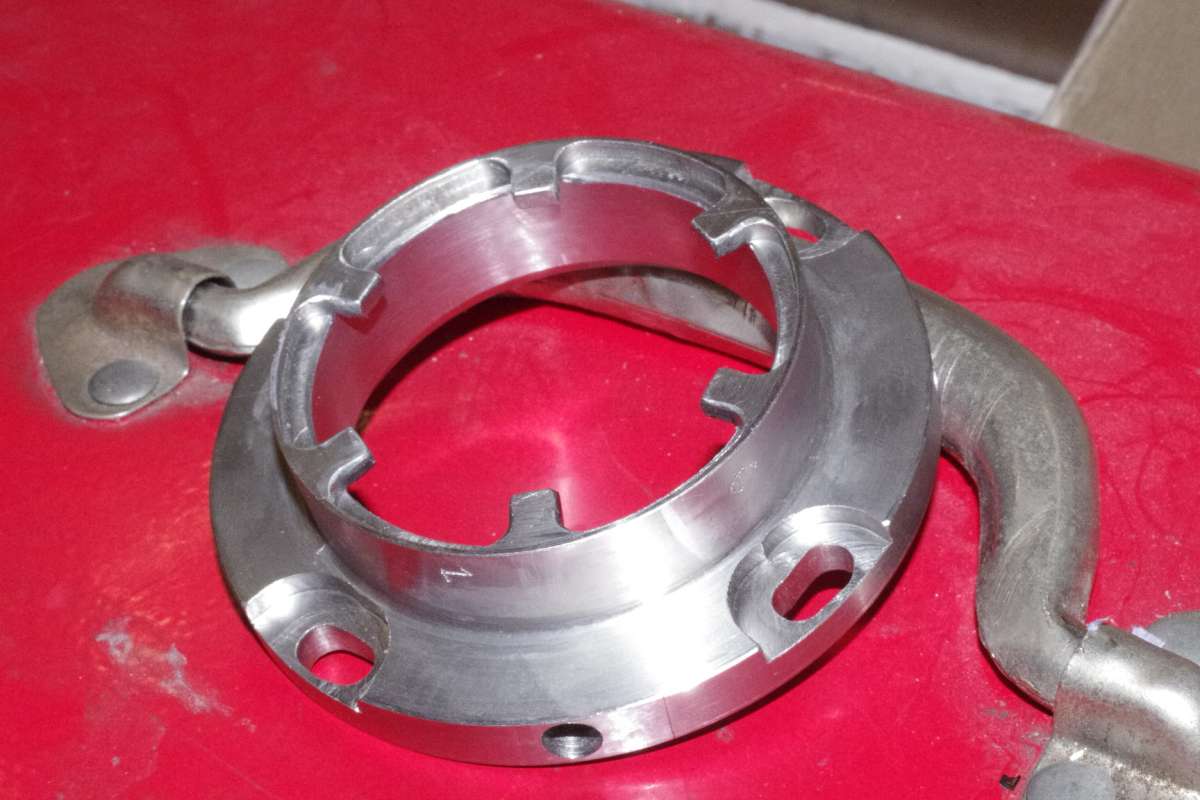

                _IGP2382I made a clamp for the museums Smart & Brown model A which is much more sophisticated, so much so that when I described it in an earlier forum thread, people were not interested. I needed the turning, and milling with a rotary table to modify the lathe spindle and complete the adaptor. Most of the backplates can be fitted with the lock if needed, which is not often.
                _IGP2386_IGP2383_IGP2381_IGP2385_IGP2388
