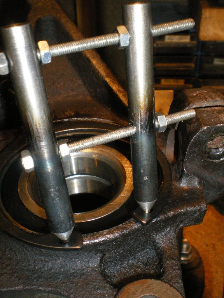

                            Steven Vine
                              @stevenvine79904
                              I had to remove a 70mm internal circlip a while back. As I would only encounter this size once in a blue moon I made this dirt cheap tool. The all thread is 4mm. The nipples that fit the circlip are very short, and hardened. The top and bottom nuts are moved in sequence to tighten the tool and grip the clip. It worked well and the circlip did not fly off. Don't know if something like this will work on an external clip.
