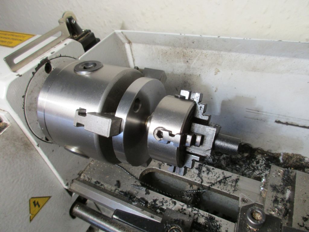

                    If I need to use a small chuck I just put in the large chuck…easy….

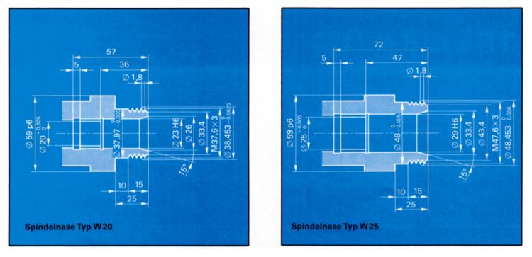

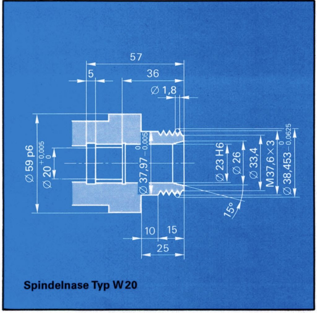

                                        Michael G, sorry to be so long responding. Those Schaublin nose specifications look interesting. Since the thread diameters are about 0.5mm larger than the register size, it looks like Schaublin doesn't belleve in close fitting backplate registers either.
                                        Dave.
                                        #522685
                                          Posted by david bennett 8 on 26/01/2021 04:19:43:
                                          the thread diameters are about 0.5mm larger than the register size […]
                                          Are you sure about that, Dave ?
                                          It’s not how I read the drawings
                                          Sorry about the image size … I grabbed it from the referenced discussion.
                                          Edited By Michael Gilligan on 26/01/2021 08:17:11
                                          #522687
                                            PostScript :
                                            For a much better image … See here: **LINK**
                                            https://www.roesli-maschinen.ch/schaublin/masszeichnungen.pdf
                                            [ isn’t the internet wonderful ! ]
                                            #522782
                                            old mart
                                              @oldmart
                                              It's that dimension at the far right hand side that is causing the confusion with both drawings. The thread sizes are definitely smaller than the registers.
                                              Edited By old mart on 26/01/2021 15:53:09
                                              #522783
                                              david bennett 8
                                                @davidbennett8
                                                Hmm, what do you read the 38.453mm dimension as (on the w20 nose) ?
                                                Dave.
                                                #522785
                                                  Posted by david bennett 8 on 26/01/2021 15:57:02:
                                                  Dave.
                                                  The dimension over the 1.8mm wires
                                                  … What do you read it as ?
                                                  Edited By Michael Gilligan on 26/01/2021 16:07:50
                                                  #522787
                                                  old mart
                                                    @oldmart
                                                    I don't know what it is there for, but the thread size is M37.6 X 3, which is smaller than the register diameter, 37.97mm.
                                                     Now I see, with the larger picture, it is the diameter over wires. All is crystal clear to me now, I hope it is also clear to everyone else.
                                                    Edited By old mart on 26/01/2021 16:07:33
                                                    #522788
                                                    david bennett 8
                                                      @davidbennett8
                                                      Ah, thanks for clarifying – I couldn't read that before . I was maybe hoping it was the elusive clearance!
                                                      Dave.
