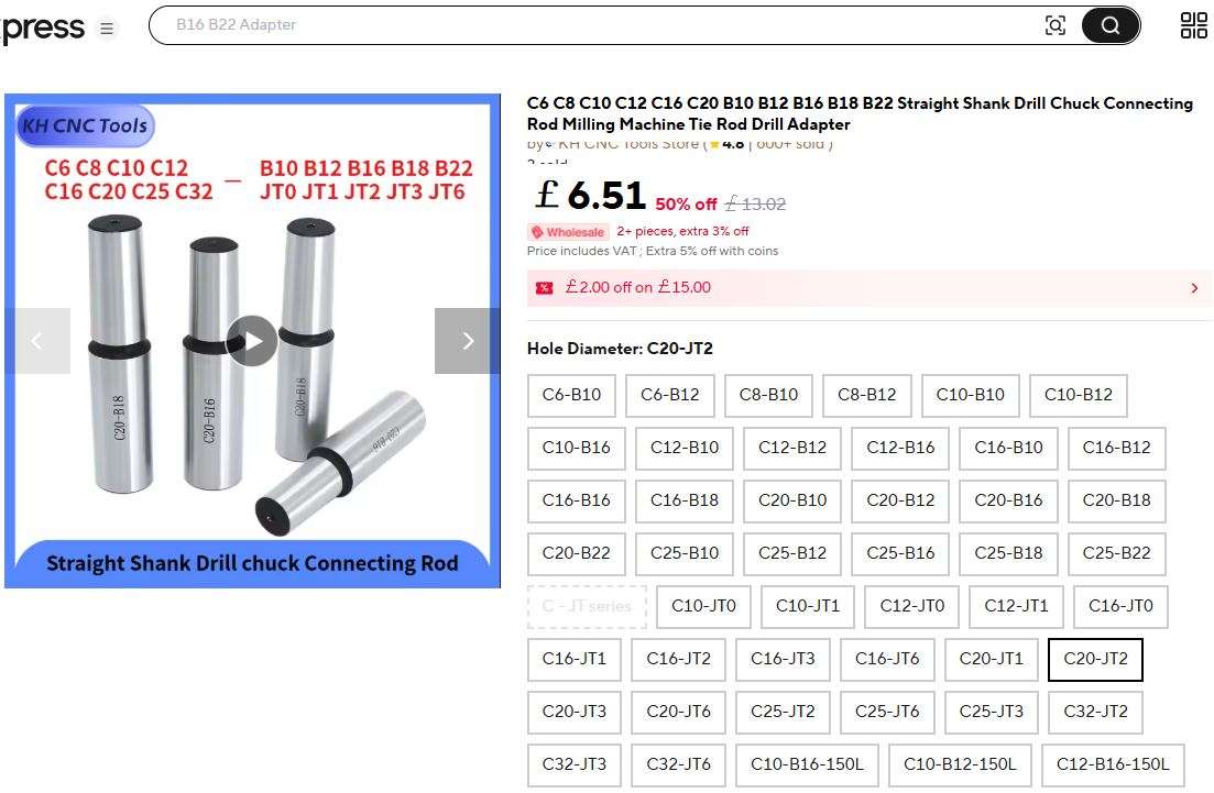

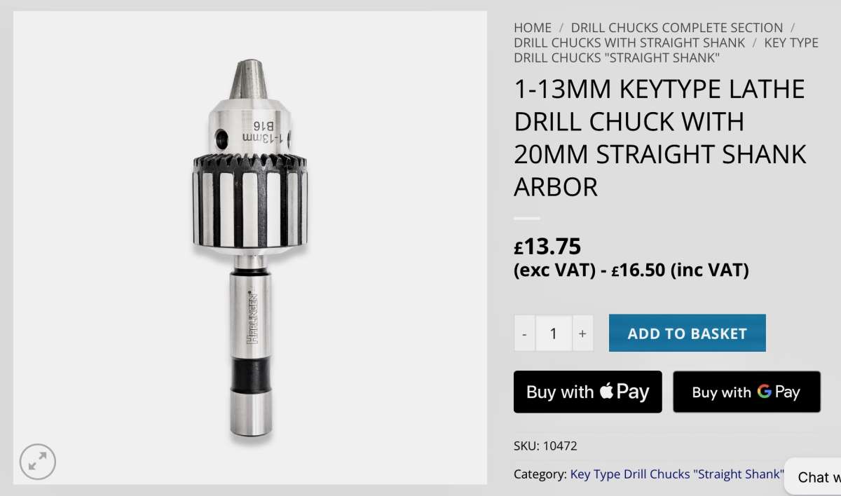

      I don’t seem to have much luck finding arbors in a size I need, at least not at a reasonable price. Case in point, I’ve decided that a straight shank arbor would be most useful when I’m constantly switching between milling and drilling on my mill. I can leave the collet chuck in place and just pop a drill chuck in it. I have two spare keyless chucks. One has a JT2s taper and the other a B18. None of the usual suspects seem to have a 3/4” or 20mm straight shank arbor in this size? It looks like I’ll have to buy yet another chuck, this time with a straight shank on it.

        Maybe pick up a Morse No3 arbor and turn it down;
        JT2-½”  seem to be available, so you could also sleeve one up.

          AliExpress has B18 to 20mm parallel. £11.09 when I looked.
          Shop is ‘CNC Tool Shop’. Description is “1PCS Drill Sleeve C12 C16 C18 C20 B10 B12 B16 B18 Straight Shank Adapter Drill Chuck Arbor for CNC machine drill chuck”

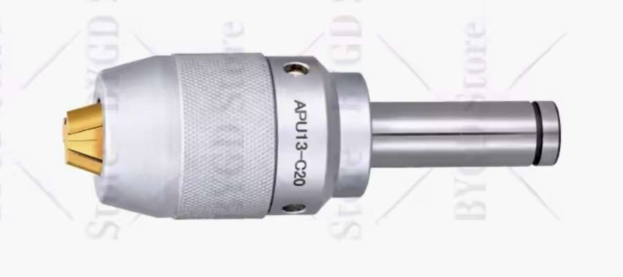

              I’ve been known to be swayed by shiny new kit. Unfortunately the flesh was weak on this occasion as well so I ended up ordering one of these …

                  Will do. I was thinking that I’d need to trim the shaft down on the one I first pictured. I’m not sure it will be necessary on the one I’ve ordered. I’ll have to see when it arrives.

                                    Indeed. The complete with chuck with arbor was £23.39 including delivery.
                                    More than I originally planned to spend but it looked so nice. Hopefully it will be ok when it gets here.

                                      if you did want to make sensible use of your other existing chucks using C20 as your shank search will throw up quite a few parallel shanks as that is the code a lot of the far eastern stuff uses for a 20mm parallel shank. both your tapers here for less than half what you spent
