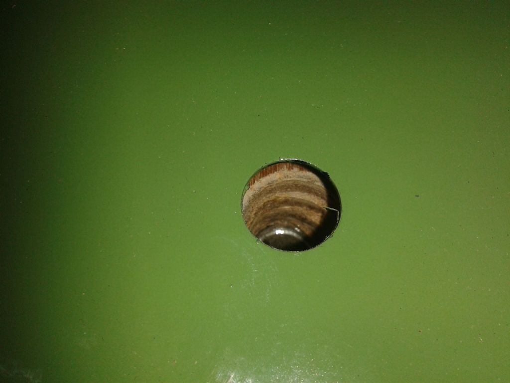

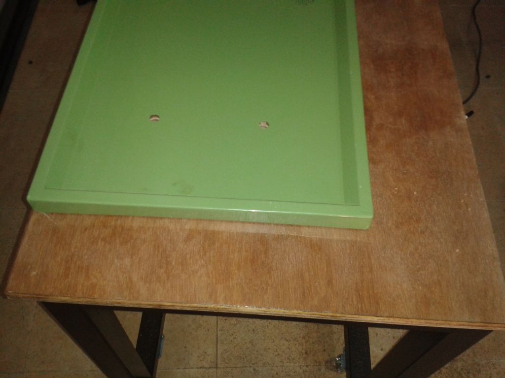

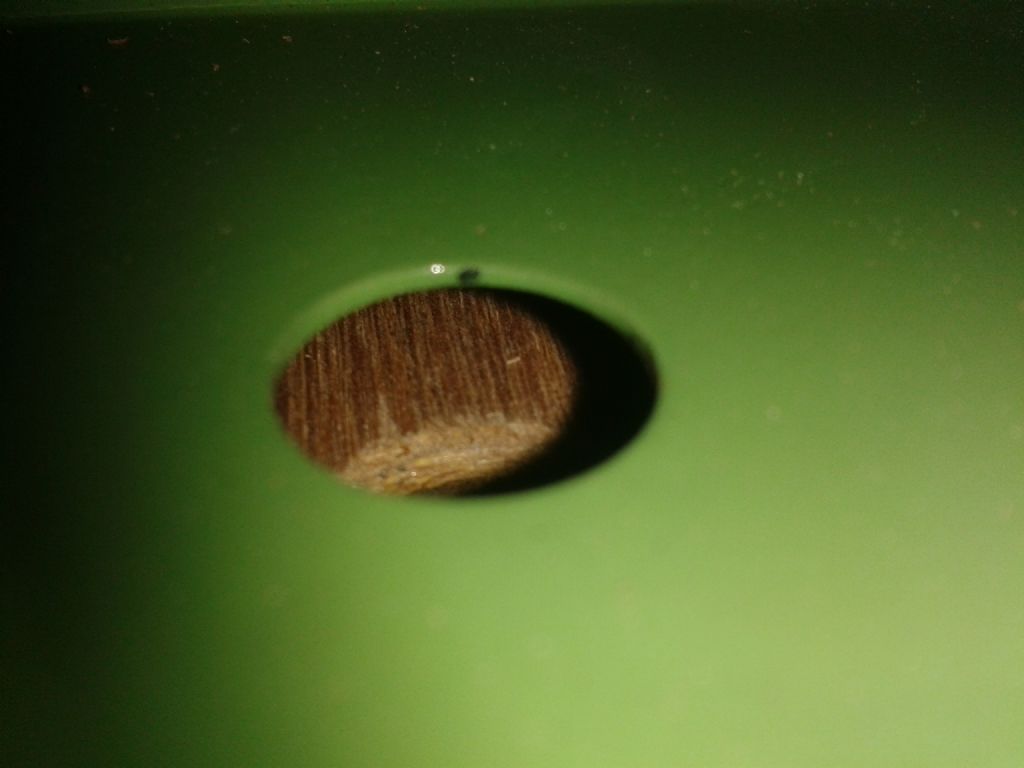

      Now for todays problem, this morning I assembled the bench tops the the benches and drilled the attachment holes for the lathe and mill. I have a lathe tray which will sit on the bench top, now I noticed that this will not sit flat to the top. There is like a 10mm gap, if I had to drop the lathe on it for sure it will distort. The only way I can see round this is to put spacers, but is it the right way to do it? I wanted the lathe to sit flat on the bench…I have seen some of you who have a similar lathe mounted the same way I plan to do.20170903_132041[1].jpg

        David Standing 1
          @davidstanding1
          Brian
          Obvious question……is the tray twisted, or the bench?
          Having a couple of Warco drip trays, they are flimsy and could easily be out of true. If the bench is flat, the action of sitting the lathe on the tray will take the twist out of the tray, and be the end of the issue.
          #315028
          I.M. OUTAHERE
            @i-m-outahere
            What if you cut a piece of plywood that is close to the correct thickness that fits the underside ofthe tray ( fits into the recess under the tray ) and sanwich the lot together ? If it is close to 10 mm you should be able to get some ply to fit that .
            Or if the tray is going to be held only with the lathe mounting bolts a piece of timber or ply sandwiched between the mounting points , tray and bench top would work but the tray could rattle .

            ChrisB
              @chrisb35596
              The bench should be flat, I really hope so!! surprise As can be seen from the top photo, the top is plywood, it's pretty flat. The tray is a bit flimsy but once placed on the bench it is flat with no wobble, but that's not the issue…maybe it's not clear, the tray central surface is raised 10mm up more than the edges, so the edge of the tray will be flat on the bench top but the central part is not, as shown in the last two photos. All six holes in the tray are 10mm away from the surface of the bench.
              Will try to take a better picture.

                #315032

                  Chris, I have similar but much older lathe bolted to a wooden bench. I am sure it is just the drip tray that is slightly twisted, dropping the lathe on top will flatten it without any problems. See my website for my setup and installation. Mine did sit flat but yours may be designed more for the cabinet stand, a packer underneath will sort it. Put some silicone sealer around the holes so that no oil or coolant can seep underneath.

                    I just looked at my Warco Trays for a WM280 and a WM18 which are on Warco pedestals.
                    Neither tray is designed to sit flat on a bench. Both trays overhang the pedestals. All the weight is taken on the flat bottom with the edges in space. On a pedestal the difference in level between edge and bottom doesn't matter. The edges of the WM18 tray are about 5mm higher than it's bottom. The edge of the 280 tray is about 10mm lower, which matches Chris's description.
                    I think Ian has the right answer. A weight bearing plate under the lathe tray to level its edge with the bench, and a gap filler around the milling tray to stop things hiding underneath.

                      I had the same issue when I mounted my wm250v. I cut a piece of 12 mm mdf to fit under the tray and bolted through. I put a bead of silicone sealant around the bolt holes as I use coolant and around the perimeter of the mdf so the tray won't rattle. The lathe feet are also sealed with silicone.

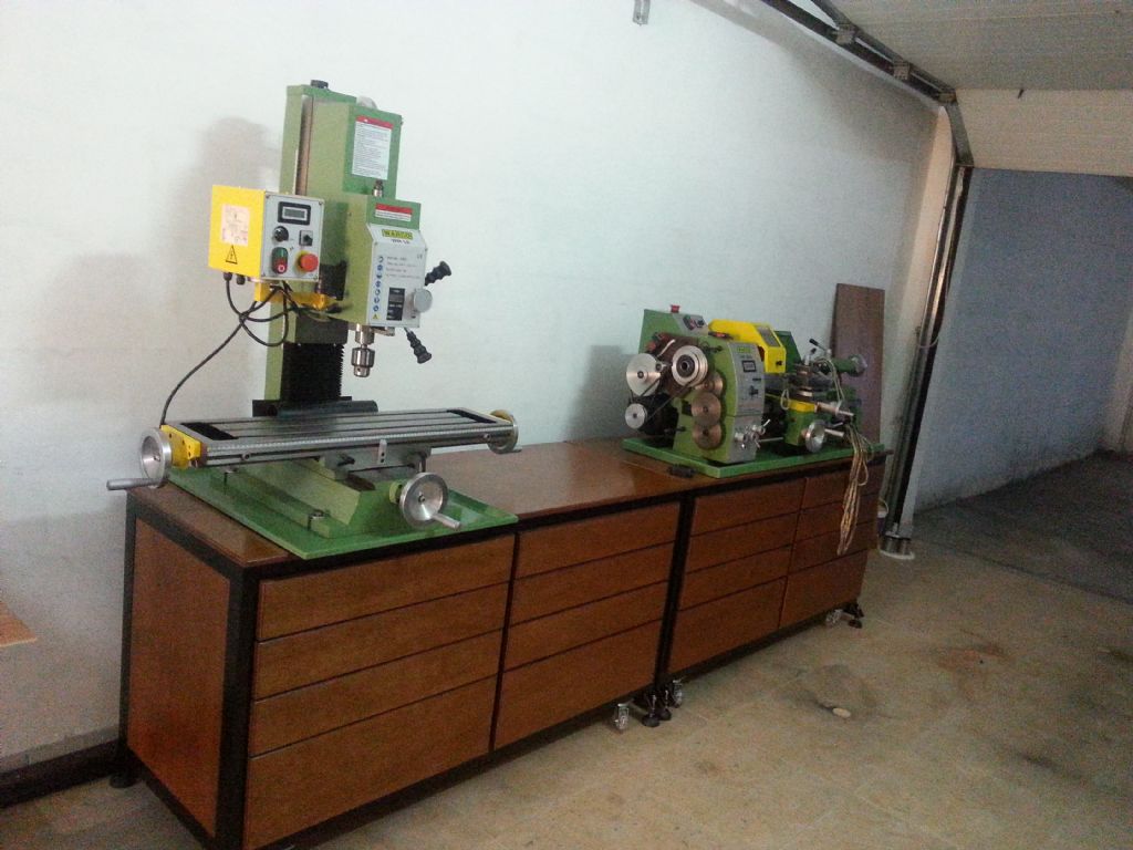

                          Right, so I finally got the first two benches for the lathe and mill ready. Still have to finalize the other workbench, but for that I have some parts on order and still not sure what bench vice to mount on it….so for now I'm leaving it and concentrate on the other two.
                          Lifting the lathe onto the bench is not an issue as I have already tried it out, and will install the lathe this Wednesday when I get the filler piece of mdf for under the swarf tray. My issue is lifting the milling machine. The WM18 is quite heavy, if I'm not wrong it's heavier than the WM280 lathe. I'm using a chainblock with 1000kg lift capacity so it should be fine. What I can't figure out is how I'm going to sling it, from where …. My initial plan was to sling it around the both sides of the table but I'm not sure if I'll damage it this way…any ideas?

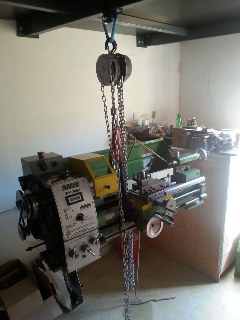

                            Now that you've sorted the need for a spacer beneath the chiptray for the lathe, how about this for a suggestion for siting the milling machine.
                            It looks as if your benches are on castors, and have adjustable feet, so:
                            1) Move the Mill head to the bottom of the column and clamp it there, firmly.
                            2) Rig a shearlegs and , with a sling around the head of the Mill, hoist it as high as possible with the chainblock.
                            3) Roll the bench under the Mill whilst it is in mid air
                            4) Lower the Mill onto the bench, and bolt it down.
                            5) Remove the sling, chainblock and shearlegs.
                            6) Roll the bench to where you want to site it, and screw down the adjustable feet.
                            Plug in and play!

                              As Howard says put the sling under the head towards the column making sure you don't trap any cables. Any tilt can be adjusted by moving the table in and out.
                              Alternative is to split it in two – base and table in one part then column and head in the other can then be lifted by two people.

                                Like the drawers – looks neat enough to have in the living room.
                                Rather than the dinky little wibbly wobbly screw feet it would be easier to make a carefully sized wooden lever/fulcrum that allows you to stand on it to lift the end just enough to slip some 2×4 under the end to support it firmly.

                                  Thanks Bazyle, in the living room, erm…wife says NO! smile p
                                  The feet might look ''dinky little wibbly wobbly'' but believe it or not they are rated 500Kg each, so with 4 at each corner the bench should handle 2tons! surprise I opted for them as they looked robust and being of the pivoting type they would compensate for any unevenness of the floor (or rather the bench!) This is what I got: **LINK** In case these do not work out as intended of course your tip will be made to good use!

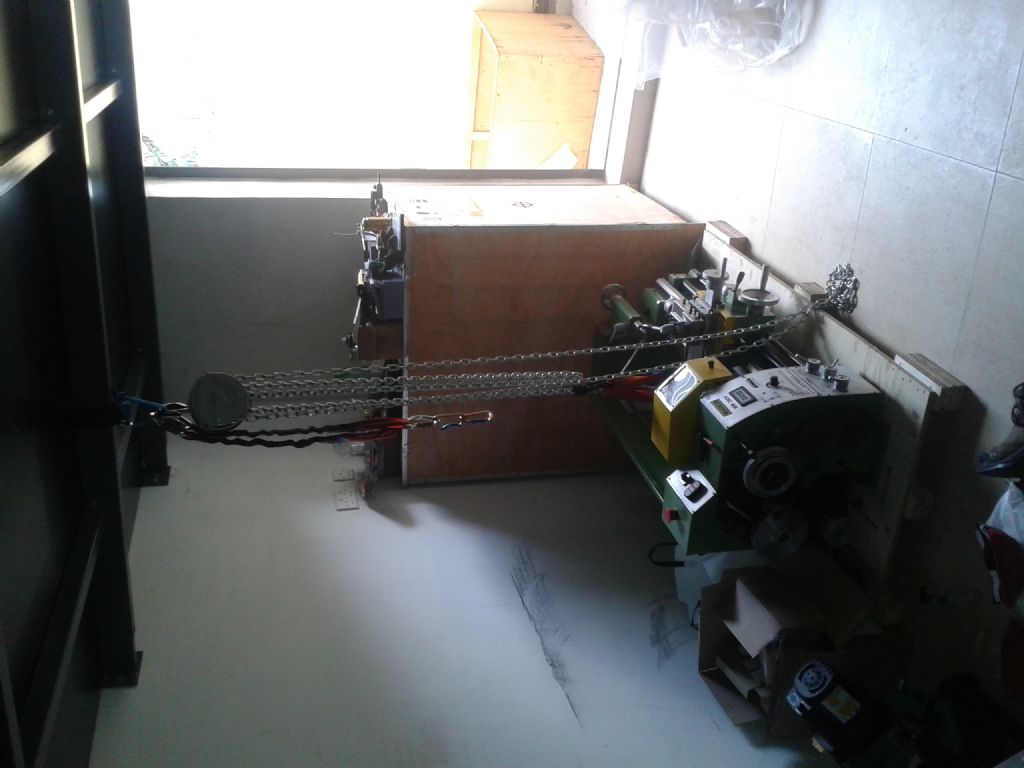

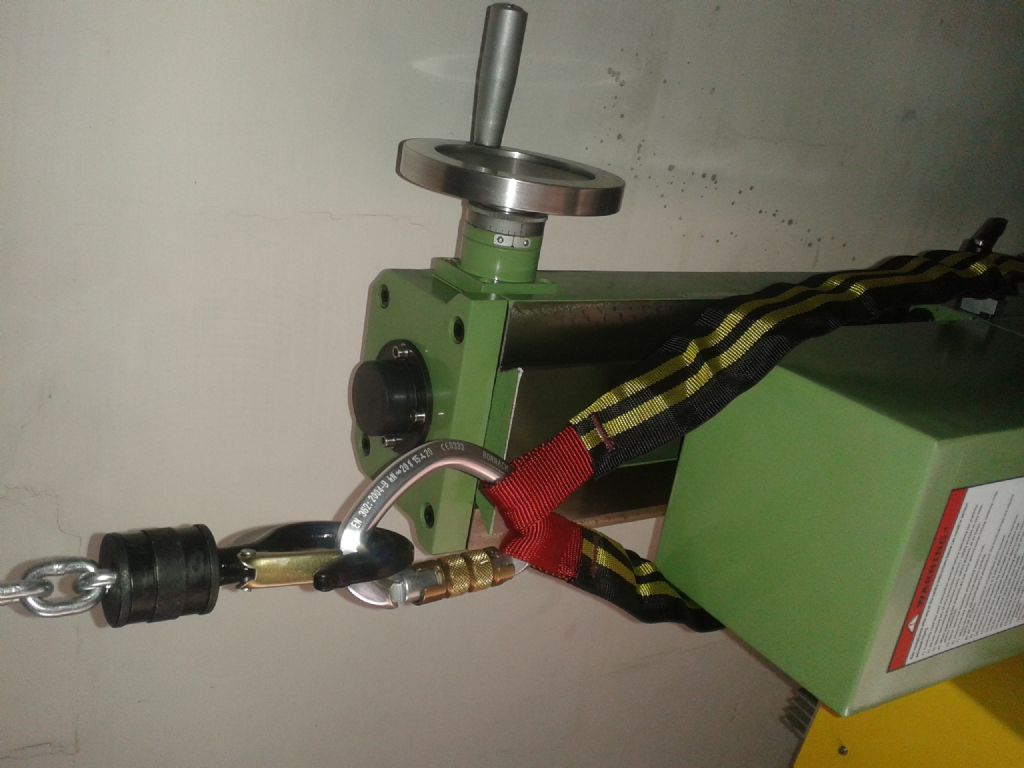

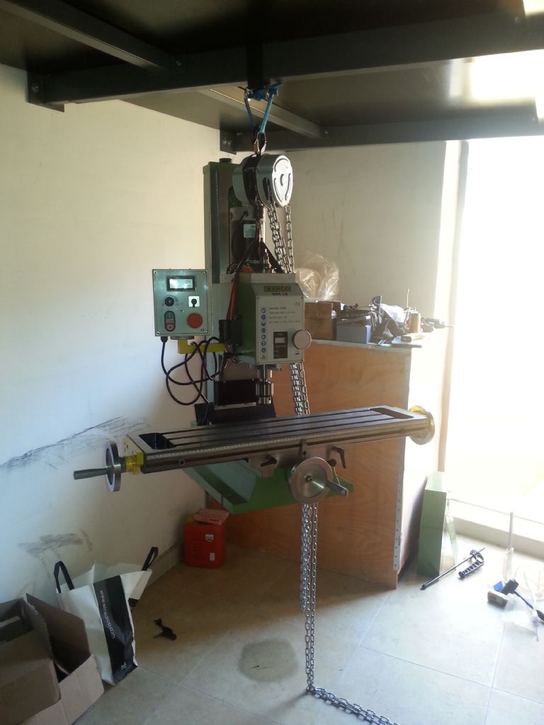

                                    Hey Howard, thanks…I built the benches on casters for exactly that reason, the chain blocks is attached to a rafter so I can lift the machines and push the bench under. The problem with the mill was from where to sling it.
                                    If I sling it something like this it should do?
                                    PS: Sorry for the sleeping photos, don't know how to wake them up!!

                                        This afternoon I had a go and lifted the machines on to their respective bench, no issues with the lathe, went right in its place, not so with the milling!! Due to the chain blocks being attached to a rafter there was not enough height to clear the bench. After some head scratching and half a dozen lifts later I used a couple of carabiners and a short sling and just managed to get it in place…phew!
                                        So this week will finish setting up and aligning the machines and their benches, do a good clean up and and wash the workshop, then I can start thinking about make lots of swarf…after I get the tools that is! embarrassed

                                                  Hi Larry, the swarf tray has been sorted, I placed a 10mm thick piece of mdf under the tray, then the lathe went on top. It's flat and ''level'' now.
                                                  Posted by Bazyle on 07/09/2017 20:08:38:
                                                  Now that's what I call a living room laugh
                                                  I don't think I would have dared take a break to take photos though. Reminds me of lifting my mill with a Haltrack 12:1 pulley block. It meant about a 30lb pull but I wasn't gong to stand nearby so with the angle of pull I kept sliding across the floor until I braced myself against my rather heavy solid timber bench.
                                                  To be honest I was a bit uneasy with the machines 3 feet off the ground, I kept asking myself ''sure you slinged it right Chris? And if it fell, will it break?'' etc… but I was wearing a safety shoeswink 2

                                                    Was the mill OK being lifted under the head? I was concerned about putting stress on gear teeth in the z axis.
                                                    #341555
                                                    mechman48
                                                      @mechman48
                                                      Posted by Ross Lloyd 1 on 14/02/2018 21:11:53:
                                                      That's how I lifted my WM16 onto it's stand… worked fine no damage.
