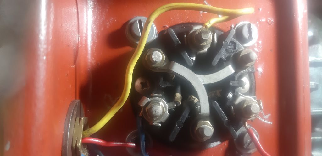

      Just bought myself a Chipmaster. I need to run it via a VFD. My (basic) understanding g is to use the VFD I've bought the motor needs to be in the delta configuration. All of my searches to date of motor windings all have very mucky labelled square connection boxes with straight connectors
      I pulled off the cover on my starter and the connections dont seemed to be labelled (it's very akward to see due to the position of the motor below the variator) and its round with a couple of very nice curved links. For the life of me I cannot reconcile this with the all the vids I e watched. Can anyone help? I took some photos but haven't worked out how to upload them yet!

                I think if you read his post with rather less of a pedantic eye, you will see that his use of 'starter' is a slip of the keyboard.
                Where he says, "(it's very awkward to see due to the position of the motor below the variator) and it's round with a couple of very nice curved links", he is indeed talking of the connection box on the motor itself.
                The motor on the Chipmaster is of an old style that uses a round terminal block rather than the more modern rectangular one that is shown in the pictures he has seen.
                The form factor is not relevant. It is just a six wire terminal block, currently wired in star. All coil ends are brought out to the terminal block so delta is not a problem.

                    Blimey I've just zoomed in on my own photo. Is that small labels on the wires?
                    #559828
                    DC31k
                      @dc31k
                      The wires are labelled. The motor is connected in star. Red, blue and yellow are the three incoming phases from the control box. They connect to one end of each of the three motor coils. The other end of the motor coils are under the curved link bars.
                      You can easily rearrange it to delta. You will end up with three wires on three terminals: one incoming phase wire, the 'beginning' of a coil and the 'end' of the next coil. The three unused terminals can be used to store the now unnecessary link bars.

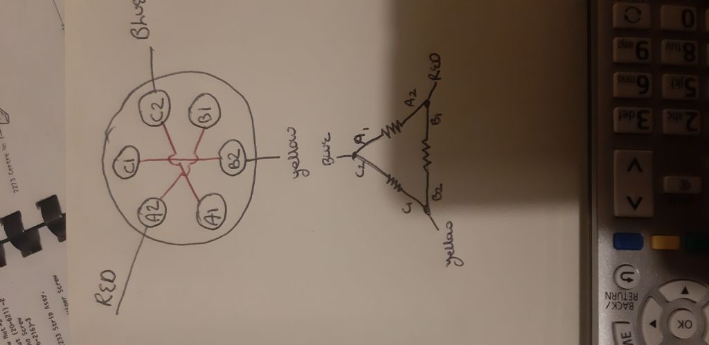

                          I wasn't sure about moving the winding wires so I made up some short jumper cables and reconfigured (I think) to delta. Does it look ok to you?
                          #559861
                          DC31k
                            @dc31k
                            Looks good.
                            If you want extra peace of mind, you could remove the jumper wires and measure the resistance of one coil (or all three individually and average). Add back the jumper wires but not the phase wires and measure the three phase-to-phase resistances. They should all be the same and you can calculate the value relative to one coil.

                              Looks OK to me as DC3 has said check the resistances just to be sure. Good luck Noel.

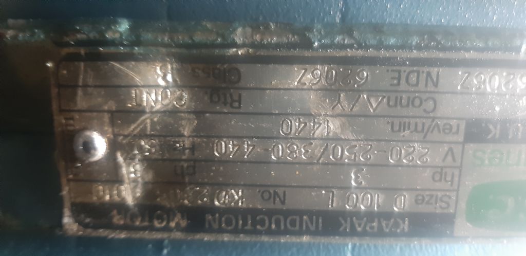

                                          Thanks everyone. My windings are labelled so I'm ok with their orientation. I found a formula that relates the number of poles to the motor speed and frequency (both of which are listed on the motor plate). It turns out I've got a 4 pole motor and the VFD was defaulting on 2. Motor is running nicely now at 50Hz.
                                          I fell like I'm getting there slowly. I just need how to learn to fault find on all the stuff between the motor and the VFD!!
