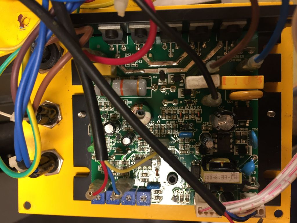

                  Thanks John the board is a Best BC 2000. I will try the test with the lamp. If it is the pcb can you check for faults that could have caused it to fail.
                  #382350
                  John Rudd
                    @johnrudd16576
                    John,sure….could you post up a picture of the board please?

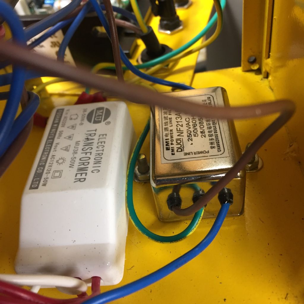

                        Hi John the plot thickens. I disconnected the motor and connected a 60w lamp switched on the lamp lit the speed indicator hunted with random numbers, I adjusted the speed control and varied the lamp brightness. I reconnected the motor switched on it tripped I then reconnected the lamp it tripped, I will post some pictures as soon as I have worked out how to do it many thanks John
                        #382411
                        John Millis
                          @johnmillis57685
                          95da7cf5-beb4-4fe8-b49f-e2dda9736af3.jpeg8969e9d4-3be4-49c2-ba90-8f9590222e23.jpeg3040253a-9ba4-436e-ab02-a435c0e28179.jpegHi John steep learning curve photos attachedb9be8083-3324-45d4-86ed-101980f402dd.jpeg

                          Martin W
                            @martinw
                            Hi
                            Having read your posts of what is going on I wonder if the fault is with the controller board. You also say the speed display is unstable/flickering which I wouldn't necessarily associated with a fault on the control board, admittedly they are in close proximity with each other both physically and electrically. In your pictures there is an electronic transformer with a 12V AC output and I wonder if this is used to power the display circuitry. Looking at the picture of there appears to be 2 dirty/sooty marks where the white wires enter the supply, they could be shadows but they look more like definite marks which may indicate a problem with this unit. It may be worth disconnecting this unit from the mains supply and running the bulb test etc. again just to eliminate this unit prior to trying to repair or replace the control board.
                            Cheers

                              #382439
                              Les Jones 1
                                @lesjones1
                                I think Martin W is thinking along the right lines. I suggest disconnecting the live and neutral connections to the electronic transformer and see if the problem still occures. I can't read all of the lable on the electronic transformer so I can't tell if it is one designed for low voltage (12V) QA lighting. I assume that the PCB with the Atmel chip on is the tachometer and is probly supplied from the electronic transformer so it will probably stop working at all with the mains removed from the electronic transformer.
                                Les.

                                      @lesjones1
                                      If the design is the same as the 20V of Dave W's then look to see if there is another small transformer and rectifier that powers the tachometer board, If so try disconnecting the mains supply to that. The fact that is displaying anything other than zero when the motor is not running is an indication that the fault may be in that area.

                                        @martinw
                                        The electronic transformer is marked as supplying 12V AC 20W – 50W, if this is used as a circuit board supply as well then it would need rectifiers and smoothing circuits as well. Computer fans will not work if connected directly to this electronic transformer as they normally require to be supplied with 12V DC power and not AC. If this electronic transformer is solely used for a lamp circuit then there will have to be another psu circuit to supply the tachometer circuit see Les's post immediately preceding this. Good luck and lets hope it's something fairly simple and inexpensive.
                                        Martin W
                                        Edit for addition.
                                        Does your mill have a low voltage light fitted? I have looked at the Chester site and can't see one on their current version of the 16V mill. A problem with a lot of these electronic transformers is that if they are run below a minimum load the output voltage can become unstable and fluctuate randomly between 0V – 12V.
                                        Edited By Martin W on 27/11/2018 01:35:08

                                                    Hi Martin thanks for your posts. The marks on the white transformer were shadows not soot or scorch. I disconnected the supply from the main board to the speed control potentiometer and with the motor still connected switched on and did not trip the speed indicator showed 0000 and did not flicker I left the power on for sometime and nothing happened. Is it possible that the potentiometer could be the fault if so how can it be tested. As you can probably guess I am not particularly electrically savy I can wire a 13a plug and that’s about it. Once again many thanks to you all for your time and trouble to help me out John

                                                      @johnrudd16576
                                                      Given your technical savvy level ( no disrespect meant or implied, we cant all be clever clogs..) I'd suggest changing the potentiometer with a new one….Just note where all the wires go.. ( photos or sketches work well )
                                                      What happens if you reconnect the pot to the speed board? Does the rcd start tripping again?..
