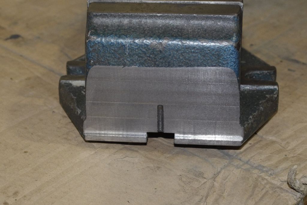

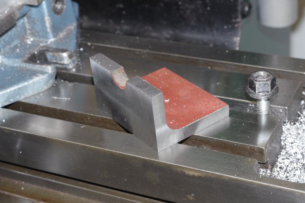

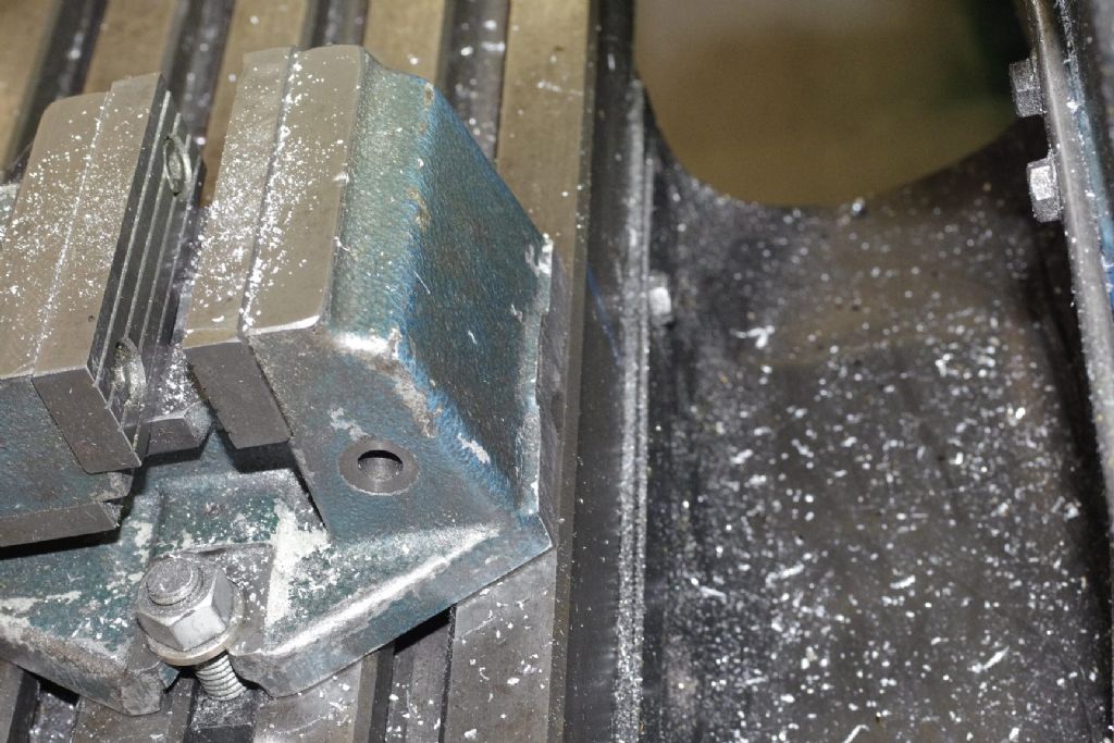

      _igp2549.jpg_igp2547.jpg_igp2545.jpg_igp2544.jpgThat ARC 5" vise which I bought is a copy of the Kurt, not in the same league for quality, but at 15% of the price what would you expect. It benifits from the Stevenson spherical improvement which does help to minimise the jaw lifting. The first Bison 6512 type 100mm vise came with the drill mill, and I was extremely lucky to get another complete with a swivel base in unused condition for 20% of the list price. The two Bisons make a useful pair, although they are of different ages, the height is matched within 0.0005". On one, I have removed the rear lug to allow more Y axis movement on the mills, but have made a bolt on lug for when the vise is used lengthways on the mill.
