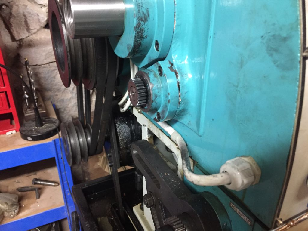

  • #380506
    Robin Graham
      @robingraham42208

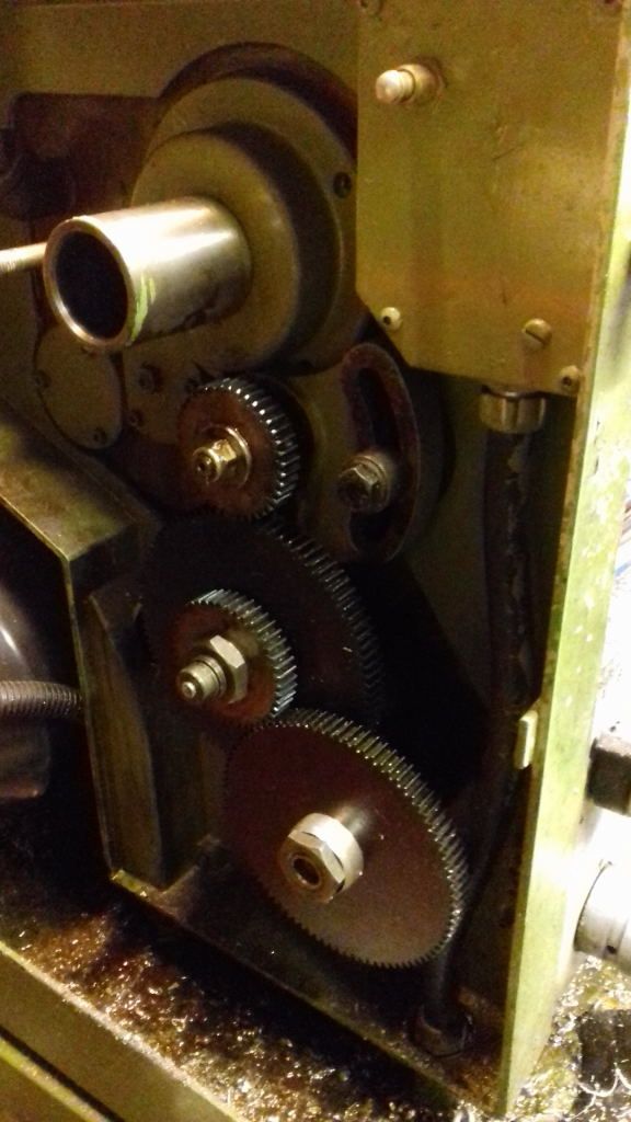

      Either I'm missing something blindingly obvious (quite possible!) or there's summat wrong with my lathe.
      Here is how the wheels are set up – they've been this way since I bought the machine, and I've had no need to change anything (it's a gear head, I've never needed to exceed the range of feeds/threads offered by the gearbox with this setting before now):
      Well, that's come out sideways for some reason (can anyone explain why this happens?) but what you're looking at is a 24T driving a 120T idler on the banjo driving a 48T on the input to the gearbox.
      I want to cut a 2mm pitch thread, so:
      just swap round the 24 and 48T and use the 127T as an idler. The only reason for using the 127T is (as far as I can see) that a straight swap of the 24/48 would lead to the outboard spacer on the 24T fouling the 127. So are you meant to turn the idler so the 127 is nearest the headstock? But then the spacing is wrong – the 120/127 wheel is made in one piece and runs on bearings which seem to be press fitted to the shaft which bears on the banjo, so I don't think I'm meant to shift it along the shaft.
      I'm really hoping that I'm being stupid here and someone with the same or a similar machine will point out a simple solution so I don't have to machine parts unnecessarily.
      Robin.

            #380514
            Hopper
              @hopper
              It makes no difference to the overall gear ratio what size idler you use. Irrelevant to the ratio whether you use the 127 or 120 as an idler. All that matters is the ratio of the first and last gears in a simple train like this.
              There should be some provision to move the stud the idler gear mounts on to accommodate different sized idler gears. Have a close look at it. There should be some kind of slot, or eccentric that allows the stud to move, or the stud should be mounted on a quadrant bracket that can be pivoted to change the stud position relevant to the other two gears.
              In your photo it looks like there is a quadrant, the grey piece about 20mm thick in behind the bottom gear. Pull the large idler gear off and have a look at what is going on there. If in doubt post us a photo of what is there.
              Details of the make and model of your lathe would help others with the same machine offer their experience.
              Edited By Hopper on 13/11/2018 23:40:18

                  #380670
                  Howard Lewis
                    @howardlewis46836
                    If the Leadscrew is Metric, and you are cutting Metric threads, as long as the meshes are correct for backlash, the choice of Idler is immaterial. The important ratio is between the Driver and the Driven. The Idler fills the space between the Driver and Driven and ensures that both rotate in the same direction, unless you want a Left hand Thread.. If so you need to insert another Idler!
                    If you want to cut an Imperial thread, then you do need to compound the 120 and 127.
                    Howard
                    #380674
                      Posted by Les Jones 1 on 14/11/2018 08:46:47:
                      I assume thet that the 127T gear is the one closest to the headstock and the bottom of the picture is to the right.
                      Remove the outer gear (The one with more than 127 teeth.) …
                      I beg to differ, Les
                      The opening post includes a clear description of 'what you're looking at'
                      … 24T driving a 120T idler on the banjo driving a 48T on the input to the gearbox.
                      Edited By Michael Gilligan on 14/11/2018 23:01:25
                      #380682
                      Robin Graham
                        @robingraham42208
                        Thanks for replies.
                        I should have said that the lathe is (was- now obsolete) an Axminster version of the generic '12×36' machine marketed with minor differences by Chester as the Crusader and in the US by Grizzly as a gunsmith's lathe. The late lamented John Stevenson who helped me install it said it was a Harrison M300 clone – but the arrangement of the wheels between the motor and the gearbox is quite different from the Harrison.
                        I understand that the size of the idler doesn't matter, the only reason for using the 127T is to give physical clearance for the other wheels.
                        I've had another look and I'm now pretty sure that it just can't work without without making some new bits. Not a massive problem, but I'm surprised as the machine has been faultless in other respects.
                        Robin.

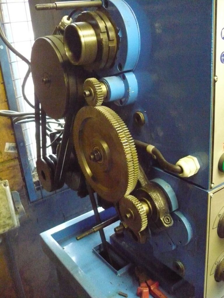

                            Hopper
                              @hopper
                              This thread here **LINK**
                              includes pics posted by Mr Stevenson himself of a remarkably similar looking lathe, showing the moveable banjo plate that pivots around the leads screw boss via pinch bolt visible in his pic. There also appear to be slots in the banjo to move the gear stud to accommodate the larger gear.
                              Does yours not have this piece in place?
                              There are also other pics in later posts in the same thread showing another type of banjo mounted more centrally between leadscrew and headstock spindle.
                              If you don't have something like this already, you will have to make something up to approximate it. Seems odd that they would supply the 127/120 gear but no facility to move the stud to fit it?
                              I just looked at your original picture again, turning it right way up for clarity, and it sure looks like there is something there where the quadrant should be. That grey unpainted piece of cast metal behind the leadscrew gear? The one the idler gear stud appears to mount to? What is that?
                              Edited By Hopper on 15/11/2018 01:12:55

                                  #380841
                                  Robin Graham
                                    @robingraham42208
                                    Posted by Hopper on 15/11/2018 01:03:18:

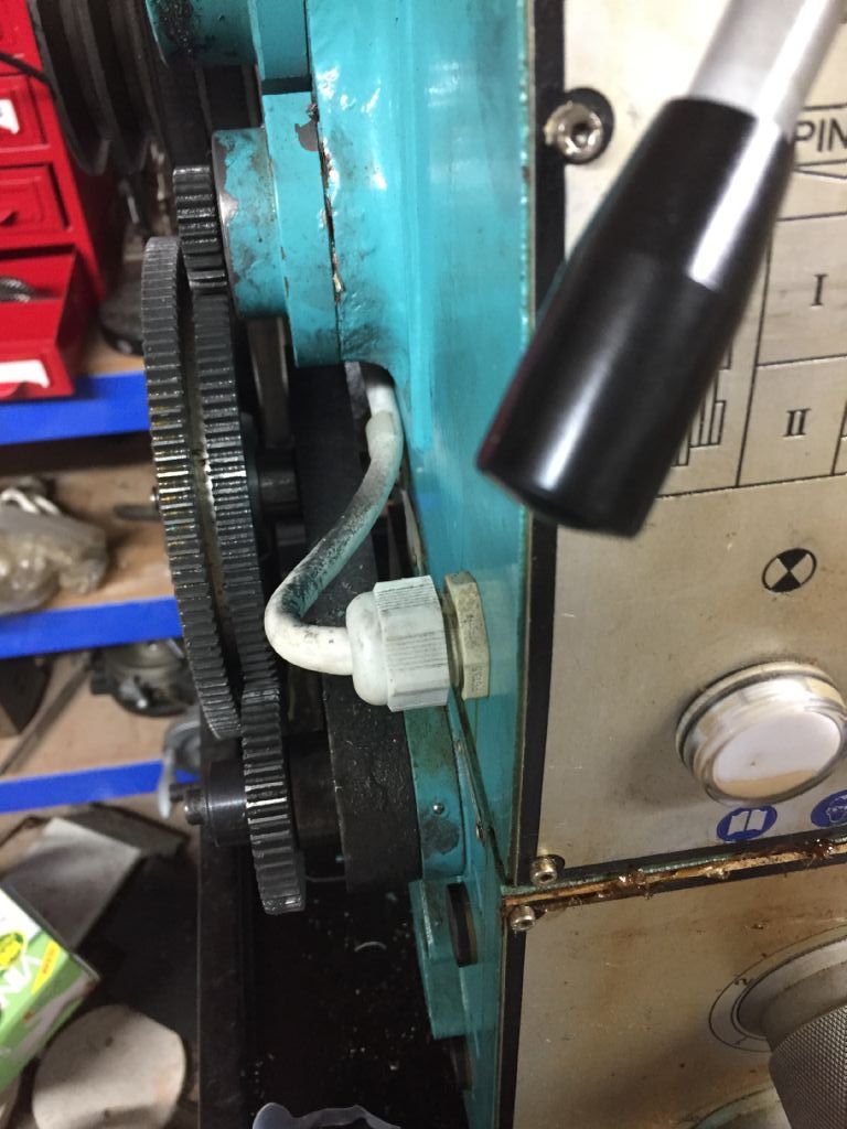

                                    Thanks for finding that thread Hopper – JohnS did say he had a very similar lathe. I now see what the problem is, though I'm not sure how to solve it yet!
                                    This is John's pic of the gear train on his machine taken from his thread:
                                    There is a spacer behind the wheel driving the 127/120 compound which allows it to reach over the 120 and engage with the 127.
                                    My machine:
                                    The drive shaft doesn't extend far enough to allow the drive wheel to engage with with the 127T in the way shown in John's pic.
                                    I now understand how it's meant to work, I just have to figure out how to fix it – any suggestions welcome!
                                    Robin.
                                    #380845

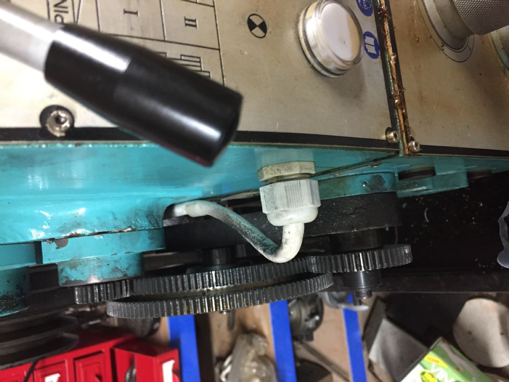

                                    Les Jones 1
                                      @lesjones1
                                      Is it not possible to swing the banjo further away from the line joining the 48 and 24 tooth gears From your picture on 15/11/18 at 22:18 I can see that swinging the banjo anti clockwise may make the 127 tooth gear touch the belts but is you swing it clockwise so that the 127 tooth gear is to the right of the line jining the 24 and 48 tooth gears it looks like there is nothing to get in the way. I have rotated your original picture to make it easier to view.
                                      Les.
                                      #380855
                                      Robin Graham
                                        @robingraham42208
                                        Thanks for putting the photo in the right orientation Les, it does make it clearer. The fundamental problem is that if I just swap the 24T driver and the 48T driven using the 120 idler, the outside spacer on the now driven 24 fouls the 127 wheel. No reorientation of the banjo will change that. The 127/120 compound is made in one piece so I can't just swap the wheels around.
                                        Looking at the photo of JohnS' machine I'm pretty sure that there is a problem with the factory assembly of the gearbox. More anon I expect!
                                        Robin
                                        Edited By Robin Graham on 16/11/2018 00:03:28

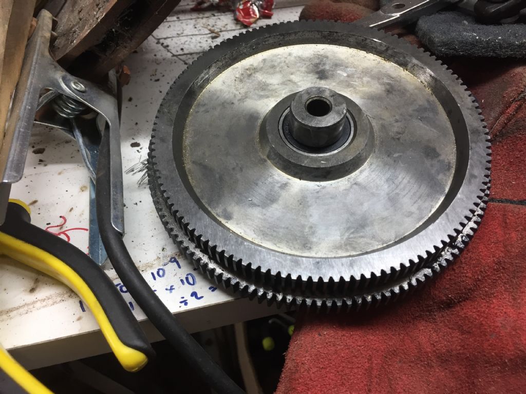

                                        #380857
                                        Hopper
                                          @hopper
                                          Can you not just pull the 120/127 gear off and flip it over so so the larger 127T gear is inboard and engaging with the driver gear and the driven gear? Of course, the position of the stud and banjo would need to be adjusted to suit.
                                          #380869

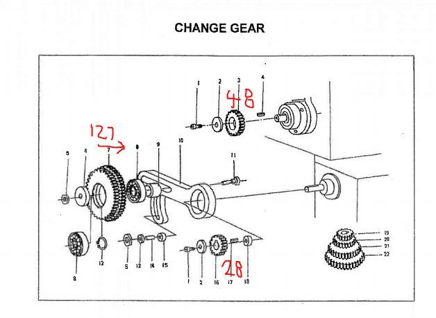

                                            Fit the 48T on the drive with the spacer facing outwards or omit the spacer all together
                                            Fit the 120/127 on the stud with the 127 nearest the machine
                                            Fit the 28T on the input shaft
                                            All three will be lined up.
                                            You will have to swing the banjo to a new position and also move the stud along the banjo so all three mesh correctly
                                            Edited By JasonB on 16/11/2018 08:01:08
                                            #380872
                                              Amazing what you find when you look in the manual!
                                              #380873

                                                Robin Graham
                                                  @robingraham42208
                                                  Posted by JasonB on 16/11/2018 08:07:55:
                                                  Thank you Jason! Where on earth did you find that? I thought I'd looked everywhere…..

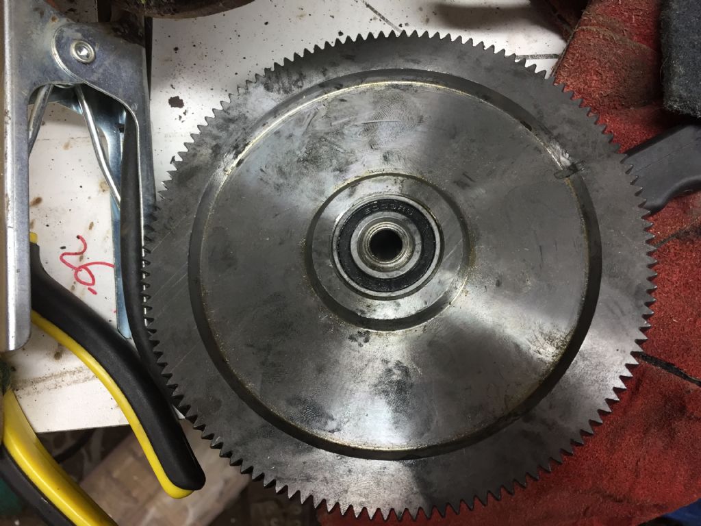

                                                  Unfortunately I still have a problem. This is my 120/127 wheel from the 120 side:
                                                  And from the 127:
                                                  From Jason's diagram it looks like the bearing and standoff (parts 8 and 9) are meant to part company with the gear, thus allowing the gear to be flipped so the 127 is closest to the banjo. Trouble is these parts seem to be tightly pressed together. So far I have tried whacking out the bearing with a drift on the outer race and pressing out the standoff from the inner with a gear puller (obviously I can't apply much force that way without risk of wrecking the bearing) – neither will budge.
                                                  I'll just make a spacer and a longer version of the stud (part 11), which I probably should have done in the first place – I just thought that there must be a more straightforward way!
                                                  Many thanks for all your suggestions and pics,
                                                  Robin

                                                    If you do need an idler, it is not a good idea to use a 120+127 gear, unless you have nothing else that can be made to fit. This is because a chipped tooth (etc) would be much more expensive to rectify, and might hold up your next project if you needed a metric to inch conversion.
                                                    This only applies to its use as an idler of course.
                                                    Cheers, Tim
                                                    #380933
                                                    Brian Wood
                                                      @brianwood45127
                                                      Hello,Robin,
                                                      Thus far I have watched with interest but said nothing. I feel now able to make an input. Part 9, the running axle for the gear combination is clearly intended to exit on the 120T side, I suggest the following
                                                      • Make a hefty stepped pin that fits into the bore of the axle, to be used as a drift
                                                      • Find a piece of thick walled pipe that clears the O/D of a bearing and park the 120 side centered on top of that, the base should sit on the workshop floor for solid support
                                                      • Now use the stepped pin to drift out the axle, don't be timid, it will move using a decent weight hammer
                                                      Rebuild it all in the opposite direction
                                                      Regards
