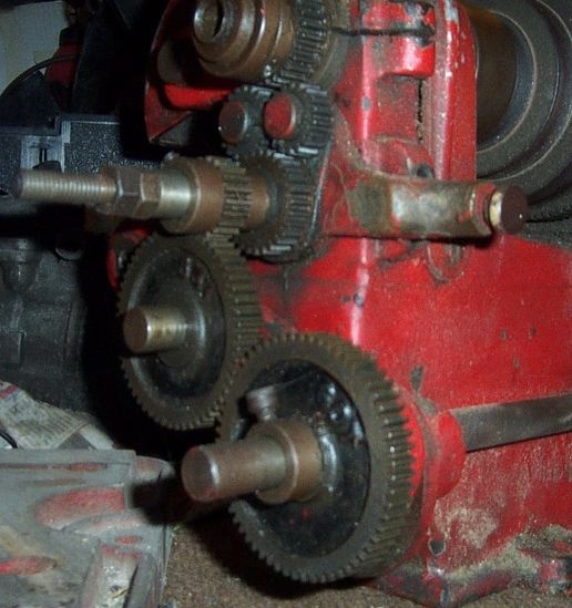

      Hi , I,m a newie, could anyone help with screw cutting in a Warwick
      Ive just bought on Ebay . Item number 140509163386 .
      If you clicked on the web site mentioned and on the 2nd colour pic .
      You will see my problem . I have just bought a set of Myford Change gears
      as well .
      I don,t know how the arrangement is suppose to be ? the little gear on the shaft just freewheels , its not locked on to the shaft .
      Thanks Terry

          Hi Terry, I presume the little gear on the extreme left, then yes I’d say it should be locked to the shaft. It may be done by a pin between the gear itself and the coller that is next to it. this may be missing or sheared. Alternativly it may just have a little grub screw inbetween two of the gear teeth which may be loose or missing.
          Your Myford change gear are probally suitable but may need a hole drilled in near the shaft hole for a pin to connect them to each other, instead of using the keyway which is cut into them.
          Look on http://www.lathes.co.uk web site and click on the links for the other makes he mentions in the text for the lathe you have for more info as they are all very basically the same.

                Just incase you’re still stuck with this, this is a pic of a working changewheel setup for the Warwick.
                #65662
                Terry Reardon
                  @terryreardon35416
                  Many many thanks, all becomes clear !!!
