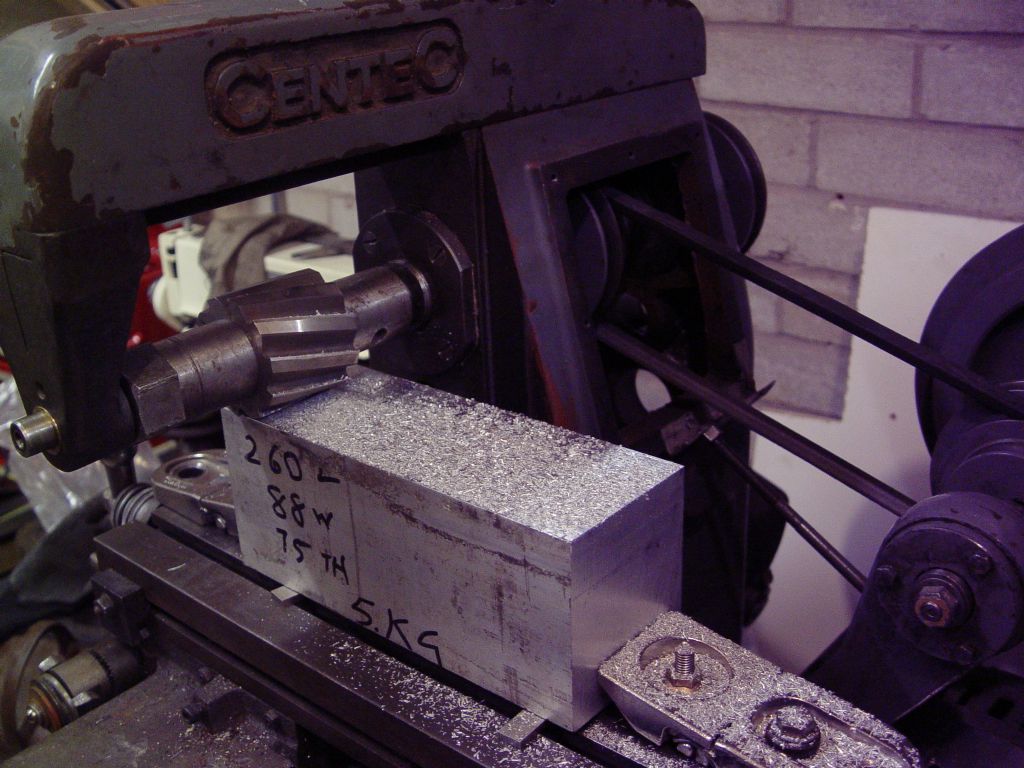

                      I'd not considered a slab cutter but that does make alot of sense. My widest horizontal cutter is 5/8" – other than a 1" bore is there anything I should be considering with regard to teeth/etc. on a cutter like this?
                      I tried to cut a piece of aluminium flat using a horizontal cutter and ended up with a tiny groove on the outside edge of the cut. I don't know if this was because the overarm was sagging and causing the arbor and cutter to sit at an angle, or something else. The VH was on the front of the overarm/spacer so next time I'll try pushing that back along the dovetail.
                      That nut on the front of the VH had oil leaking out of it like crazy, so I used an aircraft screwdriver to hold the stud on the inside and tighten it up on the outside.
                      Turns out the disc on my wiggler is only nominal 0.100" – actually 0.1185" – that would have been annoying! I grabbed a M&W 0.500" edge finder too – not because I think I need it, but more because it will fit in the clarkson chuck and is roughly the same height as a mill – rather than having to crank the table down 3-4" and then back up again!
                      Edited By William Ayerst on 03/08/2021 08:53:51
                      #556804
                      Anonymous
                        Posted by William Ayerst on 03/08/2021 08:52:45:
                        Do everything up tight, and then tighten some more, and ensure the cutter is well supported. Make sure the work is firmly held; I've had a slab mill lift work out of a Kurt vice. Spindle speed the same as any other cutter of the same diameter. Feeds based on number of teeth and number of thou per tooth. I usually start at 4 thou per tooth. From a practical viewpoint I suspect the lack of arbor keyway and lack of power will be the limiting factors. A slab mill can remove serious amounts of metal; this is pussyfooting as the mill didn't even notice as the cut started:

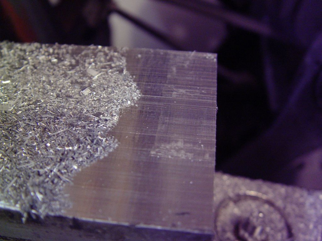

                          Can't beat Andrew ……………. but I can offer photos of my 2Aminus as it was then (minus a gearbox) with a 2 belt drive facing the top and bottom of it's own raising block.
                          Note that the nut does not touch the bearing smiley and it's only a 2 thou cut.
