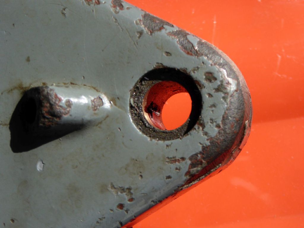

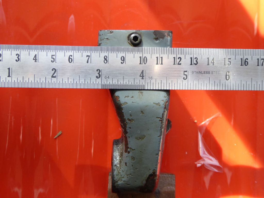

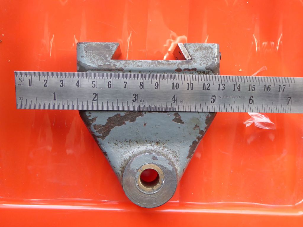

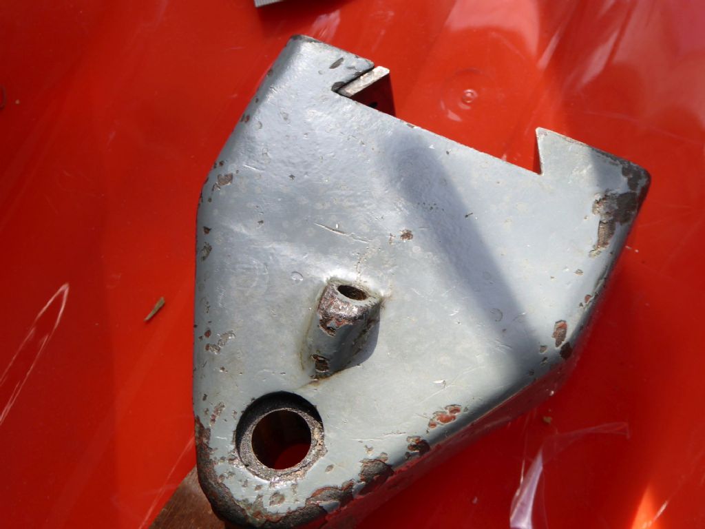

              These photos of my overarm might help…
              overarm 4.jpgoverarm 3.jpgHere are some photos of my overarm that might help…

                  Very many thanks for the pictures Gary, it does look like a dead easy piece to make.
                  I could knock out an identical copy on my little CNC mill easily.

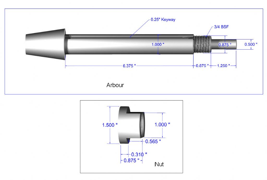

                  What is the bearing size Gary ?
                  Scaling up from your drawing it looks like 3/4" O.D. 1/2" I.D. is that right ?
                  Also what is the thread on the end of the arbour for the lock nut out of interest, and is it L>H. or RH thread ?

                      These are the dimension of my 2B arbour.

                        That's absolutely terrific Gary, thank you so much.
                        I'll definitely go ahead now and make the parts.
                        Measured up my overarm and it looks like the correct one for my machine.
                        Got an accurate figure of 3.7/16" from the spindle centre to the arm mating face, so can go ahead now.
                        Very many thanks again I'm very grateful.
