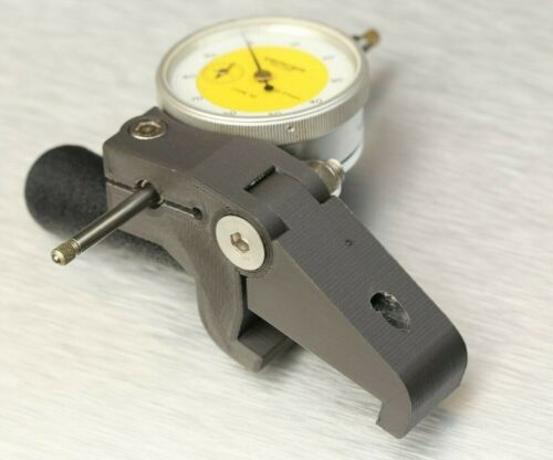

      While looking on a well known auction site for a S/H Mitutoyo lever type indicator, I came across several of these for various lathes (including: Warco, Boxford, Harrison, Emco & Harrison). While they are made for dial gauge fitment, I'm sure they can be adapted to make a carriage stop. Not sure how they get around the differing vee angles that we experience. Yes, we can make our own, but for £25.00, and someone who hasn't got a mill (yet), it might be useful.
      Not sure what it's made of, but I'm guessing it's aluminium.
      "WARCO 240 & 250 Lathe Dial Indicator Gauge DTI Holder Clamp Mount DRO"

            Tony Pratt 1
              @tonypratt1
              It's 3D printed plastic.
              Tony

                My machine allowed me to cut and paste it ok. I had a look and downloaded an image – I might try to draw one in CAD to 3D print. Here a picture of one:

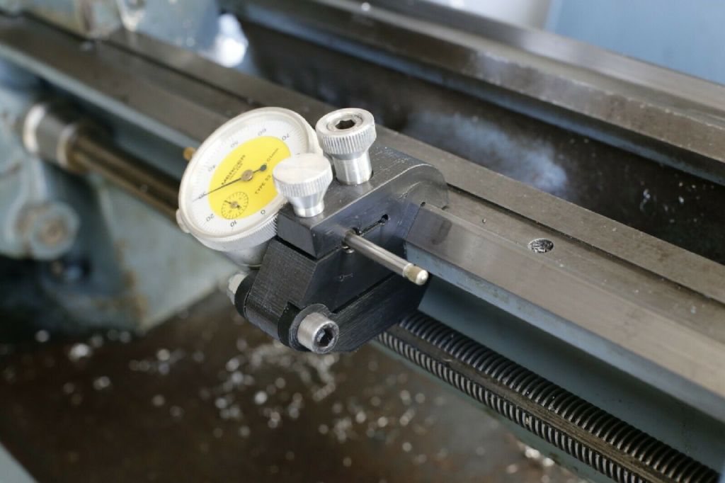

                      Couple of thoughts on the ebay items; I have a Boxford micrometer saddle stop, it's a fairly substantial chunk of metal which is clamped firmly to the lathe bed. It has to be so because the saddle can gve it quite a clunk at times,
                      I'm constantly moving it along the bed to suit the job in hand. The clamping mechanism needs to be robust and hard wearing.
                      The printed items, to me, don't look as if they'd be too rigid. OK for pressure from a DTI perhaps but not as a physical stop.

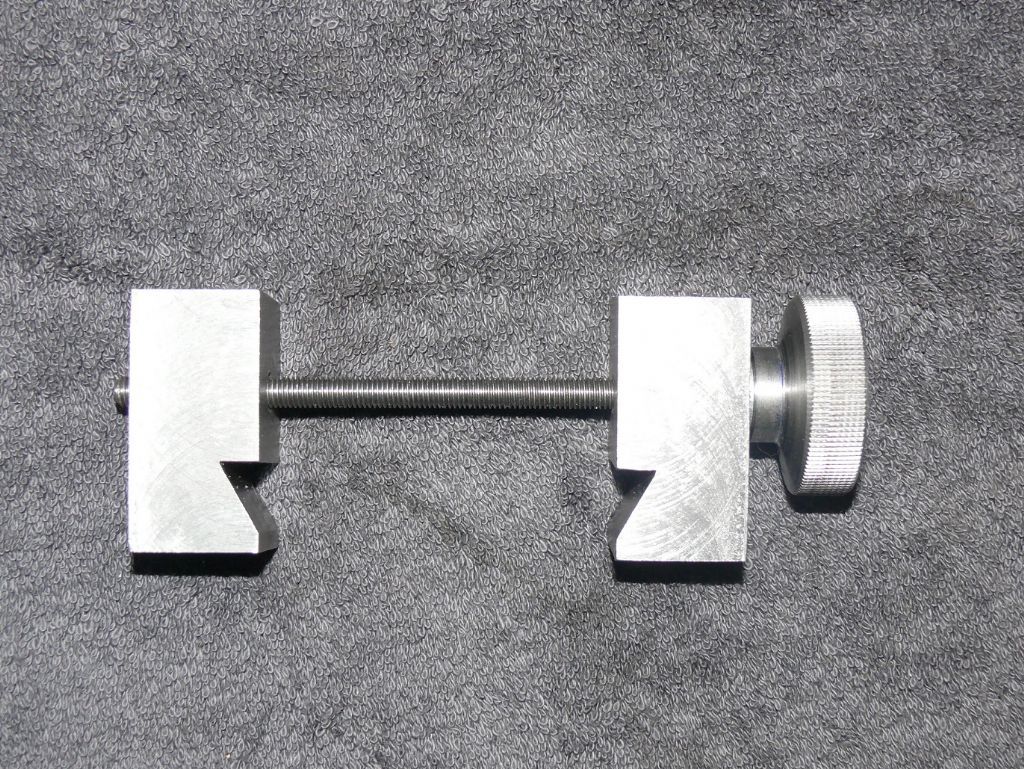

                            I made a clamp to mount onto the bed of my BL12-24, so that a Micrometer barrel could be mounted. It is used, when nrequired as a Saddle stop.
                            The mic is extended by the required travel and the stop clamped to the bed wsith bthe micrometer spindle against the Saddle. The Mic is then nretracted to the Zero position. AS the Saddle mapproaches the stop, power feed is disconnected, and the Saddle brought to the stop by hand feed.
                            In this way no mdamage is done, and the stop is not moved from it's position.
                            For a lathe with a dovetail bed, (Myford ML1,2, 3 ,4 , Clarke CL430 or CL500M ) a different form of mounting arrangement is required..
                            I'll try to put a picture into an album.

                                      If you are going to have one 3D printed, consider incorporating a slot and clamping screw so you could then add a 'rain deflector' made of clear perspex, which would assist with the issue pointed out by Nigel above.
                                      https://www.linear-tools.com/product/2-dial-indicator-linear-code-dg-2s/
                                      https://www.linear-tools.com/product/50mm-dial-indicator-linear-code-dg-50m/

                                            Have just posted a photo of the Micrometer saddle Stop that I made for my BL12-24 (Will fit a Taiwanese lathe such as the Warco BH600, 900 or Chester Craftsman ) into an Album, if anyone is interested.
                                            There is also another Album showing a Saddle Stop made for a Myford ML4, but suitably upscaled can be used on any lathe with a dovetail bed. Adding a Micrometer barrel, or DTI should not be too difficult a modification to make.

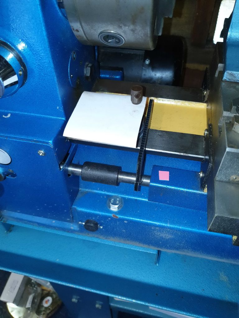

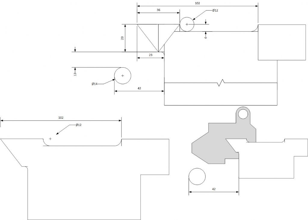

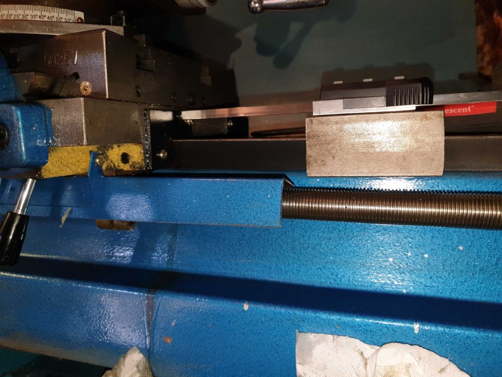

                                              Hi Guys
                                              Below are my findings from Clarke CL500M
                                              Ive even had a bash at designing a clamp with Splash-guard holding thingy (top hole of the Greyed out image).
                                              Its tight down there, and that guard (see pink marker) will have to be cut down.
                                              If anyone fancies printing me one, give me a shout, I'll gladly work with you to resolve any design issues.
                                              cheers

                                                I thought I would update on this, and hopefully save you some drinking time.

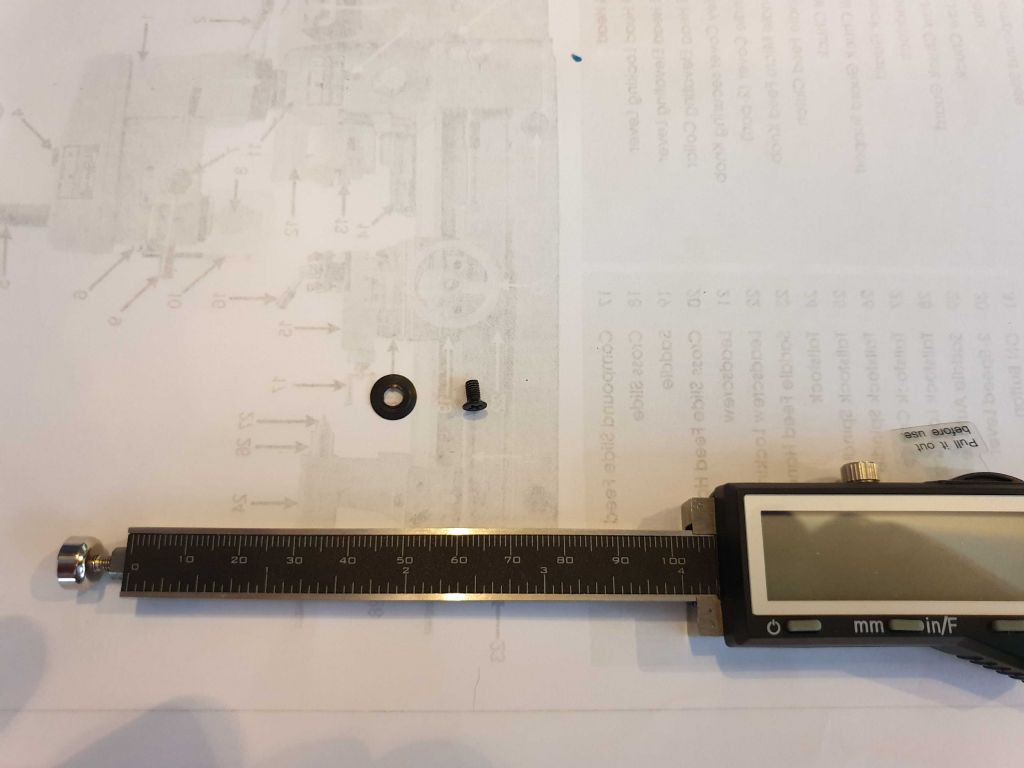

                                                So, the clamp thing (in my opinion) waste of time. The Plastic printing guy (eBay – great guy and knows his stuff) doesn't think it will work but did provide an option with magnets BUT with his clock embedded.
                                                Im not keen on a 30mm clock or buying another when I have a few old ones around.
                                                Got me thinking about using a >100mm digital vernier instead of 50mm clock at silly money.

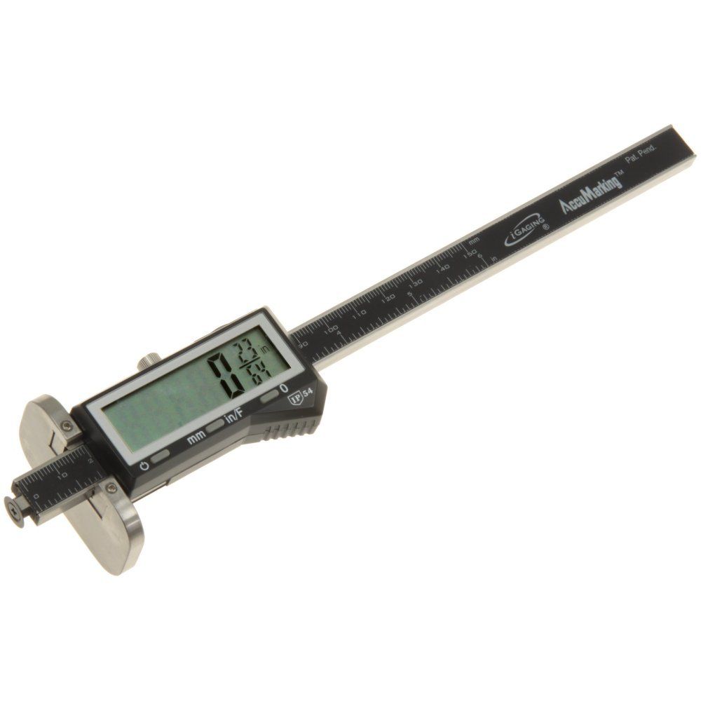

                                                If I have to use magnets, then I can prob make myself easy – right?
                                                Turns out YES. There's a YouTube clip somewhere of a US guy making one with iGaging depth gauge. Can buy in UK for >£50 but Amazon £40 imported from US.

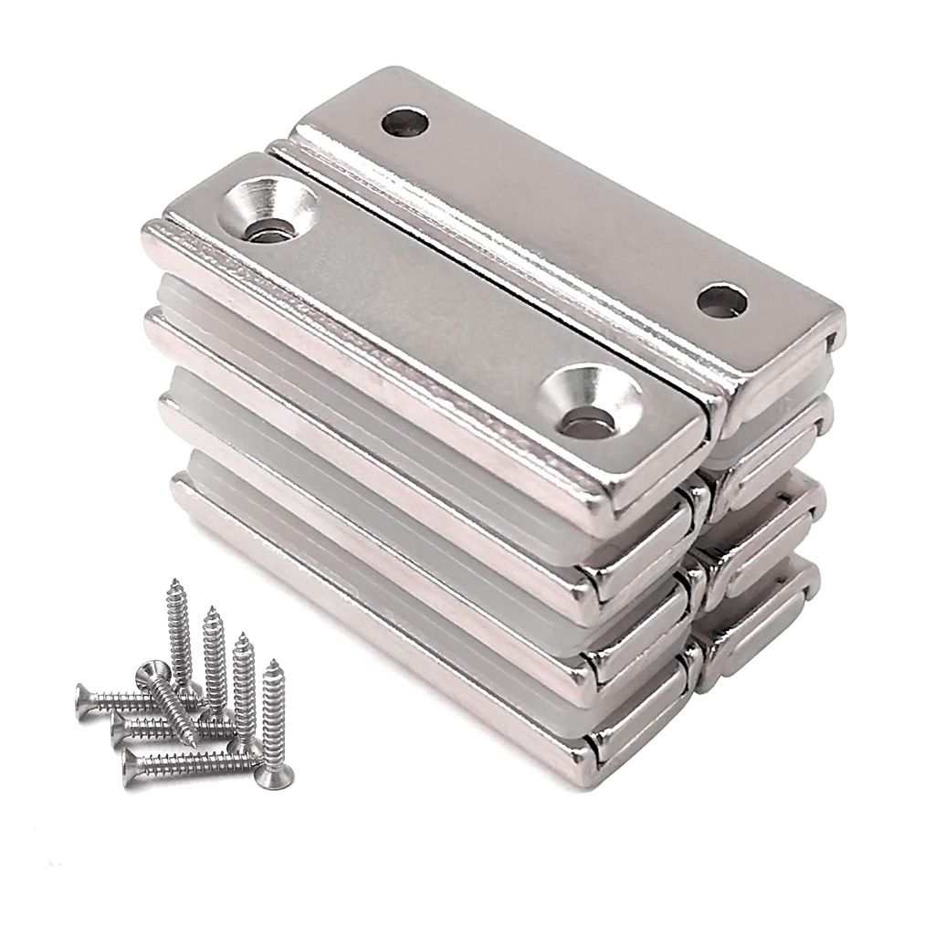

                                                So for magnets.
                                                I did loads of research using couple of magnet sites. Nothing perfect.
                                                Then, I went back on Amazon and found these (below) because they have a hole which I can attached to Saddle (Oil Guard thingymabob) and I hoped the vernier marking wheel would be sufficient for pulling the gauge. It does perfect.
                                                Magnetpro 8 Pieces Strong Neodymium Rectangular Magnets 20 KG Force 40 x 13.5 x 5 mm with Countersunk Hole and Capsule, Household and Industrial Rare Earth Magnet with Mounting Screws
                                                Also, I thought the 5mm height and 40mm length would be OK for under a base-plate: which is a 70mm piece of 40mm angle iron (maybe with some 5mm packing also to avoid any snatching when installing). Note that I'm using 5mm drills in pic for testing the height.
                                                20210613_133836.medium.jpegSorry I haven't fitted these yet so cant show a finished pic.
                                                Turns out I didnt need these specific (8 pack) magnets, but thought I would share that they are very good, so I'm sure I'll find a use for them – one day! I could have bought just 1 of something similar for under the base-plate. With hindsight I would get 1 magnet of similar quality and 5mm height, which is good height for hitting metal on the Saddle oil-guard.
                                                Anyway,

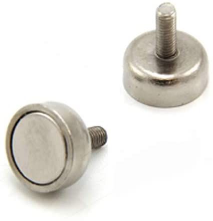

                                                I also found this magnet: Magnetpro 8 Pieces Strong Neodymium Rectangular Magnets 20 KG Force 40 x 13.5 x 5 mm with Countersunk Hole and Capsule, Household and Industrial Rare Earth Magnet with Mounting Screws
                                                Turns out this has an M3 screw. But would this small thing really be strong enough?
                                                Yep. Ive just tried it with steel ruler on my desk and it sticks like shit to a shovel. So, turns out adding an iGaging vernier is a piece of cake.
                                                BUT as with all things with this Clarke lathe, its not all good news as it's going to be in the way of the Tailstock.

                                                Howard Lewis
                                                  @howardlewis46836
                                                  The CL500M (And the CL430 ) have Dovetail beds, (As do the Myford ML1.2, 3 and 4 ).
                                                  So it would be easy to make up a clamp which locks on to each side of the bed, with a tapping in one and a clearance hole inn the other so that tightening a knob would clamp the device securely to the bed. The front piece needs to have the means of carrying the measuring instrument (Drilled / reamed hole with tapping for screw to clamp the DTI )
                                                  The lower part of the front clamp needs to be high enough to clear the guard over the Leadscrew.
                                                  On my lathe, I made a clamp to fit the front prism way on the bed, suitably shaped, reamed, tapped to carry, in this case, a Micrometer barrel.
                                                  See my albums for pictures of the Saddle Stop for a Myford ML4, and the Micrometer Stop for my BL12 -24.
