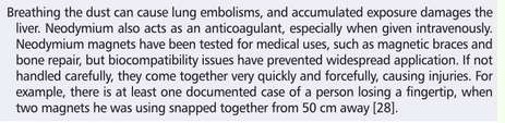

                        Grinding them best avoided, and if necessary outside wearing a mask:
                        neodymium
                        In terms of risk though, there’s a big difference between a Model Engineer grinding a few small magnets out once every 50 years and an industrial worker who does it day after day after day.

                                    Dave, I wasn’t aware of the dangers from the dust. Thanks for the warning. Hopefully no worse than the dust from carbon fibre, which was flying everywhere today while I sawed out a carbon fibre seatpost that was stuck in a bicycle frame. Strange unpleasant smell to it as well.
