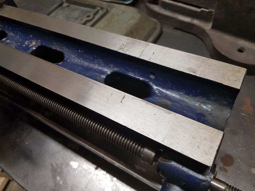

                                                  Jacob, from what I can see in your pictures that lathe isn't a ML4 or any other sort of true Myford lathe but it looks VERY much like a Drummond "M" Type – the knock off bar along the front is a bit of a give away as I believe they were never fitted to Myford designed lathes but very much a Drummond feature. Where you may be getting confused is that during World War 2 Myford made Drummond M Type lathes under licence at first but later the rights to the design were assigned to Myford by Drummond. So you can have :
                                                  1.a Drummond M type completely manufactured by Drummond
                                                  2. a Drummond M type assembled by Myford from parts that were transferred to Myford fromDrummond
                                                  3. a Drummond/Myford M type assembled from parts made by Myford to Drummond designs
                                                  or finally
                                                  4. A Myford manufactured lathe built to the Drummond M type design but incorporating modifications introduced by Myford.
                                                  About the only way to check that is to find the serial number on the bed (tail-stock end) and check that with the files on the Drummond lathes io group.
                                                  Yes the end of the spindle is damaged, the thread should be at least twice as long as that.
                                                  So long as the important parts of the lathe are in good order then you should have a very competent machine when you get it set up, they have a very good reputation.

                                                    That's a really nice looking machine, how the **** did anybody manage to break off the spindle nose threads. Clumsy muppet.
                                                    #484595
                                                    Jacob Brown
                                                      @jacobbrown
                                                      Posted by Roger Whiteley on 08/07/2020 14:49:56:
                                                      I started my small investigation and according to guys from Drummond Io group previous owned bored spindle to 1/2" and most likely in process broke off part of it.
