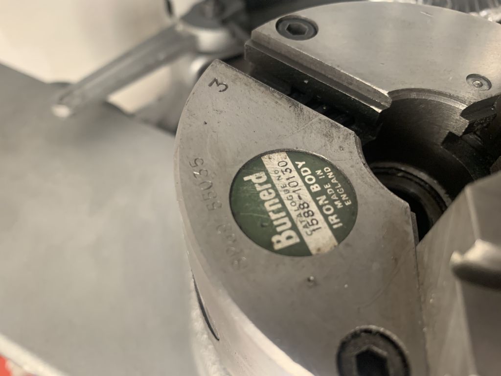

        Well, two more of thr teeth on my chuck’s jaws finally gave,
        It is for a myford ml10 burnerd chuck.Is there anyone here who has an extra set of these, or knows where to find them? It is a self centering jaw, three teeth.

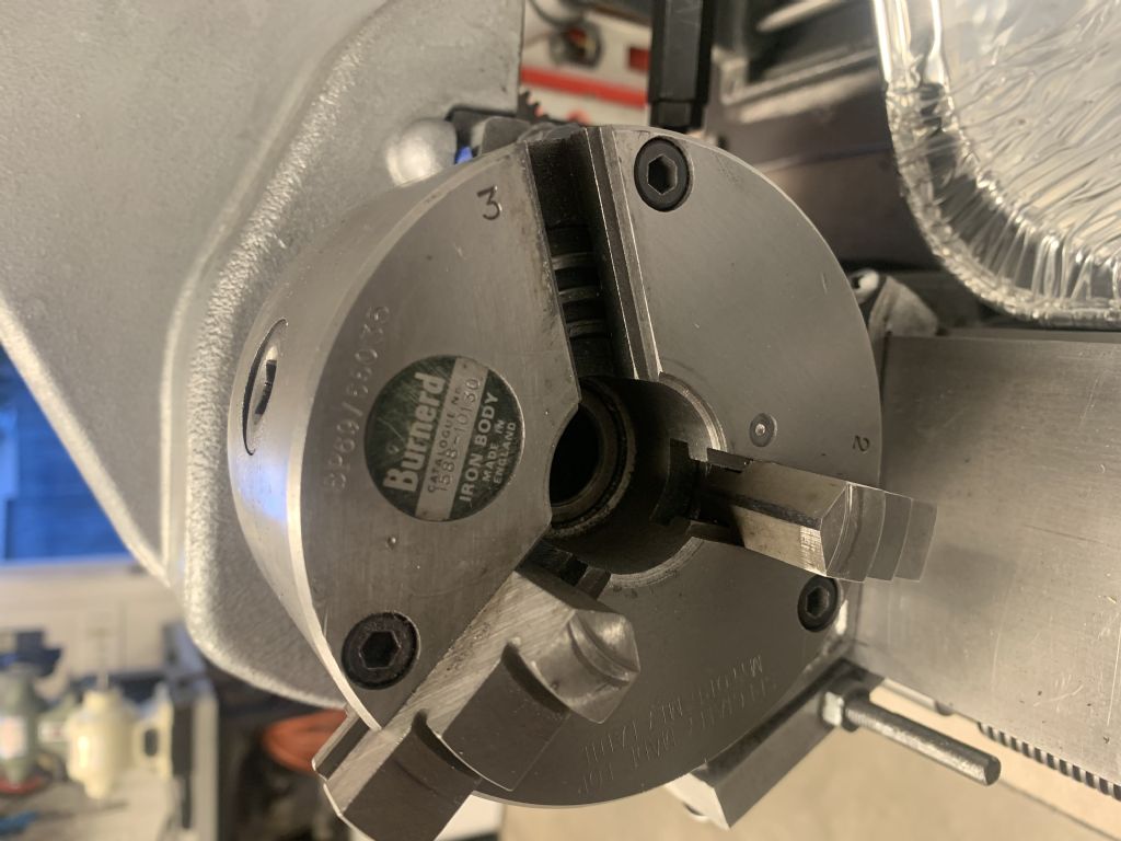

                      There was a tooth broken on the chuck a while back, and then another one broke…you get the idea. I will post some pics tonight of which chuck it is.
                      I’d like to see if i could find some teeth for this chuck, instead of purchasing a cheap knock off chuck, but will see I guess.

                          6b529687-c97c-4cb8-b26c-f79121726101.jpegAnyone here have an extra set of teeth, laying around, for this chuck?30e632a1-3103-44cb-961f-bf8c6010ad3e.jpeg

                            What does everyone here recommend as a replacement chuck? Should I get one size larger for my ml10?
                            I have a monster 6” chuck, but when the teeth are extended, it doesn’t clear the bed. Trying to find a happy medium on size.

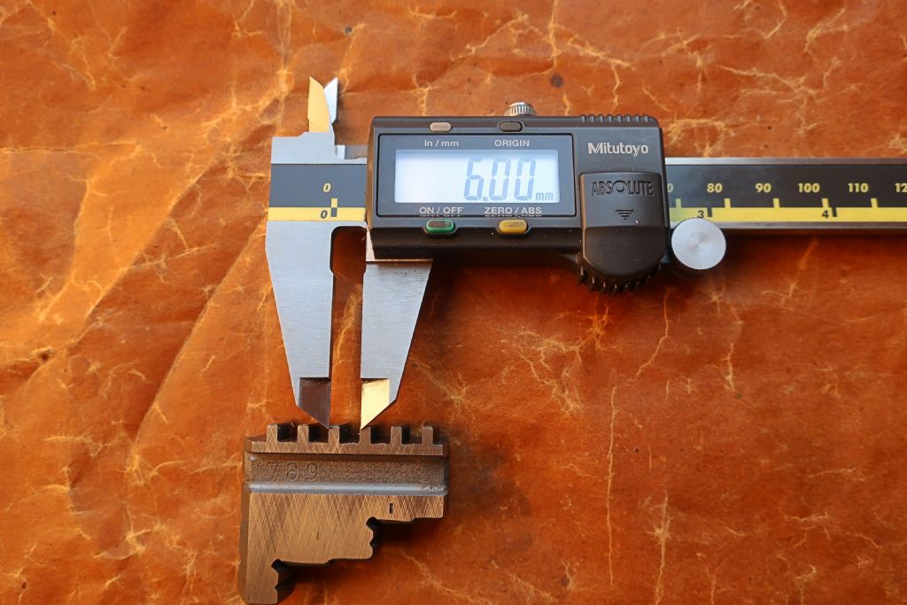

                                        You need to check the pitch of the teeth with these chucks, some are imperial and some metric.

                                            I'm fairly sure the 1580 series 4" chucks are Imperial – if so the pitch of the teeth should be 5.08mm – that is the distance from the front edge of one tooth to the front edge of the following one, i.e. the total width of one tooth and the gap next to it. The height of the slot in the side of these jaws is 4.85mm.img_1713.jpg
                                            The metric P-B 100mm jaws have a pitch of 6mm and a 7mm high slot.
                                            If your chuck is Imperial, I think soft jaws type EJC will fit – for replacement hard jaws you could try try P/nos. 2580 10603 (inside), and 2580 10602 (outside). Both of these are now obsolete. I'm not absolutely certain these will fit, but it might give you something to go on. If you want to do further internet legwork, I found the dimensional / part no. information from pdf spec. sheets from Rotagrip and Thame Workholding's websites…

                                              Diogenes II has measured the pitch of an imperial measurement chuck. The tooth pitch is 5.08mm, or 0.2", 5 teeth per inch. If your chuck is a metric one the pitch will be 6mm. This is the easiest way to tell the difference between the 100mm chucks.
