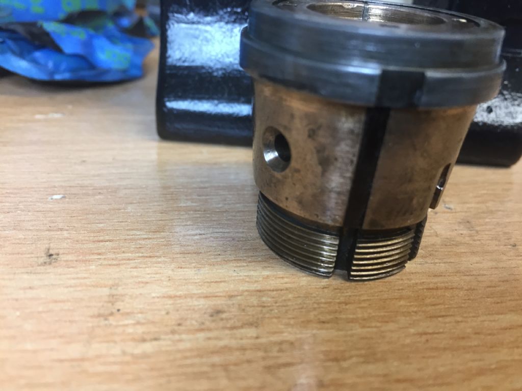

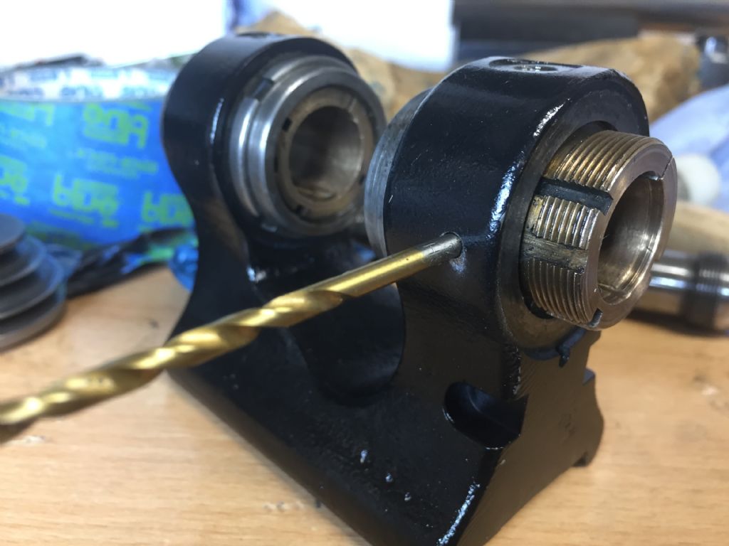

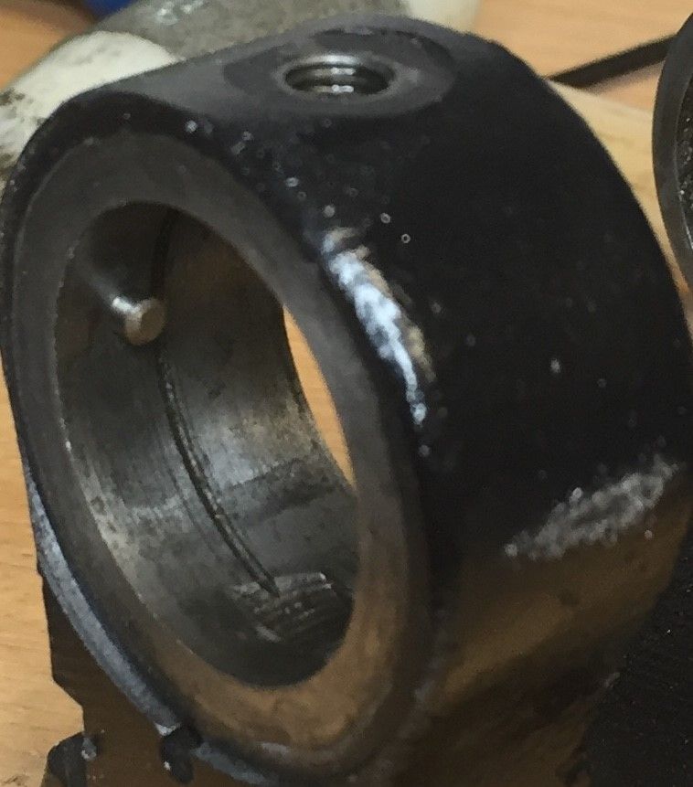

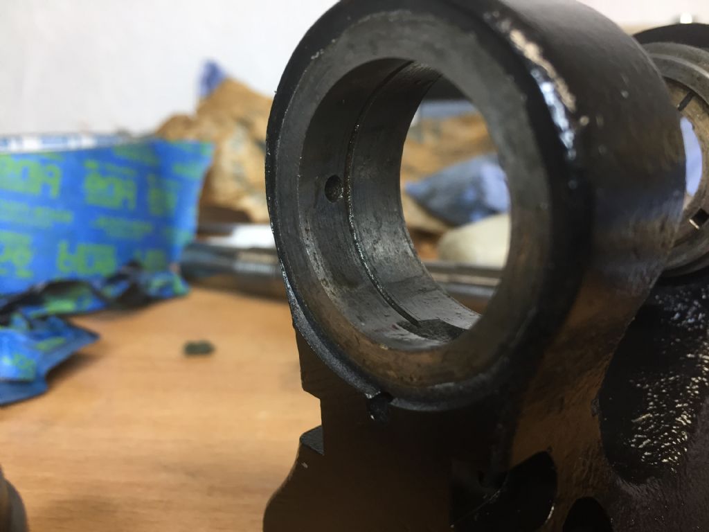

      10. Now back to that headstock hole. Well that supposed to contain a pin to stop the bearing from turning.
      So time to strip it down and take a look. Yep there is a pin supposed to be in there.
      The hole in the bearing contains a felt wick that locates in a well at the bottom of the bearing housing. I have removed this for replacement.

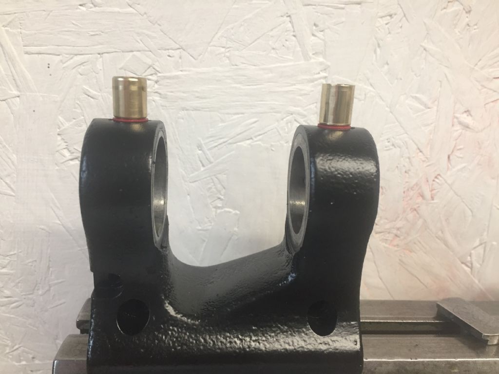

        11. Now time for a new pin. I found an imperial drill bit a tight fit in the hole and used Loctite to keep in place. This will be cut off to size and filed down flush.

                12. Drill bit now successfully Loctited in and cut off with a mini cutoff wheel
                Time to start filing flush

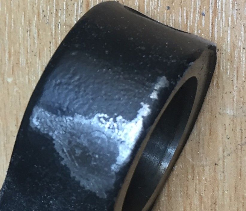

                13. Ok its destroying the paint work but hayho I can replace that. I think thats flush enough now.
                Really happy with the pin it fits great

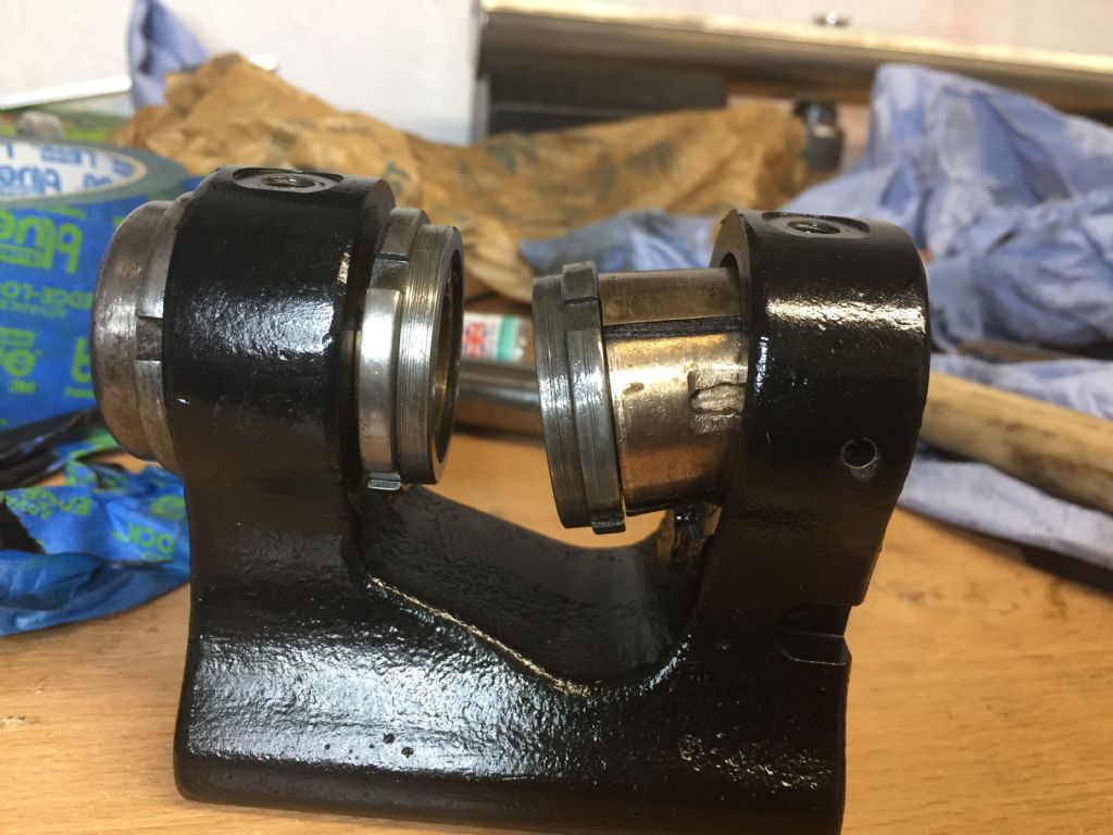

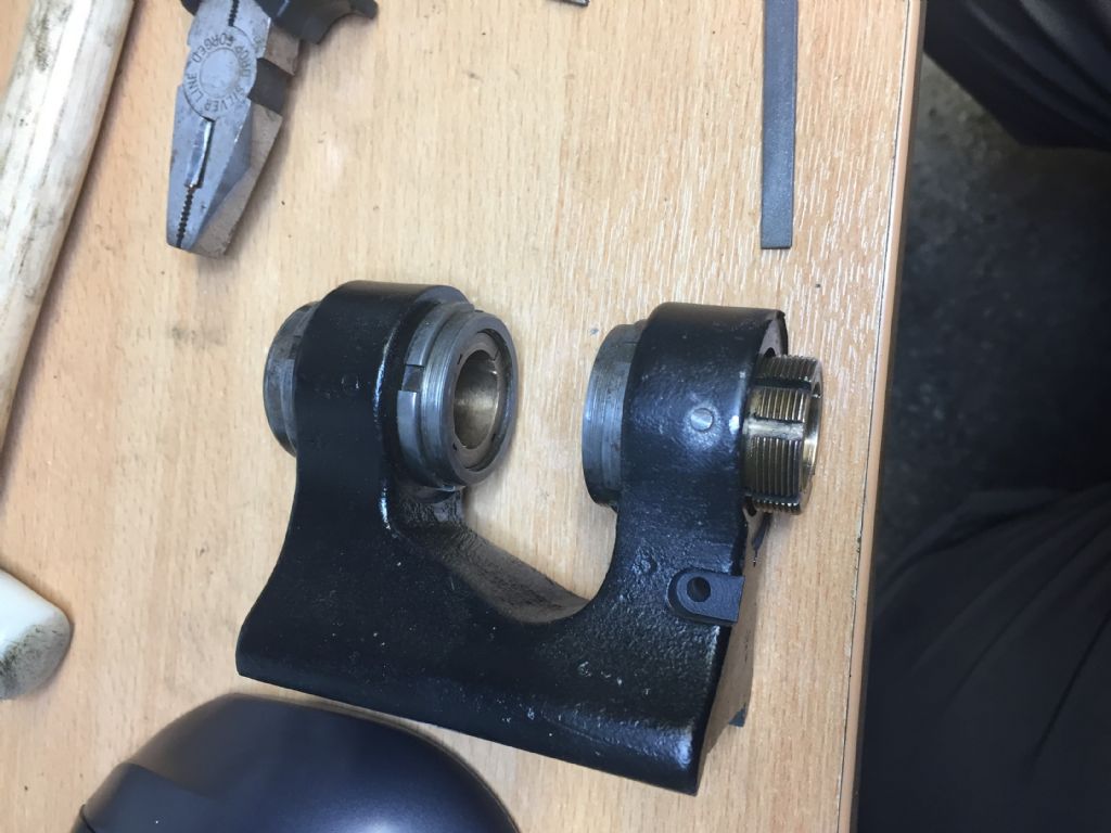

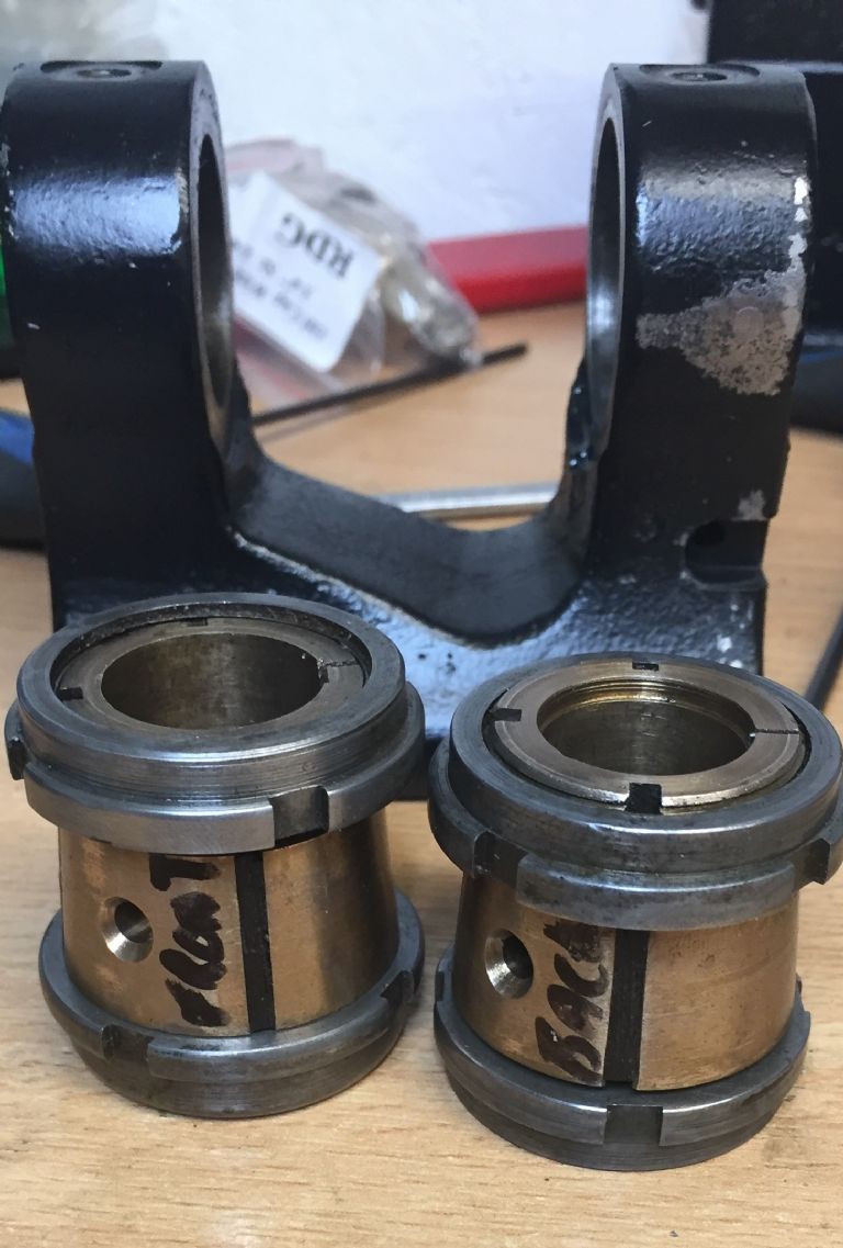

                14. Removed both bearings this time so I can mask up to respray.
                Also marked them up front and back and also saved the felt wicks for safe keeping.

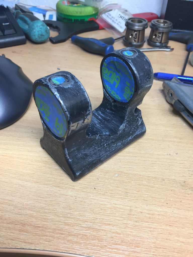

                15. All keyed and masked up for respray of etching primer before the matt black enamel.
                I received the oil cups today from RDGTools. Doh!! I ordered 1/4" BSP They are the wrong size measuring 1/2" I should have checked my Zeus Book before I ordered. Oh well nice little project I can get my son on the lathe and get him to make me some. Time to produce some drawings for him. Get him off the XBox.

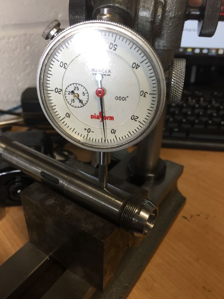

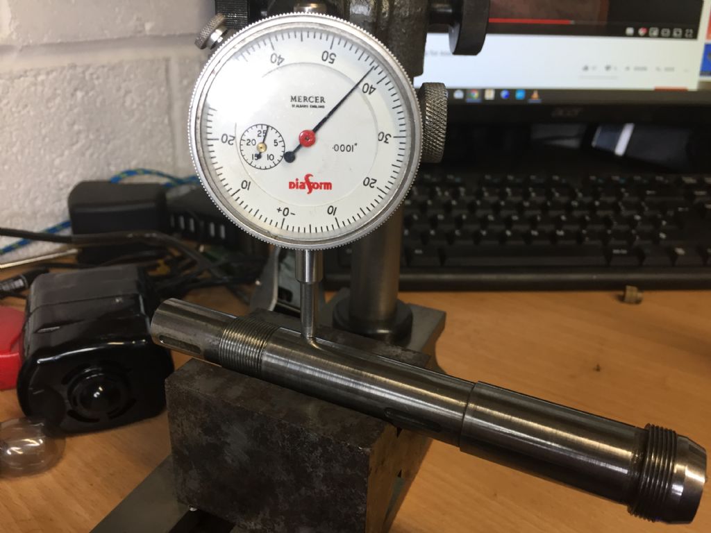

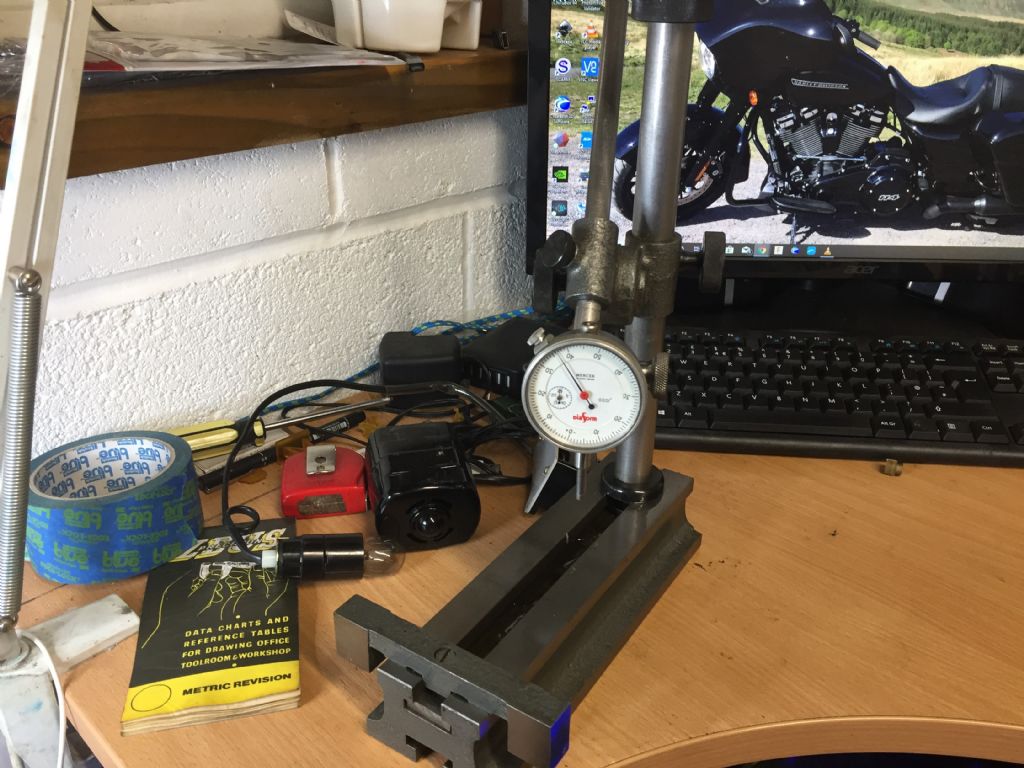

                  16. Checking spindle on the comparator b y putting in a V-Block and turning slowly on the bearing surfaces to see if any deflection.
                  Well the bearing surfaces are perfect to within .0001"

                    Posted by Michael Edwards 1 on 30/12/2019 21:24:03:
                    smiley
                    Well … it is a Pultra angel

                        Posted by Michael Gilligan on 30/12/2019 21:34:31:
                        smiley
                        Would love to know the age of this it certainly is well engineered. smiley
                        #443970
                          … made just in time for WW2, I believe
