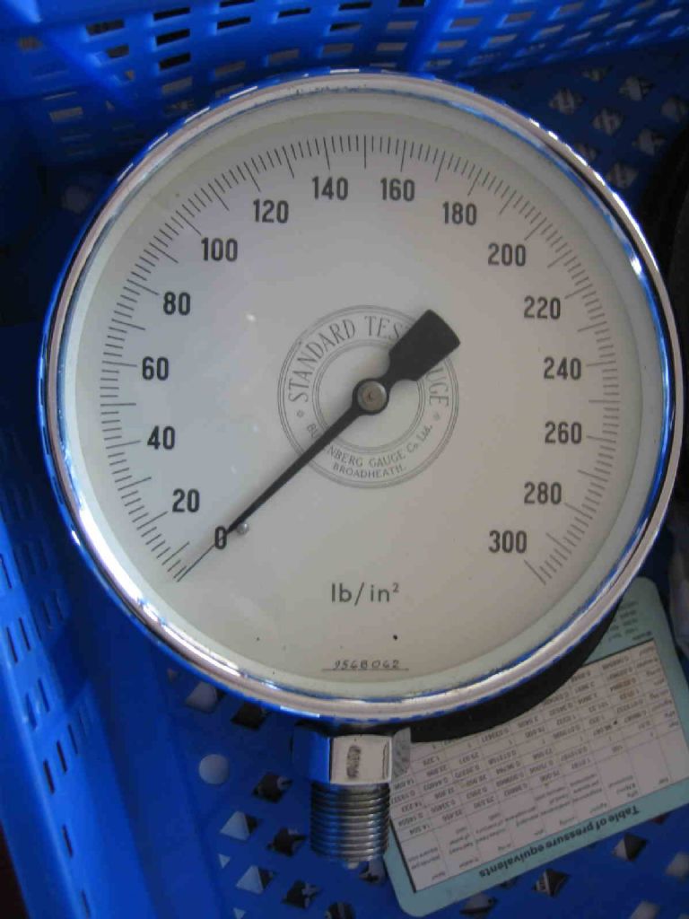

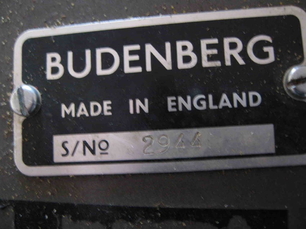

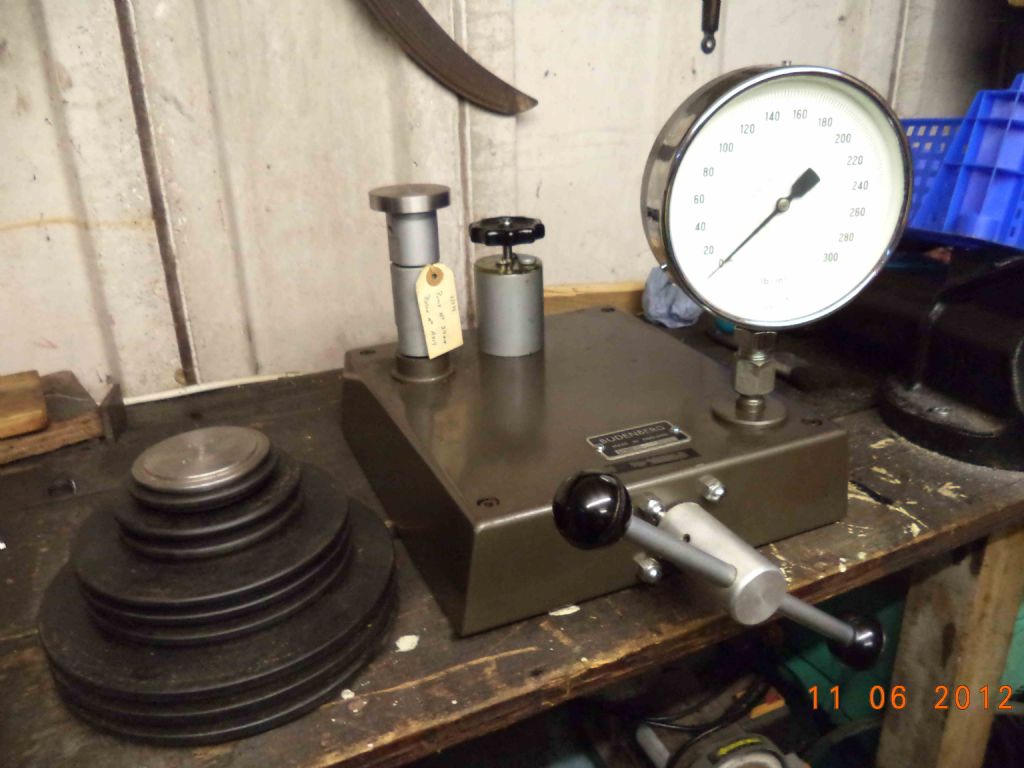

      Our Clubs had a Budenberg Dead Weight Pressure Tester donated to it. Its Complete with all the weights and reference pressure gauge, I contacted Budenberg in the UK and they were very helpful they identified the model and year of manufacture (1965) and sent me the operation instruction. I've had it working and tested the reference gauge and its bob on, I've also tested a few other pressure gauges large and small.
      I know that the small gauges you get to fit on Locos are not that accurate so I'm aware that you have to be careful just how you interpret the results.
      I'm still unsure just how we can get the best out of it so I'd welcome some comments. Photos below

            As you say the small gauges are by nature only an indicator, the range between index marks being guessed by the user.
            Start by getting a decent gauge and calibrate it with your new toy.
            Make a test manifold to hold your new 'test' gauge and any other gauges to be tested. This way you tested is mobile and its accuracy can be traced back to the dead weight tester.
            A simple air pressure pump can be made, or purchased, to go with the test manifold.

              Well it could be used as your 'master' gauge Stewart – and only used to calibrate/check your other boiler test gauges, thus helping to keep it in accurate condition. e.g. not used by all and sundry – day to day.
              I believe it would still need to be 'certified' from time to time – as you will need to have a back-reference to quote when it is used to check other test gauges. My Society is thinking of having a single 'master' gauge that is used to check our boiler test rigs – as this reduces the cost of sending off multiple gauges for testing.

                Readings should be corrected for local gravity and temperature for the highest accuracy. The weights are normally stamped with the standard gravity (normally 9.80665 m/S^2) and the piston is normally stamped fro the standard temperature (20°C typically).
                Many 'happy' hours spent in power stations around the world with Budenberg dead weight testers (for calibrating transducers) and dead weight gauges (what we used for high pressure readings before transducers got reliable enough).
                A dead weight tester is sufficiently quick and rugged to use that there is no benefit in using a bourdon tube gauge as a working master.

                        Even the posh gauge on the tester only reads in 2 psi steps and it looks to be about 4" in diameter.
                        If anyone on the planet can read a 1/2" or even a 3/4" diameter gauge to an accuracy of 2%, I take my hat off to them
                        At a scale length of 0.2" = 100psi that's 4 thou…

                                    We have one at work, I've used it to drive pressure sensors in simulations. The one bit of advice I was given was to spin the weight to make sure the piston didn't stick, but I do wonder how much that is really required!

                                      +1 for spinning to make sure that the weight is floating.
                                      Should be calibrated regularly, but unless you fail to take care of the rig and its weights, and chew lumps off them, should be very little variation in accuracy.
