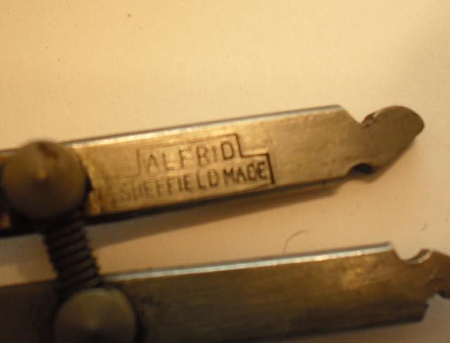

      On another thread I described how the spring on some outside calipers self destructed when I was cleaning them in hydrochloric acid. I believe this was due to a pre existing start of a crack which the acid stimulated. To make a new spring I need a piece of 20mmx70mm x1.8mm springy stuff. Suggestions please. I have had the calipers for at least 40 years. They are stamped ALFRIDname.jpg SHEFFIELD MADE.

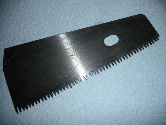

                        Modern throwaway saws must be made out of decent stuff, but perhaps a bit too thin? I've got one stached away waiting for me to experiment on it. It might be waiting a long time!

                              Hi Duncan-great idea! I happen to have one of the saws you mention. The teeth are knackered but I've kept it because "it might come in handy" and now it will. I will use a cutting disc in the angle grinder to hack a piece off. I will then anneal it and see if I can cut, file and bend it to the correct shape. Then re harden and temper.

                                            Well, I managed to find the old saw and cut a piece off. It's only 1mm thick but I'll give it a try.offcut.jpg
