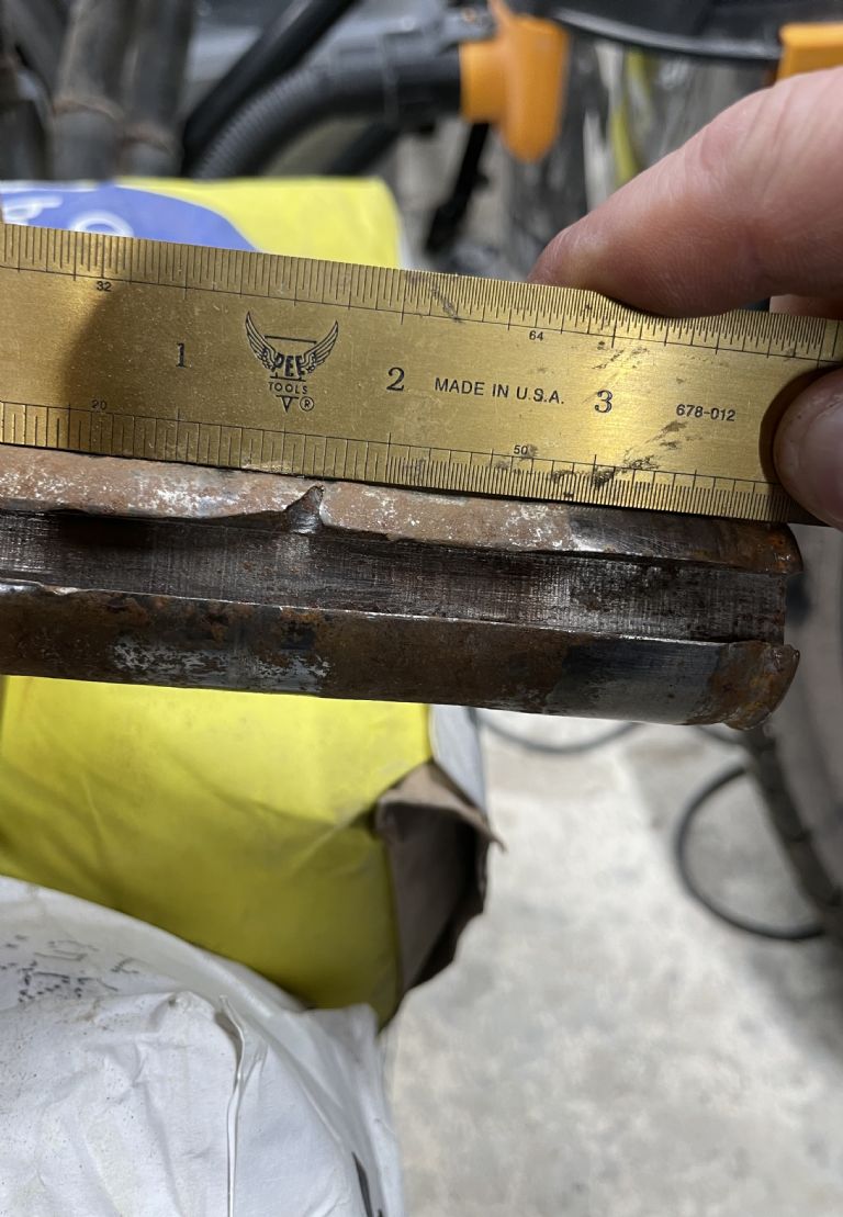

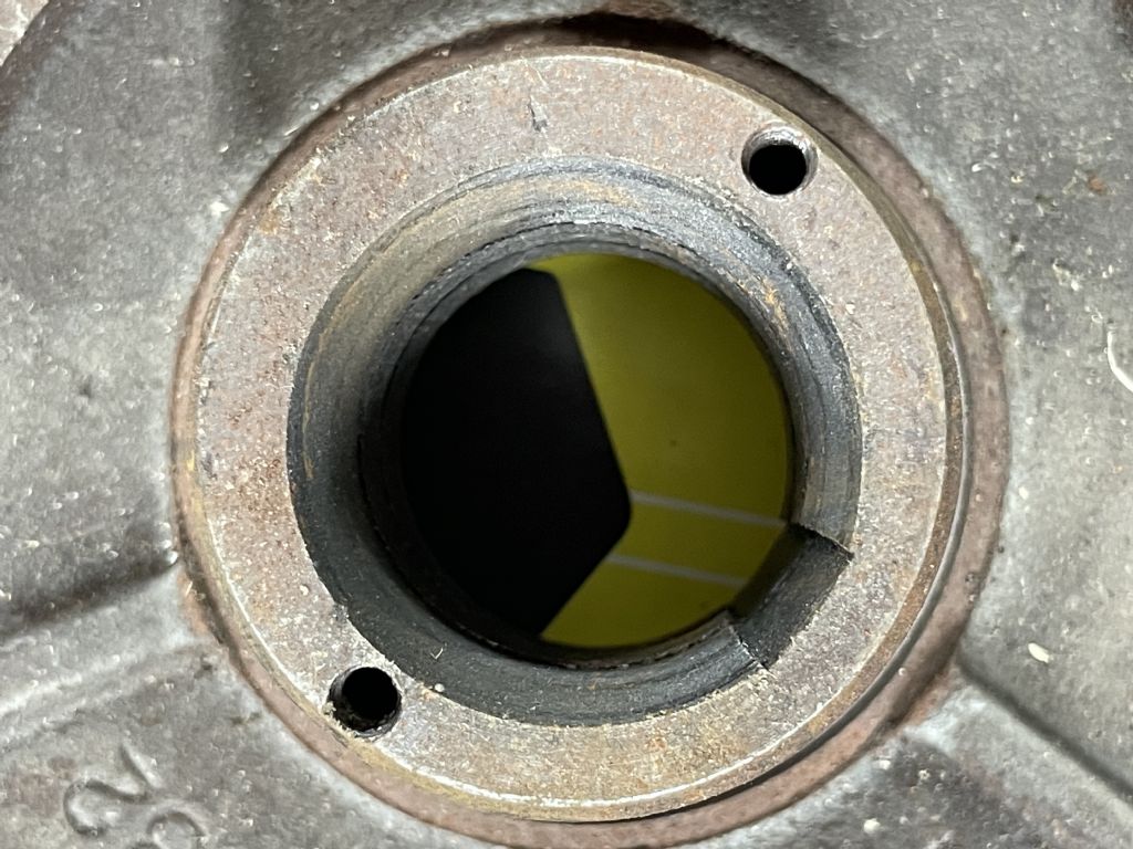

      I have just gotten around to looking at my series 1 vari speed 2hp motor. Having rewired it for low volts I started to look at the vari disc. It’s beyond repair. The previous owners appear to have run the machine with no inserts or retaining clip. Consequently the armature shaft has had as has the lower adjustable disc. As these are expensive parts can anyone recommend a company or person who may be able to supply serviceable used parts?

          The late JS used to repair these by filling the slot with weld and remachining it.
          I think there are some photos and how to over on the home shop machinist bbs. Might also be something here in the Bodgers Corner thread (think that’s what it was called)

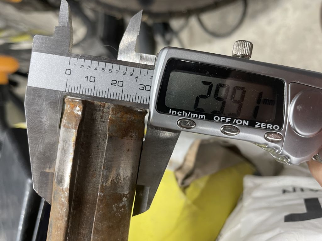

              Hi Clive the shaft appears to be 30mm or equivalent in old money (pics below).

                It appears that I have three varidisks from the 2 Hp 2J2 head. Both spindle disks and the fixed motor varidisk part 2J-643. Bore of the motor disk is 30 mm and someone has carefully written 2 Hp on it in red felt tip. Unfortunately I don't have the adjustable varidisk for the motor.
                I'm a little surprised that your set-up is beyond repair. As Dave says fixing the motor shaft by building up with weld and re-machining is considered a standard job by folk who do such things.
                Boring out the varidisk to fit an oversize plastic insert is quite practical. Delrin worked well for me. Still running well after 18 years and counting.
                I found that superficially horrendous damage to mine was actually not that great in objective terms when I added material to the motor shaft and bored out the disk after discovering the box of NoS parts I'd bought didn't have the right bits. Certainly nothing approaching the examples the late, great JS has published before and after pictures of.
                Clive
                #614906
                Mark O’Callaghan
                  @markocallaghan42477
                  Thanks for looking Clive. After getting over my meltdown I’ve had think about what I’m going to do. I’m going to weld the spindle as suggested above and I think I’m going to bore and sleeve the varidisc. Just need a lathe. 😂😂

                                David, yes you are right they do have a plastic bush in them, however if you look at the picture, where the disc has been rattling on the shaft it has created a tapper, so the bushes will not be big enough to do the job they are meant to do.
                                Mark
