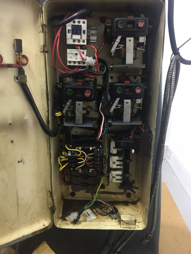

        Hi Guys,
        I have recently purchased a Bridgeport Mill and want to get up and running.
        Locally someone advertised a transwave Convertor (4.0kw Static ) from someone who lives nearby. I've read on this site that some statics seem to work okay on Bridgeport with pancake motor.
        I tried it last night and it wont hold the contacts in – does anyone know what phase the ghost is on transwave (as again on this site i read i need to perhaps trial and error a change of phase to the transformer to the contactor.
        Any advice greatly appreciated, thank you
        Vince
        Control Panel
        Edited By Vince Gedge on 14/01/2020 07:32:07

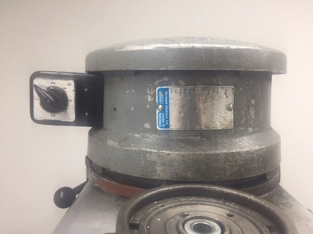

              I'm a bit confused as i thought the pancake NECO motor will not work with a VFD (i do have one but ive not tested as i read its due to the internal wiring). If this is not the case its great as i have a Bosch EFC5610 inverter.
              I also read that some people seem to get on okay with a TW static convertor and some have issues. form what ive read its not clear why some work and some do not was rather hoping that mine would be a "works okay"

                As Chris says there is some evidence that Bridgeport motors and Transwave converters don't play well together unless everything is just so. Presumably some interaction between the motor design parameters and Transwave design parameters pushes everything to the edge.
                Basic rule is make sure that all the control gear runs off the incoming mains driven phase. Both the others are generated and will have no power from a static converter until the motor is running. Transwave a s breed are sensitive to cable losses. You need a good incomer supply from the utility to the house and a hefty cable to the workshop. At least double book size is desirable in my experience.
                If you have the switched auto-manual reset overload devices on those old contactors its worth checking for proper operation and giving a good dose of switch cleaner. They are known to get a bit iffy after many years. Probably 'cos they pretty much never operate and get bored after sitting in one place fot 50 or more years.
                Old Bridgeport motors have a certain reputation for not lasting well when hooked up to a VFD. Hard to be sure how much is inherent and how much is just plain age. I know of Bridgeport motors that have failed after some time on a VFD (5 to 10 years). I'd prefer to use a decent branded VFD and, probably, fit inline filters to reduce switching stress. Bridgeport motors being seriously non standard its worth spending a bit more to be safe.

                  Can you confirm which is the incoming mains driven phase – logic would say L1 do you know. " Basic rule is make sure that all the control gear runs off the incoming mains driven phase.
                  thanks Vince very much appreciated.

                      Yes the transformer that runs the control gear is normally connected to L1 but on an older machine its best to check by tracing the wires through. Same with the Transwave converter. Just because there is no reason for someone to mess with things doesn't mean they haven't been played with.
                      These days I always check that sort of thing first. On balance it probably saves time as maybe 30 to 50 % of the well used equipment I get to see after the "Help" call has simply been messed around with. Simply putting things back to book works often enough to impress folk and, if it doesn't, at least you know where you are starting from.

                      As the Bridgeport pancake motors are shorter and larger diameter than the usual run of motors I imagine the design parameters are a bit different. There are a lot of different ways of making motors with similar nominal power but different operation characteristics, let alone any price / performance ratio considerations. Back in the days when VFD boxes were expensive "professionals only" devices with a 9 ft long list of parameters to set I imagine it was possible to set them up to get the best out of pretty much any type of motor with no risk of seriously reducing the lifetime. These days inexpensive inverters will be basically set up for the common varieties of motor which may mean they are hard on other types. Its a pity there is no easy way for the non expert to know if a particular inverter type or combination of set-up parameters is unduly stressful for any particular motor. Although Bridgeport pancake motors are known to sometimes react badly to inverters leading to shorter life the very non specific nature of when problems occur suggests that its basically something in the combination going out of the safe area.

                          If you are feeling brave, it is possible to rewire the pancake motor from Dahlander to Delta and run it off a VFD – https://youtu.be/o1rpez4uon0
                          I happened across that while trying to figure out how to run my own recently acquired step-belt Bridgeport off a VFD – currently it has a 415V permanent star motor *and* a 415V Bridgeport power cross-feed so a Transwave was tempting, but I've also read of a lot of problems (like these) – and my wiring cabinet looks very similar to yours!
