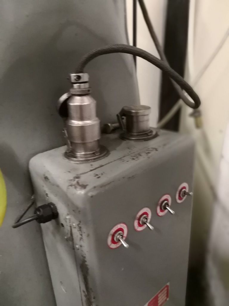

      Hi all i have bought a new Bridgeport Milling Machine and a slotting head from 2 different places the slotting head does not have a plug anyone have one to sell or know where i can get one please. is there an old machine breakers anywhere?
      Thanks Bob

      #18894
      Bob Astill
        @bobastill76884
        Plug for slotting head

        Ian Parkin
          @ianparkin39383
          Whilst I'd allways want to keep machines as makers intended I would just put a modern socket and plug on it..
          how many ways does it need?

          Bob Astill
            @bobastill76884
            Thanks for the reply the head has 4 wires i need to find a plug 1 to keep things original and 2 i have exactly the same machine at my works so i can use the head at either place or i would just hard wire it.

            V8Eng
              @v8eng
              Try a search for Niphan Plugs,
              Looks very similar to that make, we used to find them on equipment In factories as well.
              Found a link hope it helps.
                 https://www.aerco.co.uk/dbfile.axd?name=Niphan+Connectors+Brochure+low_res.pdf

              Clive Foster
                @clivefoster55965
                Agree with V8Eng that its almost certainly a Niphan connector. Old style sealed joint rough duty connector. Very, very expensive new these days. Far as I know you have to order direct from the maker. I suspect there is a minimum order charge and minimum quantity requirement too.
                Might be worth asking Sorted Machine Sales **LINK** as they sometimes have second hand parts.

                  Aerco have some prices here. The 4-way plug and socket are £69.03 and £74.16 ex-works, plus VAT. I think this question has been asked on the forum before but I can't find the answer. I'm probably not doing the search properly!

                    @notdoneityet
                    Tried checking out RS?
                    Is it like this?
                    **LINK**

                      V8Eng
                        @v8eng
                        Might be worth a look on EBay once you have positively identified it.
