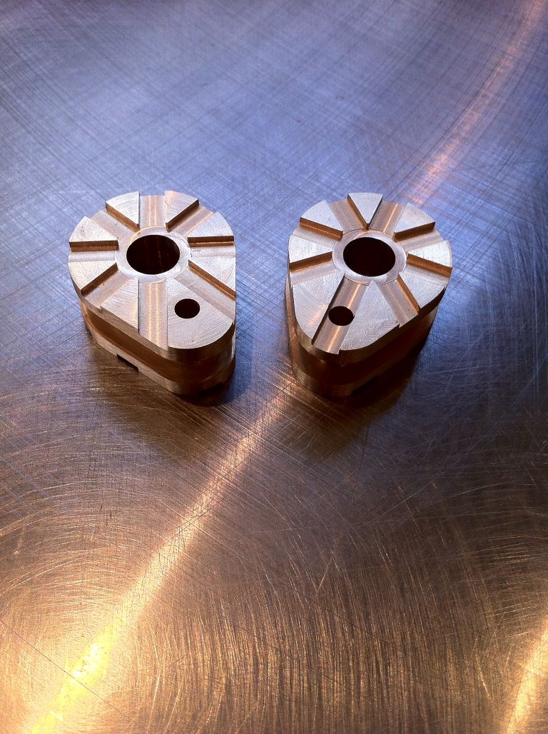

          Brian Abbott
            @brianabbott67793
            just spent a happy hour boring the 7/16 holes through my hubs, first one perfect, second one 0.002 over size…
            don't sound much but it given me a wobble, don't want to scrap it, anyone any ideas.

              Unlikely to really notice when its all done. If you are really not happy them maybe bore it out to say 1/2" and soft solder or even loctite in a sleeve. Probably easier than turning down an axle with an oversize end from 1/2" bar.

                Hi Brian,
                I remember doing just that on my Minnie – oversized a bore on rear wheel hub. So I opened up the bore and slipped in a bush with 601 retainer and tried again. Second time I got it right; bit of a faff, but all part of the learning process

                  Thanks both for your reply's
                  Not done and soldering yet, so loctite may be the way to go.. Is 601 the one to get ?

                    Hi Brian,
                    I only mentioned 601 because that's what I've had on the shelf for years, shelf life seems very good. Here is the link to Loctite's retaining compound page.
                    http://www.loctite.co.uk/loctite-4087.htm?primaryFacet=000000028Z#.
                    I'm sure I've seen 638 mentioned elsewhere as a general purpose retainer – looking at the spec. it cures a lot quicker too. I'm sure that other members will have different suggestions.
                    Are you soldering the covers on the hubs after assembly of the spokes? This might help you make your decision.

                    Brian Abbott
                      @brianabbott67793
                      image.jpgFinished the hubs today, decided to include the drive pin hole to help me setup.
                      Wondering now which bit to do, guess the wheel jig is next.

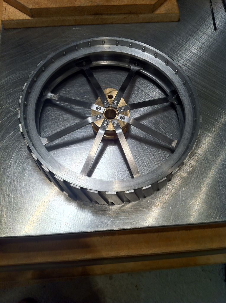

                      #169897
                      Brian Abbott
                        @brianabbott67793
                        Hello all, need some help if possible.
                        Progressing with the wheel build on my minnie, have now complete one side using the the wheel jig,
                        so now need to turn the wheel over and complete the other side, ( obviously )should I continue using the wheel jig ?
                        If I have done the first stage correctly and the hub is central to the rim case can I just sit the hub on a packer to stop any flexing whilst drilling, ect.
                        Thanks for any advice.
                        Brian

                            I can't offer any comments jig or no jig, but just wanted to say your wheel looks excellent! Very well done. JD

                              Thats how I have done them on all the wheels I have built, adjust the height of the packer and build the second side in the jig. Looking good.

                                Thanks both for your reply's,
                                I dropped the wheel onto the spindle but unfortunately it does have a few mm run out, should have taken more care i guess so need to sort this before starting the other side.
                                Jason..did you manage to get them running perfectly true ? or should i settle for what i have ?
                                Thanks
                                #169945
                                  I don't think I had more than 1/32" woibble on teh Minnie. Main thing is to make sure you get the bends right as any tension put on when its screwed together will pull the wheel out of true.
                                  You may want to try 4 spokes on one side, then 4 on the other and when its true start filling in the gaps

                                  CotswoldsPhil
                                    @cotswoldsphil
                                    As Jason says, any tension in a spoke will pull the wheel out of true.
                                    I made the wheels to my Minnie some time ago and remember it being rather fiddly, but I did manage to achieve wheels with very little run-out. Len Mason's description, in the Minnie book, which I followed, goes something like – working in opposite pairs… set the bend at the rim end, position the spoke with a 10BA screw through the central hole and press the spoke gently onto the rim, the spoke should just graze the edge of the hub groove and there should be no rock. It's probably more obvious if the bend is just a little too much at first, and then tweaked back to fit.
                                    Now the hard part – mark the spoke at the hub end and bend the spoke (all bends must be a right angles across the spoke and each hub end bend should be slightly short of the hub groove). Now refit the spoke to check – there should be no rocking and the hub end should lie flush with the face of the hub.
                                    Perseverance – bend, fit, mark , bend, tweak, fit, tweak, fit —- ahhhh is quite satisfying.
                                    Thinking about it now, for the second bend, I would make a little test jig, which would simply be a block of an appropriate height (inside rim to bottom of groove), resting on a flat surface, you could then test each spoke with Mk1 eyeball, so that it rests flat at both the rim and hub ends.
                                    It might be an idea to do 4 each side and check before completing the wheel.

                                    Brian Abbott
                                      @brianabbott67793
                                      thanks Jason, thanks Phil,
                                      Have managed to spend a few hours on it tonight( sure the wife thinks I've got another women in the shed)
                                      spent sometime re setting the spokes, then finishing the remainder, not quite finished but is running much better.
