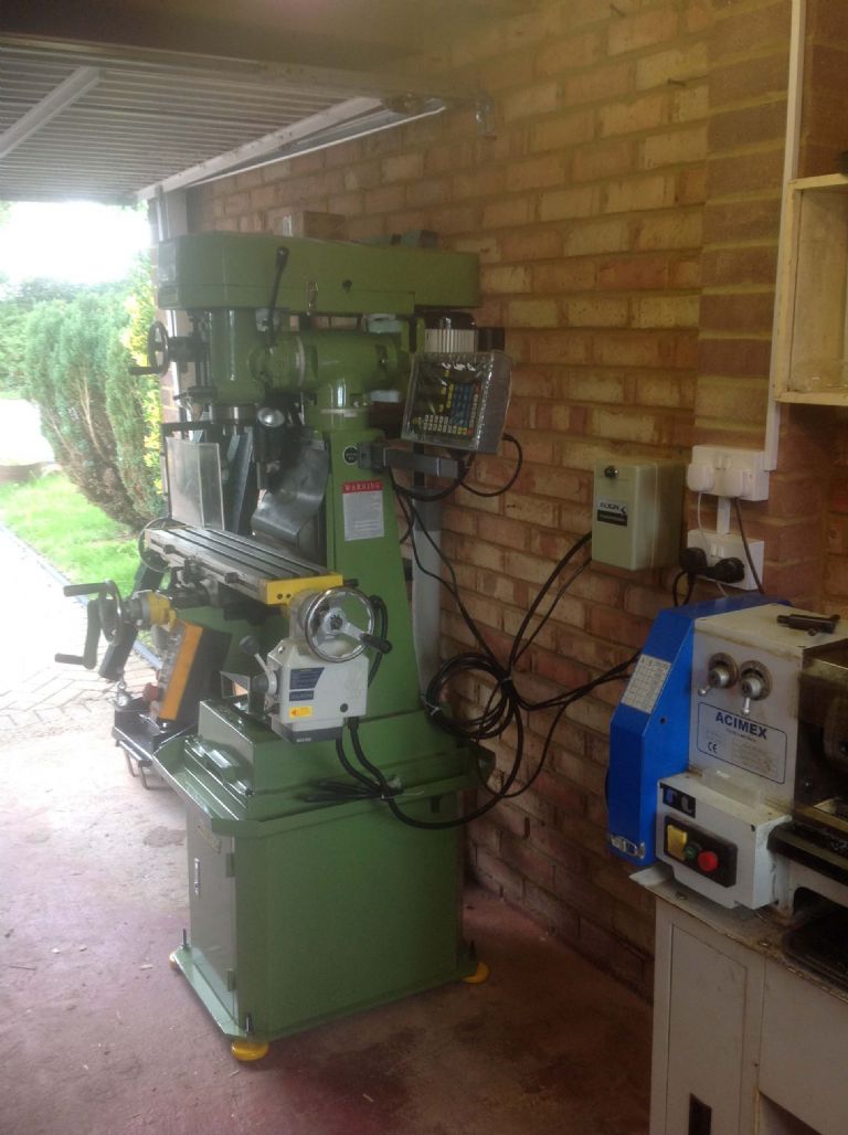

                As part of the package from Warco, I also specified their X-axis power feed. It fitted perfectly and operates with no problems. You just don't use the supplied casting (which is for the Bridgeport only). You can see it fitted below, just after delivery and before I fitted the DRO system. (omplete with travel stops and power feed limit switches, Vic.)
                View from the righthand side.
