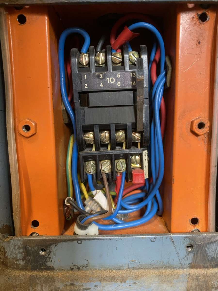

                    Just took the switch front off and its a Electronomics 3 phase start and stop switch on the side is a small pointer ahat points to 9.7 12 14.5 its set at 9.7 at the moment. will go back and check the motor it started this morning and ran for 2 min then triped out

                    john steel 1
                      @johnsteel1
                      Thank you for all your help. I just moved the belt from the left end pullys to the centre pully wheels and it works perfect. so I dont know why it trips when on the large and small wheels at the left end when running with no load free wheeling.

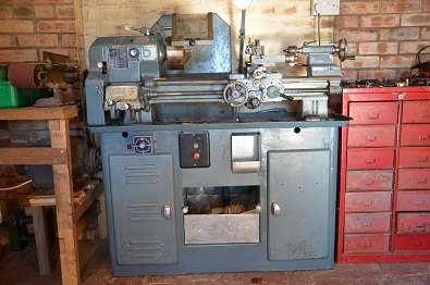

                          I have the same lathe with a 3/4 Hp single phase cap start motor and a very heavy chuck(6″ Burnard Griptu). Looks like the same stop start switch. This is supplied from a 40Amp (30 Mili amp) RDC and 32 amp circuit breaker, and not given any problems in the last 20 years (Crossed fingers!).

                            Ps:  Mine is set on 7

                                  The current setting at 9.7A seems high ! If set to high it will offer little or no protection to the motor.  It seems the motor is being overloaded on the high speed possibly due to incorrect lubricating oil causing drag ? This may not be noticable al slow speed. Noel.
