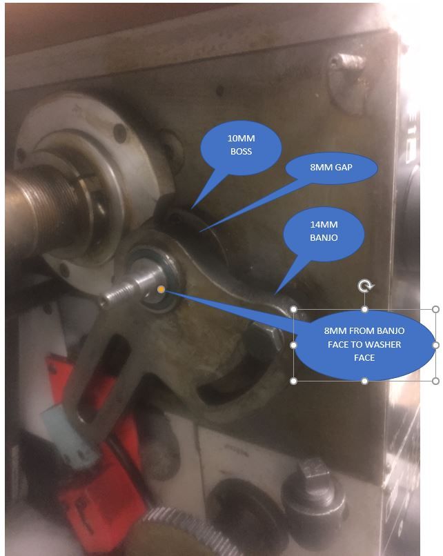

                                      I can’t immediately see how the Boxford solution is going to be work with the banjo in its current location.
                                      The driving gear sits on the shaft on a splined adaptor ( shear pinned to the shaft) that has been removed for clarity. All dimensions are approximate. Two possible routes come to mind, develop something that sits outboard of the driven gear or look at a new banjo arrangement pivoting on the lower input shaft to the feed and screw cutting gearbox. It looks like the oil filler elbow would have to be replaced, that wouldn’be a bad thing as it looks like it came out of a plumbers merchants! Sorry for the poor image the machine is right up against something els so I just have room to remove the cover & do change wheel adjustments.

                                        Harrison have surely made this one difficult with the banjo pivoting about the output gear. Relocating the banjo to the more conventional position about the input to the screwcutting box might need a whole new banjo design.
                                        My inclination suggests taking the drive from the output shaft, 1:1, to a gearbox containing the clutch directly above the output shaft, there is plenty of room here, but part of this space will be taken up by the banjo movement.
                                        The drive is then brought back to this output shaft either by gearing or by a timing belt, 1:1.
                                        Failing that the obvious place to fit the clutch is inside the headstock, but that will be major work and not for the faint hearted.

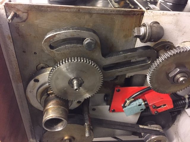

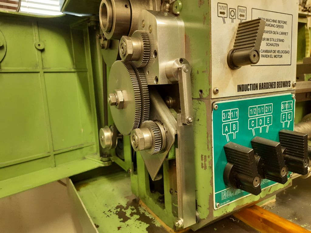

                                            Its going to take me a while to process all of that useful info, I spent a bit of time this afternoon looking at the possibilities. This is the banjo in its upper most position, this reduces the space envelope to approx 40 x 90mm. I think I will need a more detailed explanation a new a sketch to understand Gray’s suggestion.
                                            #531943
                                            Tony Ray
                                              @tonyray65007

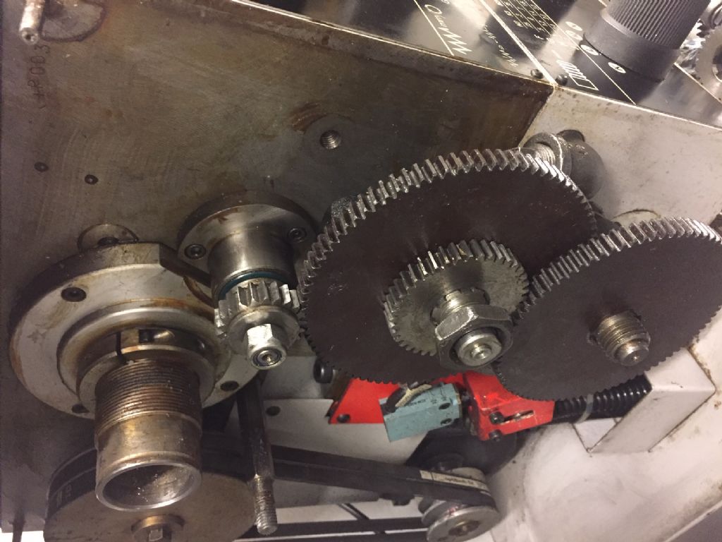

                                              I don’t think I would want to attempt an internal mod without a spare box to work on so here is a preliminary look at moving the banjo. The boss supporting the input shaft to the gearbox is cylindrical but smaller in dia that the current banjo and has protruding cap heads but they can be changed. A sleeve could be made to make up the difference. I hung the banjo on the boss with the two sets used to cut metric pitches.
                                              22T on the output
                                              44T on the output, the compound gear are just swapped round between the two setups. The wire is just to hold it in position
                                              so my initial conclusion is that this could work , the banjo is not a complicated part to make and I can 3 d print mock-ups. I think I need to make an accurate model in Fusion360 then model the various gear trains needed to cut imperial, module and DP. I am fortunate to all have a full set of change wheels to do Imperial threads although recent experiments have yielded useable 3D printed items. Moving the banjo then gives a large space in which to implement the dog clutch. That will of course need to be figured out but it should be possible to use Trevors excellent solution as a starting point.

                                                Just noticed that I failed to swap the compound gears for the 44T set up.

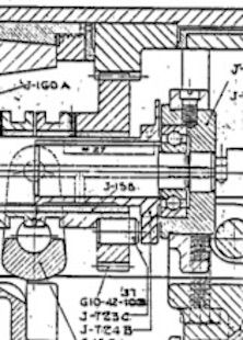

                                                  This is how P&W do it but they slide the gear. I see no reason why the clutch unit rather than the gear couldn't do the sliding.
                                                  With a decent helping of low cunning I think it might well be possible to squeeze  something similar onto the existing drive output shaft.
                                                  Dog is a pin (J -723-C) pushed into the gear (G 10-42-'37) clutch is on the right (J -742 B). Clutch is made as part of a sleeve sliding on and keted to the drive shaft. Gear and actuator slide on the outside.
                                                  Sorry for the poor quality but the scan I have is what it is.

                                                    I am not familiar with this lathe, but from what I can make out from the scan. The P&W clutch drives in one direction only. If this is correct then the leadscrew clasp nuts need to be disengaged to return the carriage to the start position.
                                                    The Hardinge HLV clutch, which the original Myford, and all my subsequent designs are based on, drive in both directions. There is no need with these designs to disengage the leadscrew clasp nuts.
                                                    This makes cutting any Thread, DP or Module dead simple. With no reversal of the motor needed either.
