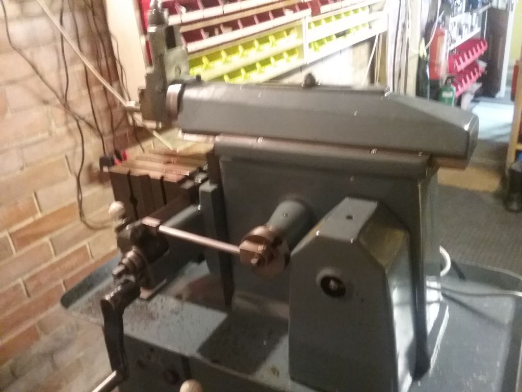

                      Shaper arrived Thursday, all stripped down on Friday for a clean, its 3 phase but have a single phase 3/4 hp motor runs at 1440 rpm I am going to use instead, does anyone know where I can get an exploded parts drawing ? Been looking for one of these for ages feeling like a kid in a sweetshop20170707_110618.jpg
                      Apologies photo designed to give you neck ache
                      Edited By Neil Wyatt on 08/07/2017 11:42:44

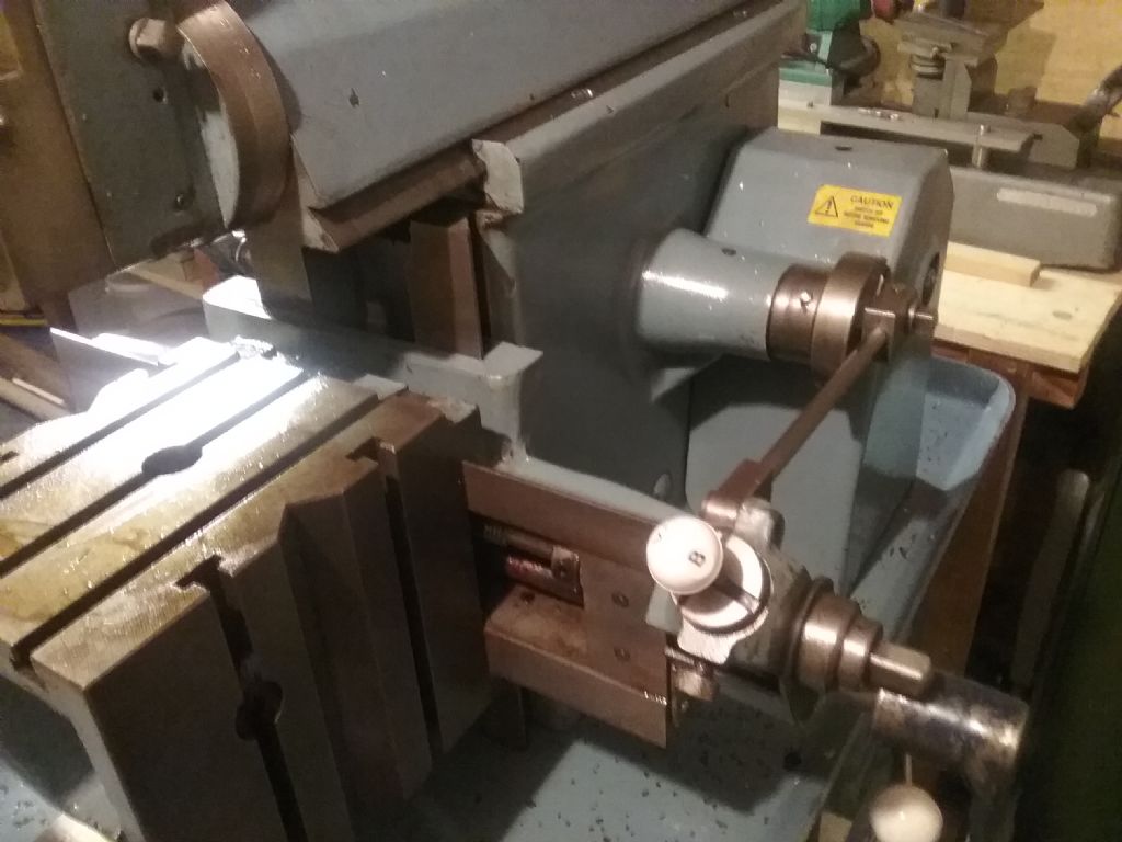

                      Mick Henshall
                        @mickhenshall99321
                        20170707_110701.jpgCouple more shots, not having 3 phase supply have a 1 phase 3/4 horse motor to fit20170707_110718.jpg

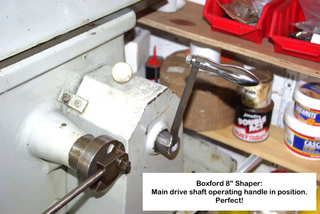

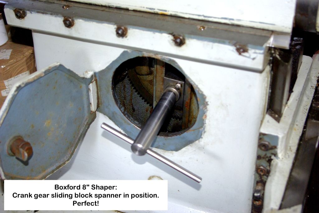

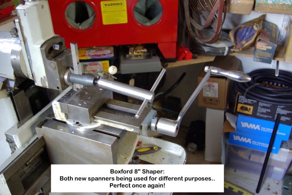

                                      You will be mesmerised by it's action, BUT do, however, fit a guard on the front to deflect the blue swarf that flies off, onto the tray.
                                      Mine with DIY handles
                                      Boxford 8 Shaper
                                      Boxford 8 Shaper
                                      Boxford 8 Shaper
                                      Geoff – Day off organising Ruby repairs photos
