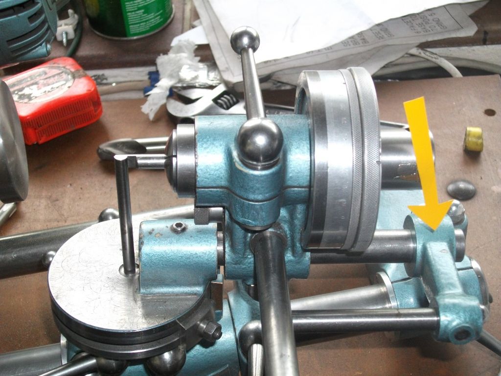

              I was wondering what this lug on the casting was for:
              According to the drawings, there should be a (5/16"?) through hole here. The book doesn't mention it afaik.
              I have studied a lot of pictures of other Quorns on the web, and some has a hole here and others don't.
              #282824

                  Posted by Thomas Staubo 07/02/2017 08:20:25
                  Hi Thomas ,the lug on that casting is a location to enable the
                  tooth rest bars shown on page 21 in the Quorn book to be fitted.
                  I have used this for the setup shown in the photo .The axis of the
                  rotating base and workhead spindles are aligned using the half pins,
                  using the bars and the tailstock casting the position can be maintained
                  when the toolholder is repositioned.
                  A full article was published in MEW 215 and 216 Grinding radiused edged milling cutters .
                  Some additional photo's can be seen in album Quorn and cnc cutter grinder.

                      Posted by John Pace on 07/02/2017 09:02:57:
                      Aha! That way you can slide the workhead to and fro, and take it off, without altering any angles.
                      Thanks!

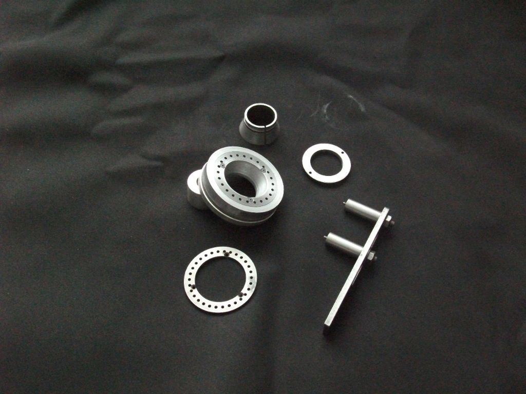

                      In your picture, it seems you have two knurled rings on the index ring. Or is perhaps one of them a (very large) clamping nut?

                        Posted by
                        Thomas Staubo 07/02/2017 13:43:47
                        "In your picture, it seems you have two knurled rings on the index ring.
                        Or is perhaps one of them a (very large) clamping nut?"
                        The index ring on my machine is made in several parts and has a
                        resetable dial and is constructed in a similar way to the index ring
                        on the front bar fig 9 on page 19 of Quorn book.
                        As can be seen in the photo the division rings are removable,the
                        two rings that i have cover most of the required numbers.
                        I over bored the casting to about 1 1/8 inch to fit a larger spindle,
                        the larger fixing collet is tightened using the pin spanner.
                        Edited By John Pace on 08/02/2017 10:57:07

                          I'm sorry John Pace, I forgot to reply and thank you for your photo and explanation.
                          You really thought it out when you made it.

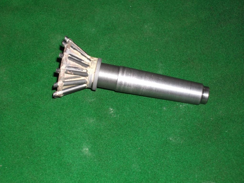

                          It seems like you have 24 and 30 divisions. The 30 wheel must be for dividing into 5, 10, 15 and 30. Is that for special cutters, maybe like dovetail cutters?

                            Posted by
                            Thomas Staubo 13/02/2017 08:07:16
                            It is just useful to have the facility to be able to divide these numbers.
                            I used the 24 division ring when making this dovetail cutter from some
                            scrap 1/8 inch carbide shanks.
                            #283937

                                Posted by Thomas Staubo on 07/02/2017 08:20:25:
                                I am grateful to Thomas Staubo for asking this question and to John Pace for answering it (and for his excellent article in MEW 215 and 216). The following is unlikely to be of interest to other than Quorn users.
                                When I built my own machine many years ago I was mystified by the drawing of this part (item 510), didn't put the hole in and have never missed it up till now, although I have used the tooth rest with its support attached to the column as normal. Departing from DHC's drawing was a bold step and I think I was influenced by the fact that the hole does not seem from his photos to be present in his own machine.
                                Now that John Pace has shown how useful the hole can be, I have put it in and in doing so have noticed that the lowest hole as drawn is the other way round from that in the photo and, indeed, from my own machine and DHC's!
                                Sadly, DHC is not here to help with these points but, on a different issue, those whose tilting brackets tend to slip should take note of the modification he outlined in ME of 5 September 1986.
