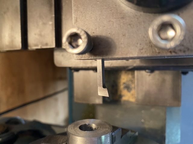

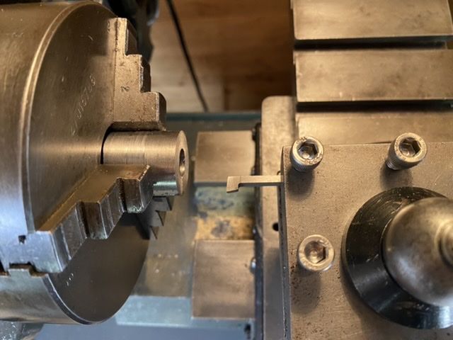

      92d127d7-c87e-4c27-a41c-45f39acce1c4.jpegHi,
      im having a bit of bother trying to use a boring tool.
      as you can see in the pics I can’t progress the tool any further on the cross slide, this is as far as it will go.
      any ideas, what am I doing wrong here.
      thanks

          Try rotating the top slide so the handle is nearer to you and wind it right in. Adjust the toolpost so that it is still at right angles and that should put your tool a bit closer to the lathe axis.

            Difficult to say for sure but it looks as though the tool is as close to the back of the slot in the toolpost — you can probably move it outward towards the machine centre thus putting the cutting edge closer to the machine centre.

                Plus one, there has to be something fundamentally amiss here. A picture taken from futher back would help, so we can see the whole picture, so to speak!
                Just checked on my lathe (Harrison M300); when the cross slide nut is about to become disengaged the axis of the lathe spindle is roughly aligned with the centre of the 4-way toolpost. So a tool as shown would be well past the work centre.

                        ..there's nothing fitted under the nose of the cross-slide to act as a 'stop'?
                        ..there is nothing attached to or protruding from any of the cross-slide T slots to act as a 'stop'
                        ..you can still see some feedscrew threads under the slide at 'your' end?
                        ..have you got the tailstock pushed right back out of the way at the end of the bed?
