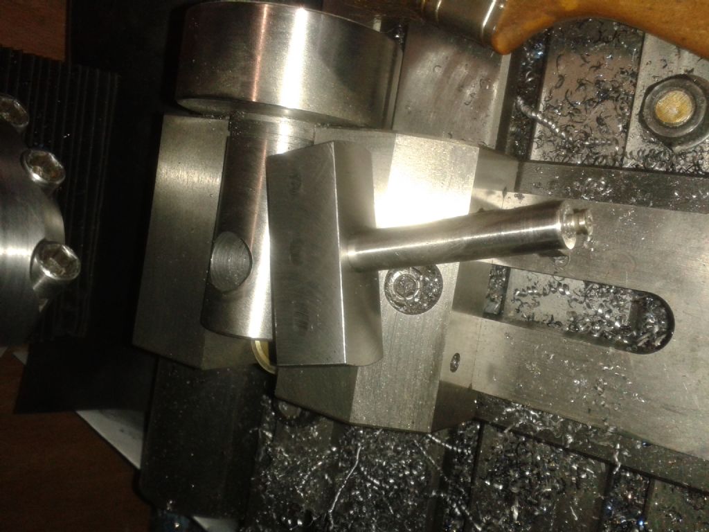

        Hello everyone, I have a question regarding boring on a small milling machine, I have a WM18.
        Before buying a proper boring head (there are many different types, sizes and prices!) I thought I'll mock up something simple just to gauge the machine's limitations etc. I used a fly-cutter body I already had and machined a 12mm dia boring bar using a ground drill bit for the cutting edge.
        It seemed to work fine on light cuts of say1mm off the diameter, but when I tried to up the depth of cut to 2mm off the diameter I could see the mill head sort of moving – just a little bit but that cant be right no?
        I was boring a hole approx 18mm diameter, 40mm deep at about 250rpm, material not sure what exactly but it was a 46mm diameter 8.8HT
        The tool seemed rigid enough with no nasty chattering etc, and it cuts ok, after a couple of passes the cutting edge is still sharp. Any advice is welcome, thanks.

          Just keep to light cuts, even .25 mm to .5 mm is OK, it just takes time. Patience is what is needed. I'v often wondered if I could do a better job boring cylinders for my hot air engines on the mill, rather than on the lathe as I do now.

            Hi Chris I have a similar Chester mill and have no problem boring just bought bog standard boring head no problems.

                Yes it's a 2" and it depends on what material and diamiter I am boring small hole faster maybe 750 rpm and 6inch diamiter 150 rpm. Also brass and ally faster than hard steel. A good strong boring bar is essential if it comes with a set of boring bars they will need grinding with a green grit or diamond wheel. I make bars for different jobs.

                  On My X3 with a 2" head I seldom take more that 0.050" ( 1.3mm) off diameter which is one turn of the dial.
                  I would say 2mm is getting a bit much and the HT bolt won't have helped, I'd be running faster than you but with boring heads it is often the balance that will govern your speed not what the book says..

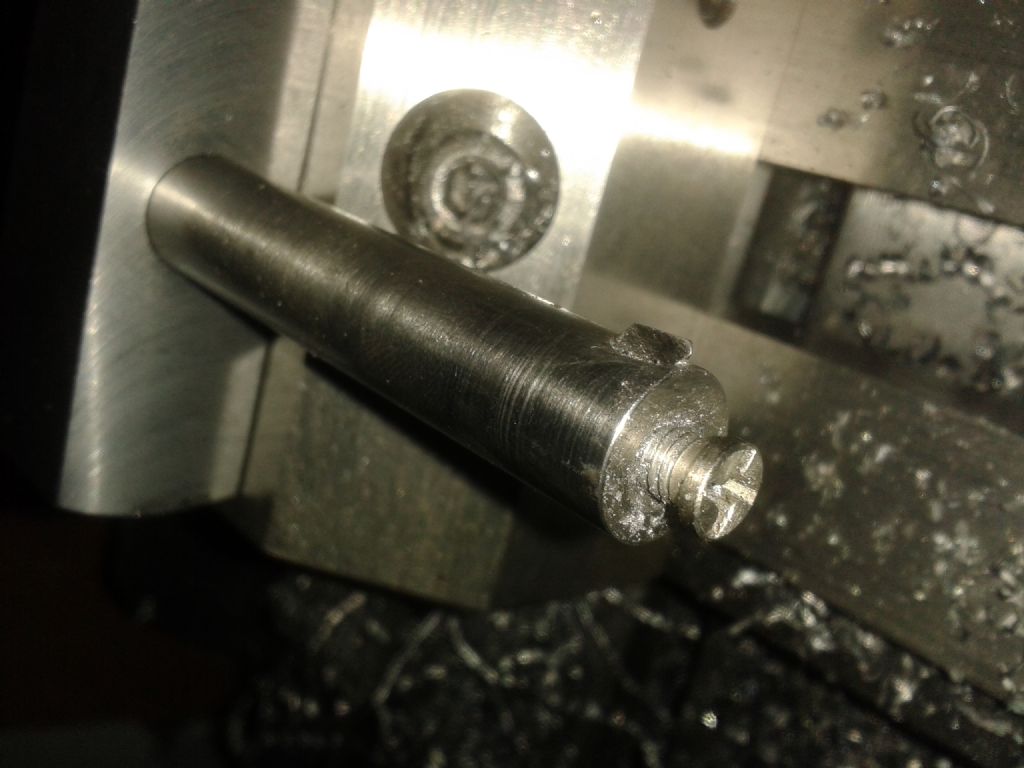

                            This is what I'm using at the moment – no control whatsoever on fine adjustment just guess work, but for the current project it's fine.
                            But I want a proper one for better control – the one in the last link is quite big true, not sure it's fit for a WM18, price is good…not sure about the quality tho!

                              Boring is just turning inside out with a less rigid machine.
                              What sort of lathe does your mill head look like if it were all turned on its side? Perhaps a 3in lathe with a ridiculous 8in centre height. How rigid is that?
                              If you were turning mystery metal or 8.8 bolt in this 'lathe' would your first cut be 40thou ? I'd be starting at 10thou or less to see how it performed.

                                Tool looks blunt in the last photo, also make sure the back edge does not rub on the holes sidewall.

                                  Jason , true the bit looks blunt in the photo, but in reality it is sharp…ish, the bit is a 3.9mm drill bit so it's a bit small. The thing with boring at small increments is it going to take a very long time without having the hole predrilled with a close enough dia drill.

                                    Chris if that is the shank of a 3.9mm drill then they are not as hard as the business end and will soon lose the edge, just think of how easily a drill shank is chewed up if it spins in a chuck. If you are going to regrind old tools then ctr drills or end mill shanks will be fully hard all the way along.

                                      I noticed that, the first try was a common twist drill…which as you say was pretty useless, so I used a stub drill, the hacksaw and file slips off it so I think it's "ok". Bored the hole from 12 to 22mm without issues.
                                      Will see if I can find some larger drills to reduce the "boring" time!
