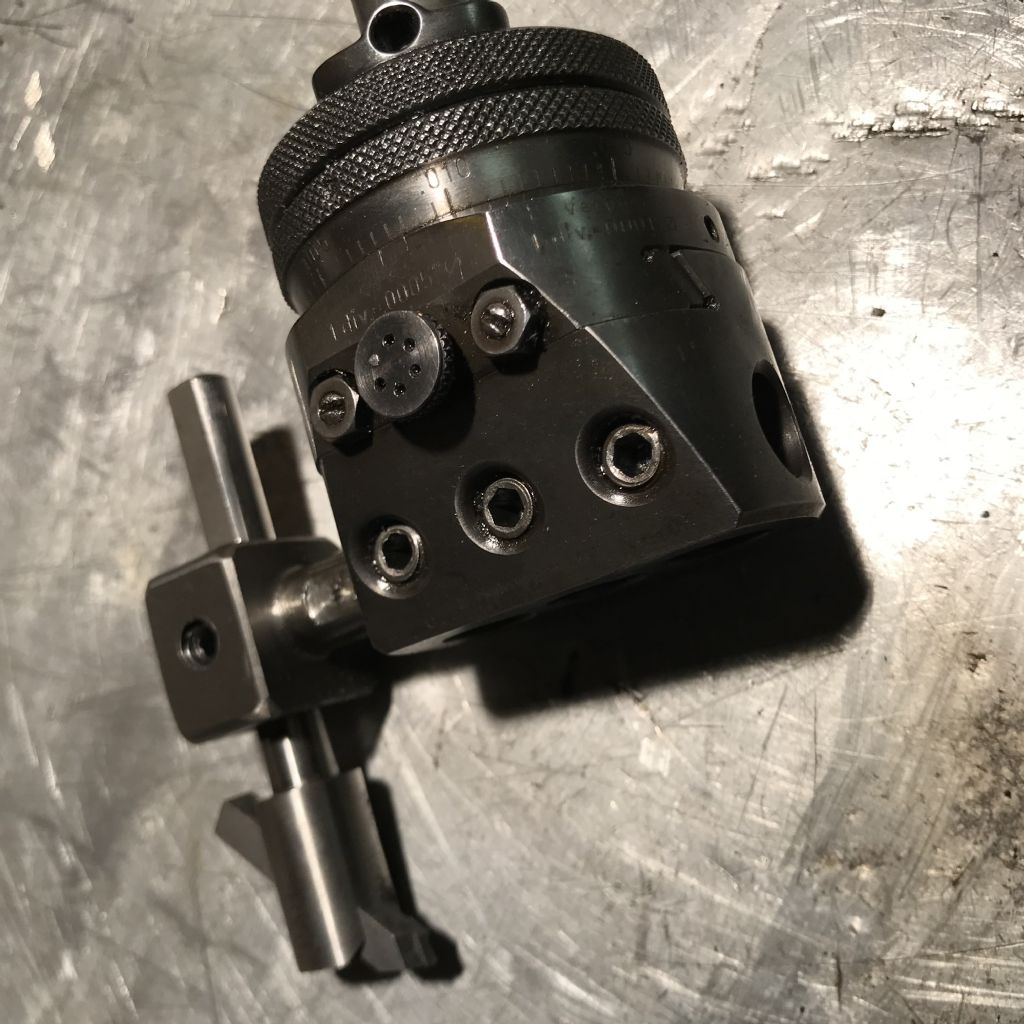

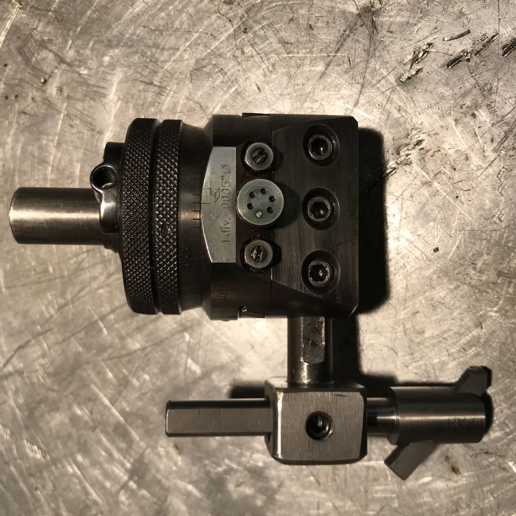

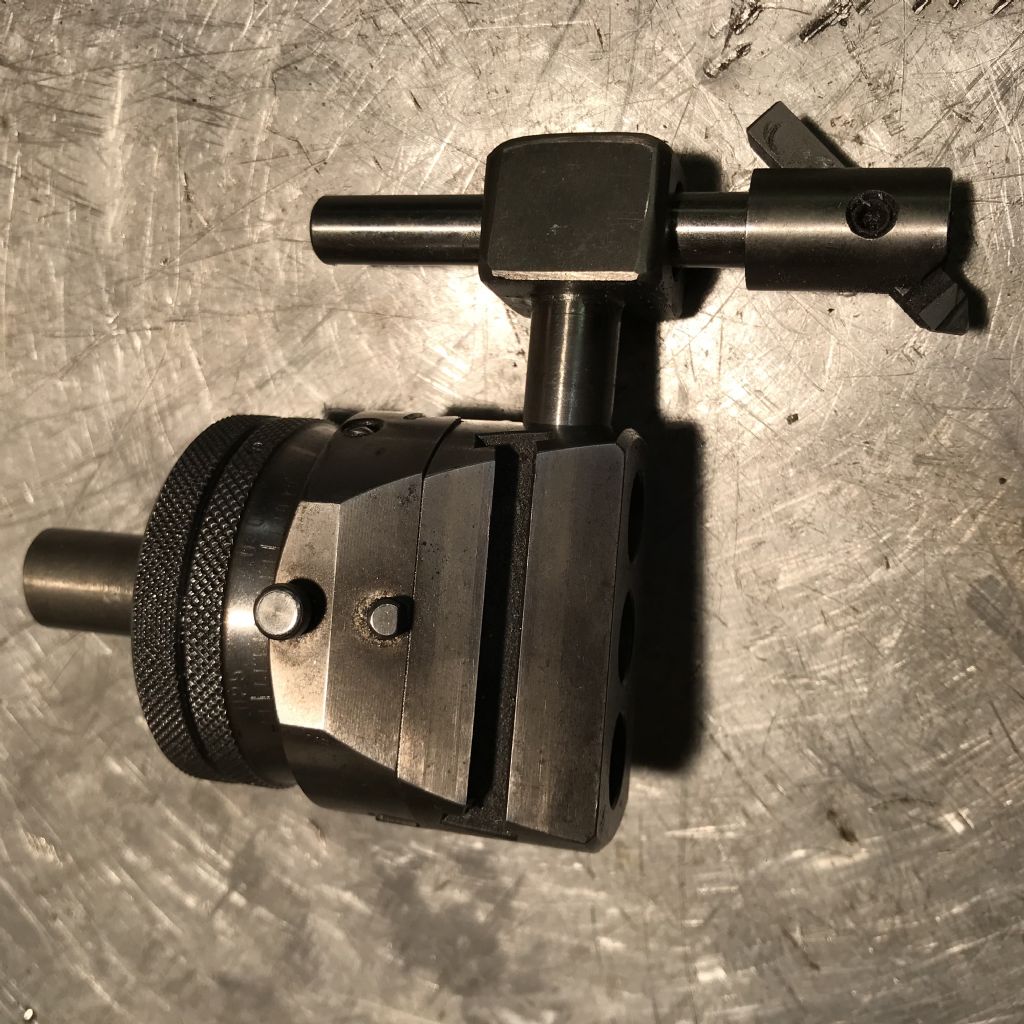

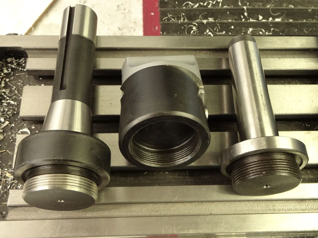

      Hi,
      I recently purchased a boring head from Arc, it has turned out to be a great purchase and has already paid for itself, however I did come across one issue which has puzzled me, as follows.
      I wanted to enlarge a hole in a sheet of plastic (perspex I think), the sheet was too large to be held in any way on the lathe cross slide so the mill was the only machine able to perform the task. The problem is that all of the tools that come with the tool are for an anti-clockwise rotation. My mill will and did run in reverse in order to achieve the desired result but I had to take very small cuts to prevent the head unscrewing from the R8 arbour.
      Apologies if I have been a muppet but am I missing something here?

          Seems like it is time to make some custom tools which will run in the correct direction. Any minute now there will be members posting designs for exactly the tools you want.

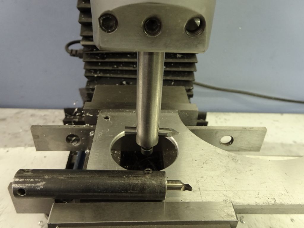

              As Oldmart says just grind a tool to suit, either one of the supplied brazed ones can be modified or make a simple holder from 12mm rod drilled 3mm or 1/8" to take an old crt drill ground to suit and retained by a grub screw in a tapped cross hole.

                You can get RH and LH boring bars, and even double-ended ones. The type supplied with the head are correct for vertical operation in the boring head and for most lathe-work.
                I've run my boring head in reverse and not had the drawbar come undone on a mill with an MT spindle. If the drawbar is tightened enough for the taper to grip properly, it shouldn't unwind.
                Possible Perspex contributed. It's on my list of difficult materials. It needs a sharp cutter and it's important to make sure the plastic doesn't melt and stick. I once ran a jig-saw through a sheet of Perspex only to find the two halves welded back together behind the blade.
                I wish I knew a way of tightening drawbars scientifically. I do mine by feel, first hand-tight, then spannered to close up with two fingers, plus a 1/4 to 1/3 hard turn to nip up. Seems to work well enough – the taper releases after a single sharp tap, and doesn't spin. But what on earth I mean by 'spannered to close up with two fingers' is probably only meaningful to me – pretty unhelpful!
                I suggested in a recent thread that R8 might be more likely to slip than MT2 because the R8 taper has a smaller surface area. No proof though! Perhaps Ian has hit the problem in the real world?
                If I bored lots of big holes I'd buy a Left Hand boring bar.

                  Posted by SillyOldDuffer on 19/06/2020 16:26:29:
                  It's the head coming off it's arbor that is the issue when running in reverse not the arbor coming out of the spindle

                        Jason is correct, it was the thread on the arbour screwed onto the boring head that was coming loose. Luckily it didn't happen enough to stop me completing the job but I had to take a lot more time than I wanted. I guess I need to look at grinding the two hss tools that I have for the boring head. To be fair the supplied tools were tips brazed onto the shanks and seem to be very well made and it was only the orientation that made things tricky.

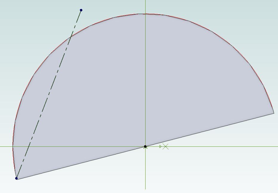

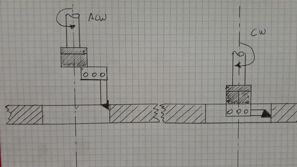

                                Hi Ian, when you place the ACW boring bar in the side holder of the head and rotate it through 180' to get the cutting edge facing down, wouldn't it become a CW tool? You can then spin the boring head clockwise and do your cuts.
                                Will try to draw a diagram, maybe it's clear to me or maybe I'm missing something

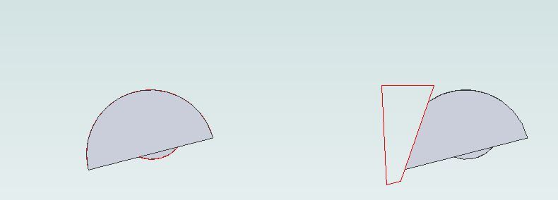

                                  Chris, the trailing edge of the supplied tools are usually curved so that when you run them horizontally the curved edge needs to do the cutting which is not ideal. But if ground as shown by teh broken green line they work so quite easy to modify

                                          I see what you mean Jason, that would be an easy fix.
                                          For the OP, the LH drawing is how the tool is supplied with anti CW boring bars, so you have to run it in reverse to do cuts with the boring bars in vertical.
                                          What I'm trying to suggest is mounting the bar horizontal in the side, turn the cutting edge to face down and run the mill in fwd direction. As Jason says the geometry of the cutting edge might need some adjustment but nothing major I think.

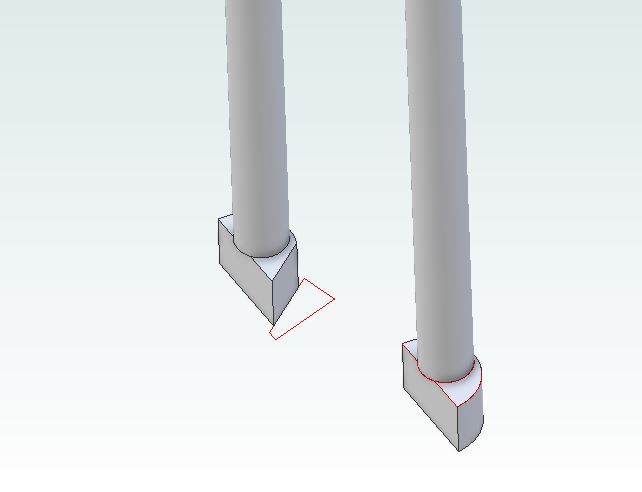

                                              Bit of elaboration of my earlier sketch showing how a supplied tool would offer a rounded cutting edge on the left and the modified tool on the right when used horizontally
                                              The modified tool can still be used for boring when mounted vertically, infact a bit less chance of rubbing in smaller holes

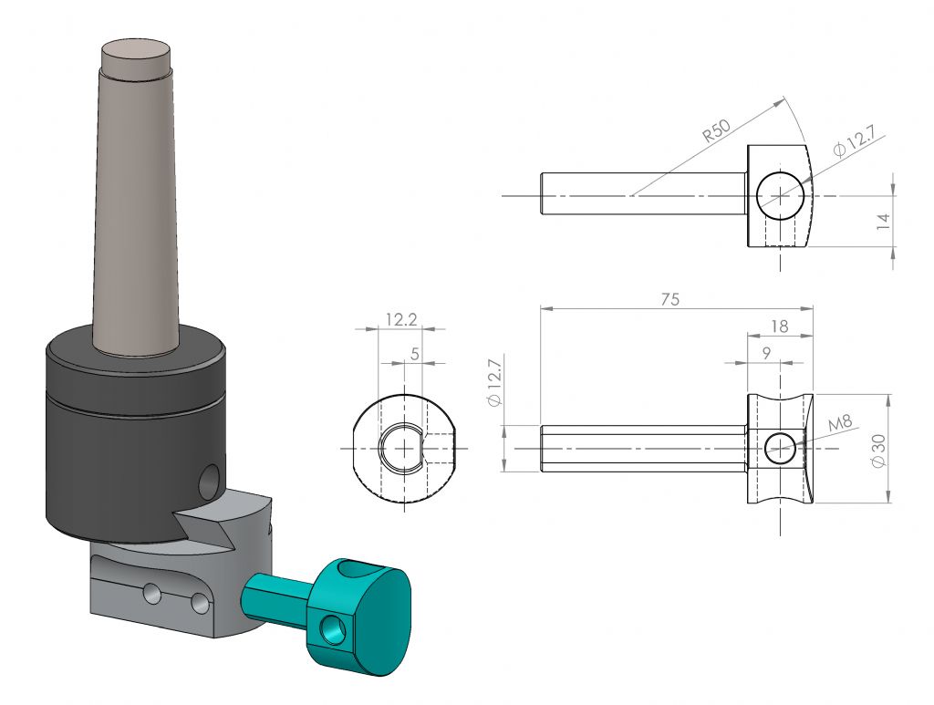

                                                Now we have started looking at alternative holders, ChrisB' sketch reminds me of a style of holder I have seen that has two projecting pins that locate in the two vertical holes in the head and somehow puts the cutting edge horizontal.
                                                I have a hazy memory that either the bar itself or a separate insert then fixes to this piece. I wonder if that was aimed at assisting with the balance issues. I cannot remember where I have seen it though.
                                                OK. Found something similar at:
                                                https://www.homemadetools.net/forum/improving-boring-heads-56968

                                                  I did look at rotating the tool within the holder but the cutting geometry isn't correct.
                                                  NDIY, yes I did exactly the same thing, even down to the fact that it was a piece of MDF cut out a hole slight larger than the hole I need in the sheet of plastic.
                                                  Using the tool held vertical in the holder gives the right geometry but not the required diameter. I think I will need to run up the grinder and see what I can do with a piece of HSS, although for now I have completed the task I initially set out to do so it will have to go onto the list of things to do.

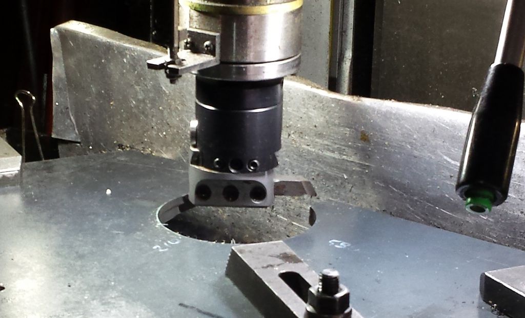

                                                    As DC31K's picture suggests below is a Wohlhaupter UPA2 head with a side bar extension fitted to put a boring bar into a position more suited to the job in hand. This set up was to externally machine the snout casting of an Eaton supercharger to allow a reduced diameter pulley to fit (20% upspeed on the charger).
                                                    Easy to make from a square bar of silver steel.
