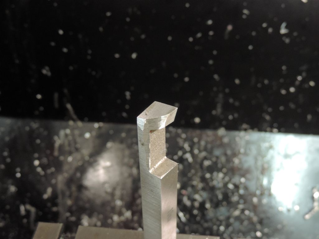

                              @davidgeorge1
                              Have you thought of using a home made boring bar with a piece of HSS as the cutting edge held in with a grub screw.

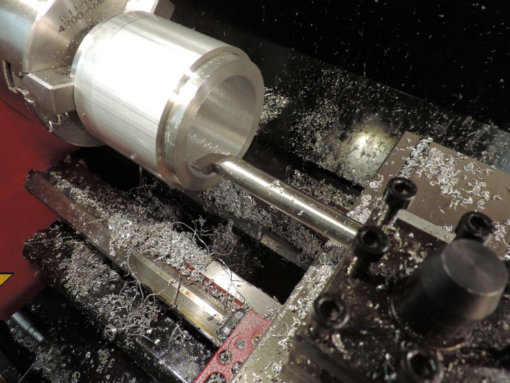

                                  #371013
                                    I'm blessed with more boring bars than you can shake a stick at.
                                    One of my favourites is made from the bent and ground end of a broken drill, jammed in a bit of aluminium extrusion. It's excellent for straight and tapered holes down to about 1/4"
                                    The boring bars that come in HSS sets are generally of two types. The square shank ones are easy to use, with the same shim, as other tools in the set, but need to be ground away for clearance in small holes. 8mm tools will just about work in a 16mm hole with this treatment.
                                    Round shank boring bars need less grinding, but are harder to set. It can be better to use a big bar straight in the toolpost without its square holder, than to use an undersize bar with a big overhang.
                                    I also like the bars that take a tiny 1/8" HSS insert in a 3/8" or 10mm shank. These work well with mini lathes, bit you may have to grind a curve on the fixing screw to get in small holes.

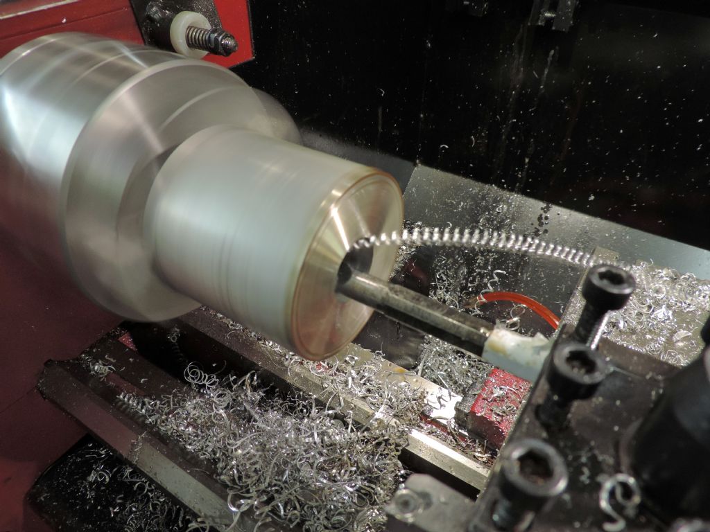

                                    My new favourite boring bar is this S10K-SCLSR06 from Arc. It takes CCGT/CCMT inserts. It has flats on it so the insert 'droops' at about 20 degrees which seems all wrong! With a hefty bit of packing (about 2.5mm) it's cutting rather below centre height in the SC4 toolpost. Not sure how the mini-lathe would handle it.
                                    Overhung by the thick end of 3" I had to limit cuts to 0.4mm in 6082 alloy today, but even with a CCMT insert (and a dab of cutting fluid) it was very free cutting with excellent finish.
                                    Obviously a QCTP with much more latitude in setting height will bring me closer to boring bar nirvana on the SC4 but so far I've largely stuck to the 4-way toolpost.

                                        #371994
                                          Update… I fitted the QCTP.
                                          The S10K-SCLSR06 boring bar works very well.

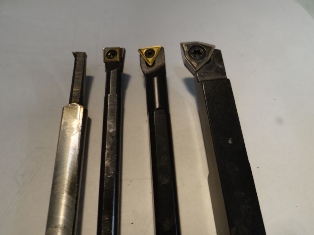

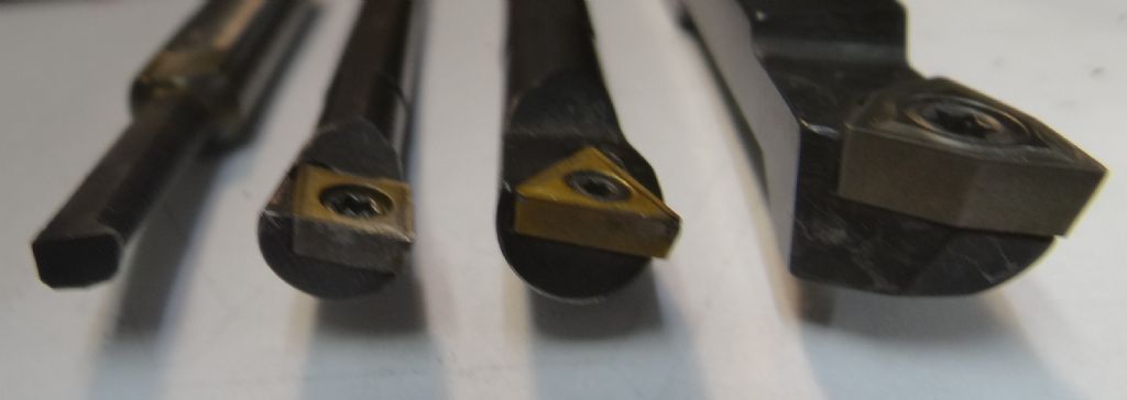

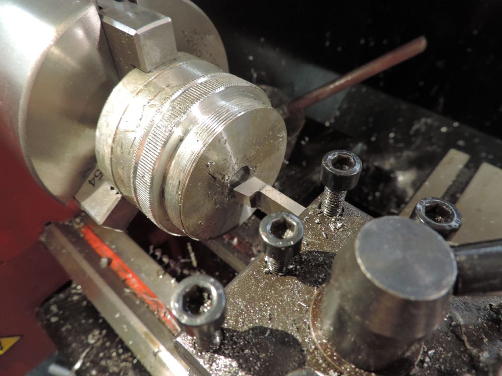

                                          #372003
                                            Here's my selection of boring bars, which are all useful:
                                            I find it handy to have four different sizes. The smaller ones are useful for small diameter and shallow holes. The big bars resist chatter and have a deeper reach, but need bigger holes to start.
                                            Viewed from the business end, the heads shows how big a hole is needed to get each size of bar into position:
                                            From left to right:
                                            1. Smallest bar is home-made from silver-steel and hardened. I made it specially to open a small hole out to a non standard size. It needs a minimum 5.5mm hole to start and goes 20mm deep.
                                            2. Next is the small boring bar I bought for my mini-lathe. It needs an 8.4mm hole to start and goes up to about 40mm deep.
                                            3. Third is the small boring bar bought for my WM-280. It needs an 9.8mm hole to start and goes about 50mm deep.
                                            4. Fourth is a heavy bar that came with a set. It's more rigid than the other types but needs a 16.3mm diameter hole to start and only does 45mm deep.
                                            As my biggest drill is only 13mm, in practice I use boring bar number 3 most often, starting by drilling a 10 to 13mm diameter hole with a twist drill and then opening out to size. If the finished hole is to be bigger than about 20mm diameter, I usually switch from bar No 3 to No 4. Not essential to swap but being more rigid the heavier bar cuts faster and deeper while producing a good finish.
                                            Minimising the amount of boring done by twist drilling to the max first is a good idea but there are limits. My mini-lathe struggled a little putting a 13mm twist drill into mild-steel so I'm not sure fitting a bigger chuck to one is a good idea. I usually drilled 1/2" (12.5mm), which it did comfortably, and then bored. The one time I did a big hole (50mm) on my mini-lathe I rough chain-drilled the core out and then tidied the diameter up to size with the No 2 boring bar. Not sure if that was the quickest way or not, but it got the job done.
                                            Inserts and boring bars go well together I think. I found grinding and sharpening HSS for a boring bar quite irksome. Just being able to swap inserts eliminated the fuss entirely.  I confess to being an oik at the grinding wheel.

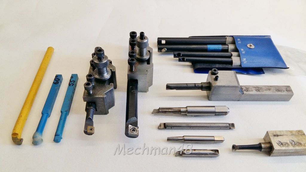

                                              #372081
                                              mechman48
                                                @mechman48
                                                I have a varied selection of boring bars, some of which I have never used, which include insert tipped, carbide tipped plus home made bars made from broken taps, broken milling cutters, silver steel, some of which are in pics. The one in the holder & bottom right are a couple I picked up from a car boot sale which I believe may have been used on auto / cnc machines…
                                                The smallest in my collection, top – 3mm (3.5 hole)… bottom – 5 mm, (5.5 hole)
                                                Have only used 50% of them, so far, but 'nice to have' I s'pose
