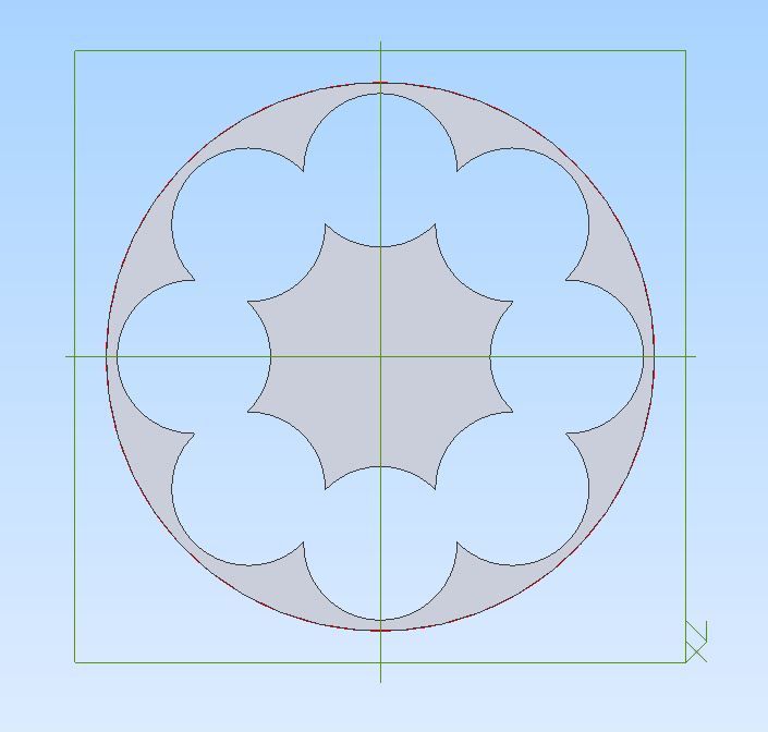

      I am trying to cut a round 25 mm diameter hole in some 25 mm thick aluminium disks. I am using a Sieg mini mill. Using an ordinary holesaw is not working. Probably because I have already cut smaller diameter holes in the discs so the holesaw drill has nothing to drill through to guide the holesaw.
      I bought a Armeg carbide tipped holesaw, which was not cheap. This successfully cut through one aluminium disc but no longer works to cut through the other 3 discs I have. I am using plenty of cutting fluid.
      Would a diamond hole saw work any better? I have a boring bar, but do not want to use this as I know from previous experience this will take a very long time if I use it. As on the mini mill I can only take very smal cuts each time.
      Perhaps my mini mill is simply not powerfull enough? I should soon have access to a large lathe, but I will still need to know what to use to cut the holes.

                    Given that the mini-mill does not have a great deal of power and may struggle to drive the larger blacksmiths drills even if working up in a range of sizes or the thicker kerf of a rotabroach. I would suggest stitch drilling out most of the waste with a 7mm drill bit which will allow the motor to run at a comfortable speed and not overload it or the plastic gears. Then take it out to final size with your boring bar(head? )
                    This is a fairly easy layout, I would drill the holes 6mm and then open out to 7mm to reduce the risk of the holes wandering as they break into the adjacent hole. Holes at 90deg are spaced 8.5mm from ctr, the ones on the 45angles are 6mm x 6mm from ctr which keeps it simple if using hand dials

                          So I'd change technique. Instead of trying to saw a large hole in one go, I'd twist-drill as big as I can – 13mm because I'm too mean to buy a Blacksmith's Drill.
                          Then bore the 15mm hole out to whatever size is needed with a boring bar. For this a boring head is needed:
                          Though they cost a few bob, boring heads are a valuable accessory. Boring does both deep and wide holes. As there's only one cutter, which can be adjusted to take very find cuts, it doesn't overload the motor. The holes are also considerably more accurate and straighter than anything done with drill or hole-saw. Main disadvantage is the time taken. If you want to make big holes quickly, a large powerful machine is needed to drive the cutter. Otherwise we have to slow down!
                          Jason's method is a good compromise: chain drilling lots of small holes removes metal quickly and then the boring bar only has to tidy up, which doesn't take long. The mill works inside it's comfort zone throughout, and swarf collecting and mincing in the slot isn't a problem.

                            I will give a 24 mm rotabroach a try. I have a R8 mini mill. What adapter would I need so that the Rotaborach would fit it? The one I have found on Amzon says that it needs a pilot pin, SRA50 ejector pin. What is this used for?
                            I have a boring head and will use this if necessary. But I lack the patience to use a boring head on 3 holes because of the time it takes, unless there is no alternative. Plus, I have had problems making the holes too big with a boring head.

                                  You are never going to do it quickly on a small mini mill due to the size of cut it can comfortably take. Using a large cutter that puts a lot of load on the slow running motor won't be quick in the long run when you have to spend time repairing the machine but I can see Ketan and the boys rubbing their hands now at the prospect of more sales of spare partsdevil
                                  If you can't size the hole then you have problems somewhere either rushing with big cuts that deflect things or tool geometry is rubbing somewhere. Boring head is more accurate and will give a better finish than any holesaw, rorabroach, blacksmiths drill, etc
                                  You should be able to use the quill lever to feed the boring head fairly quickly, for best results use the fine feed for the finish pass
