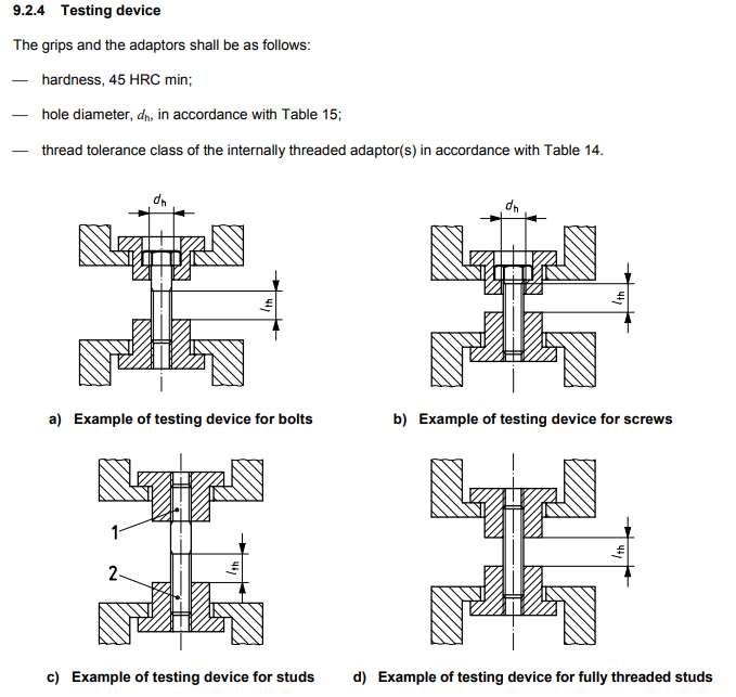

                        peak4
                          @peak4
                          My I refer you back to my post on the previous page.
                          It referred to an ISO standard, though hosted on a suppliers site.
                          From everything I’ve managed to find, spread across various ISOs, it seems a fair indication of the intended usage of the terms screw and bolt.
                          One of the previous links fails has moved, but this seems to work
                          https://regbar.com/wp-content/uploads/2019/09/ISO-1891-2009-ÖNEMLİ.pdf
                          (ISO225 also seems relevant, but I’m struggling to find a free source for it.)
                          Round about P 29 onwards.
                          Very broadly, external drive fasteners such as hex or square heads, seem to be subdivided into fully threaded screws, and partially threaded bolts.
                          Round heads, some countersinks etc, with some form of built in anti-rotation feature such as a square section or a nib are also called bolts.
                          Internally driven fasteners, such as Allen, Torx, Philips, slot heads, etc, are mainly called screws, regardless the thread length.
                          See also the tensile testing rigs in ISO898 staring about P26
                          https://pppars.com/wp-content/uploads/2021/07/ISO-898-1.pdf
                          image_2024-06-28_015054709
                          If anyone here is legitimately studying, or lives in NI, then they may have free access to ISOs; also I think folk in Lancashire can gain free ISO access via their library cards.
