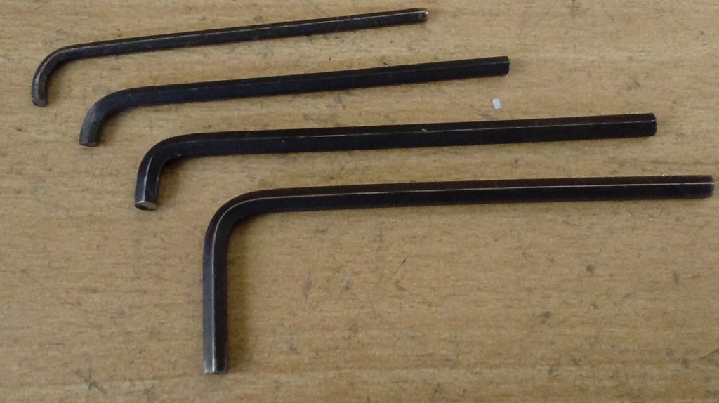

              Cylinder Jacket: Having made this to drawing I found that it was well nigh impossible to get the four M3 screws holding it to the crankcase in place and then tighten them. The photos show cap head screws. I have tried all types of screws but, in the end, gave up. My solution was to machine four scallops in the top flange to allow the screws to be inserted and the hex key – with a 'ball' end' – to be used to tighten them. Of course, this means that the four long screws used to fasten the head and fins in place will need to be placed 'fore and aft' and 'across' the engine, but I don't think that will be a problem.
              Can't agree with this as the photos definately show hex head bolts. but if you want to use cap heads then grind yourself up some short keys for final tightening the rest can be done with ball ended drivers
              It would have been very useful to have had a Materials List in Part 1. This should have included the sizes and lengths of the screws.
              I tend to just by boxes of 200 cap heads at a time and cut them to suitable length which works out a lot cheaper than buying small quantities of various lengths.

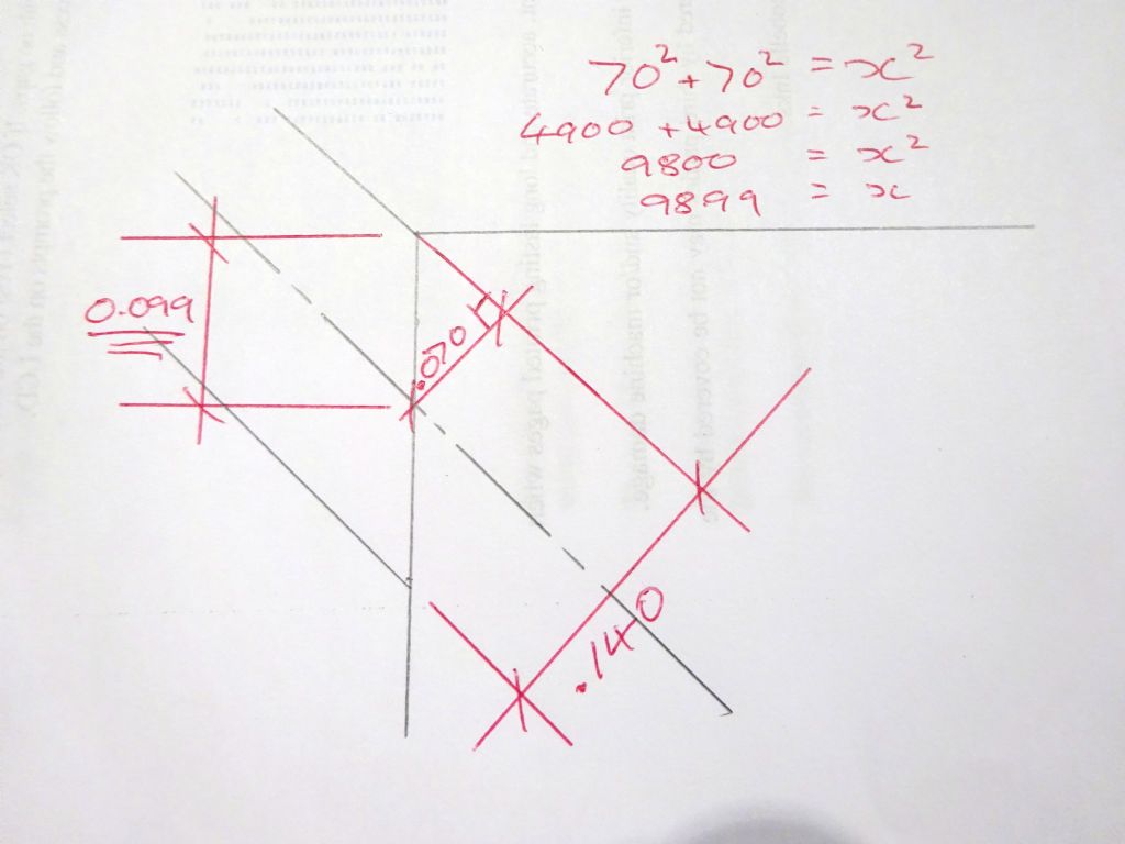

                          The transfer ports are 0.140" diameter so the centre of the cutter will need to be 0.049" below the bottom of the flange.
                          #285633
                            Posted by Dick Ganderton 1 on 23/02/2017 18:52:54:

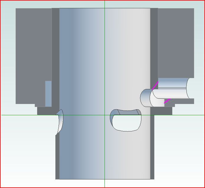

                            Can't get it to come out as that, as I said basic school boy maths gives 0.099"
                            Also CAD seems to agree
                            Pink areas could be touched up with a Dremel if you want a clearer gas flow, but this is not a high performance competition engine so probably not worth bothering.
