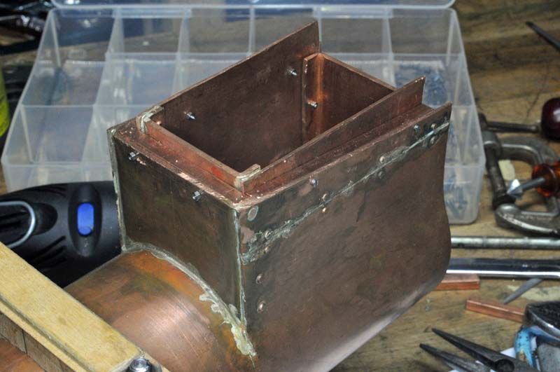

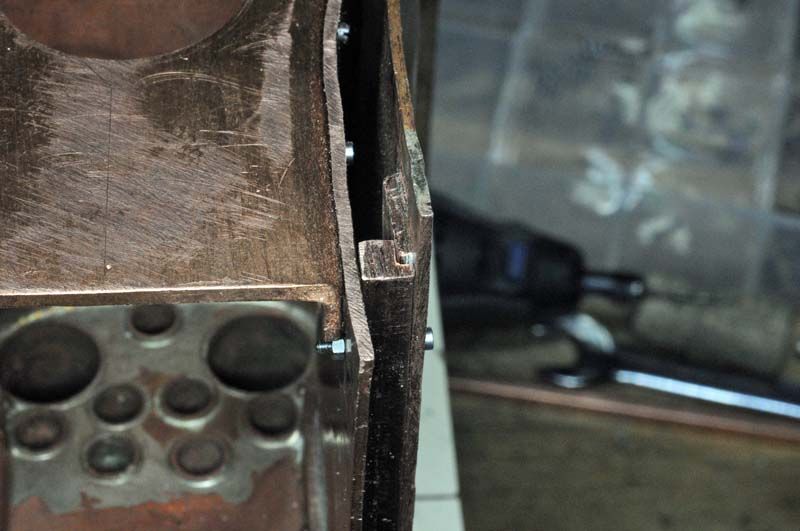

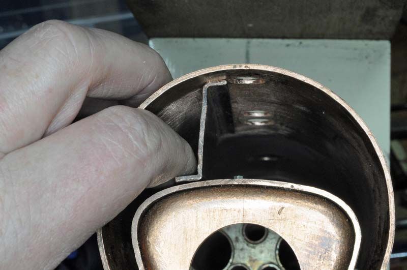

                              Mick,
                              I'm currently building a Rob Roy boiler (mostly) according to the drawings. I bought a kit from Blackgates with flanged plates for slightly over £200. I took my latest efforts to my inspector last night.
                              Currently, the firebox and foundation ring pieces are held together with 10 BA nuts and screws – these will be replaced by 1/16" rivets before silver soldering. I'm proposing to to use 1/8" dome head rivets for the side stays, head on the inside and the outer just poking through and silver soldered. The inspector is happy with that, I think it is generally preferred to nuts and caulking these days. As you can see the, I extended the sides after opening up the tube. In the interests of symmetry I did both sides the same. This was a mistake as the butt strap interferes with the foundation ring and I had to mill a tapered recess in the foundation bar to make it fit.rrb26.jpg
                              It would have been much easier to leave one side long and to have a butt strap on the other side much higher up and out of the way.
                              Making the crown stays to fit is also quite awkward to get a good fit.
                              Long 1/8" rivets would be much easier and my boiler inspector suggested using these – but as I've made the sheet crown stays now I'll use these and they will be soldered to the firebox crown before the firebox and tube assembly is finally inserted into the boiler tube.
                              Not he world's neatest boiler but, so far, it looks like it might be OK.
                              HTH,
                              Rod

                                Looks good Rod, did you use 3/32"thick copper for firebox in my book it is shown the same as the boiler at 16g,interesting using rivets for the stays saves a lot of threading for nuts, I see Kennions do a kit ( with unflanged plates)
                                for around £140 plus? but I'm not sure what is in the kit, having made frames , buffers horns, axleboxes stretchers and erected it all I am at an early stage wheels and axles next
                                Regards Mick

                                  Rod,
                                  I understand that you have only shown part of the crown stay in your picture. I did read (somewhere) that the some builders had observed distortion to the top of their Rob Roy firebox. One proposed solution is to add a second 'L' shape riveted to the piece shown in the book. Its flange helps to strengthen the inner wrapper.

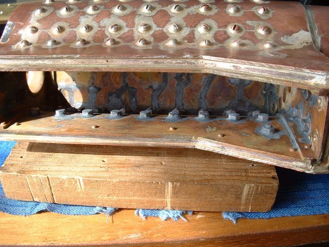

                                  This is a view of my firebox stays.

                                    The side stay spacings from the book don't seem to make much sense when compared to the Rob Roy drawings – as follows;
                                    The book gives a table for the minimum diameter for the stay per thickness of plate and for 1/16" it states 5BA.
                                    It then gives Stay pitch = Sq' root of D^2 x T x 3/ P x F x 4
                                    where D min stay thread diameter, T is UTS for copper (25000), F is safety factor and again suggests 8 and P is the working pressure (psi).
                                    this gives sq root of 0.096" ^2 x 25000 x 3/ 80 x 8 x 4 = 0.52" – half an inch!!!! or about 7/16" if 4BA is used!!!
                                    Assuming that I have pressed the numbers on my calculator correctly, neither can really be right because his own Rob Roy boiler drawing shown in the same book, a few pages earlier shows 5BA with a pitch of 3/4" x 5/8"
                                    Interesting.
                                    #297703
                                    Phil H1
                                      @philh196021
                                      Sorry, I meant to type 9/16" for 4BA – not 7/16". It also gives just over 5/8" pitch if 1/8" is used.
