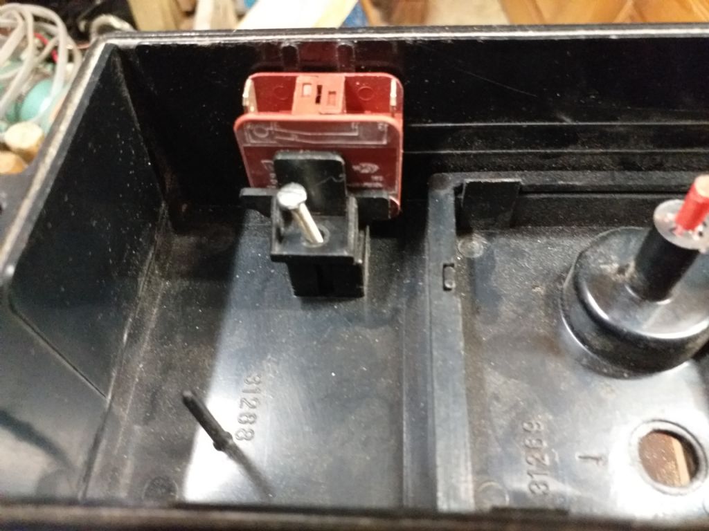

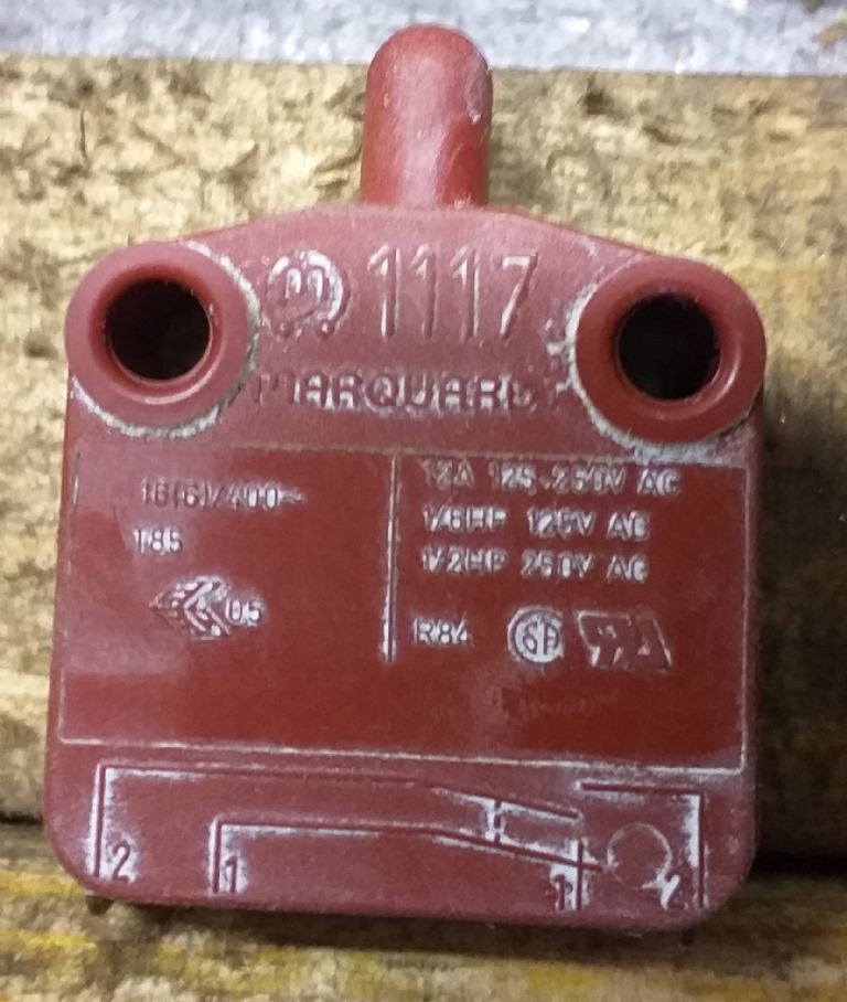

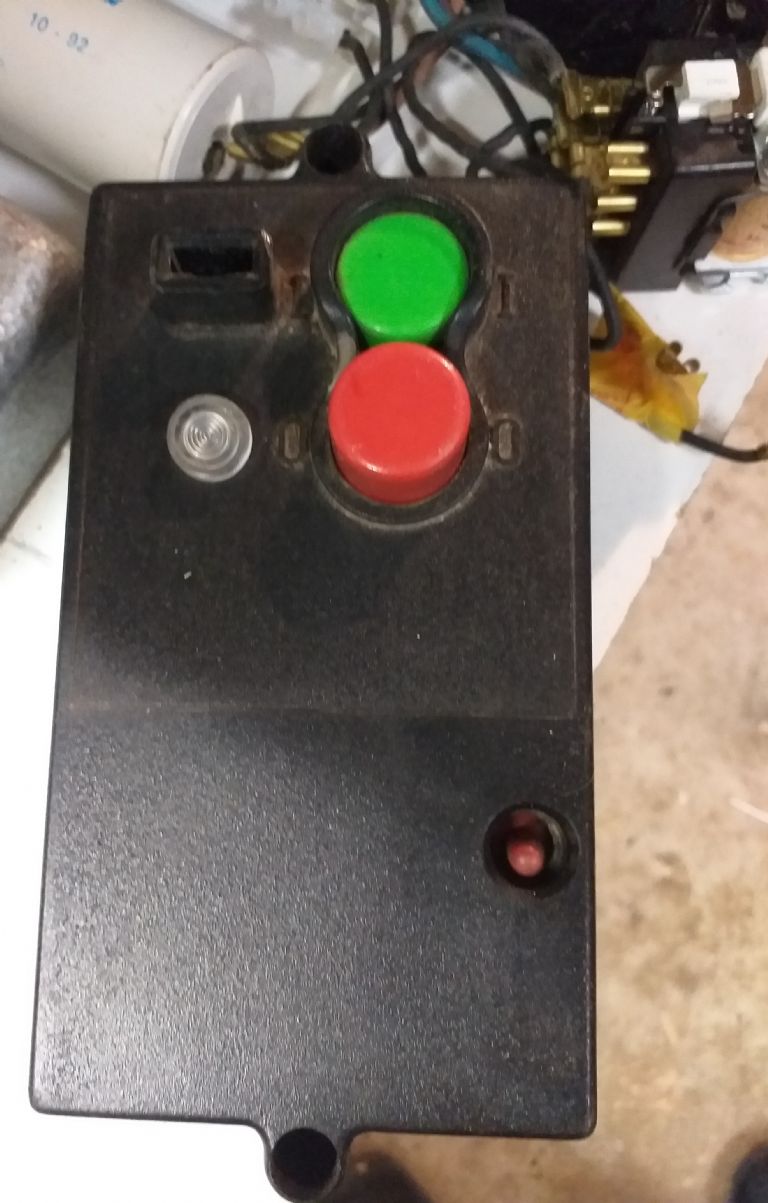

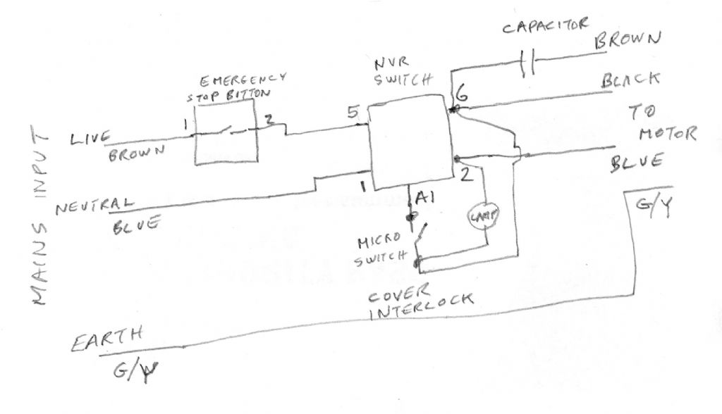

      Yes, the Multi meter is max 10 amps.
      Pic of micro switch shown. I have tried to chalk it to make it easier to read. The original fell one apart but inside was a couple of metal strips effectively being pressed over or onto. I cannot recall much else. My apologies.
      The front of existing switching is the PIc. showing the micro switch as mounted. The red button (bottom right) should have a plastic dust cover on top of it. The running light (top left) I read somewhere is useful in a noisy workshop, so I don't need that now.
      The last Pic. shows the emergency stop button wiring diag. They have similarity to each other? I do hope this is not as misleading as much as before.
      I tested the resistance of the micro switch. With button NOT pressed-in I got a reading of 1 ((overrange indication). I have assumed this means no connection in this position. With the button pressed DOWN I got varying readings immediately (almost too quick to read) of 7.5, 9.6, 8.4, 6.7, 3.1. The readings whilst still continuing to press down reduced to 0.01 or on one occasion 3.2. It did a count-down through all readings so it took a while on each reading.
      I think I have covered all the questions this time so thank you once again for your help but will go over things as requested. Feeling encouraged!

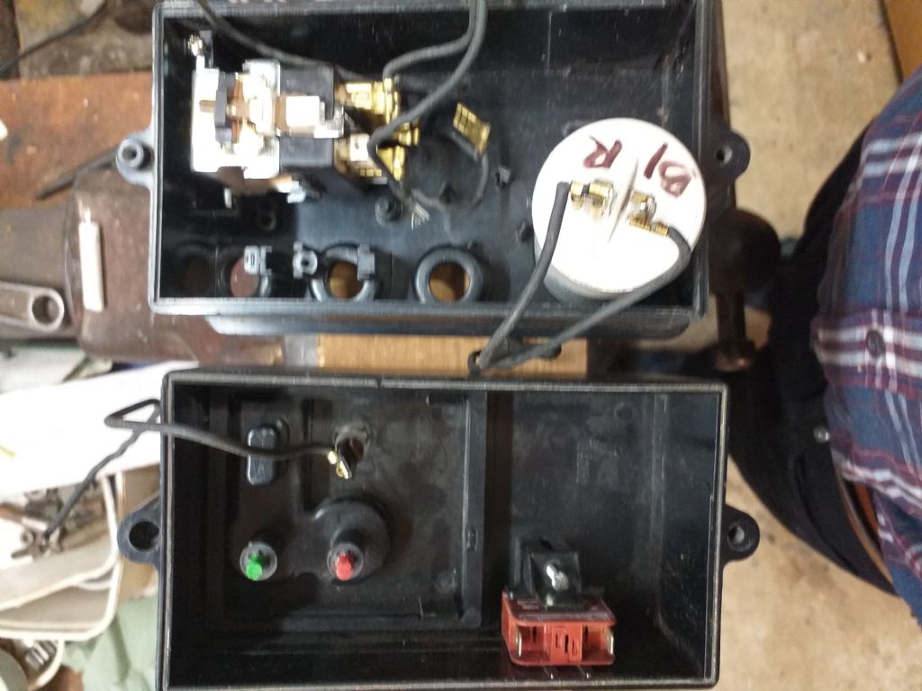

              I have taken a pic. of the box showing both halves (all loosely re-assembled). The wires were cut to allow a temporary connection to the mains. The three holes through the back in the top Pic. are for the grommets for feeds in and out.
              If you like I can ease apart the micro switch, which I hopefully will not have a use for in the future. Let me know please and I can do it quickly and take a pic. Thank you for all your support once again.

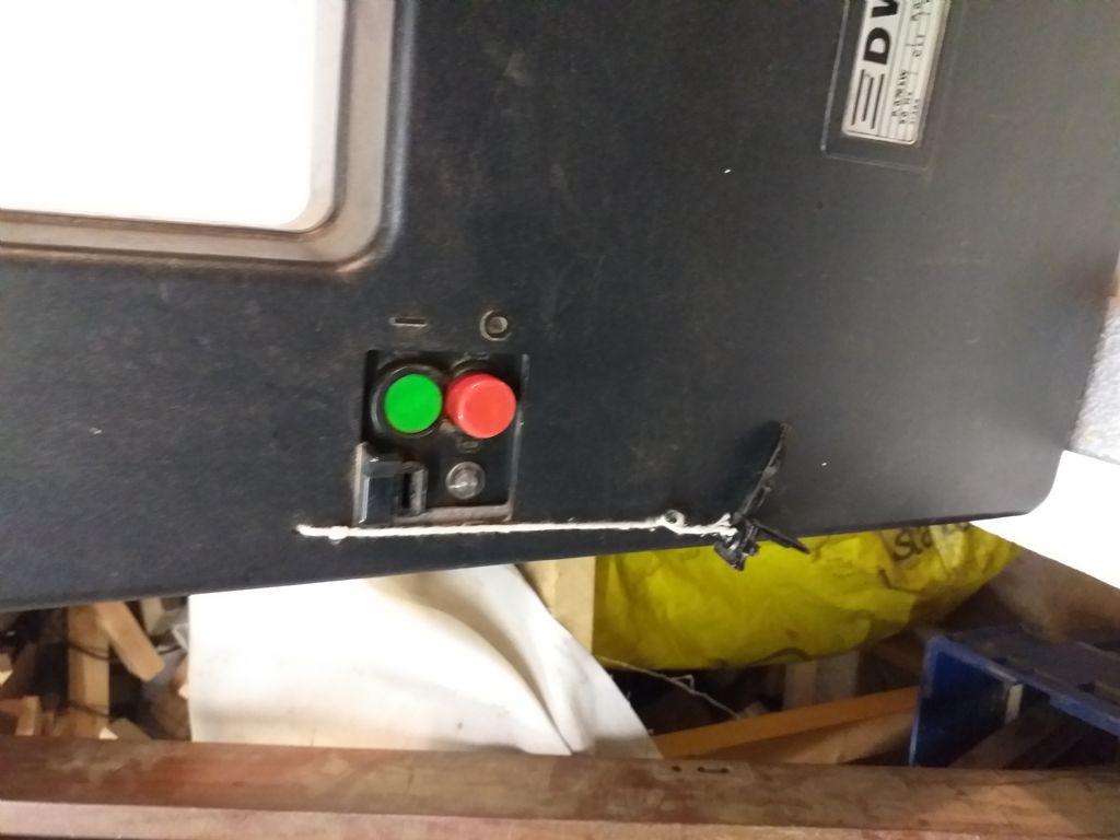

                This is still not the picture I asked for. From the second picture picture in your post at 12:46 on 11/10/20 it looks like the black plastic control box is mounted on the die cast right hand side of the machine and it looks like there is a hole in the hinged left hand cover of the machine that allows access to the red and green buttons, the hole for the key and the indicator light. It looks like the hole in the left hand cover does not go down as far as the plunger on the micro switch. I want to see the INSIDE OF THE LEFT HAND COVER so I can see if there is something on the INSIDE of the cover that presses against the plunger of the micro switch when the LEFT HAND COVER IS CLOSED. This would then explain the purpose of the micro switch.

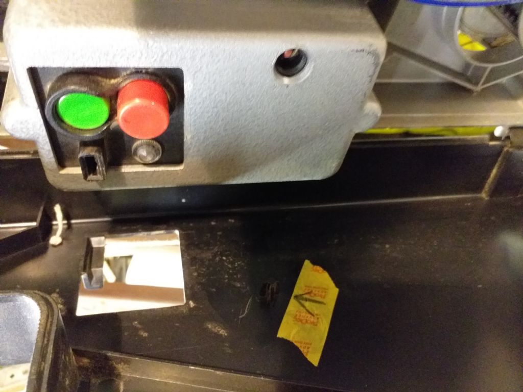

                  Marischal Ellis
                    @marischalellis28661
                    I have taken two pics. One of the cover inside and the other of the cover closed. I do hope they are correct.
                    The open cover was a bit dark so I put some masking tape over the micro switch button as a check. The 'pin' on the cover inside (pointed pencil arrow) aligns perfectly with the button when the cover is closed and the tape was depressed. The loose button was pressed in so, they align with each other.
                    The other pic shows the cover closed concealing the button from view. Both pics require rotating I am afraid but they are easily understood. M

                    Les Jones 1
                      @lesjones1

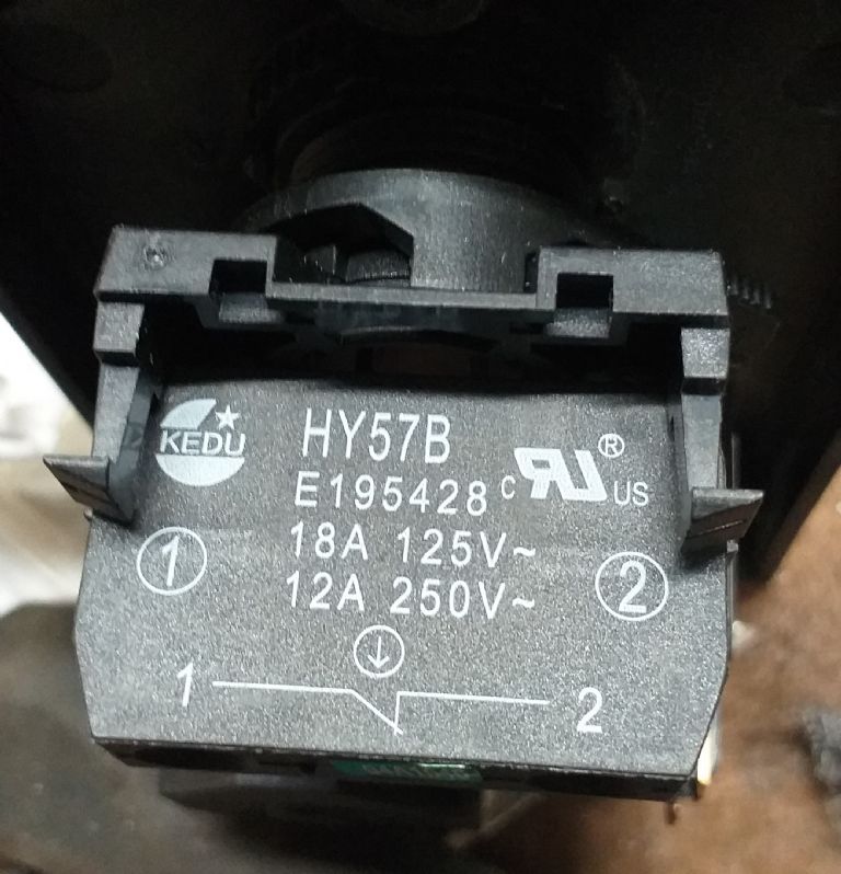

                      We have now confirmed what I suspected in my post on 01/09/20. It has taken 41 days to confirm what would have taken a few seconds if I had been standing next to the band saw.
                      This is how I suggest connecting thing together.
                      It will behave slightly differently to the way it was connected in your original diagram, In your original diagram the micro switch was switching the full motor current which was more than it was rated for. It is now only switching the current taken by the coil in the NVR switch. This means that when the cover is open the motor will run while the green button is held pressed. The way it was connected the motor could not be made to run with the cover open.
                      It is now wired in a similar manner to the schematic in the manual. If you don't want to fit the lamp just don't connect it. (It will work without it.) Whatever physical changes you make to fit the new NVR switch the micro switch MUST be held closed by the left hand cover while it is closed.
